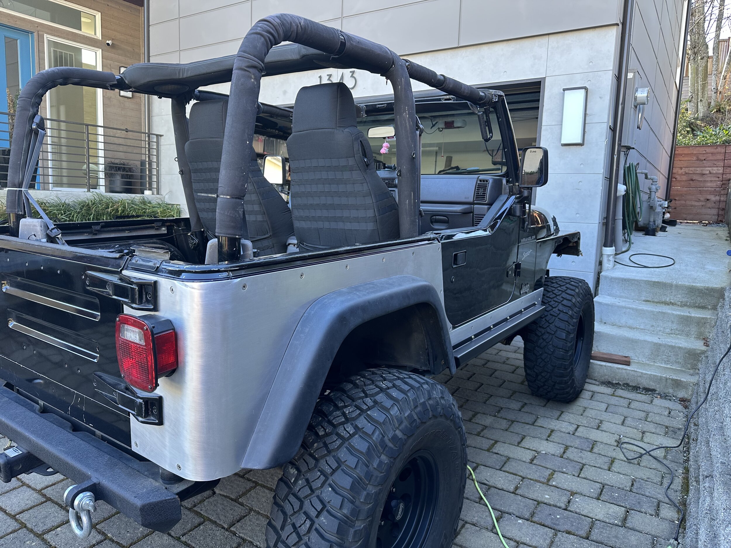

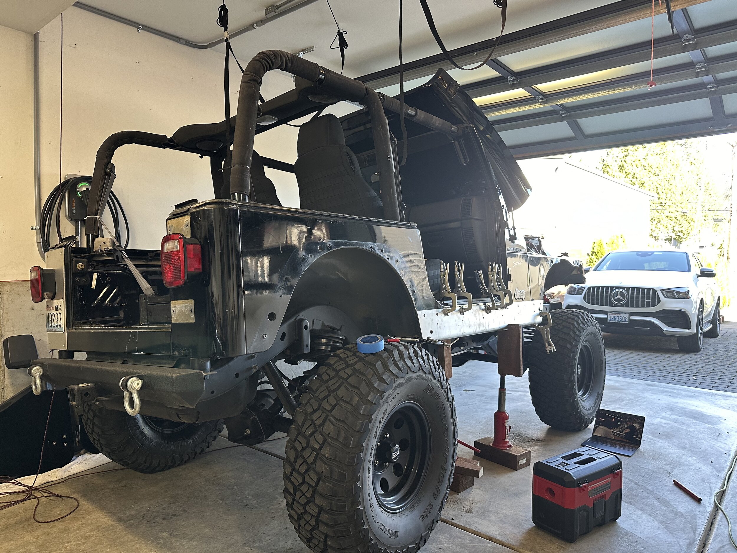

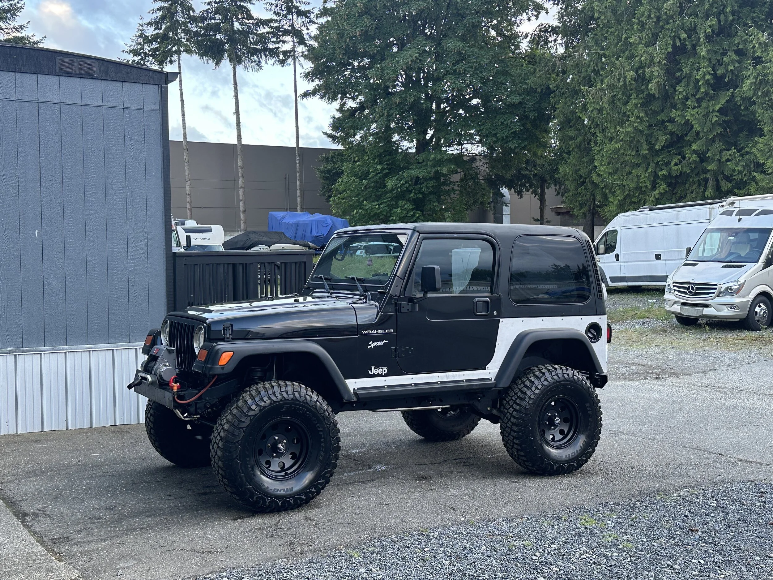

Finished up the rest of the armor install this sunny weekend..

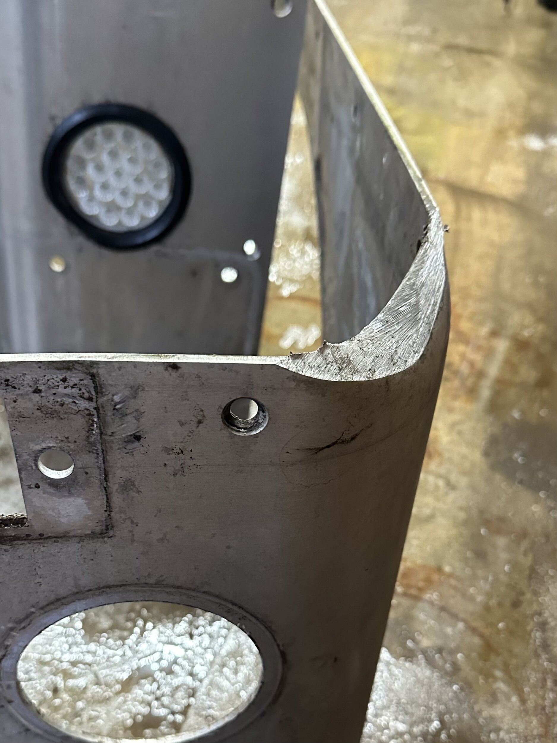

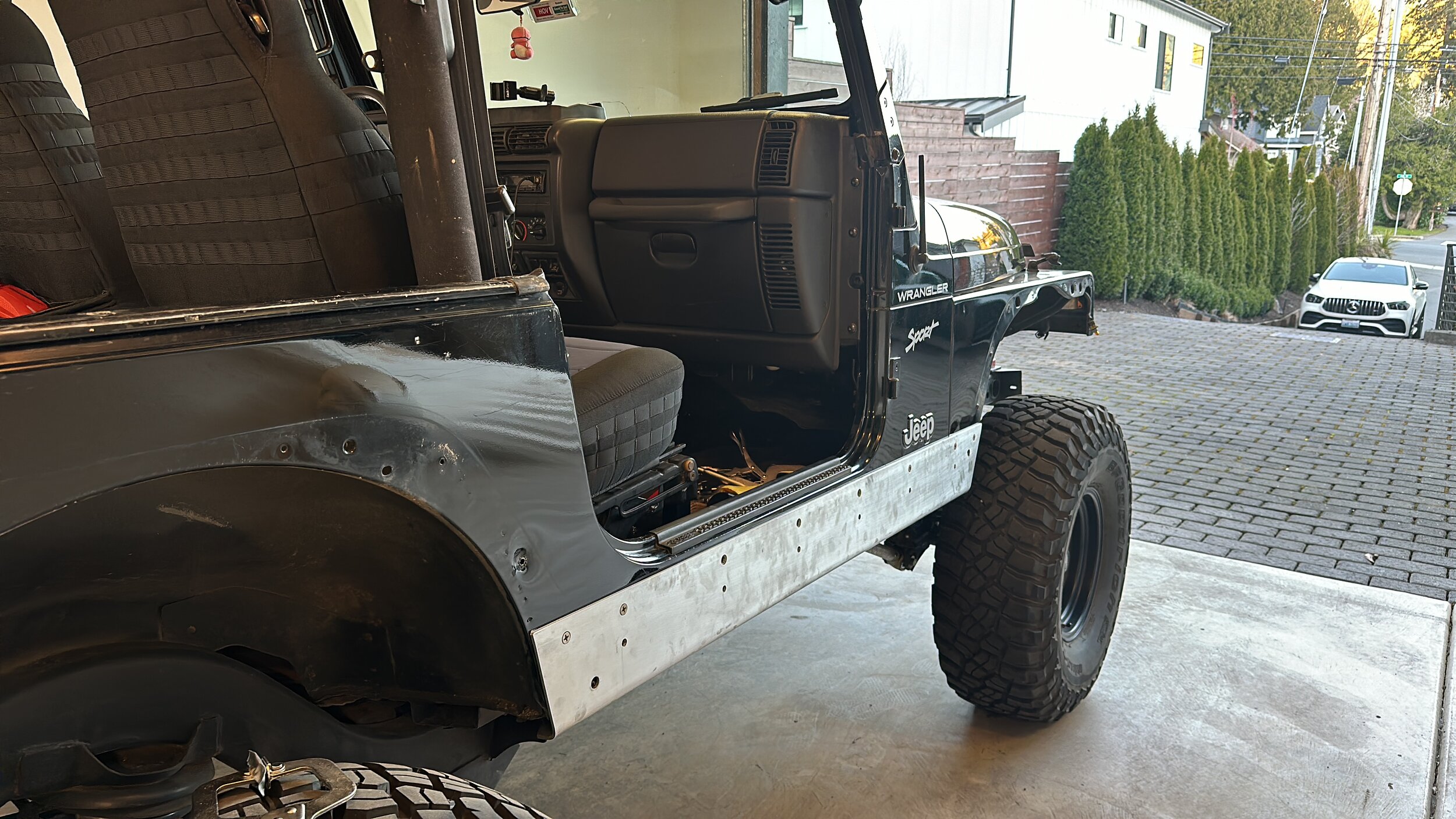

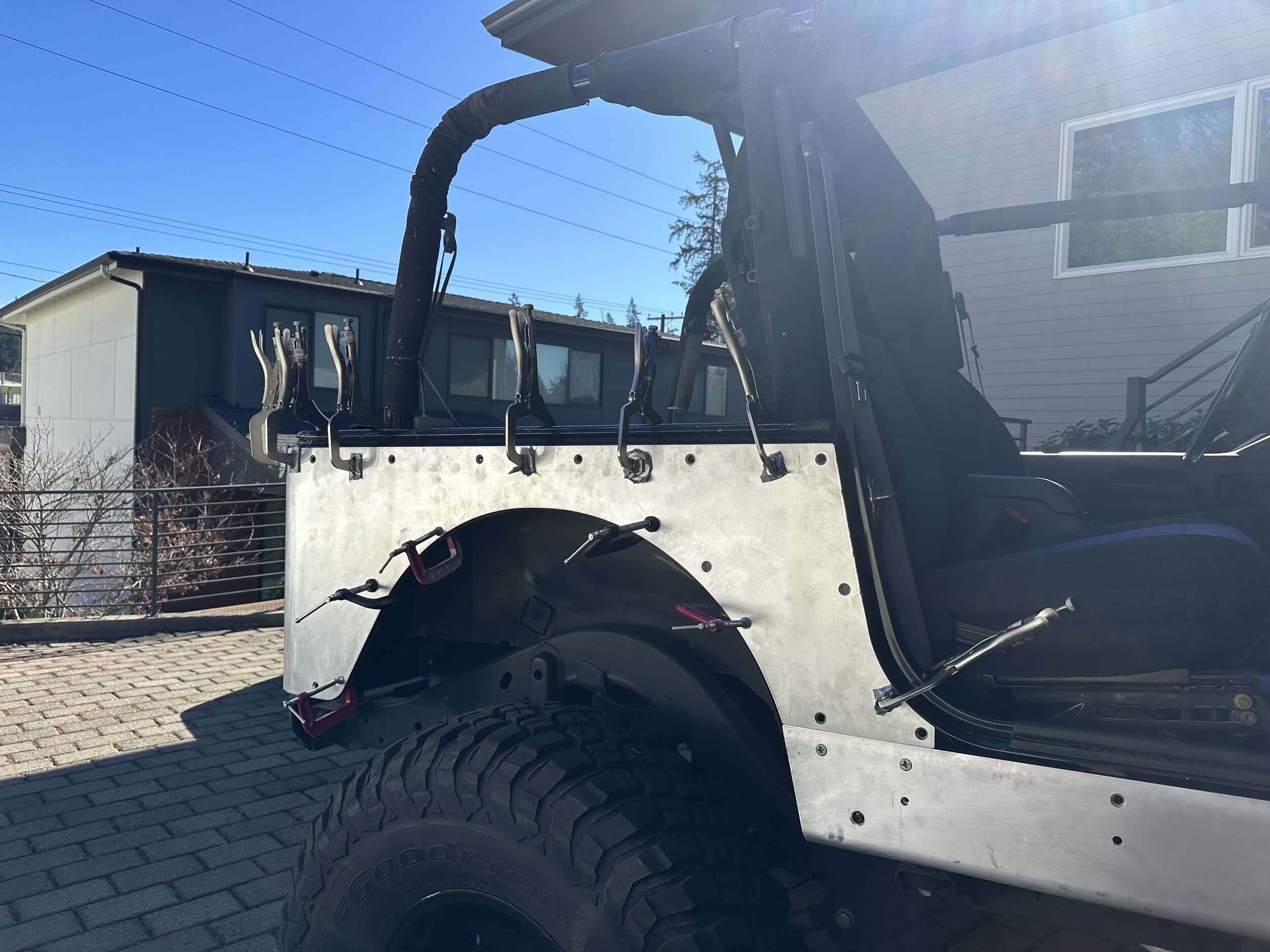

I expected this side to be a bit more time consuming given that my rocker panel on that side was out of shape and the corner armor had this in it:
I was able to get it straightened out pretty well, and given the price I got the armor for it is not a big deal
Started with the sliders
Then onto the corner

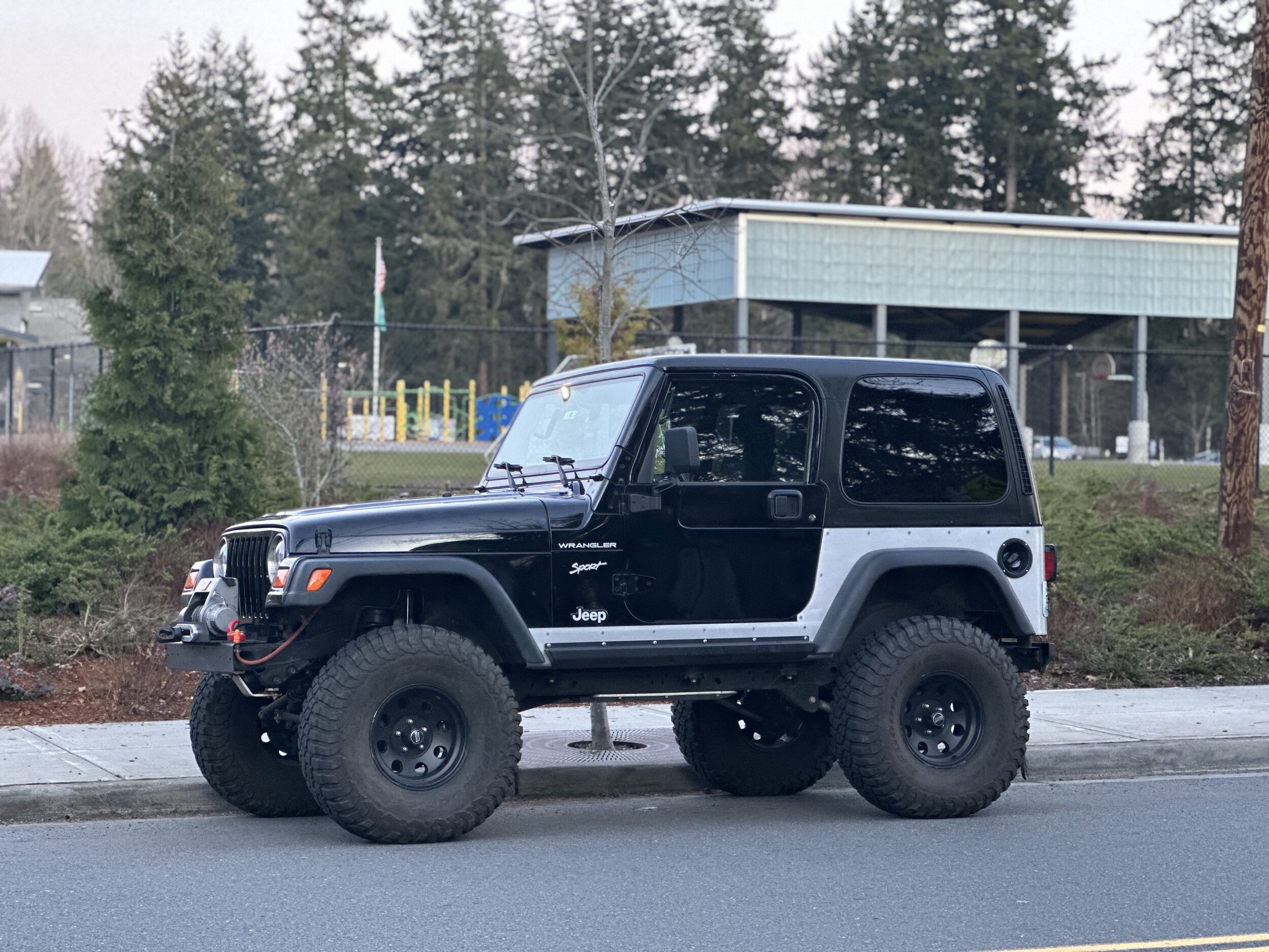

Overall came out pretty well, the damage to the corner is not too noticeable
Happy with how the rig is sitting currently, just need to get that HP in!

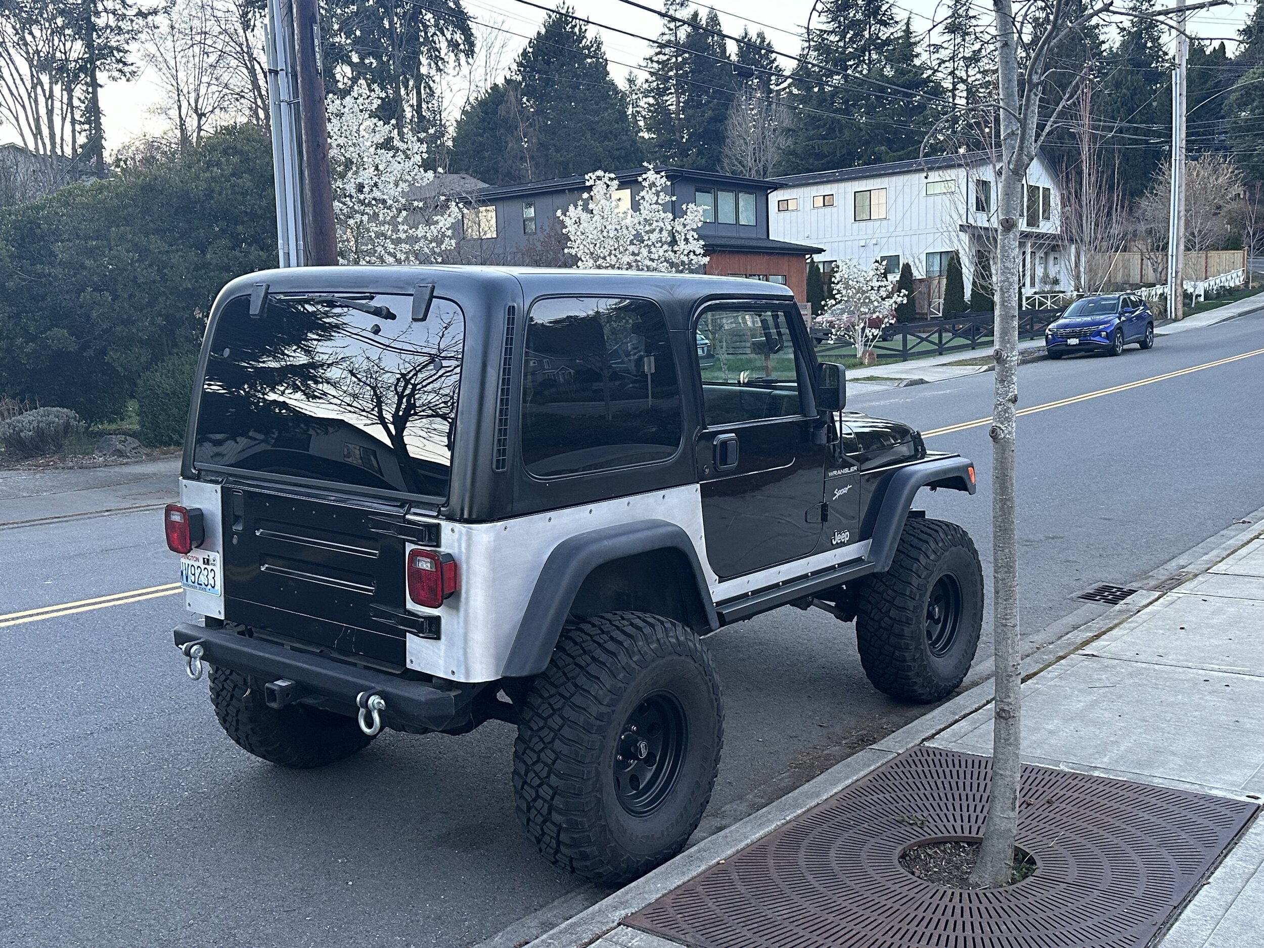

(Also traded my tan hardtop for a black one)

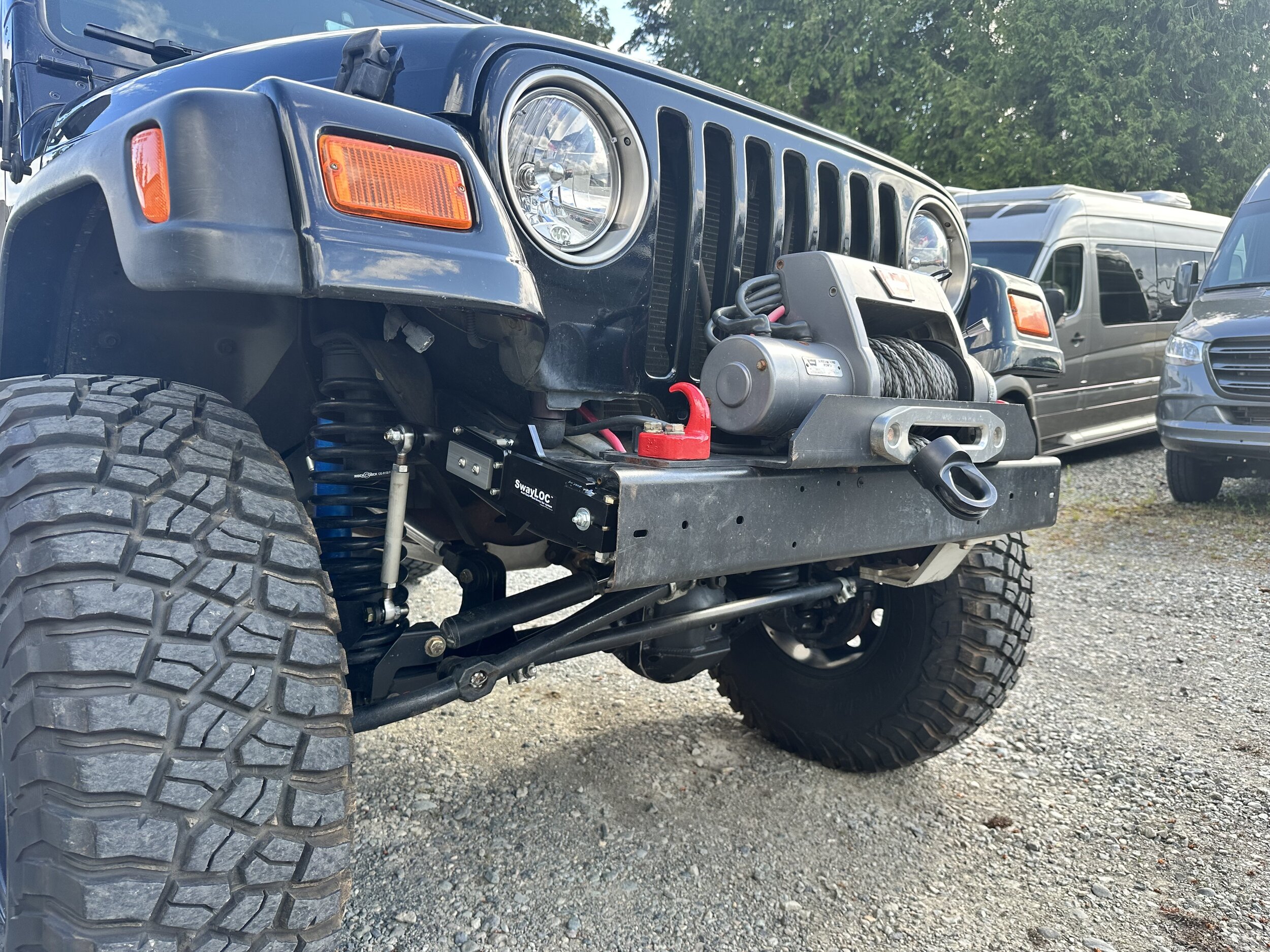

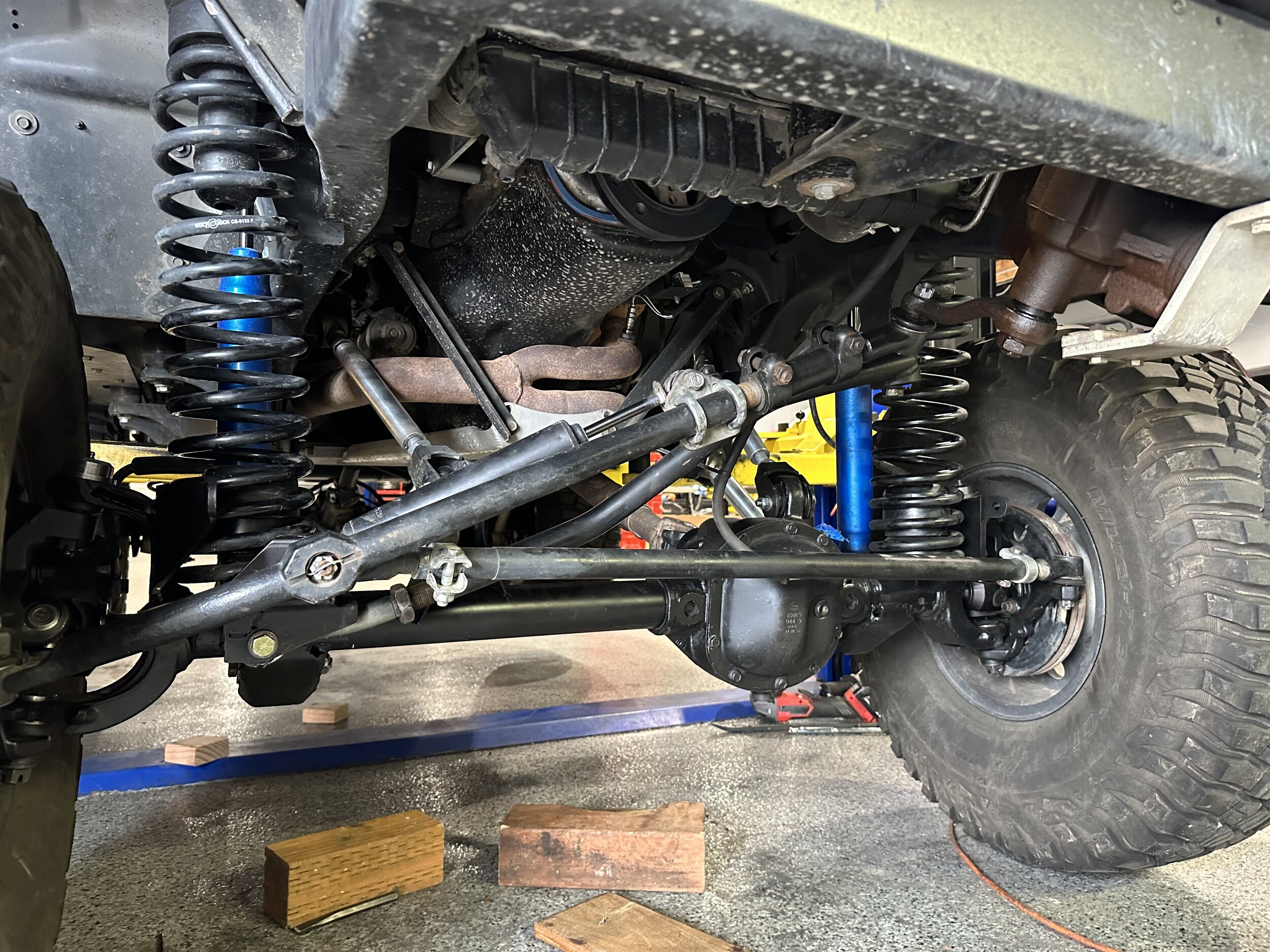

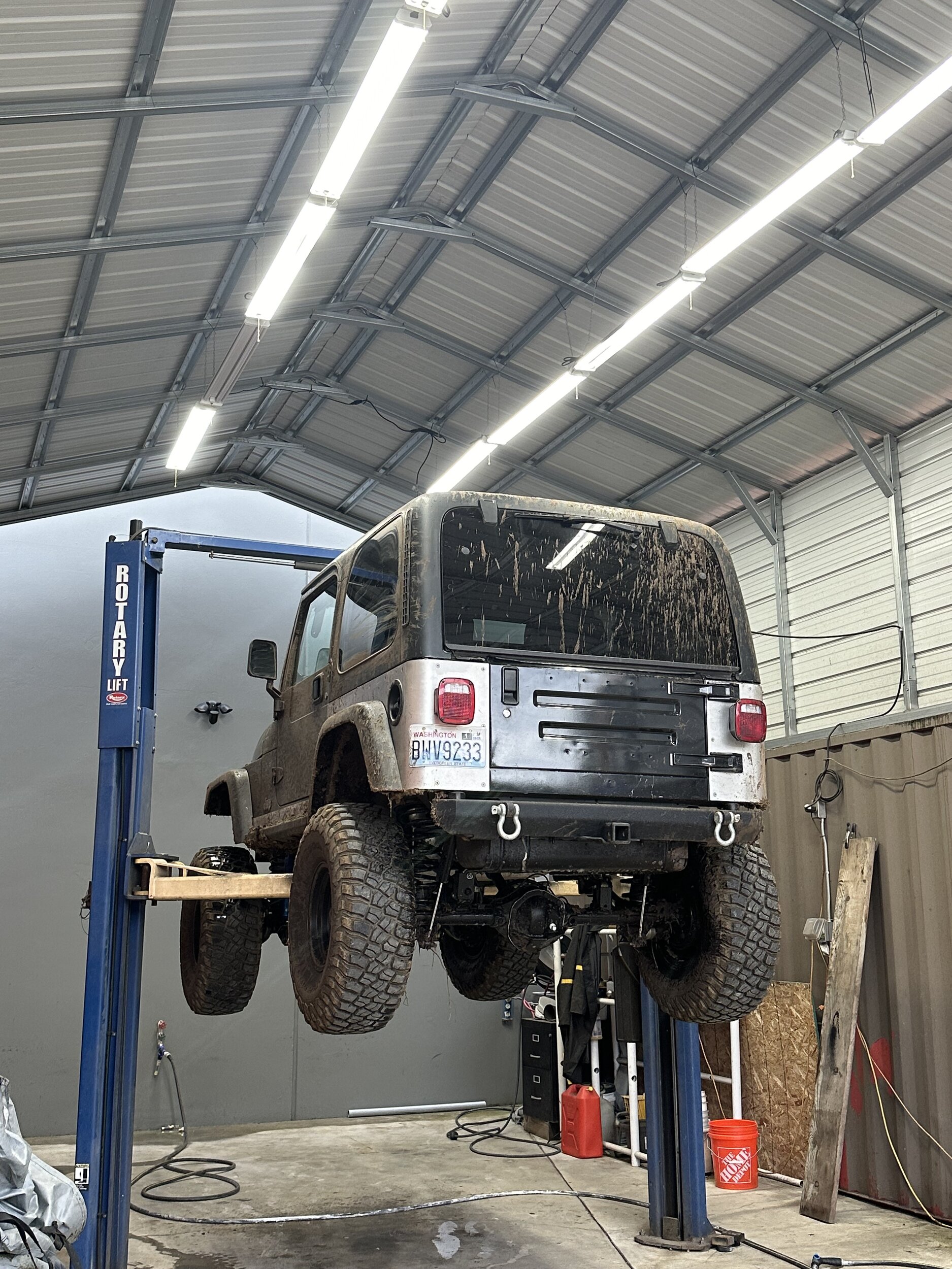

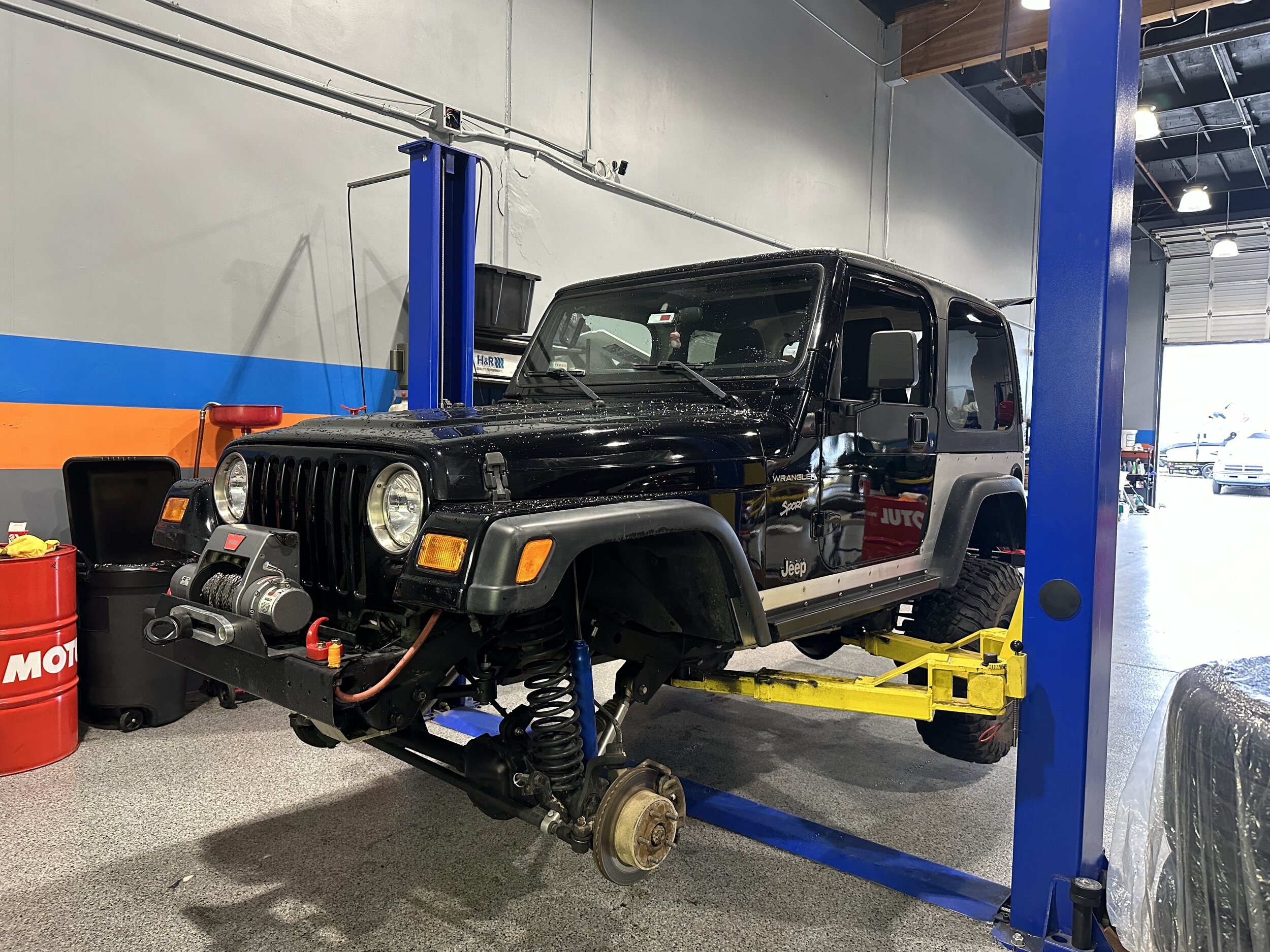

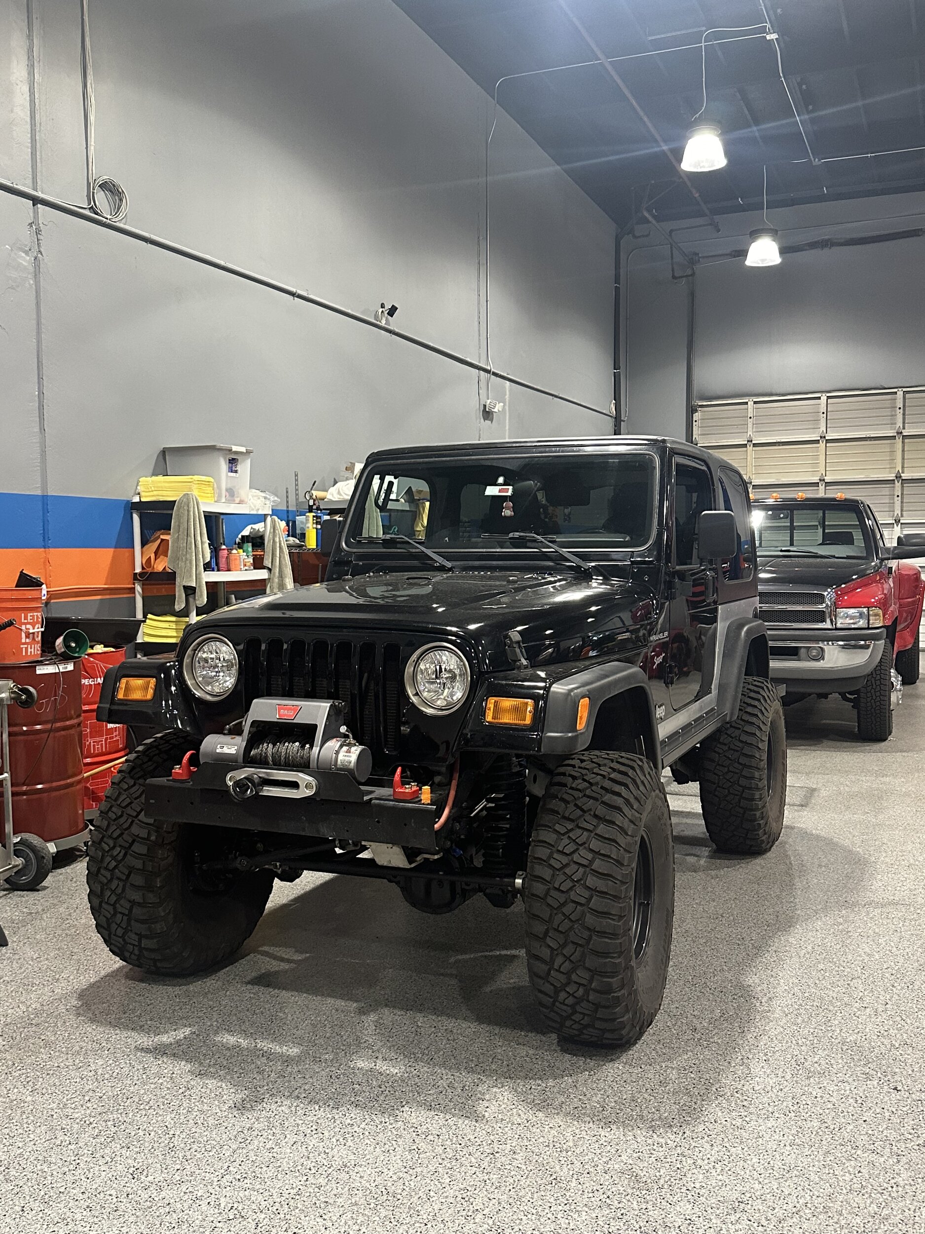

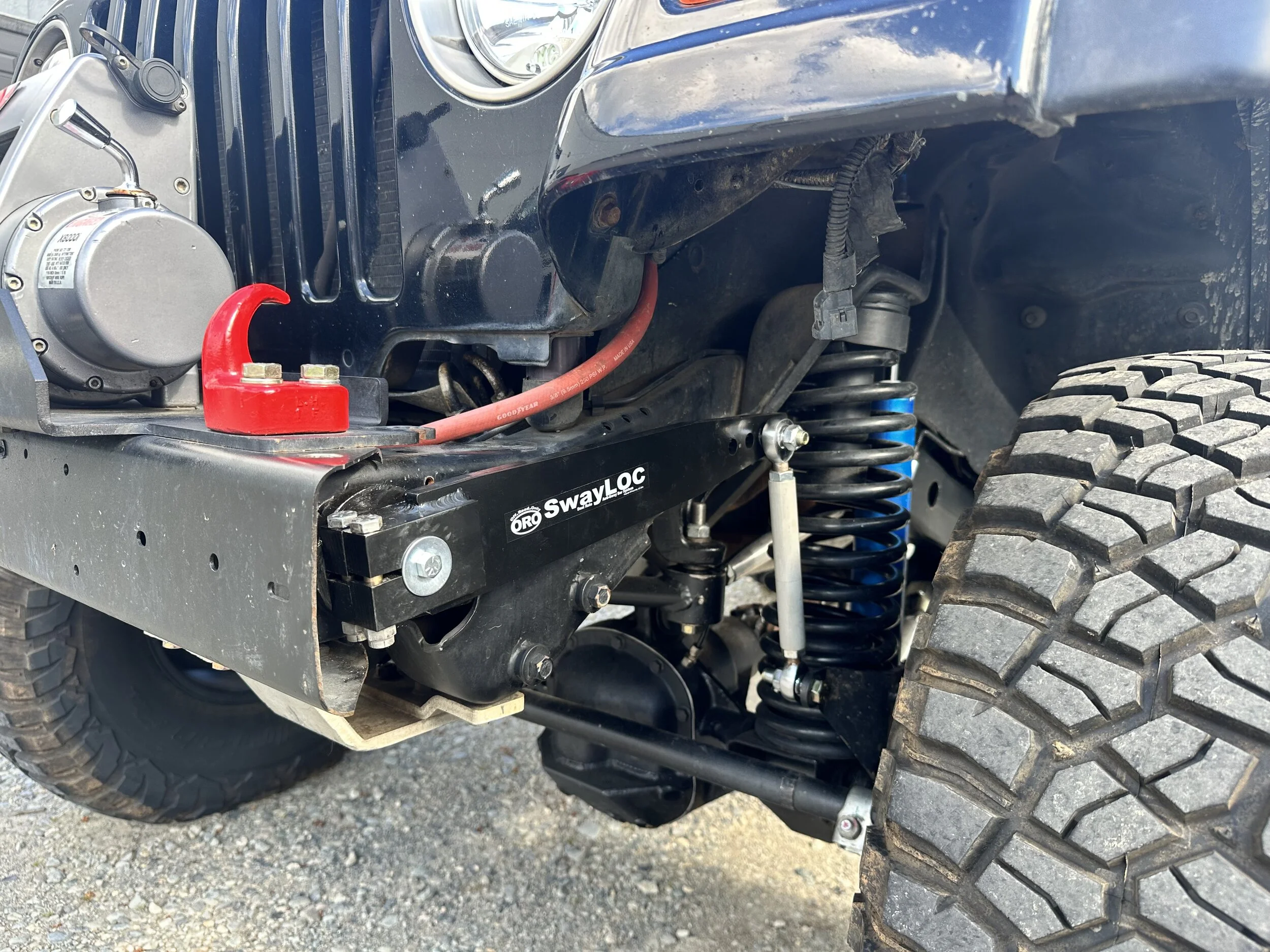

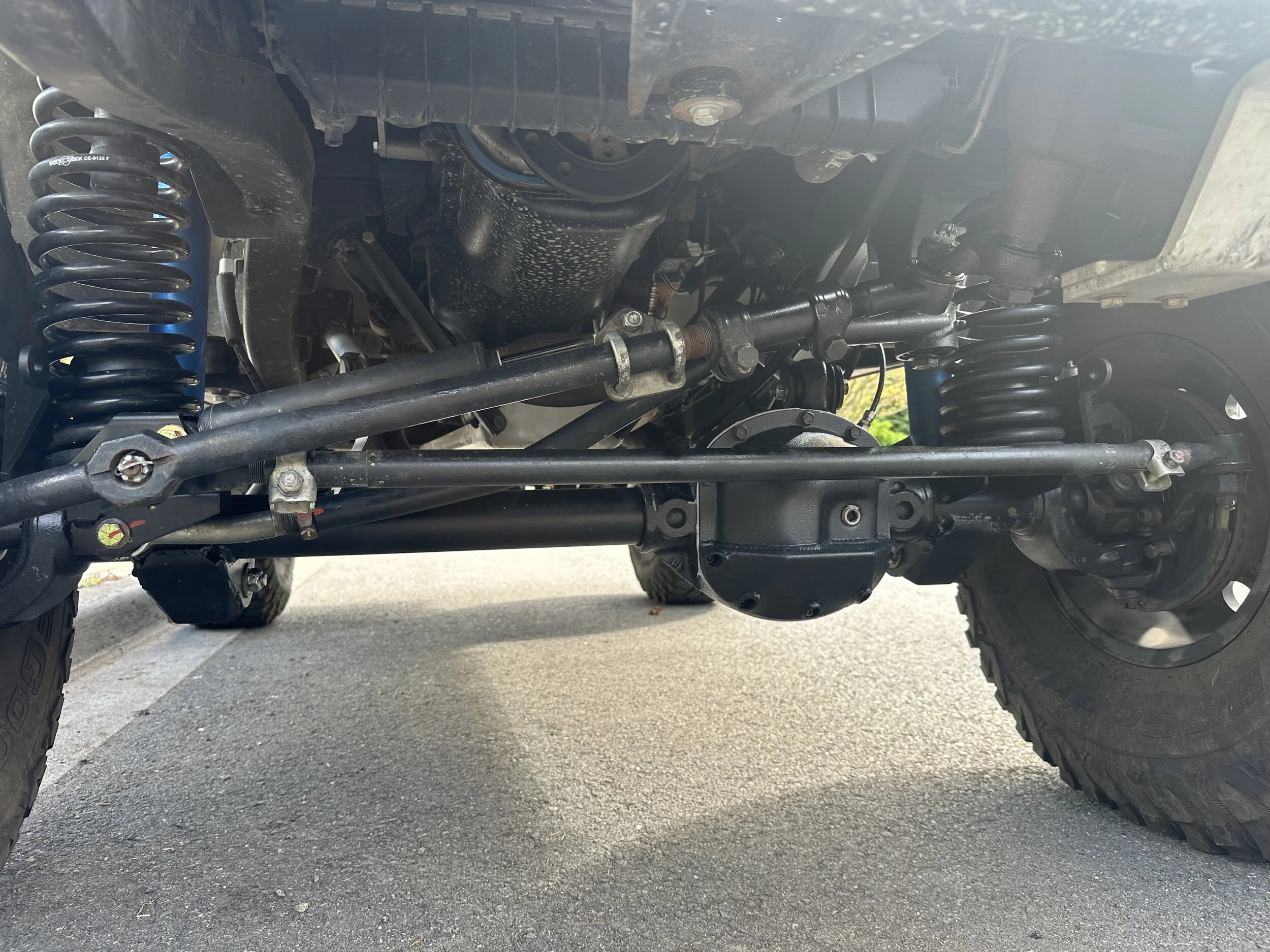

HP30 is installed!
Alignment has been done, now to finish the break-in period and hook up the lockers
(swayloc has also been ordered!)
Very nice job sir 👍
Thought you had ordered Barnett diff covers?
Sent the axle to get re-geared with the stock cover so they just sealed it back up with that. At the 500 mile fluid change i’ll swap to barnett, then you can guide me through reiter 😉

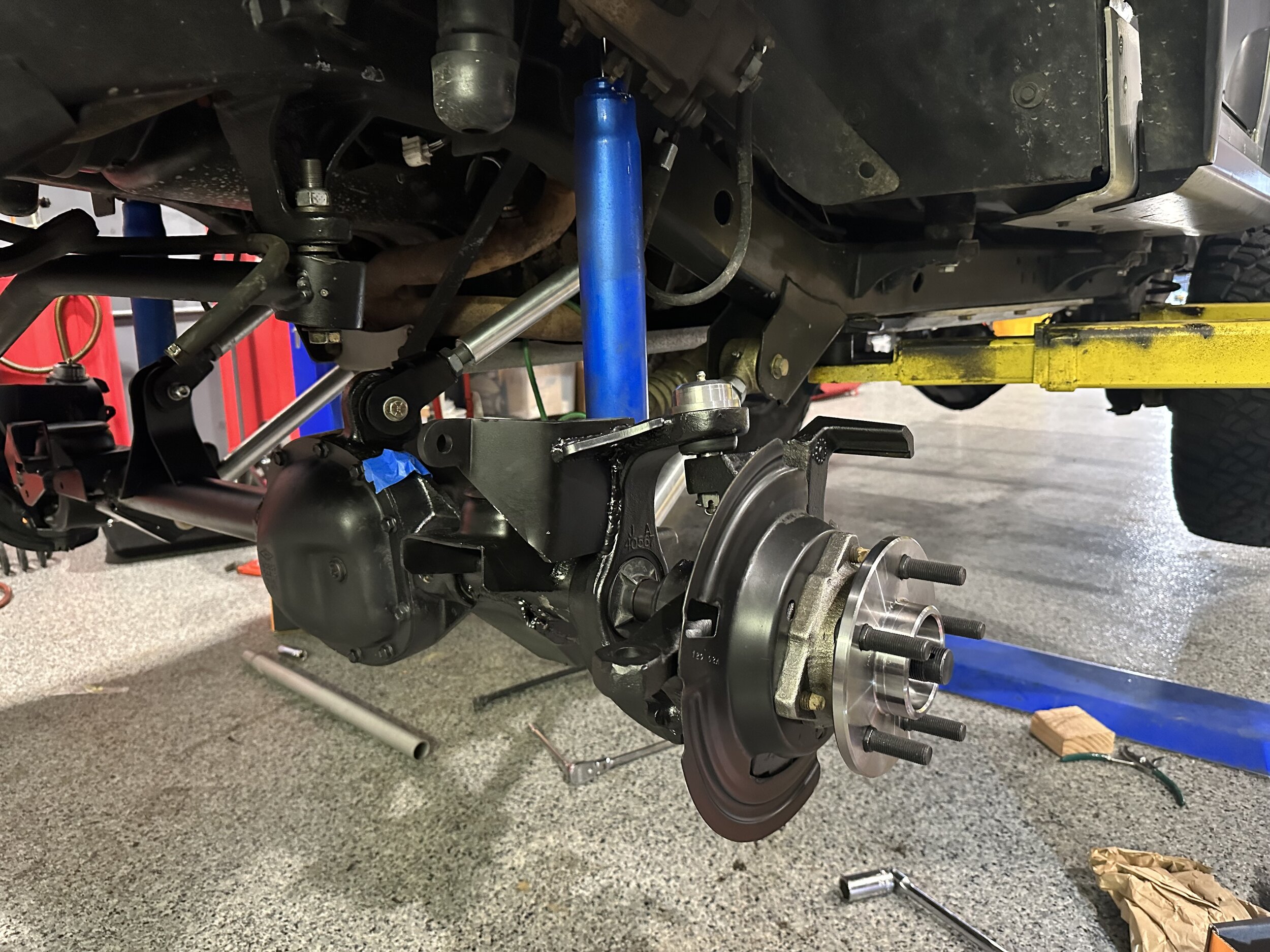

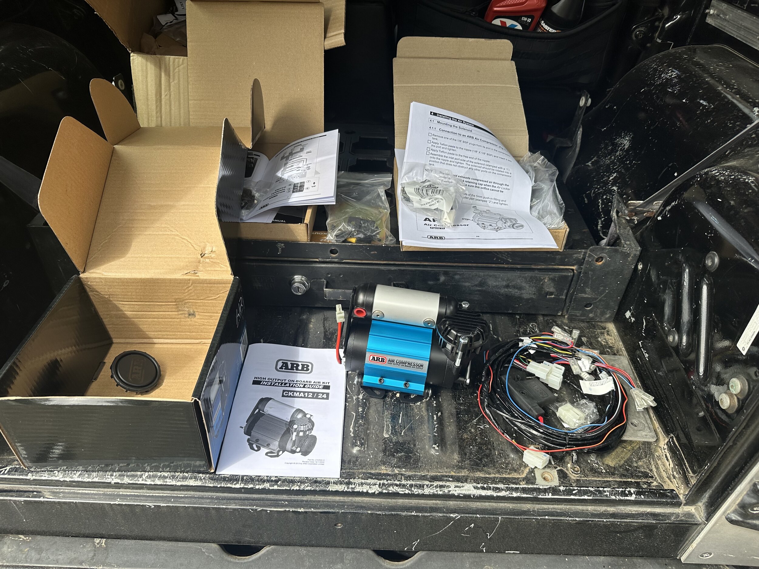

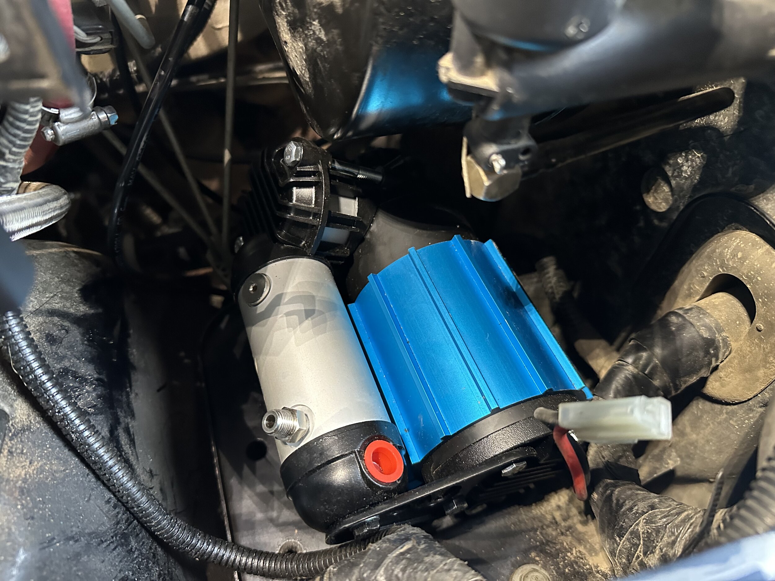

In other news, got the barnett cover done for the front

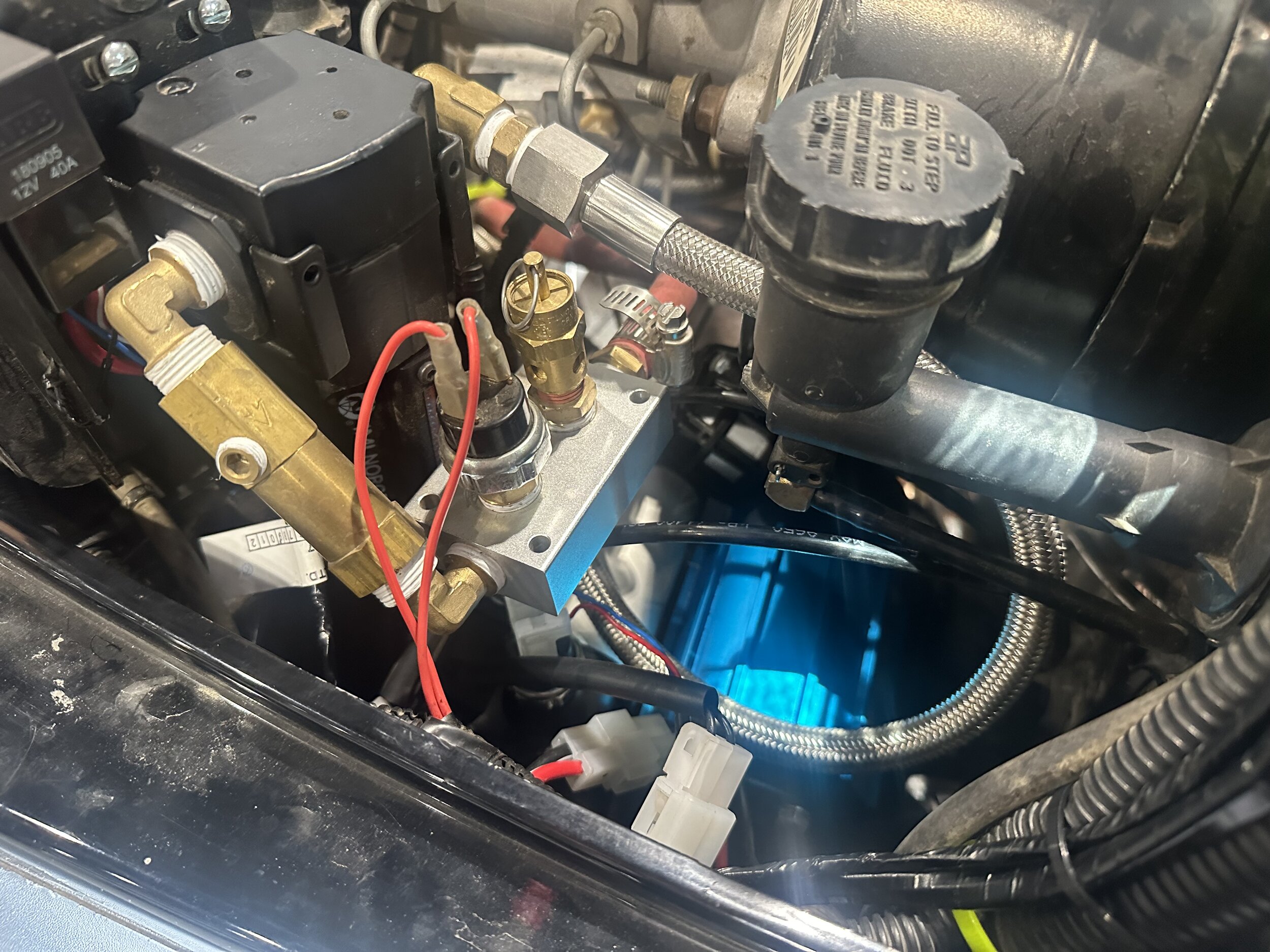

And the ARB’s fully hooked up, not much room to work near the compressor but at least it’s tucked away
