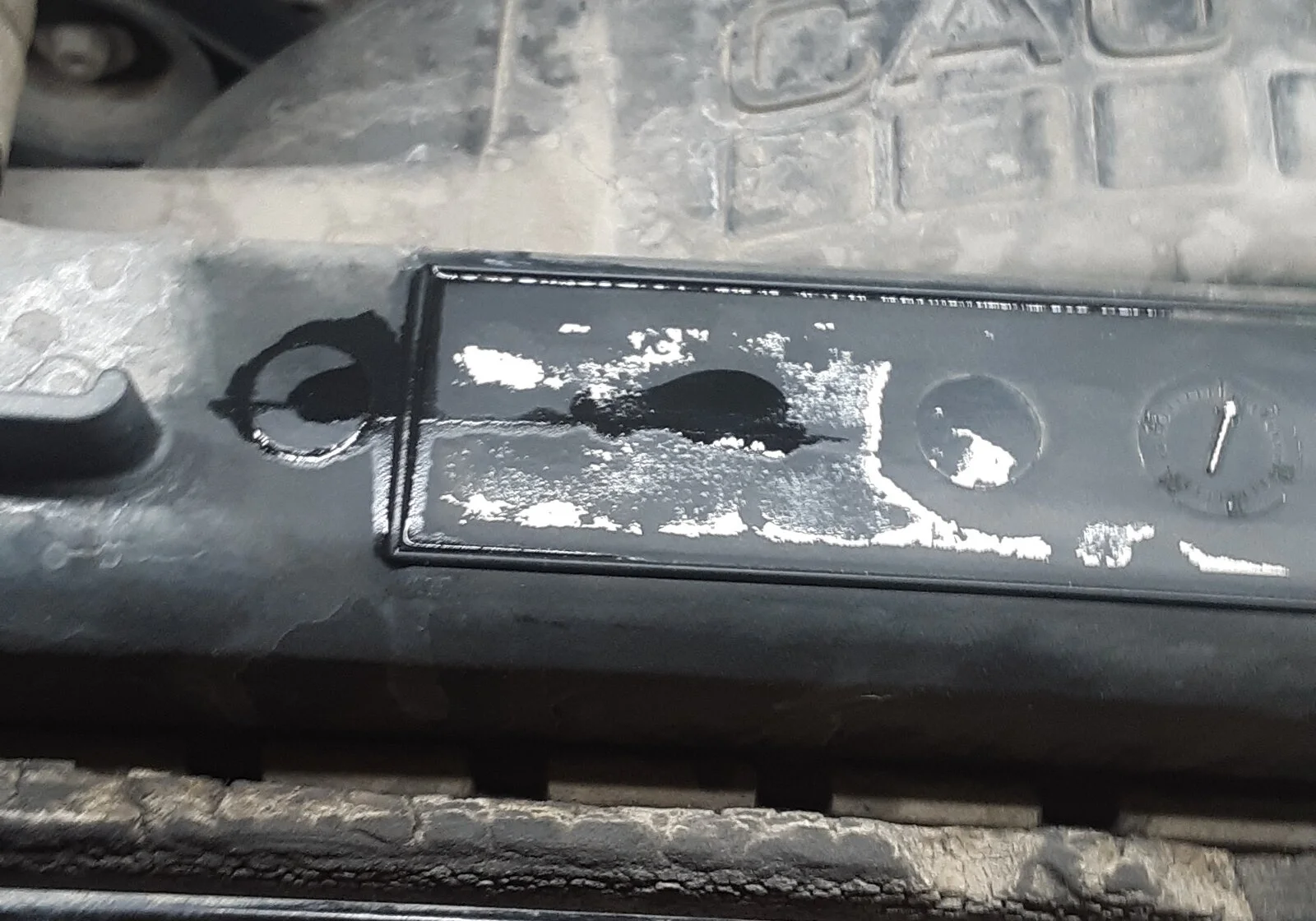

14 yrs.old, 135k; mine just got a hairline crack through the date code. Didn't notice it till the day after a 16 hour drive, which included some offroading. Emptied the overflow bottle, but the radiator was still full, so it never ran hot. Not blaming the long drive, I've done it many times.
Exact spot where mine went. You should toss a debate bomb into the chat and wonder aloud whether to go OEM or aftermarket for the replacement

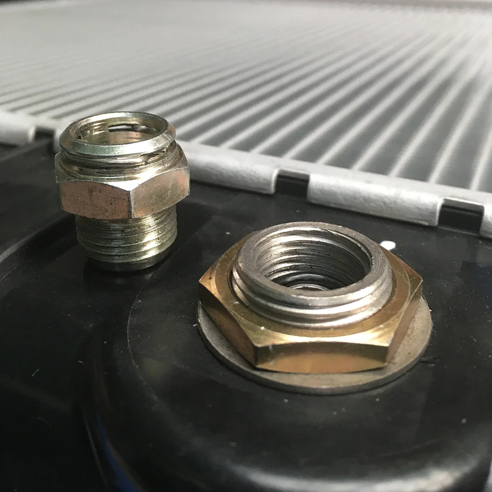

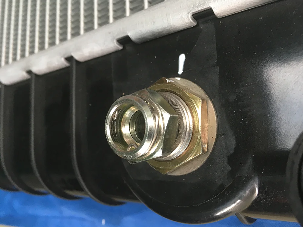

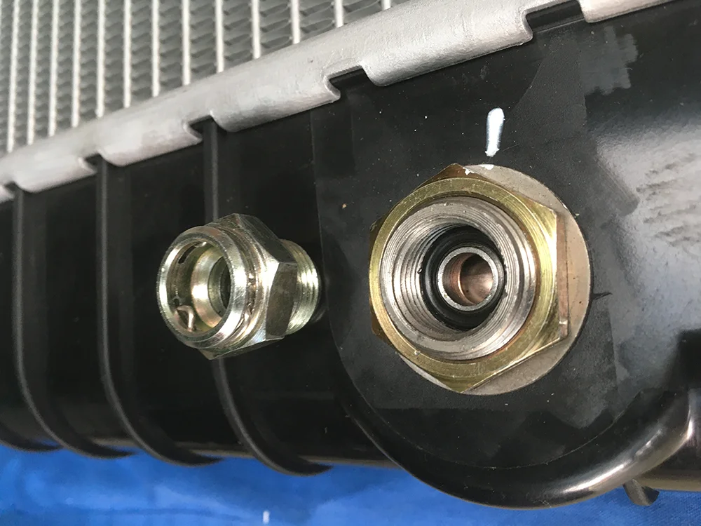

I’m in the process of putting in a new radiator and I have an issue with the transmission coolant attachments. The replacement radiator already had the same connections that are still on the trans connections. I want to take out the ones on the radiator so that I can hook up the old ones still attached to the trans hoses. What size wrench to use? The old ones came out but these new ones are so tight that the same wrench is just slipping off.
You shouldn’t have to unscrew anything, pop out the quick disconnects and pop them in the new cooler.
