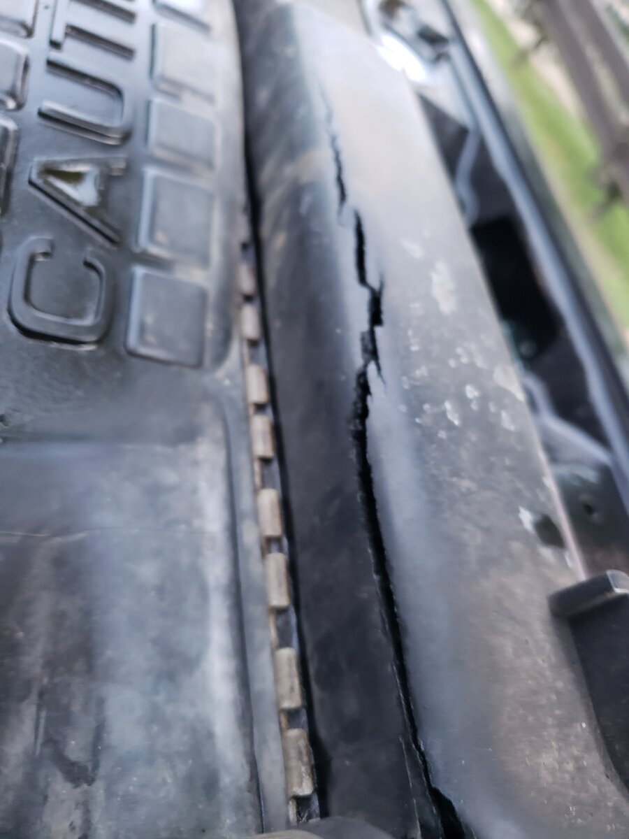

My radiator just cracked last night and I purchased a warranty on my 99 jeep wrangler sport last year when I bought it. Should I have it replaced with my warranty or do the work myself? I enjoy working on my jeep but I seem to be having trouble finding a mopar radiator. I used the links provided but it says the radiator won't fit my jeep. Thanks guys! I attached a photo of my radiator too.
Another example of similar issues with OEM radiators. Thanks for posting. This is the same location of my current issue with my 2006 radiator.
