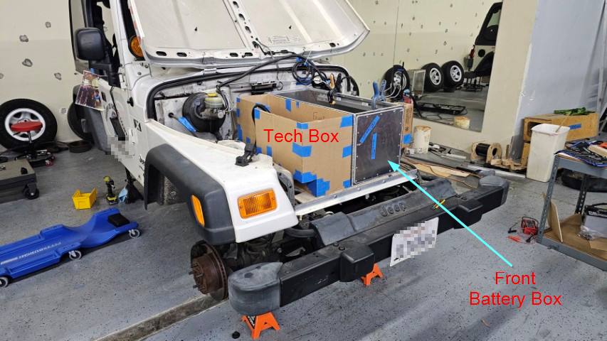

Alright, so where I am in this build is here, working on the Tech Box, here it is.
If you go back a couple pages, I put a basic diagram of the Interconnects (this usually refers to moving power, DC mostly, from point A to point B.).
This box will have the bulk of the LV (Low Voltage) wiring in it also. Things missing on the outside are the LV master Sw., about 6 flanged connectors to deal with Jeep stock PDC (Power Distribution Unit) wiring, maybe a fan to keep airflow in the Tech Box. Also, have to hook up the HV 'small' stuff - A/C, OBC-DC/DC Charger, internal Precharge.
The Tech Box, our first in this size/format, always takes a bit of time. All together, about 9,000 wires and connectors (slight exaggeration...).
I'll try to post updates with a bit more frequency.
- Patrick

Here's where the Tech Box is going to fit.

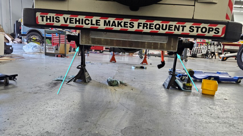

Have I mentioned that all EV conversion comes down to bracketing, never ending bracketing.... Here's a mockup of the brackets that will carry the HV Cables, 3 coolant hoses and the J1772 (charge port) harness from the back of the Jeep to the front where are the action is. One of the hardest things about making brackets is figuring out how it will actually assemble and fit in the Jeep. Many a brilliant design goes down in flames when you figure out that you've made it impossible to screw something to something around something connected to something that you didn't think about till now....why do bad thing happen to good people?!?
This design works, at least in cardboard and blue tape. I'll follow up when I make it out of AL (for all you crackers out there, 'AL' means aluminium AND Alabama, who would have thunk it!).
