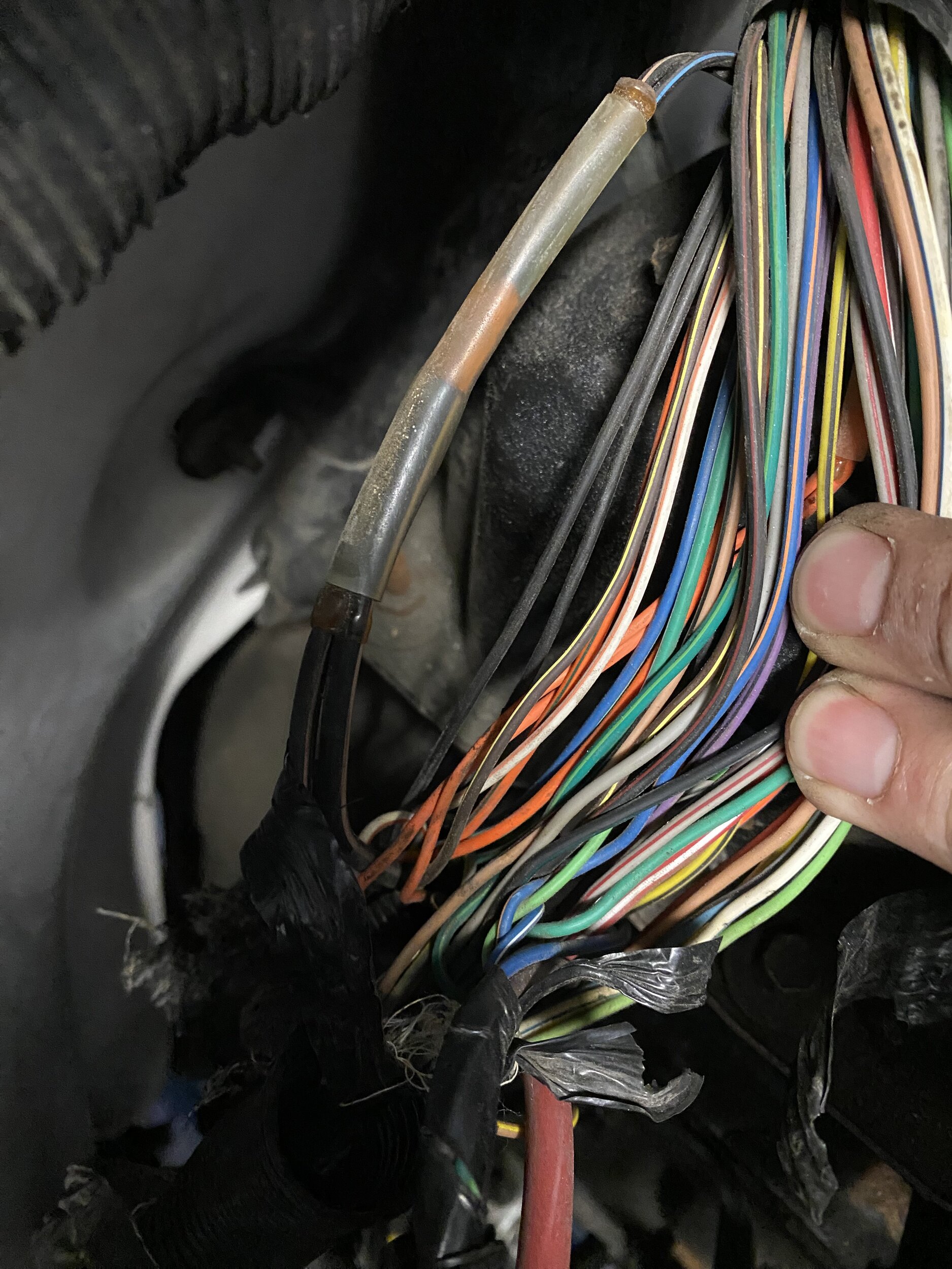

Is it orange inside the clear heat shrink from corrosion? Remember, that 0.77 ohm resistance is enough to drop the voltage at the relay coil and render it unable to switch the relay. All it takes is a little corrosion on the surfaces of the wire and splice to create a small bit of resistance.

Using visibility as a way to judge the quality of a ground is useless - you can't usually see ground problems where just a little resistance is created. You can't see voltage, current, or resistance, remember. The 0.77 ohms you tested tells me that it's an issue. The way ground problems work is that the resulting resistance can vary with load. The load a multimeter puts on the connection is extremely low compared to the relay coil (after all, if the load was high, the multimeter itself would affect the readings so much as to be inaccurate.) With more current, the resistance could be higher. That's why people often times use test lights instead of multimeters to find ground problems.

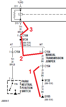

Using continuity. There are three sections of harness to test:
You'll find locations of the connectors, splices, and grounds in the Factory Service Manual (FSM). Use that to figure out where they are. I would start with Ground G105. If it's a ring eye screwed to the body, remove it, clean it and the body contact point up with sandpaper, and reinstall it. Then check continuity from battery negative back to the BR/LB terminal on the starter relay. If you have less than 0.1 ohms, that ground point was the problem. If not, you have to dig into the harness.
Check continuity on each of the three sections above. The little numbers next to the double-chevrons are the cavity locations in the connectors. Look up the connector pin-out chart in the FSM to figure out which one it is (you can also go by wire colors, which are also in the connector charts). For each of the three sections, or any combination thereof, you should get less than 0.1 ohms, meaning you have continuity. If you can pin it down to one (or more - maybe there are multiple problems) section of harness having resistance that's too high, then you have to look at each end, where the terminals are crimped, and within the harness, for damage. Find it, repair it, and you'll be golden.

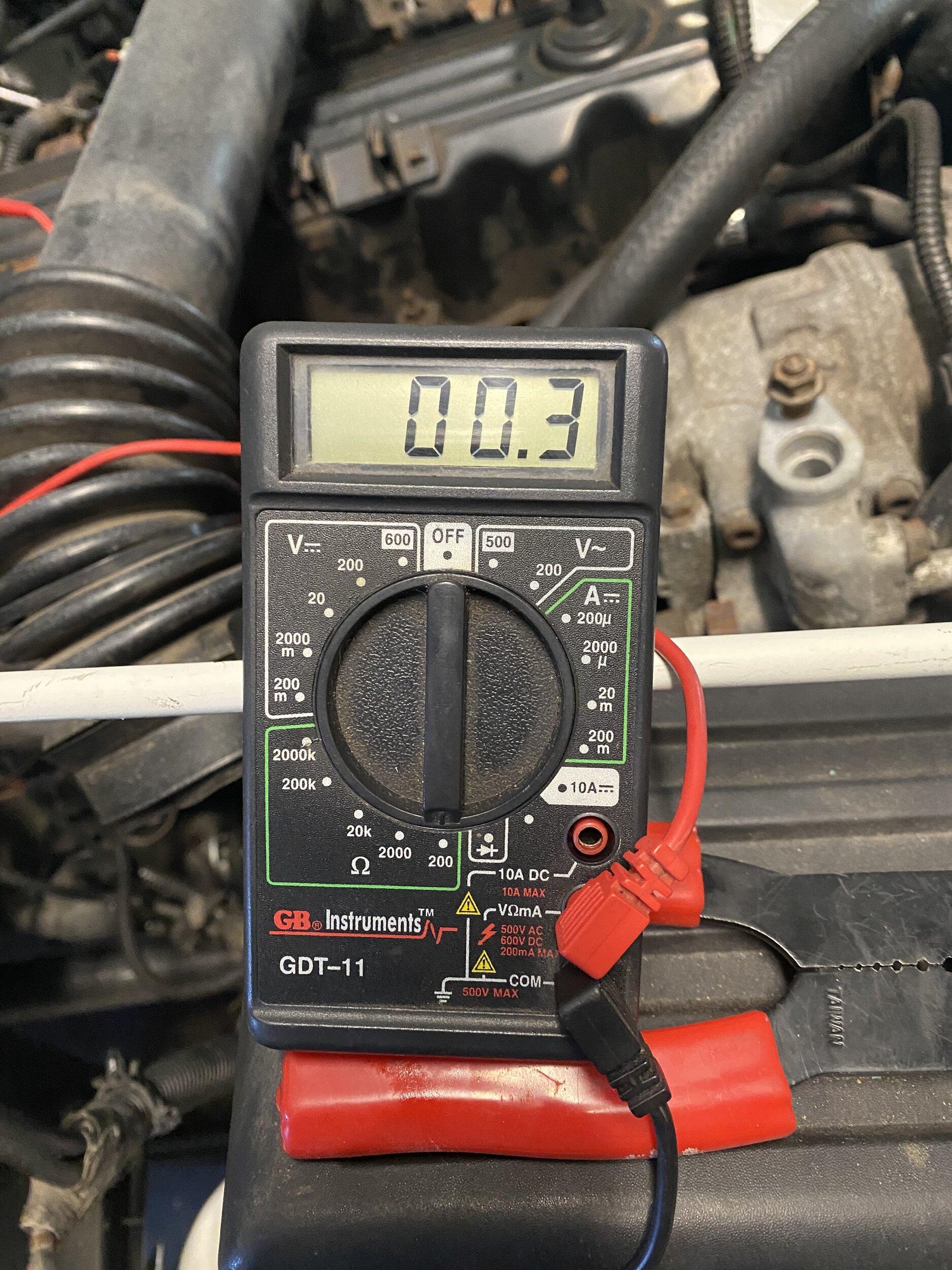

I tested it on my multimeter, and had to move the dial to the 200 ohm setting. The result was 0.4.
I cannot find what is meant by the C154 Manual Transmission Jumper. It seems it goes in as a black wire and comes out brown/light blue? I can't figure out how to test #2 in your diagram.
For #3, I tested it from the S134 connecter at the firewall to the starter relay. The reading again was 0.3 on the 200 ohm setting. Picture below.

I tested from G105 to C154 on my multimeter, and had to move the dial to the 200 ohm setting. The result was 0.4.

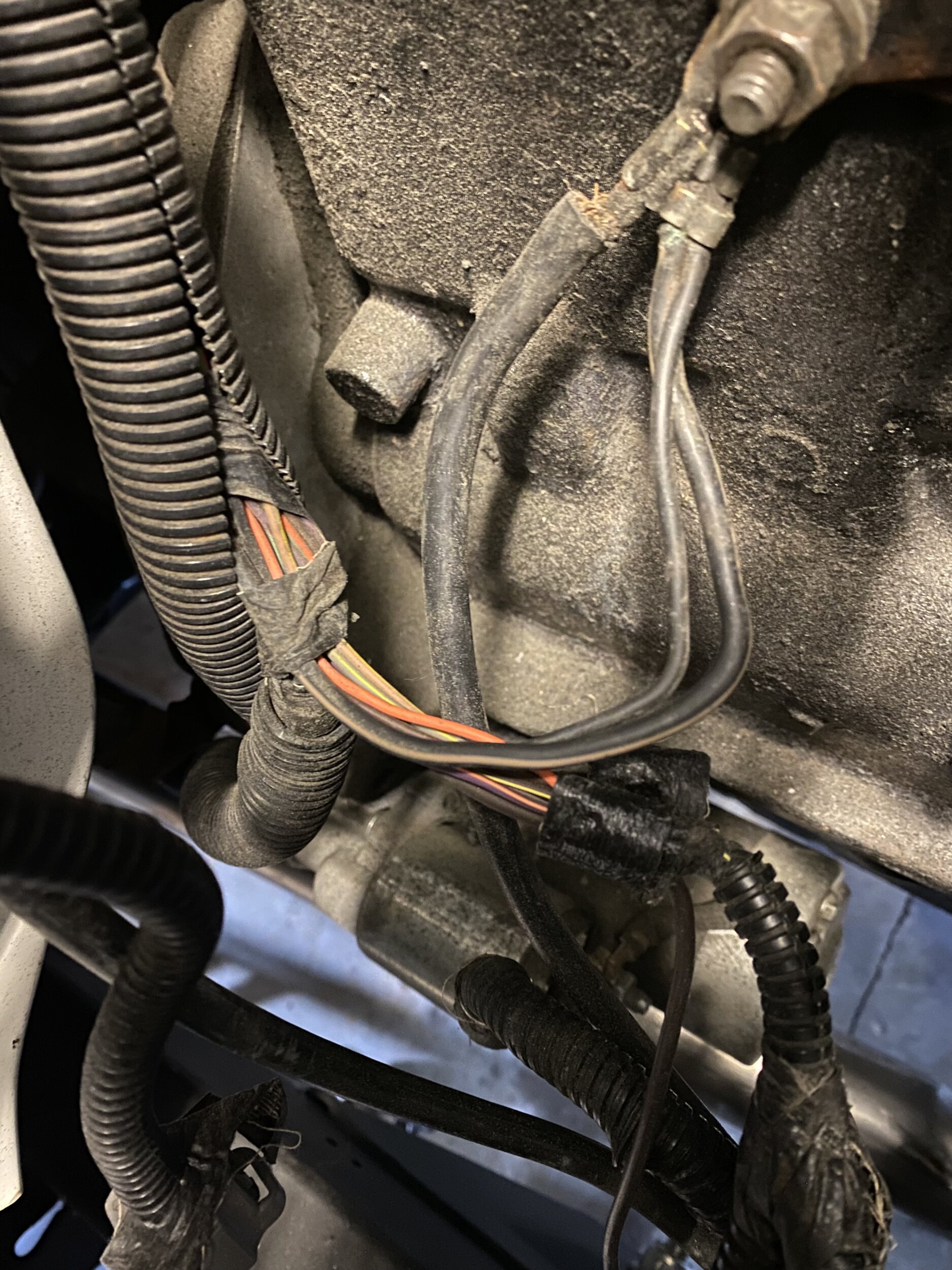

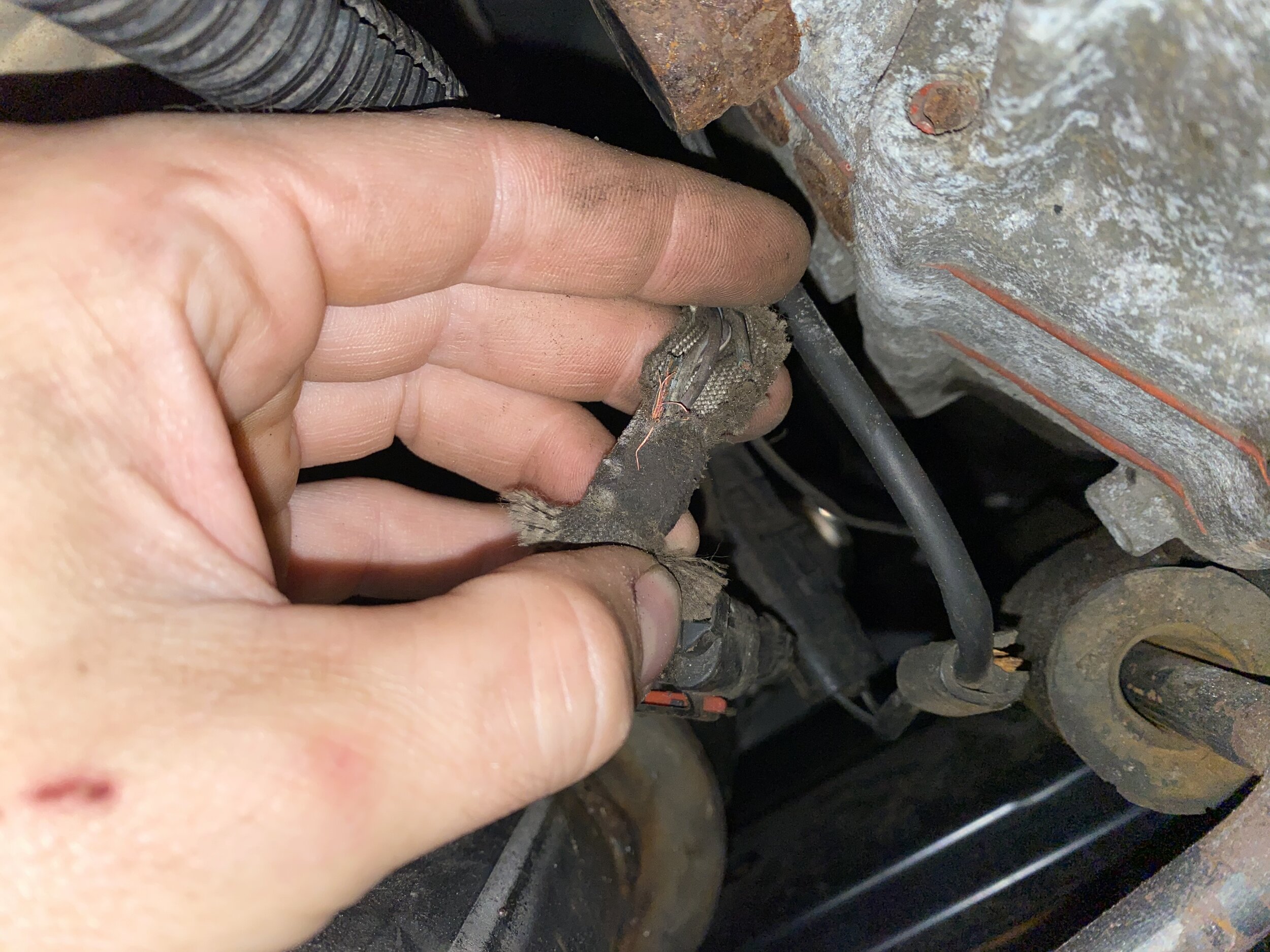

Well.... we're going backwards now. I fixed the broken wire by the trans, in what I believe is C154. I removed the ground cable that grounded G105 to the frame. Everything else should still be attached as it was previously, just de-loomed the wire harnesses. I couldn't start it up that way, so I reverted back to trying to ground the BR/LB wire of the relay to the negative post of the battery. That will not start the Jeep now. The only way to start it is to jump the starter from the battery...

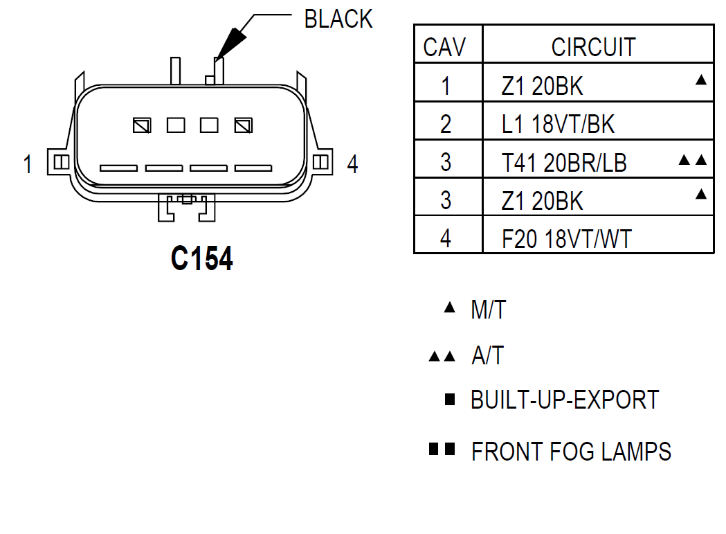

I can't tell from the picture, but looking at the pin out for C154, that section of the harness should have three of or four (more on that next) wires in it - one or two Black wires, one Violet with Black Stripe wire, and one Violet with White Stripe wire. Here's that pin out from the FSM:
I'm with you - if the black wire was broken, splicing it should have fixed you issue. The black wire is in the ground path for starter relay coil.
Side note - it seems that everywhere you turn, you're finding problems with that TJ. You've got your work cut out for you!
That's still seems like too much resistance to me.
I looked into that a bit yesterday. Go back up and look at the C154 pin out above. Notice that, for a manual transmission, both pin 1 and pin 3 are the BK wire. I believe that you'll find that one of them goes to G105, and the other goes to the other pin - like a Daisy Chain. That said, I have no way of determining why that is. I also have no way to tell what happens if that jumper (between Pin 1 and Pin 3) is broken. Test resistance from Pin 1 to G105 and then again from Pin 3 and G105. Also do it for Pin 1 to Pin 3. Report back with results.
In addition, you should pull all of the wiring from C154 to the break you repaired out of the loom and inspect it. Is there a short black jumper wire between Pin 1 and Pin 3?
S134 is a splice, not a connector. Harness section #3 goes from the PDC's starter relay socket to Connector C104. Splice S134 is located here:
I was writing my response to your previous post when this came in and sometimes if I look at new posts, I lose my work in progress (the previous post took nearly an hour to research and send). I didn't read it until I posted that last post.
If your jumper from BR/LB on the relay socket to Batt Neg no longer works, the most likely cause is that your "repair" actually connected two wires that weren't meant to be connected (you can always cut it and try your ground jumper again to confirm). I can't tell from your photo whether that's a possibility or not. However, as I said in my previous post:
Note my edit - "of" was supposed to be "or"
I can't tell what color the wires are in that photo of the broken wire, and they look to be very dirty. Can you confirm what wire colors run from there to the connector? And, like I said earlier, confirm that there is a jumper from Pin 1 to Pin 3...
