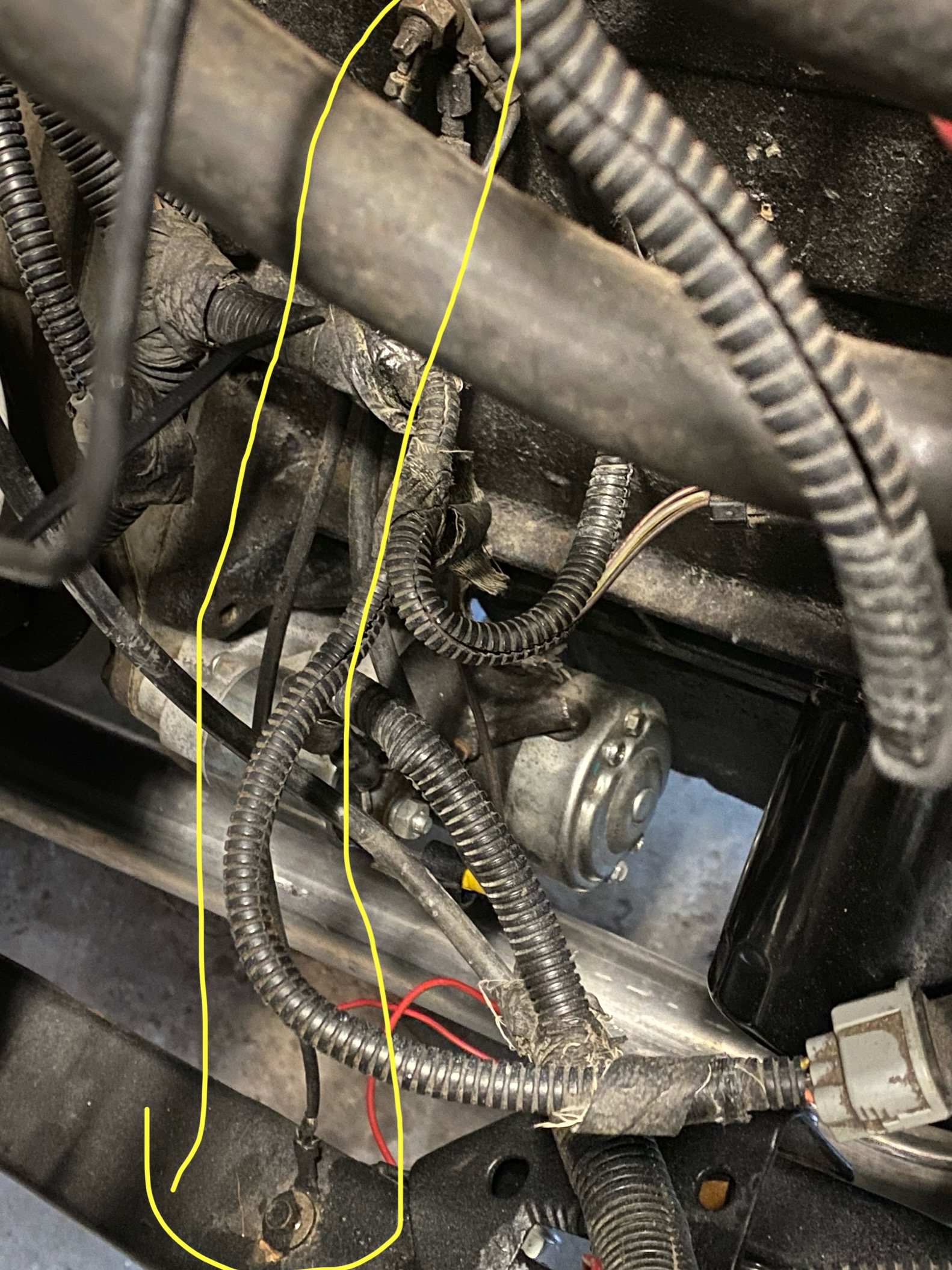

Really? That's strange. The Jeep I bought originally had a ground wire running from the G105/G107 location on the block that Sab pointed out above to the frame rail. The frame I bought had a ground wire screwed in further up that attaches ahead of the distributor. Everything else was stripped from the frame, but that was still attached. Are you saying that both of these were not supposed to be there?
With the body lift I installed 1" engine mount spacers which have torn the ground wire off the frame now anyways as the engine moved while running, and the wire was pulled very tight. So it's no longer connected anyways. But I'll put the picture below to show how it looks.
Nope, no ground to frame. If you look at a factory ground cable, you should have two big wires from the battery terminal, one to the tub, and one to the engine block. Those are your main grounds. If you're trying to start your rig through a ground that run through the frame then through any other incidental contact from the frame to the tub, that will give you a high resistance connection.
That’s wild. I wonder how this this was starting before with it grounded like that. And why anyone added it. The wiring for the headlights was a mess. So I’m not surprised that this was too. I guess people really will do anything to keep a car limping along.
You probably wound up with a frame from a 97 which is the only year I've seen that ground wire on.

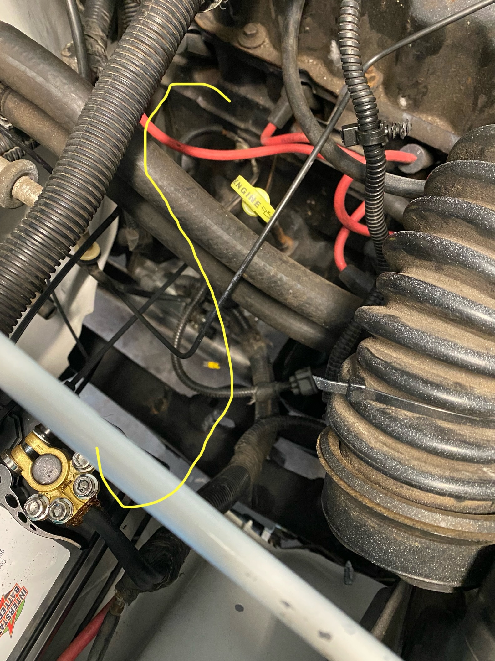

There were three connectors. One of which ground to the frame. Now there are just the two you mentioned previously that are needed. One of which grounds to the battery. I drew the path next to it so you can see how it runs without scribbling over the wire.

Both my 97 frame and the 99 4 cyl frame both had ground wires running from the engine to the frame. 97 was the G105/107 location and the 99 was just forward of the coil where the Alternator grounds. Definitely OEM wire. Not a heavy gauge wire either... maybe 8 gauge.
I don't use that type of battery terminal (that clamp the bare end of the cable) anymore. Over the years, I've had all kinds of trouble with them being able to transfer high current loads. I'm not saying that's your problem, but I'd crimp a ring terminal on the cable and use a screw terminal connection at the battery.
Just for grins, try connecting a jumper cable from battery negative to anywhere on the engine and give the key a turn. That will ensure that that cable is not your problem. Then, as you said, you'll have to start digging into the three sections of harness I mentioned earlier.
