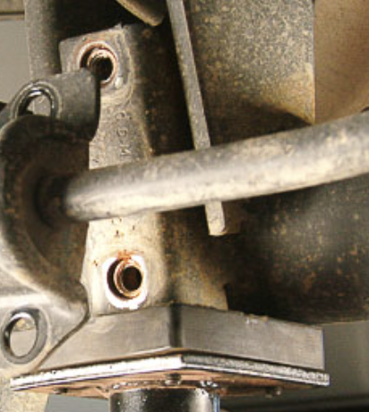

The rear sway bar nuts on the axle housing. 1 was missing when I purchased. and the other 3 are completely shot. The threads are completely torn up.
Looks like previous owner put wrong bolt in and then was able to get it out before reselling to me. I would like to remove the last 2 nuts. I would prefer to remove the nuts entirely because of how beat up they are. I thought about trying to retap the threads but with how much paint is in there (from the "prep" work the previous owner did)....Id rather just start fresh.
Ive attached a picture I found on this forum showing exactly what I am talking about.

Personally, if they're not all rusted, I'd repair the threads by either running a tap through them (if they are only mildly messed up) or by installing a Heli-coil or other thread insert (if they are really messed up). Breaking them off would be my last choice.
Pneumatic chisels are a thing, if you really want to commit to chiseling them off. It's a pretty fun tool...
Yeah.....they arent horribly rusted but are pretty shot. Maybe I can tap the last 2. Its worth a shot I guess before I break them off.
Have you used thread inserts before? They really are a great option for your situation, and it might be worth trying it, just for the learning experience.
nope. Extent of anything tap/threads I have done is for some bump stops and tailgate hardware.....nothing like this

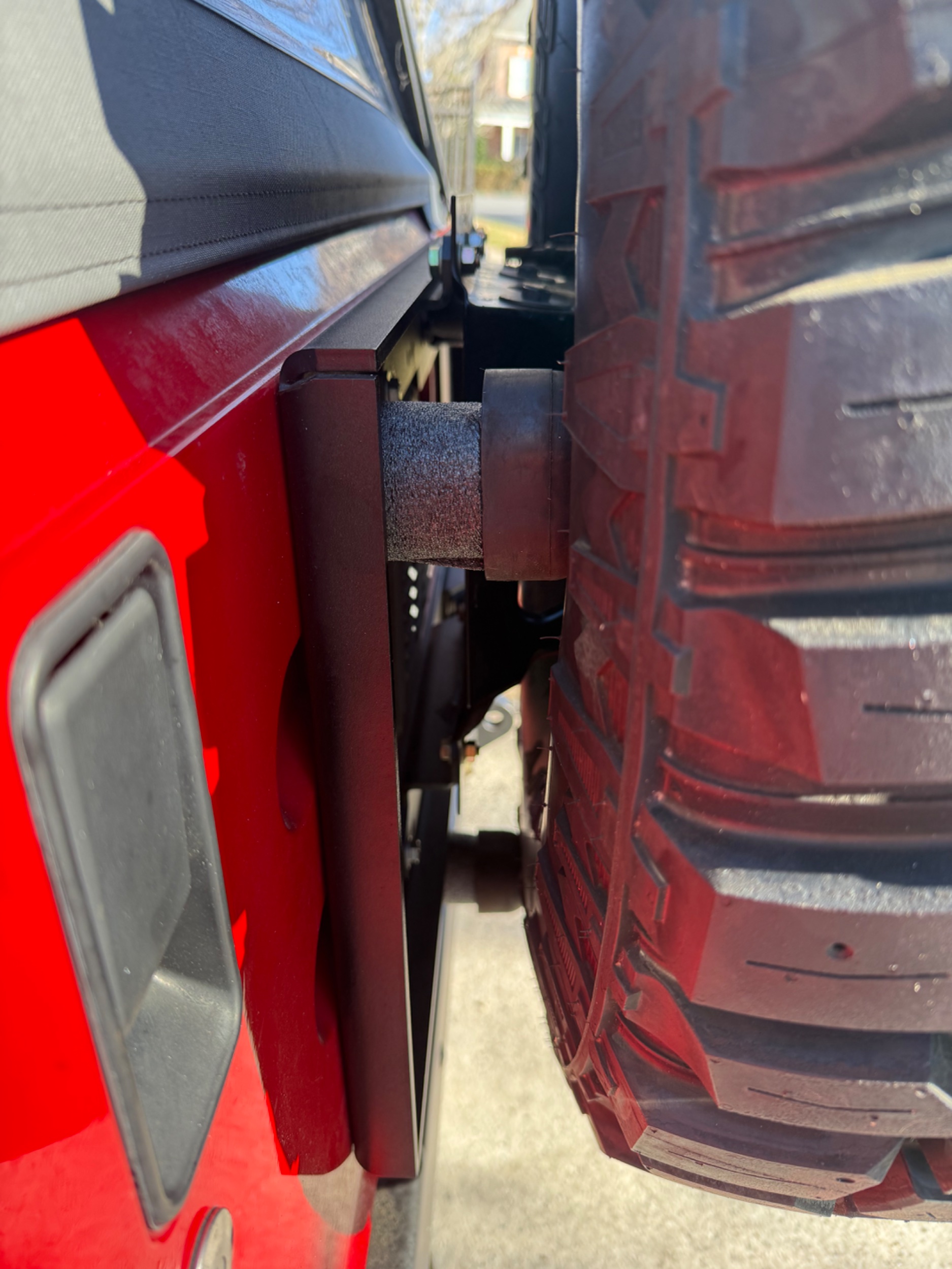

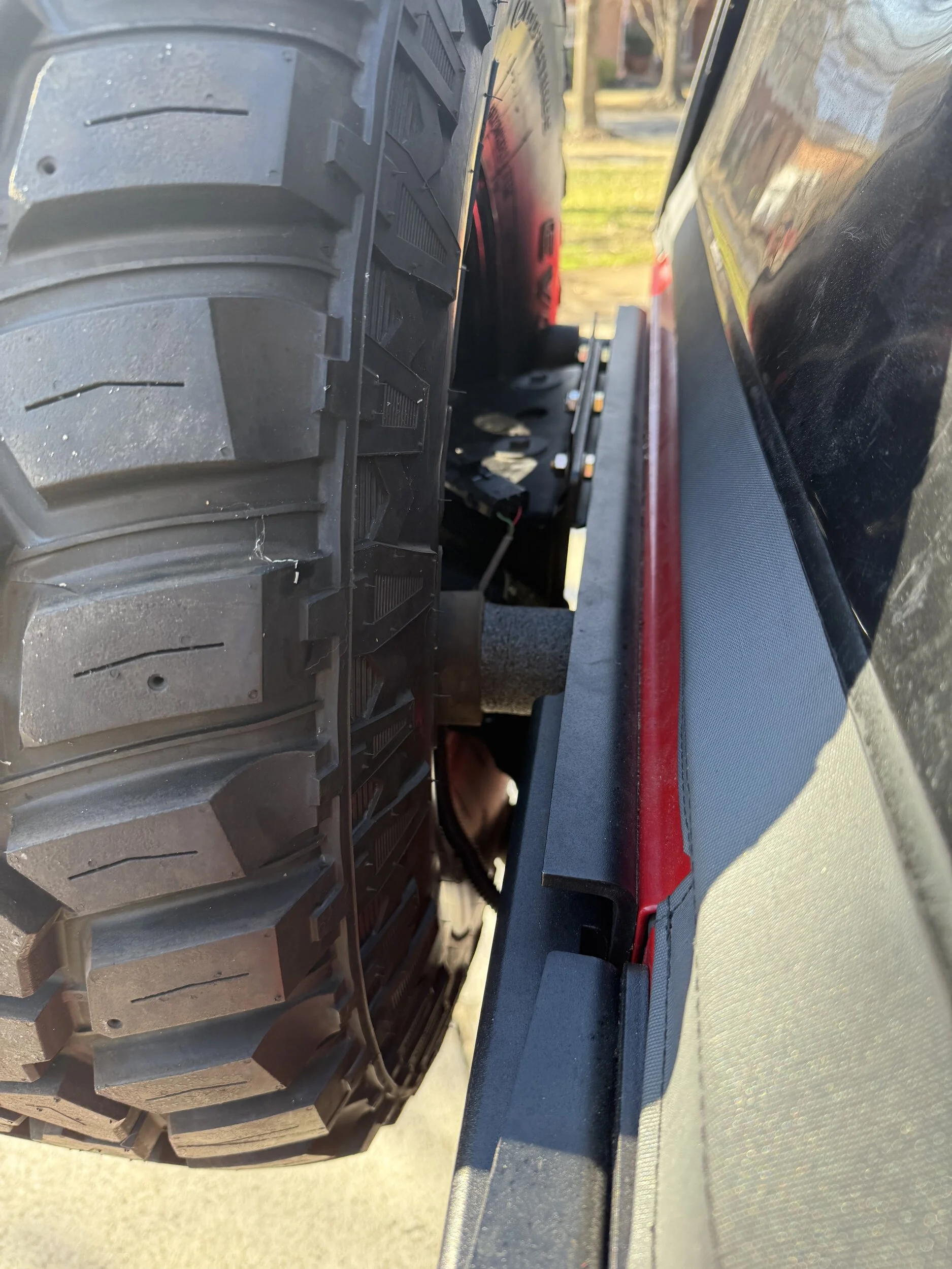

Had a little bit of downtime today so I finally fixed my rear snubber problem. I removed the extra spacer (discussed above) a few weeks back and now have spacers + the snubber sized appropriately so all 3 are contacting the tire.
I have 35” tire on 15 inch rims with 3.75” backspacing. Ended up needing 2-3.5” lengths and 1-4” length.
The snubbers themselves are 1.5” so ended up cutting 2-2” PVC lengths and 1-2.5”. This contacts the tire perfectly. Threw some rubber washers under the PVC so they weren’t contacting the body.
All in, maybe $5 worth of materials.

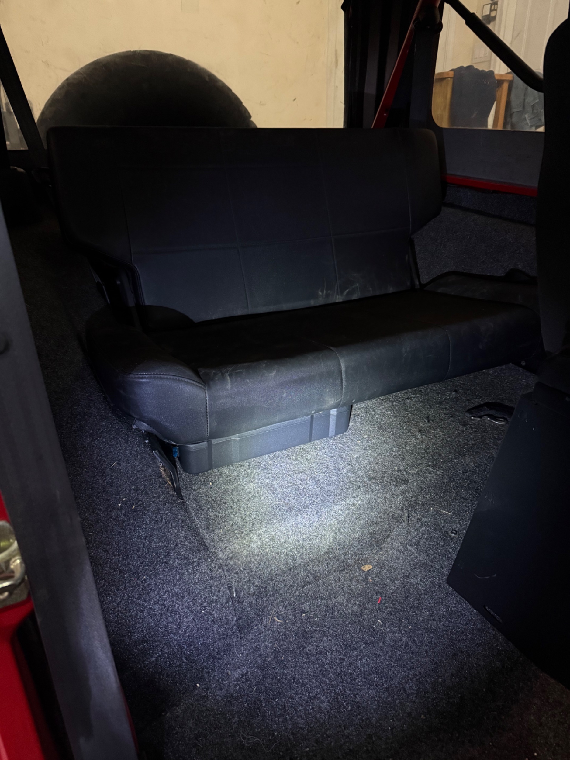

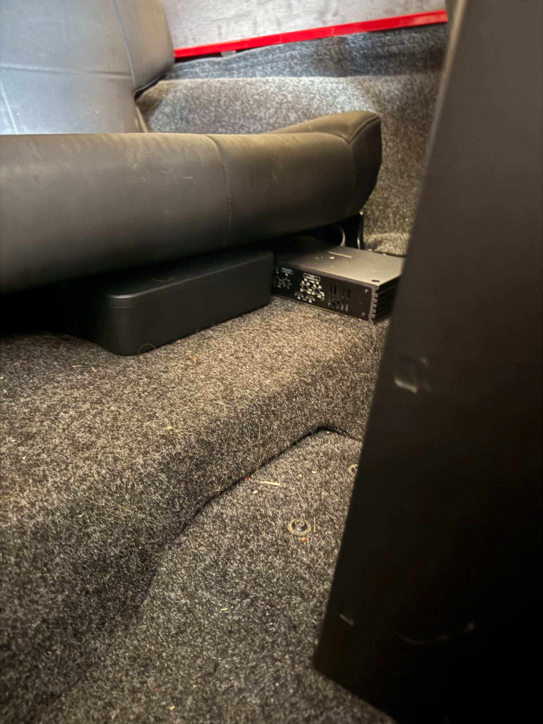

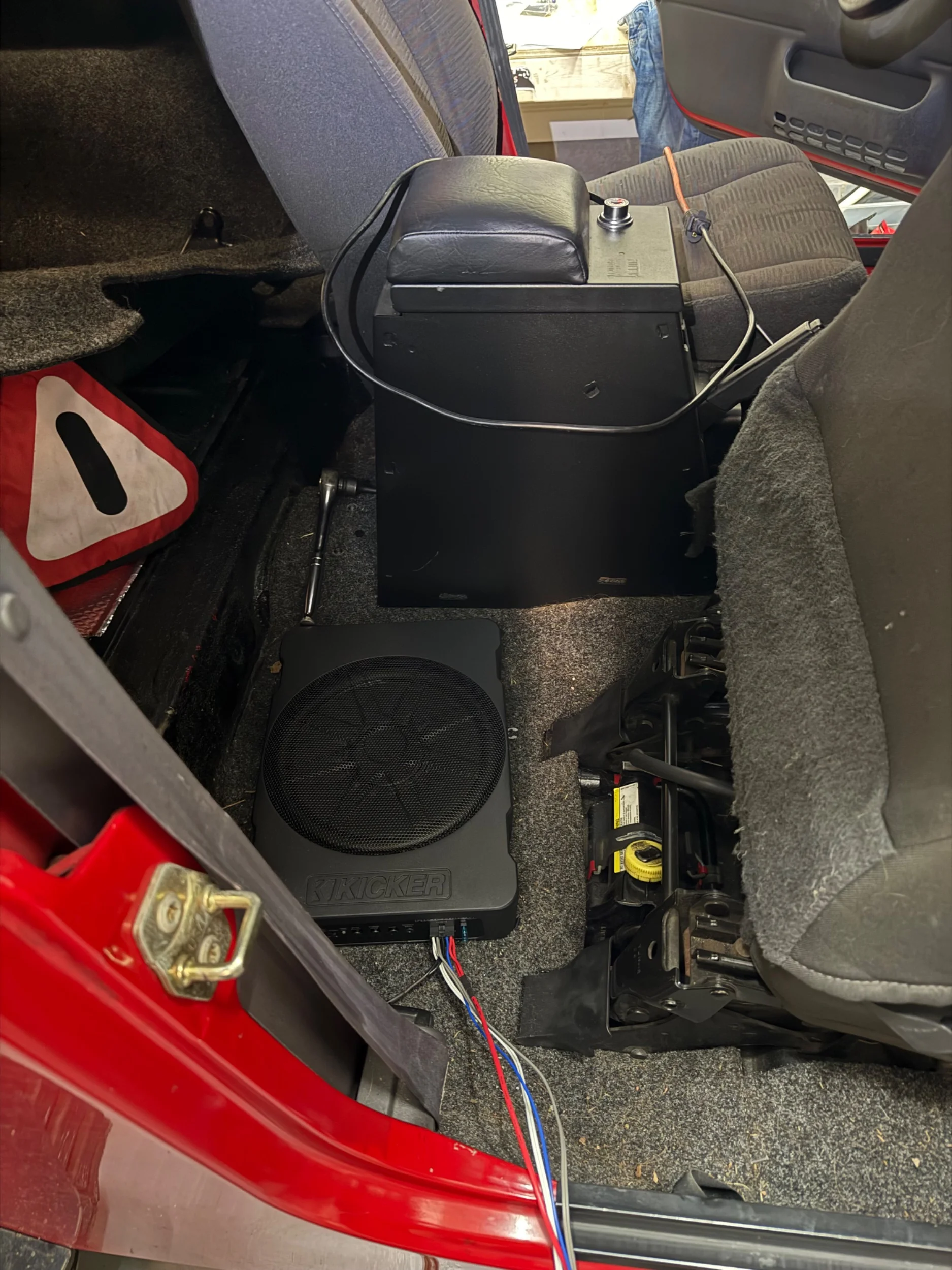

Wrapped up the 10” powered sub install. Here’s a montage of pictures along the way.
I thought about moving my speaker amp under the steering column, but the amp I have now wouldn’t fit. I figured I’d have to buy a new smaller one but was able to work around it.
As I got into the install I realized I could place the amp beside the sub under the rear seat. As you’ll see, I’m probably 2” short on the power wire and can’t fully tuck the amp under the seat. I don’t have time to fix today but will likely redo power wire so it can be fully hidden.

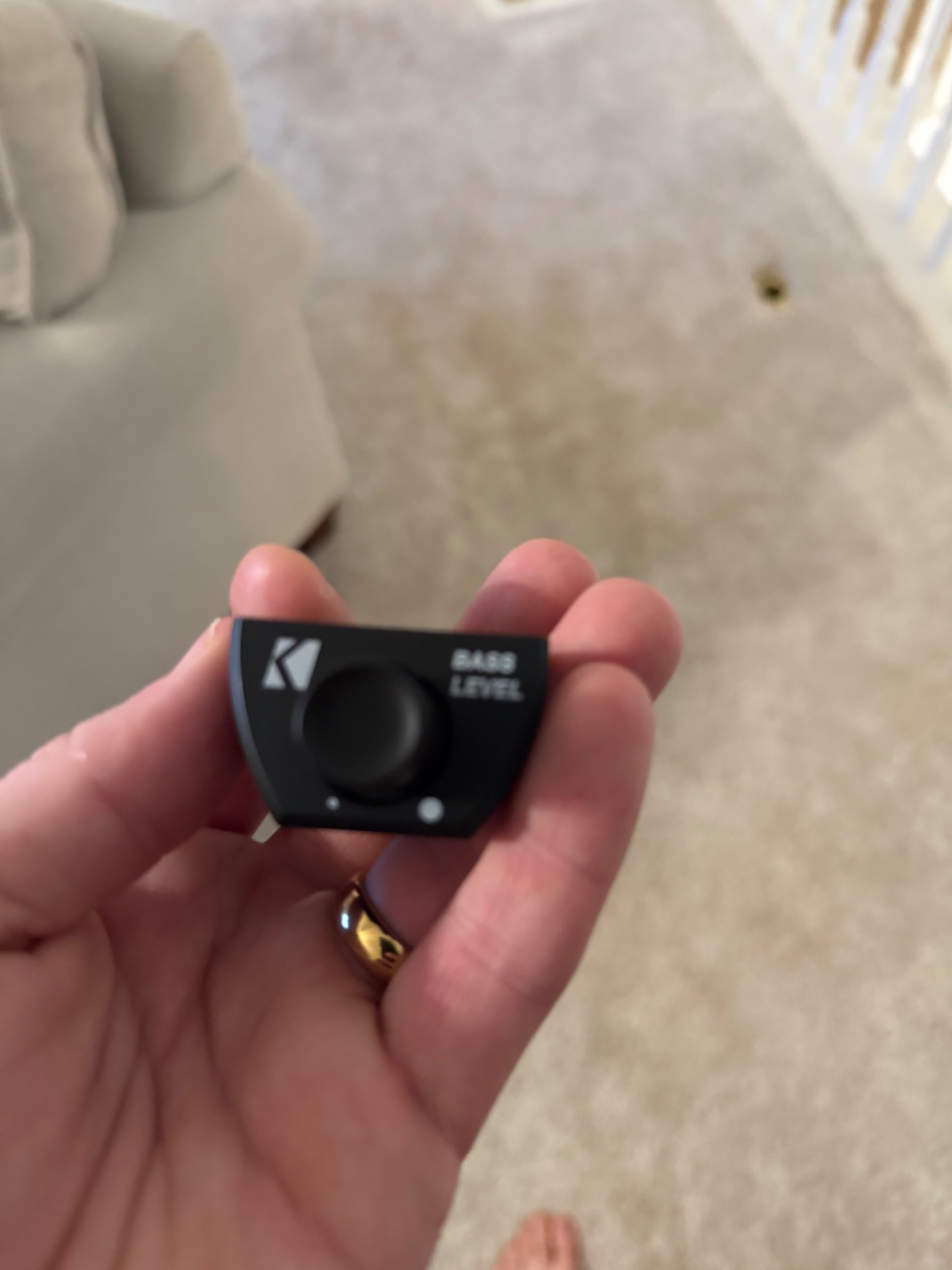

A cool aspect with the powered sub is the bass knob. My first car (in high school) had 2 subs and an amp but no knob. I always wanted the knob in my old jeep but never prioritized getting it back then. 15 years later and it’s installed in my current jeep!

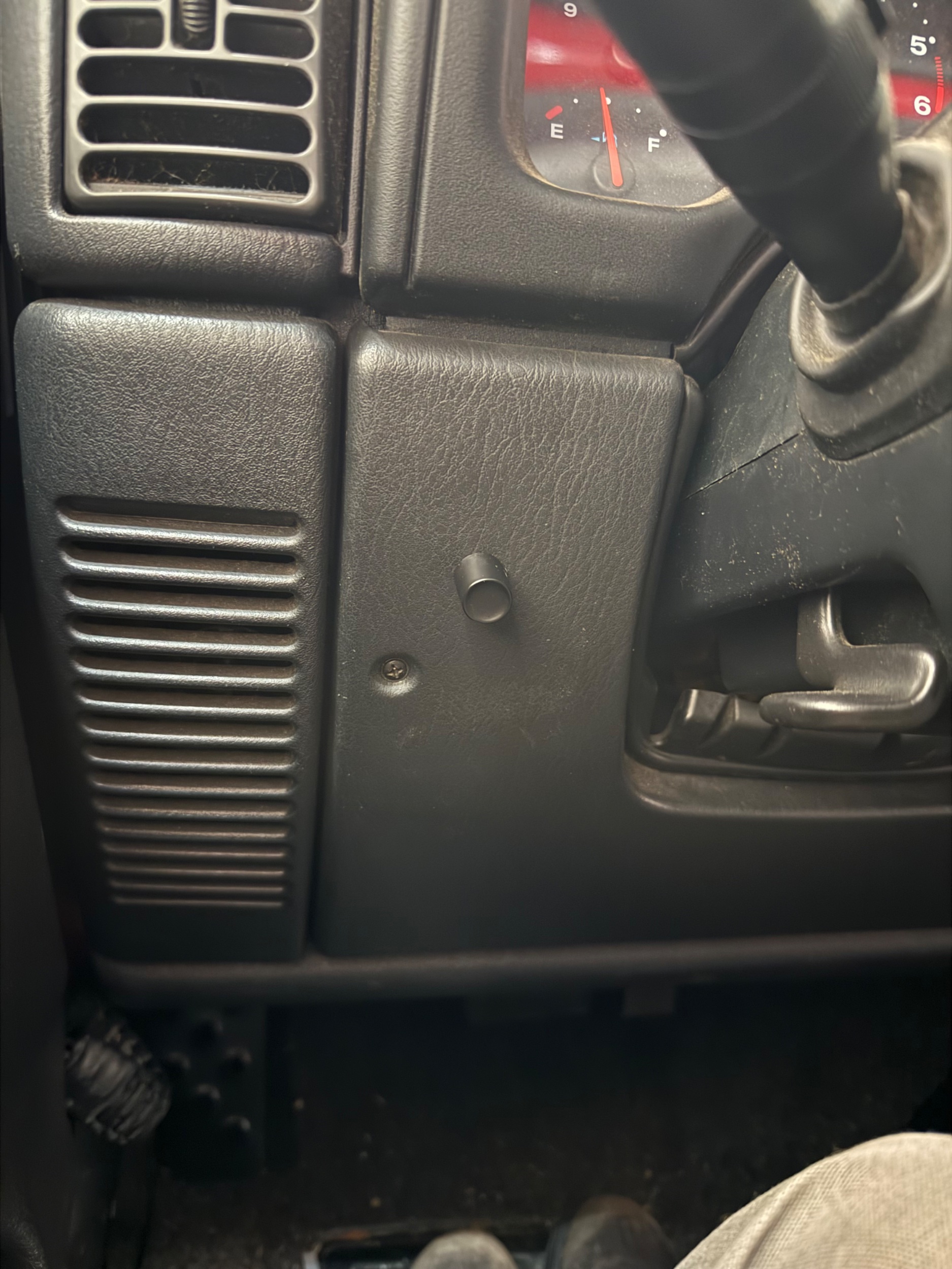

The knob comes in this housing that’s IMO way too big. I removed from the housing and placed on my driver side. I drilled small hole and screwed it in. Ran the wire opposite the power and tucked behind the dash. Result is pretty nice I’ll say.

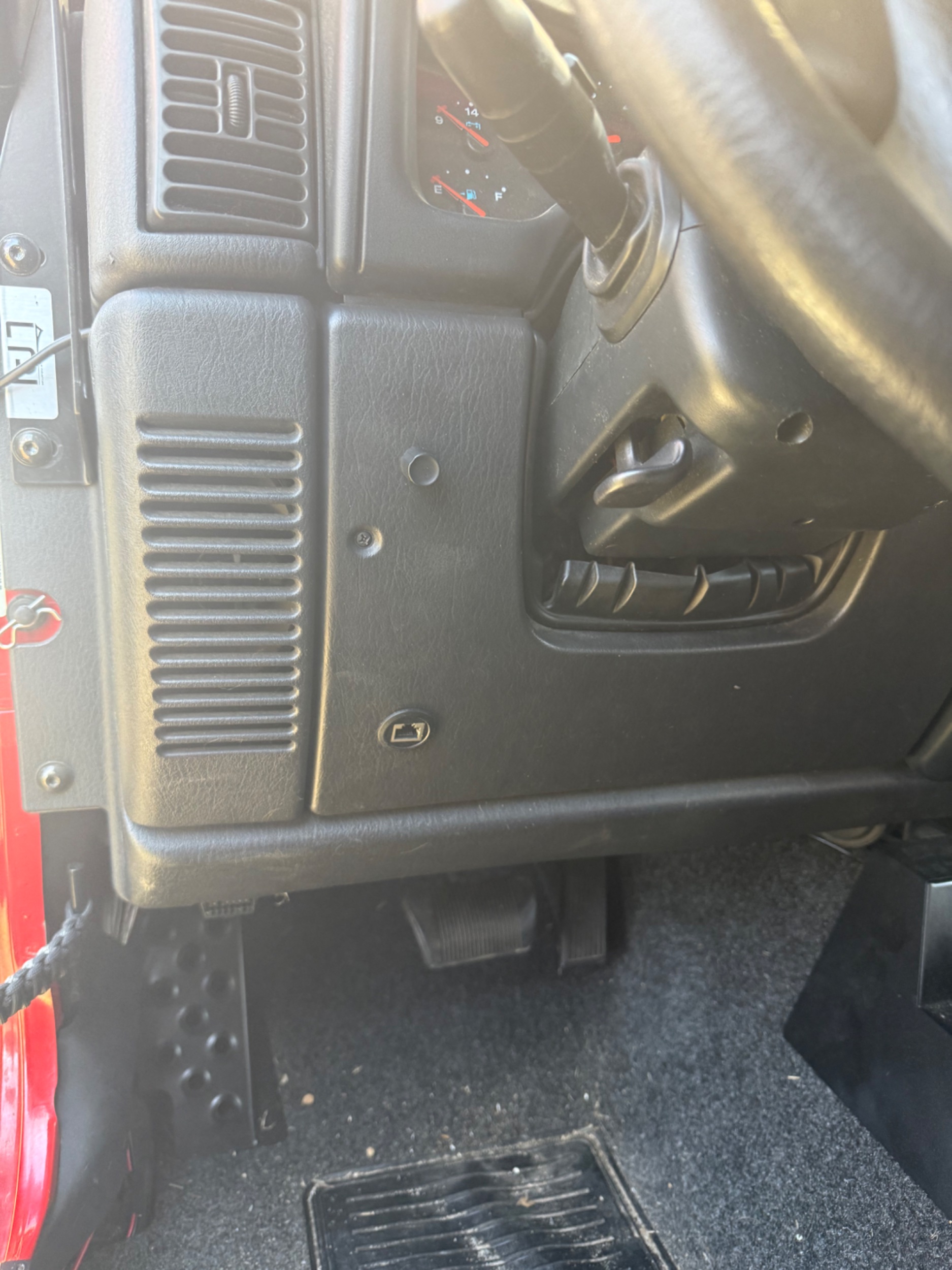

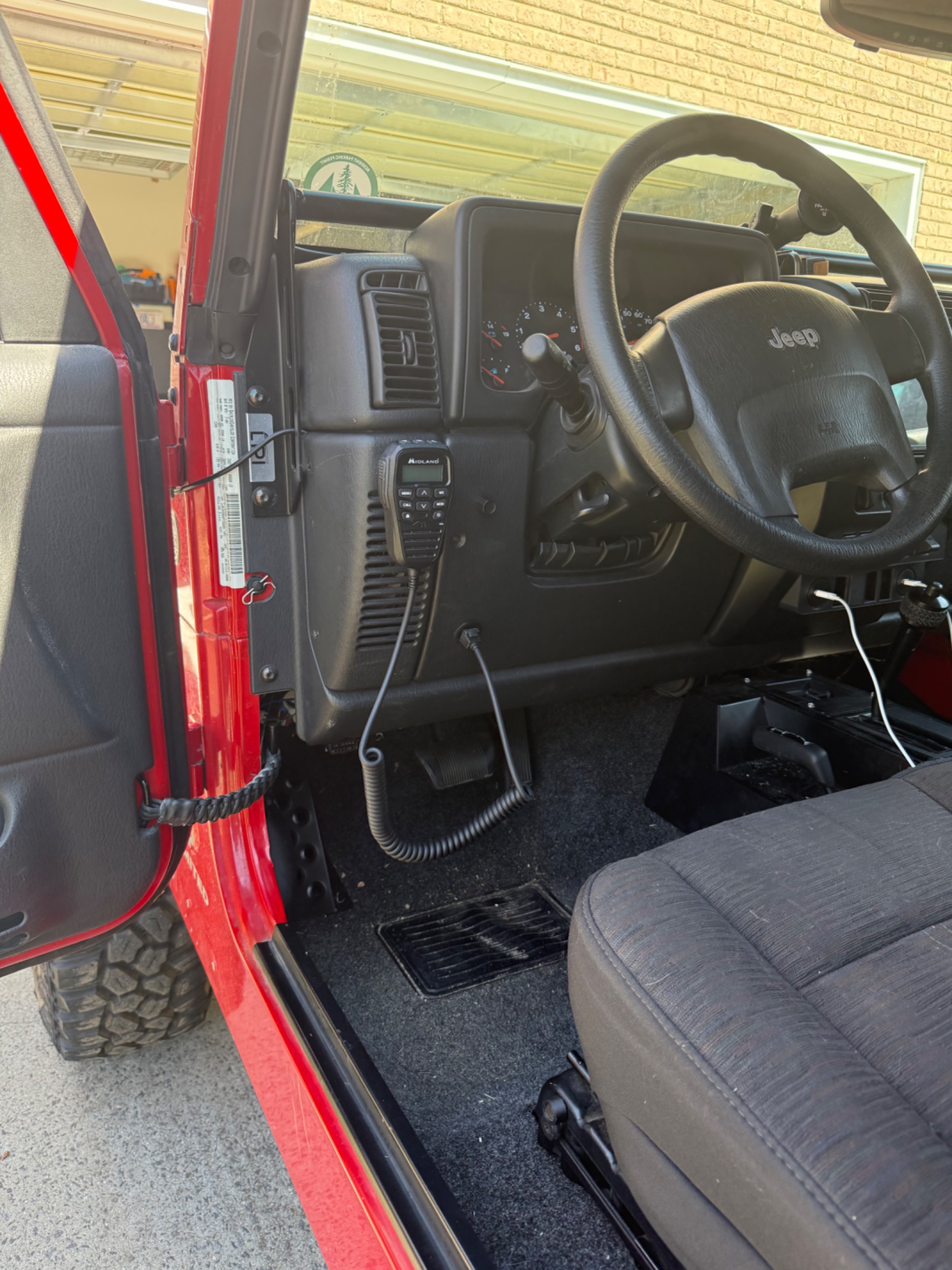

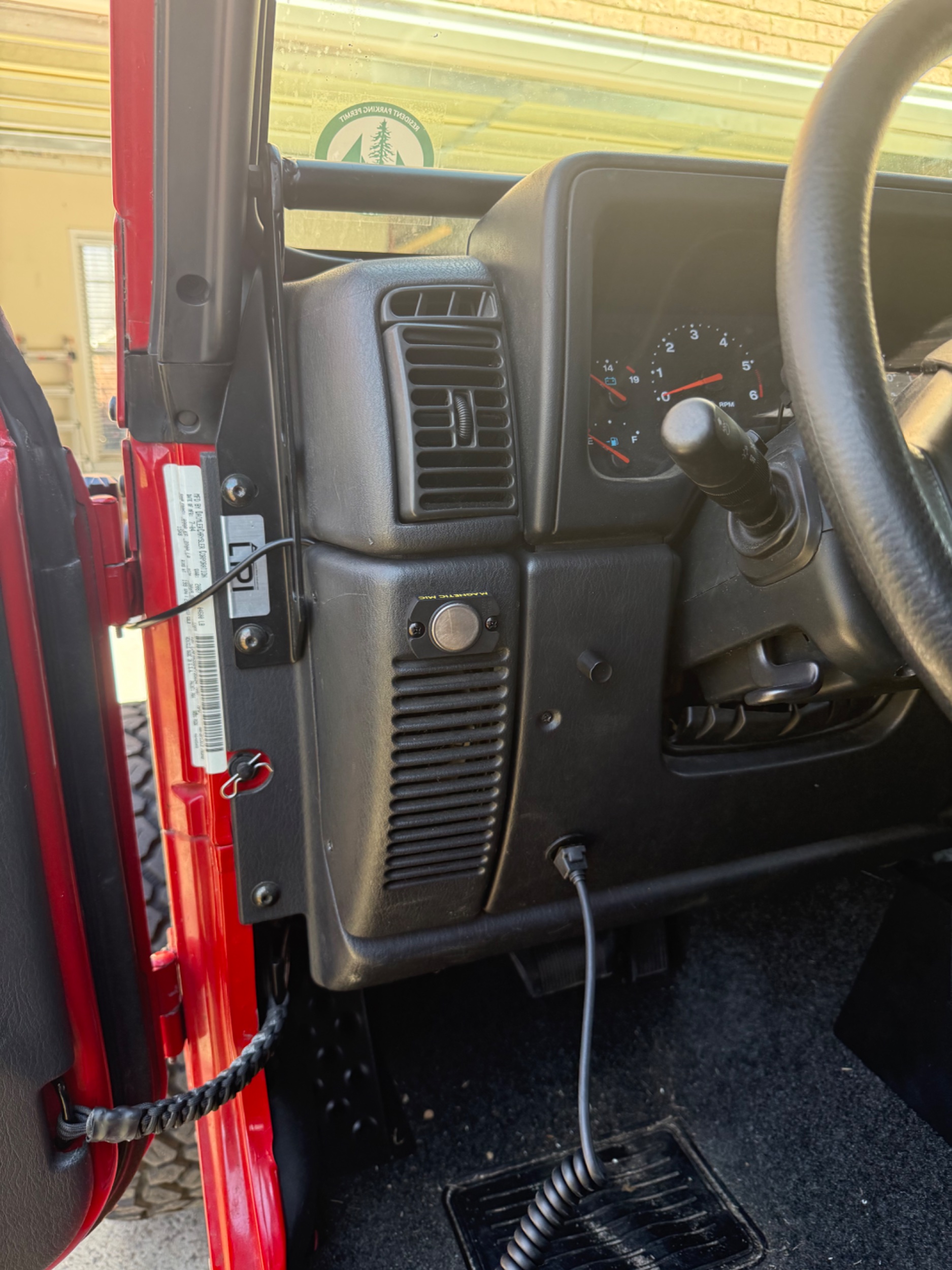

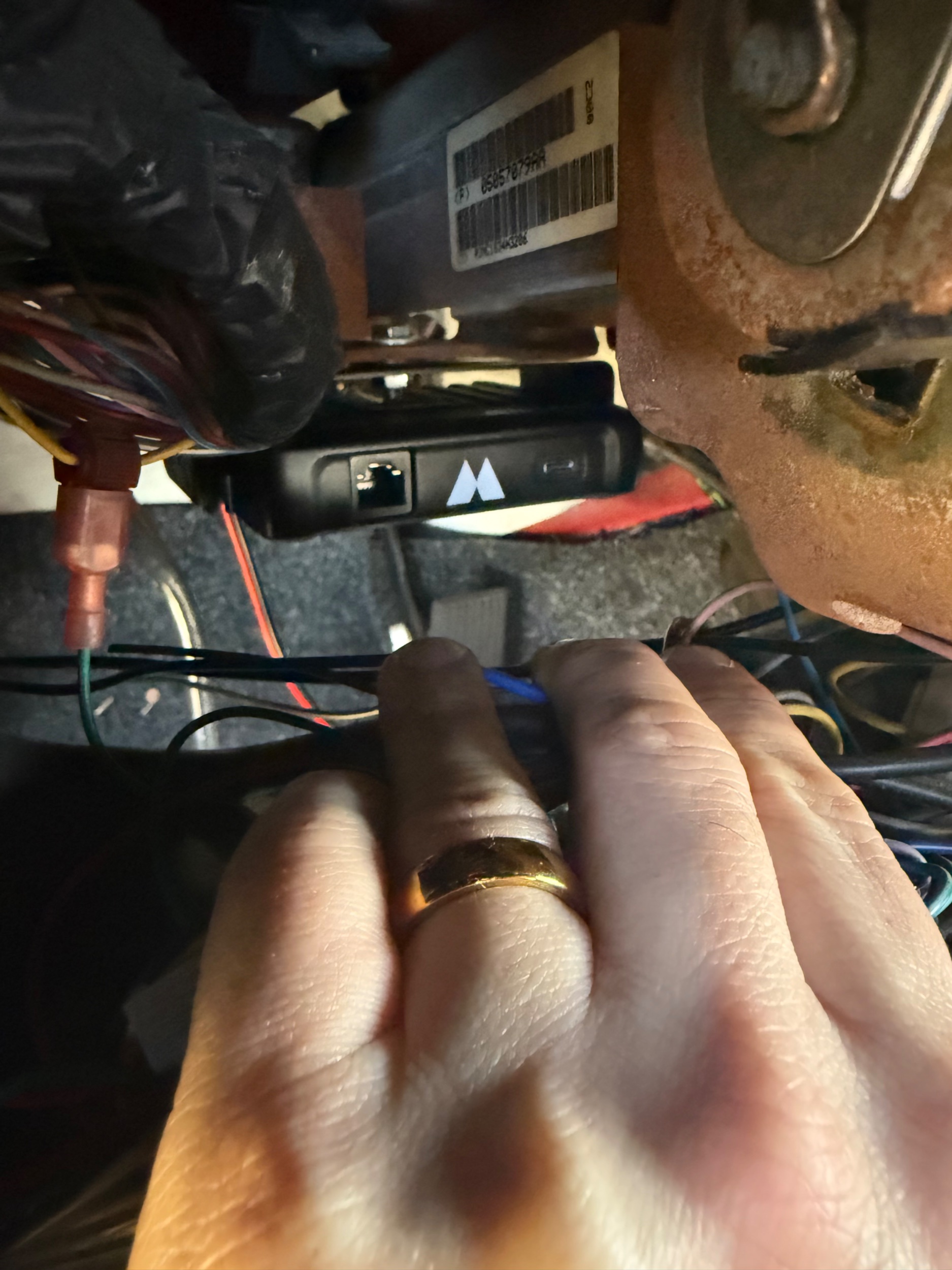

Had some downtime so I got the GMRS setup in the LJ. midland mtx275. Mounted under steering column. This is why I didn’t move the speaker amp under here.
Went with very discrete setup. I drive jeep into charlotte quite a bit, and want as little extra attention as possible. Did a flush mount for the hand held. Which lets me disconnect and throw in console in a few seconds. Used the magnetic mic setup mentioned on this forum as well.
There’s a chance the small antenna isn’t enough gain. If so, I’ll buy a bigger one.
