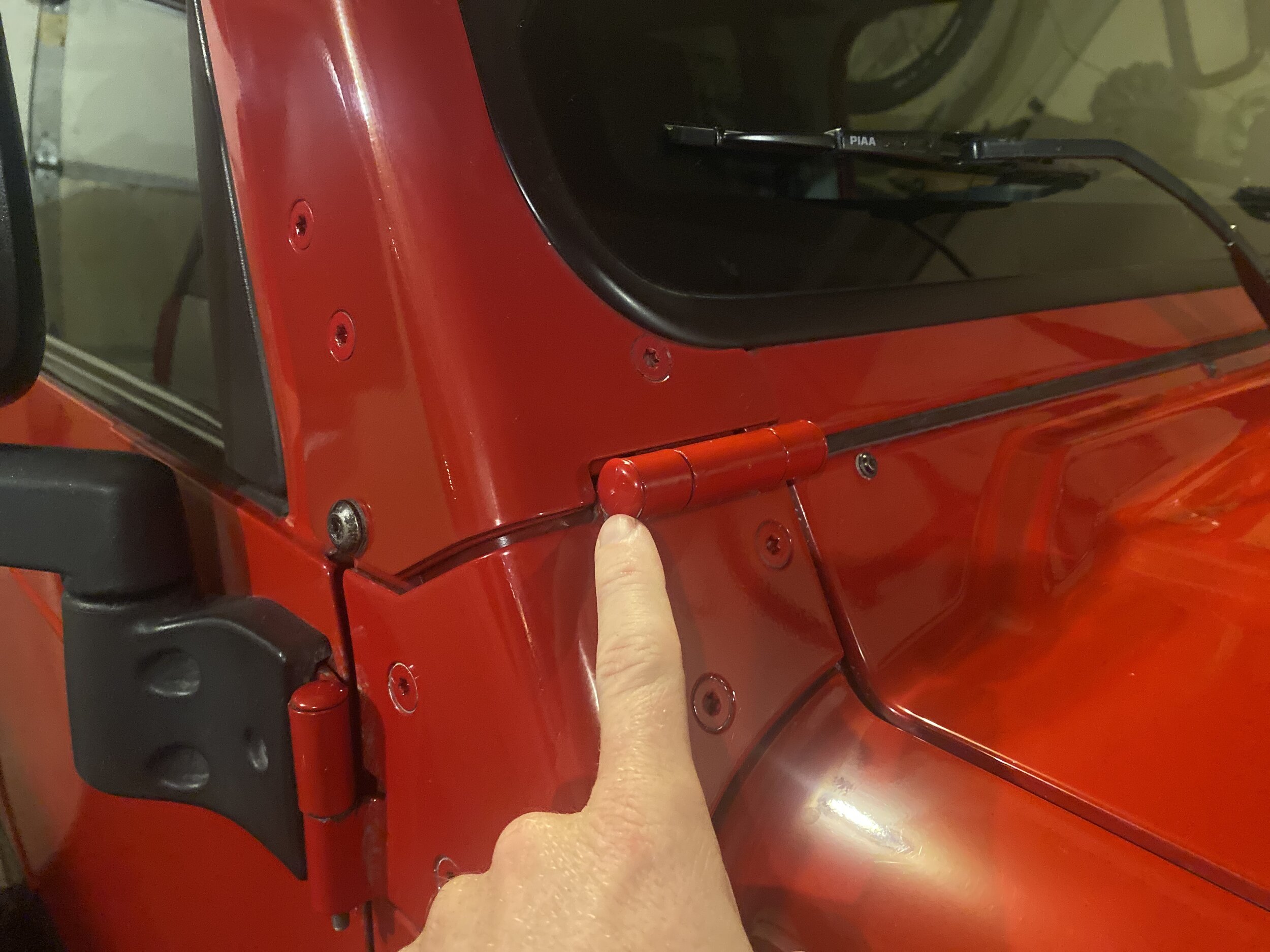

My son is replacing his windshield frame due to rust, and we need a solution to the hinge bolts. The OEM style are press fitted.
The windshield he bought came with a lock pin that is ugly as sin.
My best idea is a binding barrel on one side and a sleeve and bolt on the other, but I'm looking for any ideas that might be better solutions.
https://www.mcmaster.com/products/b...esistant-316-stainless-steel-binding-barrels/
For reference, this hinge.

Ok, that’s what came with the windshield. If no better ideas we’ll try a barrel binding bolt, sleeve, and bolt. Trying to make it look as factory as possible.
I ended up doing a regular stainless steel bolt, if you choose to go that route. Not exactly a factory look, and a downside to doing it this way is I have to remove the nut and back the bolt out some to remove the cowl
Post in thread 'Windshield Hinge Pins' https://wranglertjforum.com/threads/windshield-hinge-pins.71152/post-1344468
That's good to know that a nut can interfere with the cowl removal. I think we saw your thread when researching. I think we'll going with a really low profile slotted carriage bolt on the side of the hinge that's toward the middle of the vehicle and hopefully avoid that. 🙂
