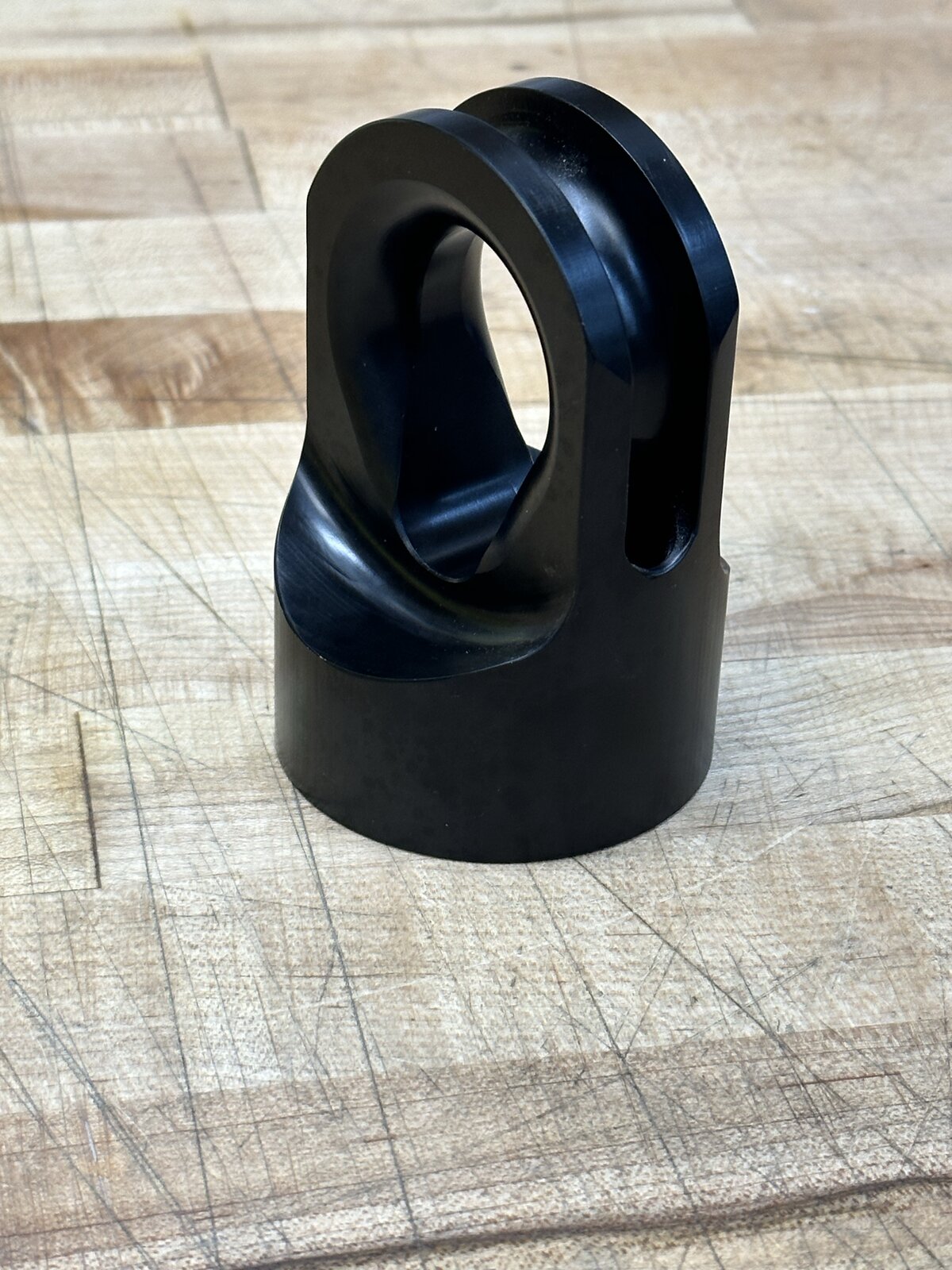

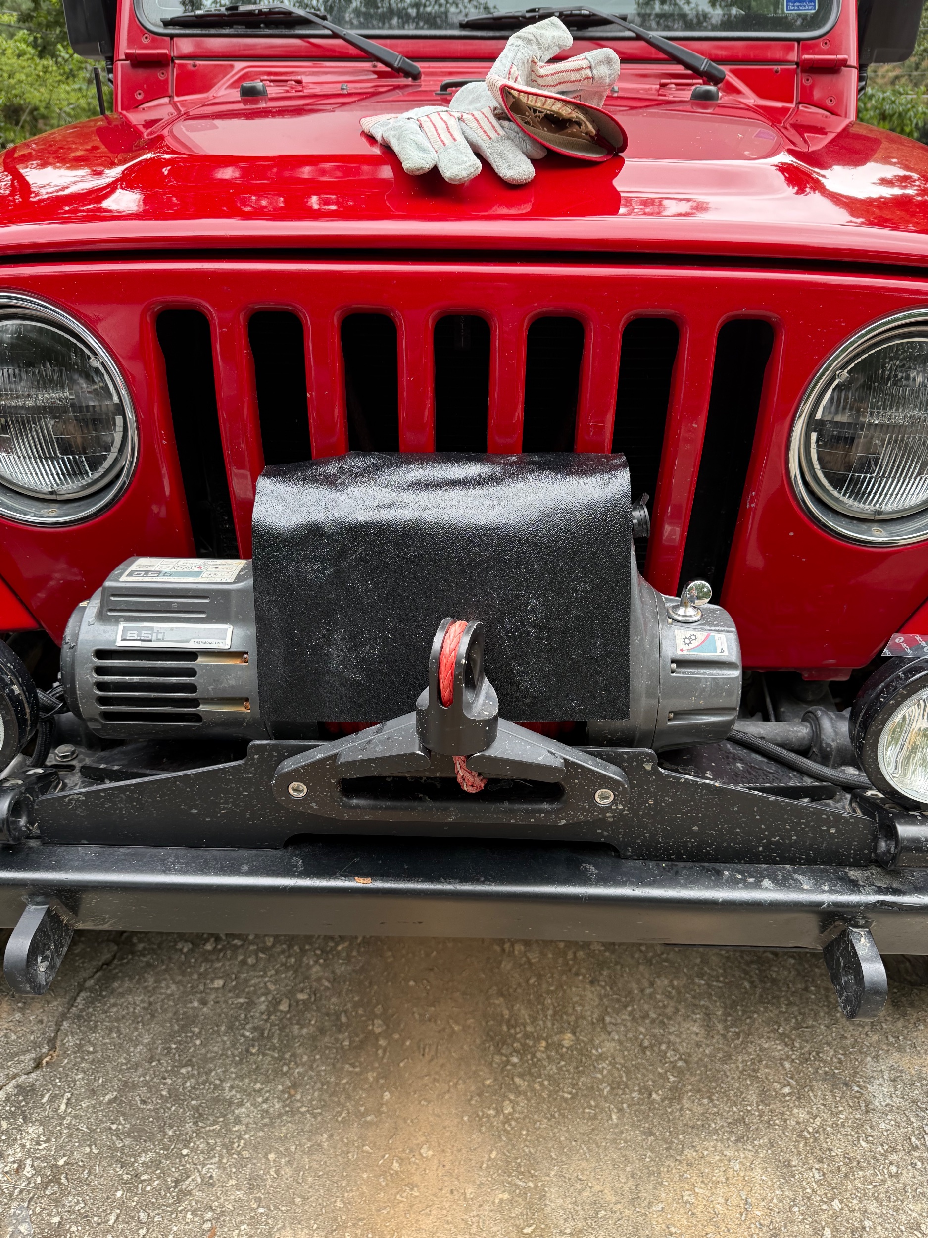

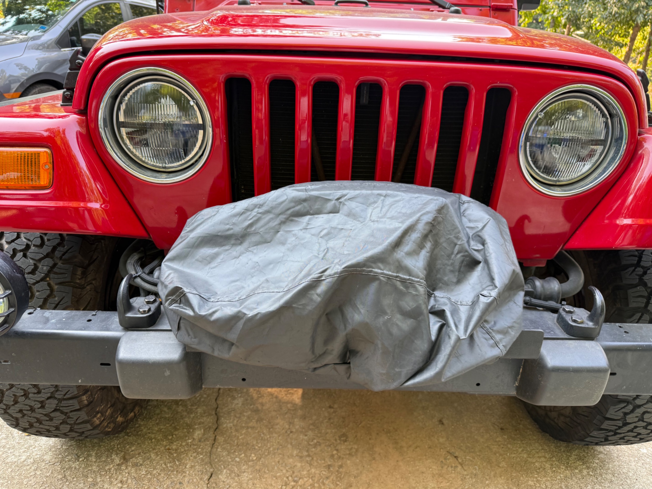

The thimble I use on my truck actually uses an eye spliced into the rope, keeping the rope behind the thimble out of the light. The Jeep has the large loop around the outside, but it is covered well by the winch cover and almost always kept inside out of the light.
Either of these thimbles are quickly and easily connected to a soft shackle for use with a tree protector, snatch ring or whatever. I’m very happy to be away from a hook, even a lightweight hook. The spring keepers get messed up and I don’t think a hook of any kind is always healthy for a soft shackle.

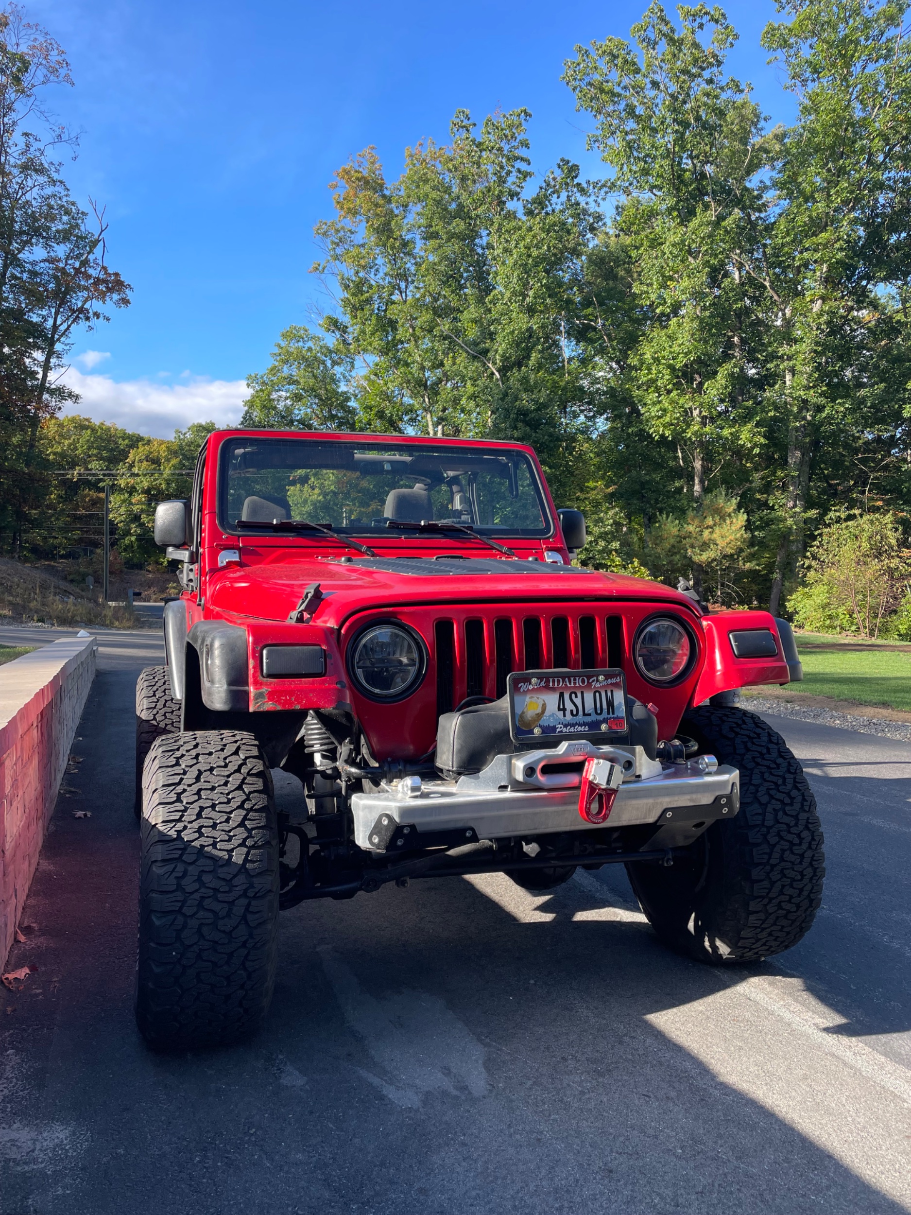

The importance of keeping the rope out of the sun seems to come and go around here. I ran a kydex cover for years until one day I guess I didn't get it on right and it flew off on I-25. My jeep is always garaged unless I'm driving it so it's probably not critical for me. Maybe for one that lives outside.

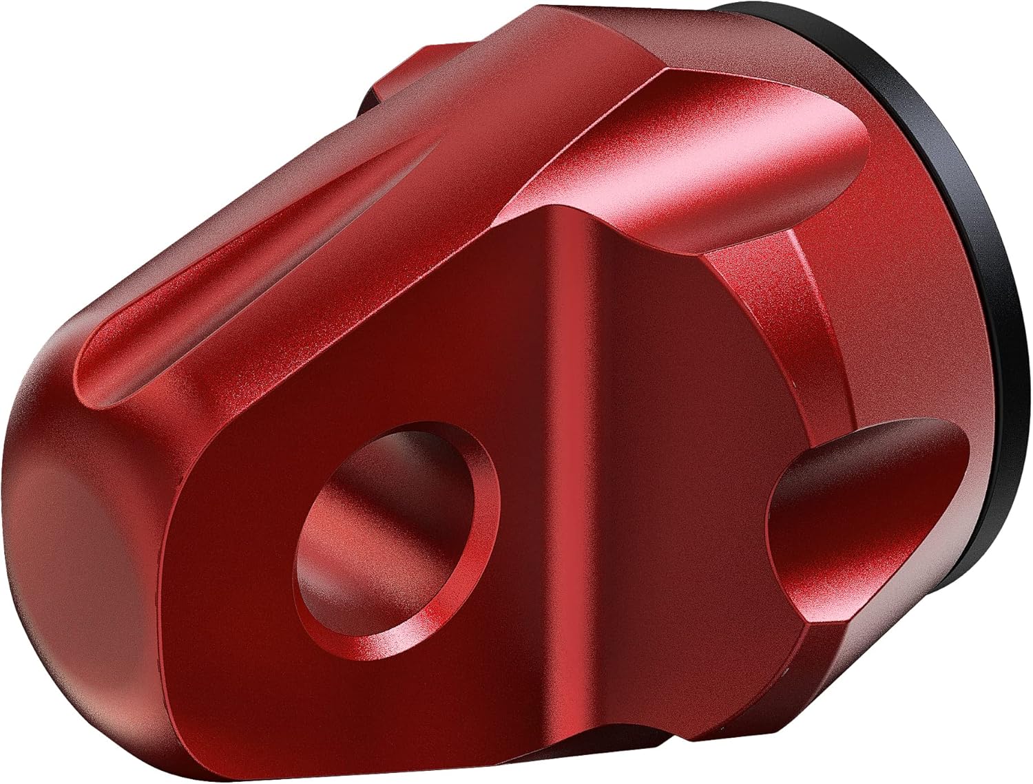

So then what is “ideal?”
Get a thimble that encloses the rope so that it's not exposed to UV
Winch Thimble
This is the type that I have on my truck. The winch is an under bumper hidden mount, so it stays pretty dark. Like my Jeep, it spends most of its time in the hangar out of the light. It is rarely used for anything except my volunteer disaster relief work after hurricanes, tornados and floods, so it is out of the sunlight most of the time.
