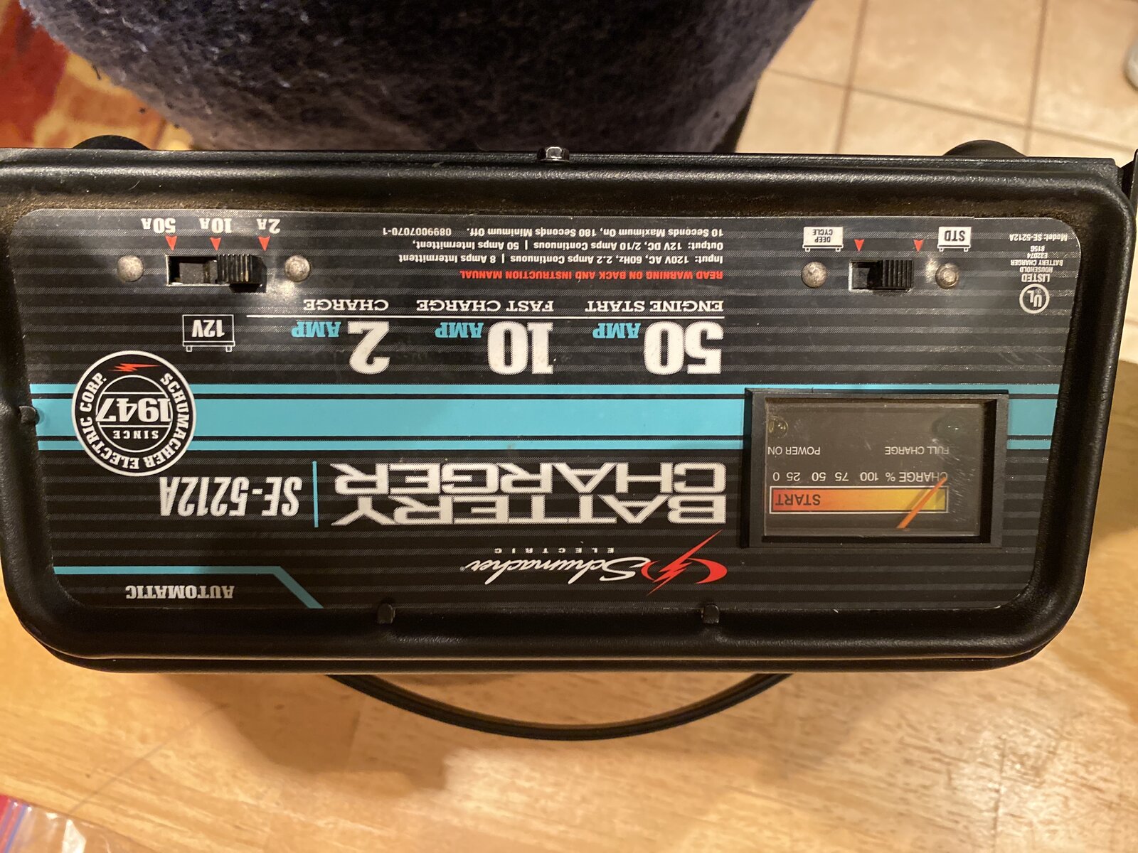

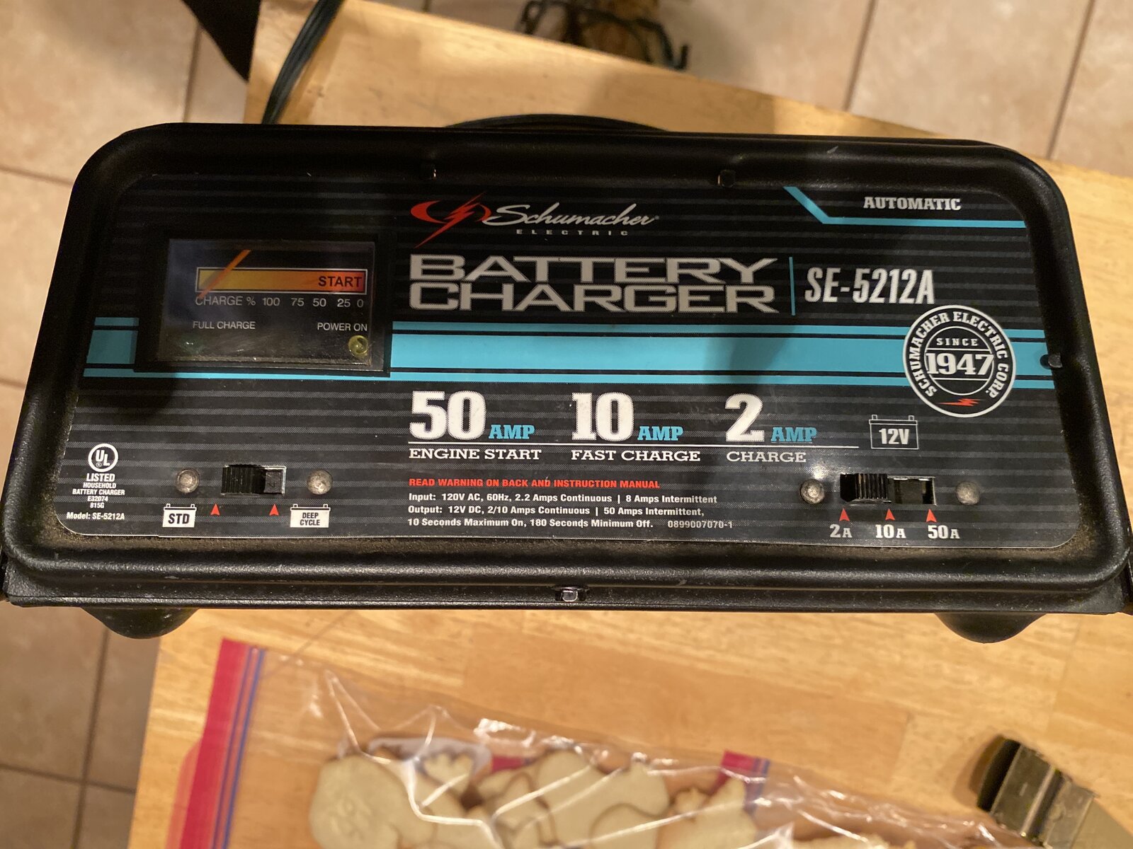

Here is my battery charger. Will this work for an AGM Battery ?

I've never owned a charger or battery maintainer with a specific AGM mode and I've had nothing but AGM batteries in my TJs since probably 1999. Never a problem.
My battery maintainer says its specifically for a AGM but I really dont know if there is a big difference. I do know if we were talking about lithium deep cycle batteries they do take a specific charger.
