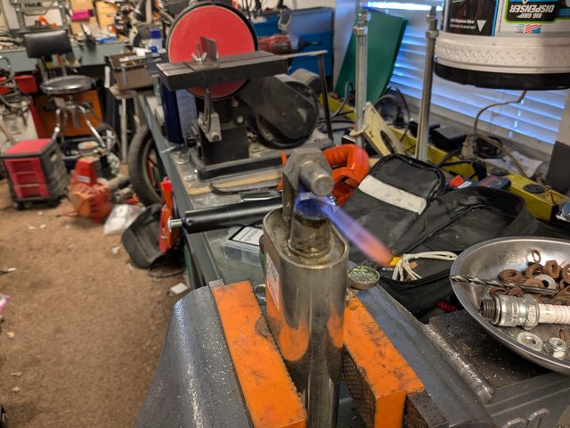

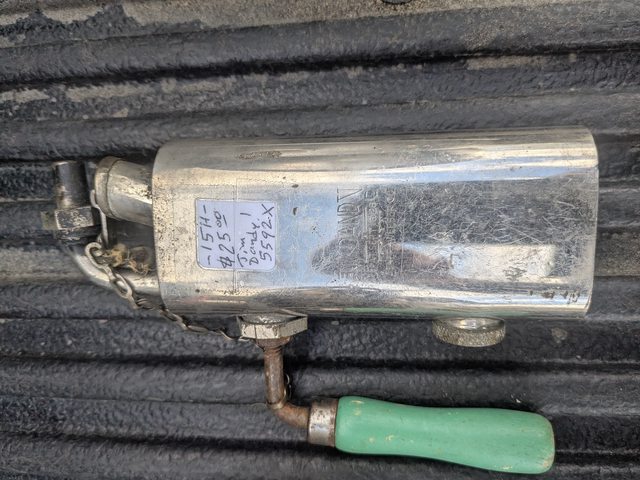

Latest project was getting this newest antique score to run.
It's a Jim Dandy alcohol fuel blow torch. Late forties, early fifties. A radio hobbyist or jewelers blow torch. Normally, I wouldn't spend more than ten bucks on an old blow torch but this one is way different than any other one I own. Plated, for one. No real nozzle to speak of. Two fuel reservoirs. I've found some info online about Jim Dandy torches online but almost nothing on this model.
First thing was figuring out how it works. That took a bit of head scratching. The knurled cap is the tank for the burner. The cap with the handle is the tank for the orifice. I couldn't even find the orifice at first as it was really plugged.

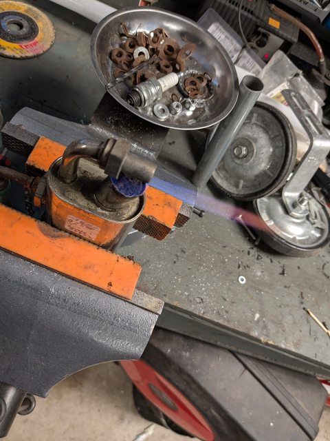

This is the first lighting before I figured out there was separate tank for the orifice.
I had unscrewed the hex at the pipe and dumped alcohol down there. It ran for maybe 5 minutes.
This is after getting my head out of my ass and filling the second tank.
It ran for well over an hour on a single filling. It could have easily run longer but I got bored and went in the house. Usually, an old blow torch, Coleman type lantern, or stove that hasn't been used in years will begin to burn better the longer they are run. The gunk in the generators gets cleaned out. This one was no exception. As far as lighting it after filling, pop the cap off the wick and put a match to it. That's it. Within two minutes, the long flame begins to shoot out.
Yesterday, for shits and giggles, I used it to sweat solder a scrap piece of sheet metal to a piece of steel tube. One, to see if it would, and two, to see if I still could. It was a yes to both. Unlike most blow torches, this torch is quiet. It doesn't generate too much heat, and the handle is more comfortable than my Lenk brand alcohol blow torch. It may have become my favorite.

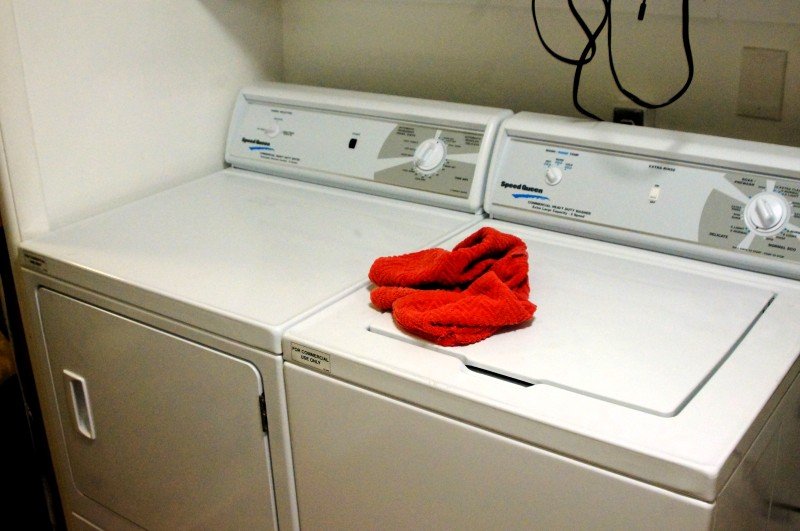

The companion gas dryer for my Speed Queen washer arrived last week, so I took the Jeep and trailer up to JAX to pick it up. As there was no gas connection for it, I had to tee off from the water heater. Homeless Despot doesn't carry black pipe AT ALL. That's fine, I went to our local hardware/industrial/commercial place that's been in the same location since 1888. They had it of course.
Gas isn't particularly common here in Florida, but we're lucky in that we have it.

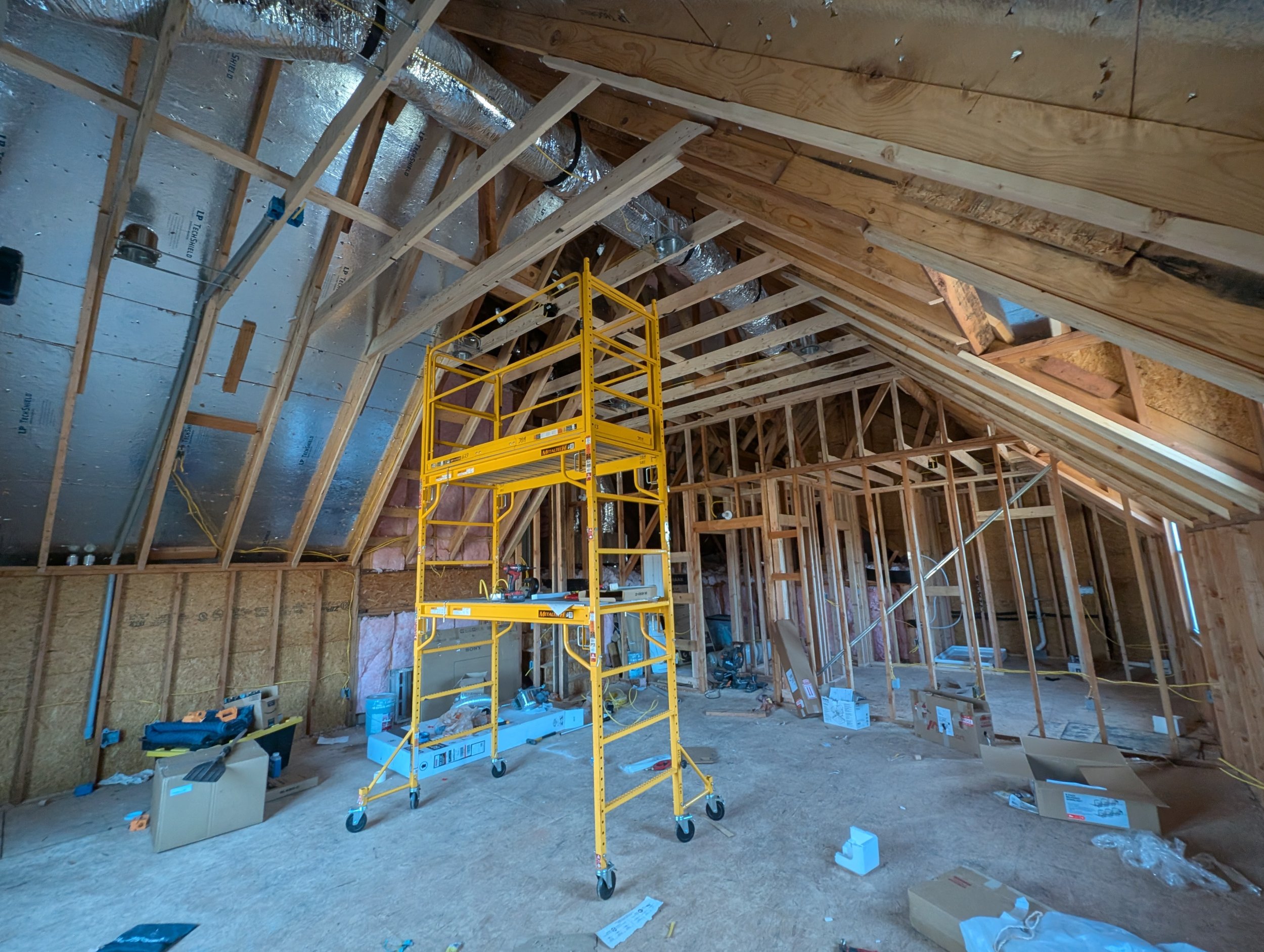

finishing 750sf above my garage to add a bed and 3/4 bath plus a large movie/music room.
Had it framed just before Thanksgiving, plumbed the bathroom right after and then I did the electrical and HVAC myself in a couple of weekends.

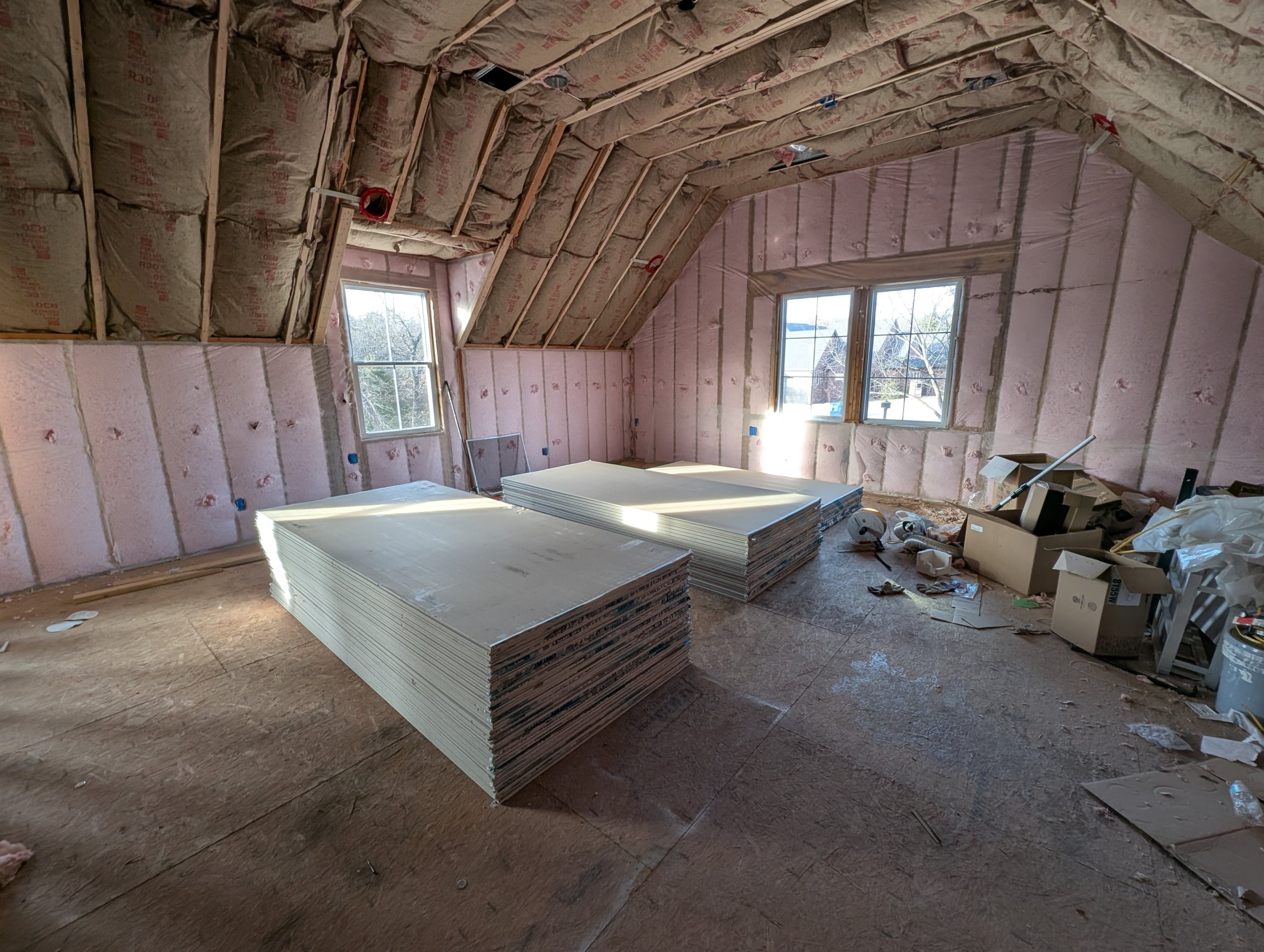

Insulated on 12/15
I installed the shower surround on 12/19 and then drywall hung on 12/20 and finished over the following few days.
Planning to get LVP down in the bathroom today and tomorrow so the trim carpenter can do his work Thursday-Friday, paint and carpet next week and my wife wants to have guests staying in it 1/16. Would have been nice not to catch a cold last night but it is what it is.

Looks great. That's awesome you're doing all this yourself, how come you don't do the trim?
I probably would if my wife wasn't in so much of a rush to have it done for her friends to come visit, but I don't have much trim experience so it would take me 4x as long while I learn by trial and error all the tricks of the trade that make things go fast. Same with the framing....I could have, but I paid a guy and his crew $1200 to get done in one day what would have taken me a week to do myself. I'm at that point in my life that I have more money than time so I think of it as buying time.
The trim guy starts another job on Monday so if I can't get the materials lined up by Thursday or he runs out of time, I'll probably end up finishing up. I'll have him shelve out the closet and get the doors all hung and cased and if there's still base and other molding left I'll finish up.
I've done enough electrical and HVAC to already be efficient at it so I never even considered hiring that out.
The bathroom floor and the shower surround would be a whole 'nother sub to bring in which made no sense for a job that only takes a couple hours even for a noob like me.
