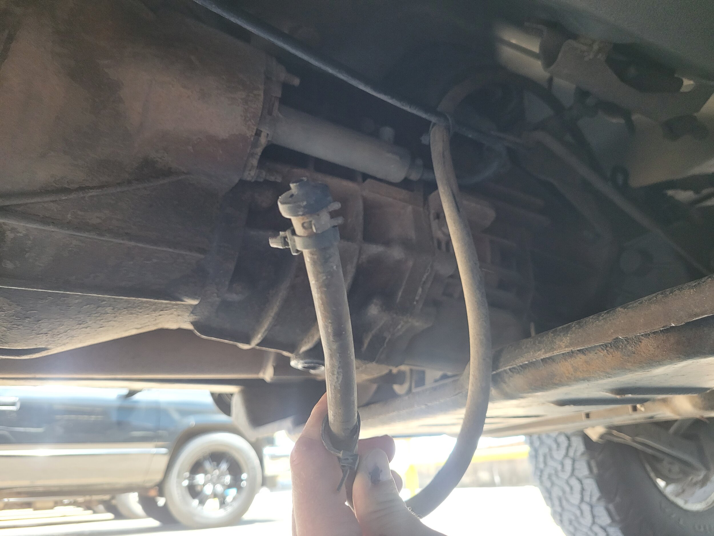

What is this?
skirata
May 20, 2025
6
South louisiana
Today I changed my crankshaft pos sensor and while doing it I noticed this. What is it?
2000 jeep wrangler 4.0 sahara
It looks like your a transfer case breather hose. Route it up into the engine bay on the passenger side of the transmission and secure it so it doesn’t fall down again.
