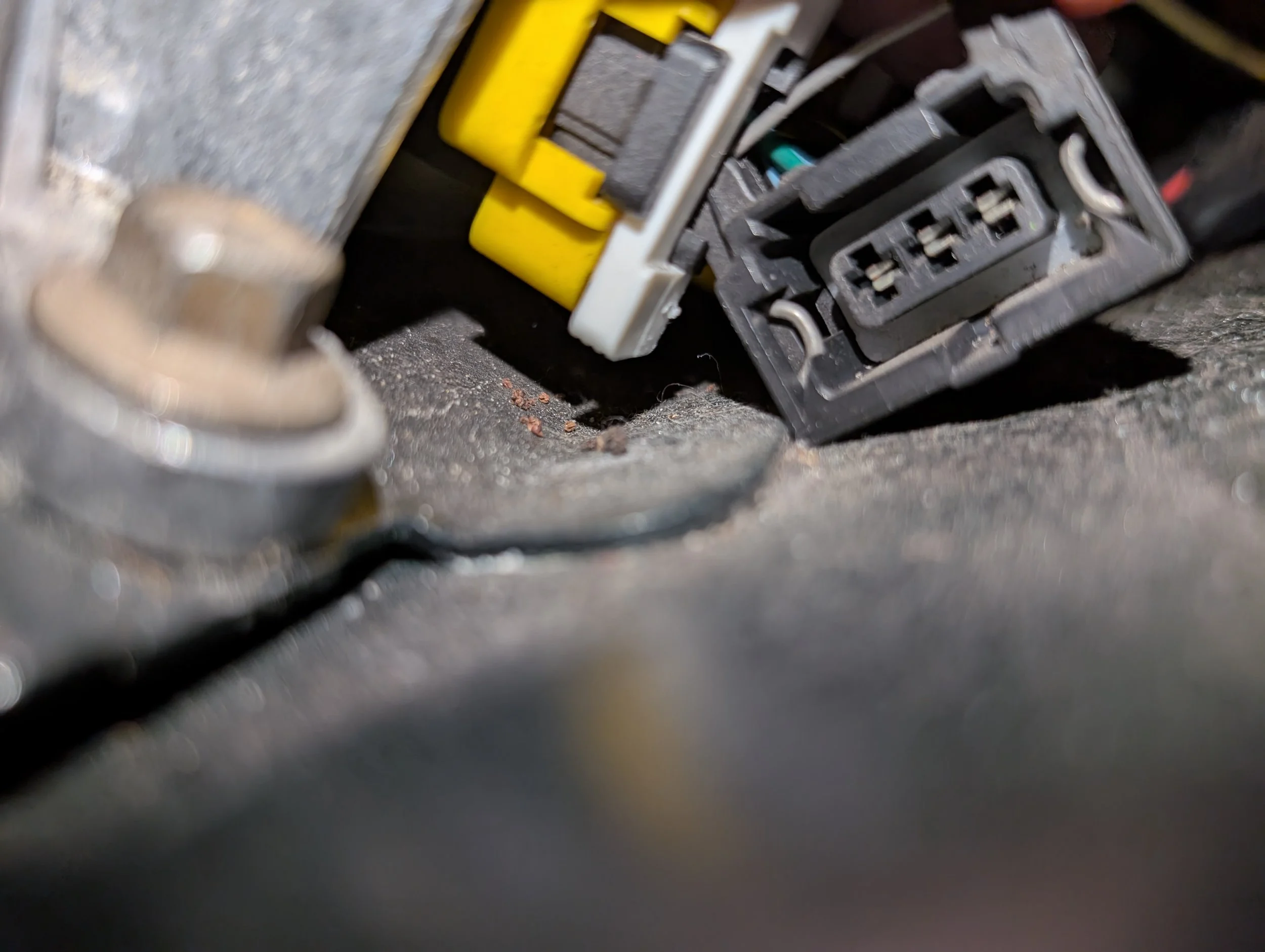

I have searched for a while and can't figure this one out. What is this plug for? It is located on the same wiring line as the Airbag Control Module plug (dead center under the dash in front of the shifter). Can anyone tell me what this plug is and if it should be connected to anything? Any help is appreciated.

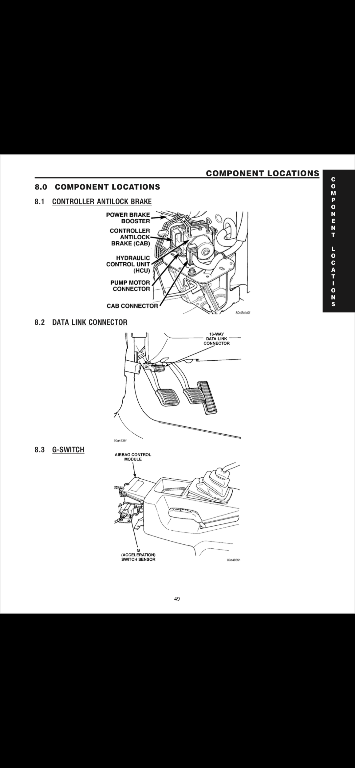

I believe that may be what plugs into the G-Switch also known as the acceleration switch if it is the plug in the attached photo. I’m not certain but It may have something to do with ABS equipped TJ’s, not real certain. I’m sure someone here will know for sure.
I believe that may be what plugs into the G-Switch also known as the acceleration switch if it is the plug in the attached photo. I’m not certain but It may have something to do with ABS equipped TJ’s, not real certain. I’m sure someone here will know for sure.View attachment 605784
I tried to look it up and the plug looks the same. I suspect you are right. From what I can tell the 04 doesn't come with the actual G-Switch. So the plug is left over on the wiring harness like a vestigial structure. I appreciate your help.
