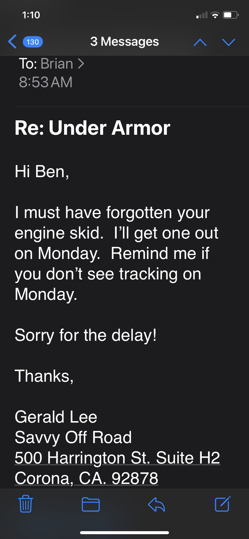

Ben ordered through the site after having an email conversation directly with Gerald. He started by asking for a military discount if he ordered everything together. (Gerald offered 8%, honorable considering today’s costs). Once placed online an email was sent directly to Gerald with a response stating he was headed to EJS then Fla and would ship asap.
This morning I emailed Gerald, (Ben is out to sea), letting him know belly pan received but no engine skid yet.
He responded shortly after with;
Well there’s an honest but unbelievable response 😂 but it seems it’ll be on its way soon enough.
Communication is key for me. As long as I know what’s happening up front it’s not a big deal. Maybe I will give them a call. Swore I never would… never say never

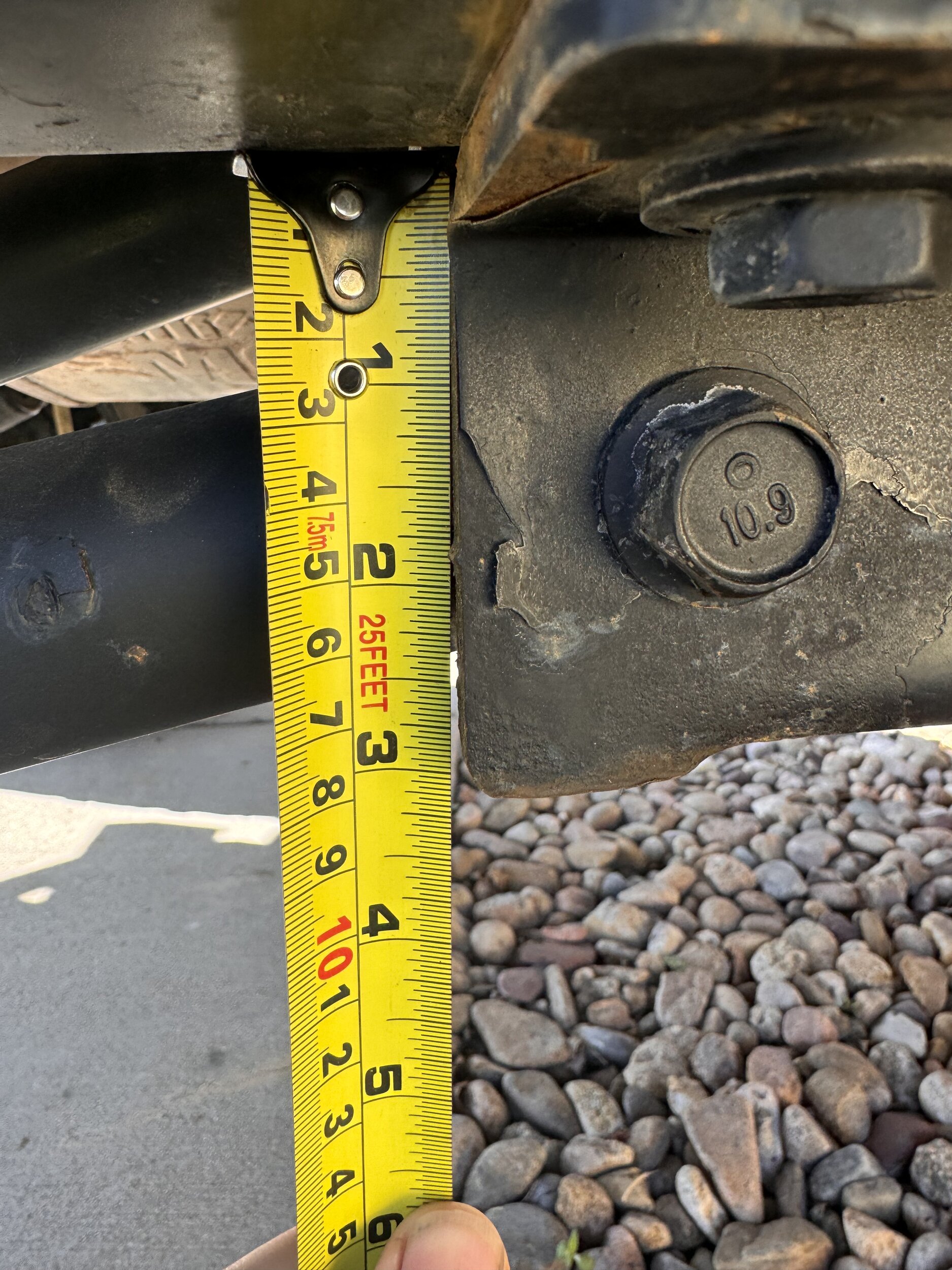

Measure the drop from the bottom of your frame rail to the bottom of the skid. We can compare to an OEM t-case skid.
Reactions: inkedrose
@deadbeat son Long arm kit is 3”. Skid looks like it’s just a homemade sheet of steel. Tapered from 26.5” front 32” wide in rear, 21” length.
The OEM skid is ribbed and ranges from 3.5" to 4", so it looks like you're raised 0.5" - 1". Without diving in deeper to measure the t-case mounting vs stock, I think that gives you a pretty good idea of the approximate difference.
UCF says their 3" skid gains approximately 1.5" over OEM, so maybe my measurement wasn't very precise. 🤷‍♂️
The OEM skid is ribbed and ranges from 3.5" to 4", so it looks like you're raised 0.5" - 1". Without diving in deeper to measure the t-case mounting vs stock, I think that gives yo a pretty good idea of the approximate difference.
