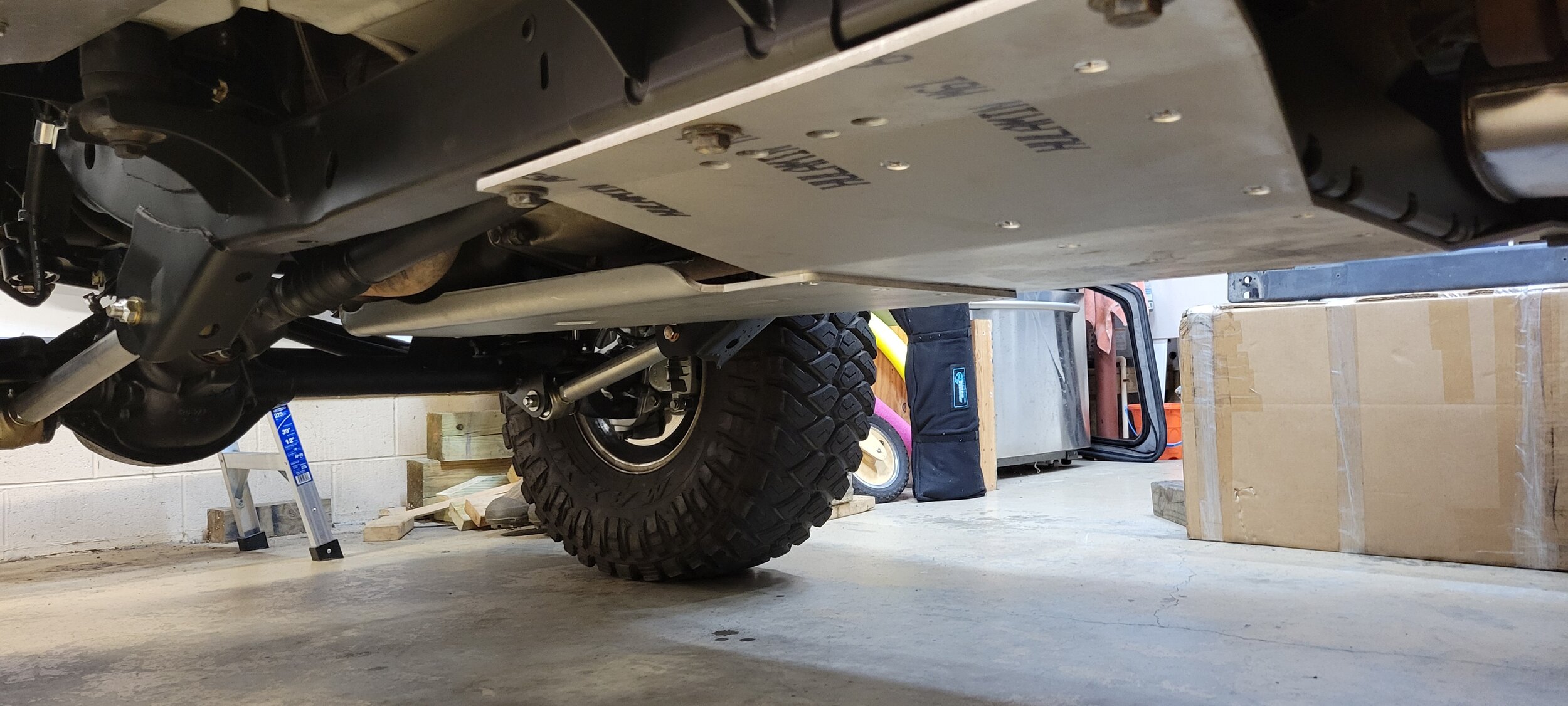

I haven't had this one in very long but it replaced my very dented stock skid.
The steel ucf engine skid I had was stout though. Just heavy.

Definitely looks the best design. Just looks like thin aluminum didn’t know how it would hold up to heavy bashing on rocks.

I will also add that crossmember underneath that aluminum is nice. You can removing for cleaning, driveshaft and exhaust maintenance.
When setting my pinion angles, I ran with just the crossmember for while as it was easier for front driveshaft removal and adjusting.
Hey @mrblaine or @jjvw, how does that thin piece of aluminum hold up to heavy bashing on rocks?
1/4" aluminum doesn't hold up that well on its own, but neither does steel plate. The bracing is very important and the Savvy does that part very well. The design allows a fairly deep cross section in the middle with a low overall footprint.
Reactions: jjvw and tworley
Yep, most people overlook the design and that cross member. It’s a fine piece of engineering.
