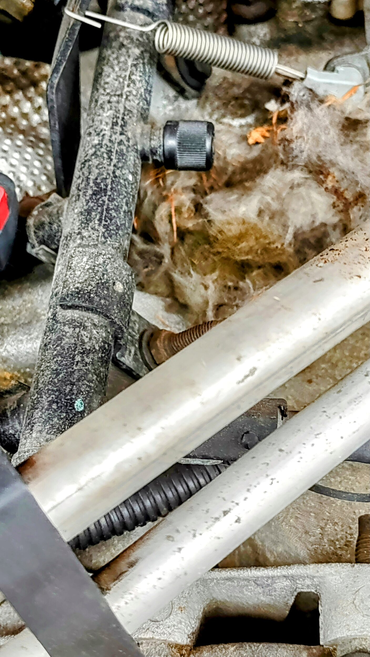

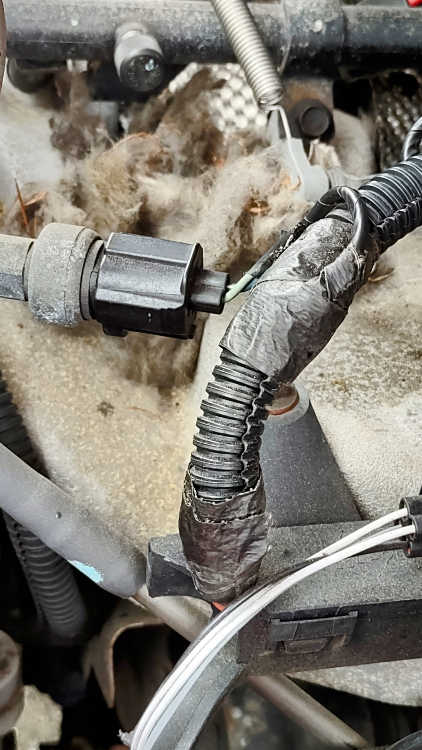

Had a rough day yesterday. Picked up my TJ that I can't park where I live (HOA rules about having 3 cars). Checked the oil and found this mouse nest. Everything is working so far. I need to drive it more to make sure they didn't chew through the wiring anywhere. Went home and cooked some food on the gas stove. My wife came home 4 hours later, opened the front door and started yelling, "THE GAS IS ON!" She got a headache within 2 minutes and immediately left. Stove was on high with no flame on. I had headaches, sore throat and a little dizziness. About like I feel every day. :unsure: She wanted to take me to the emergency room, but I pointed out that the damage was done. Nothing they can do. One of the drawbacks of being born with ZERO sense of smell (Congenital Anosmia) I guess. I ordered a natural gas detector this morning so I don't blow up my neighbors. I thought the carbon monoxide detector was for that. :unsure: Still feel like crap.View attachment 637089

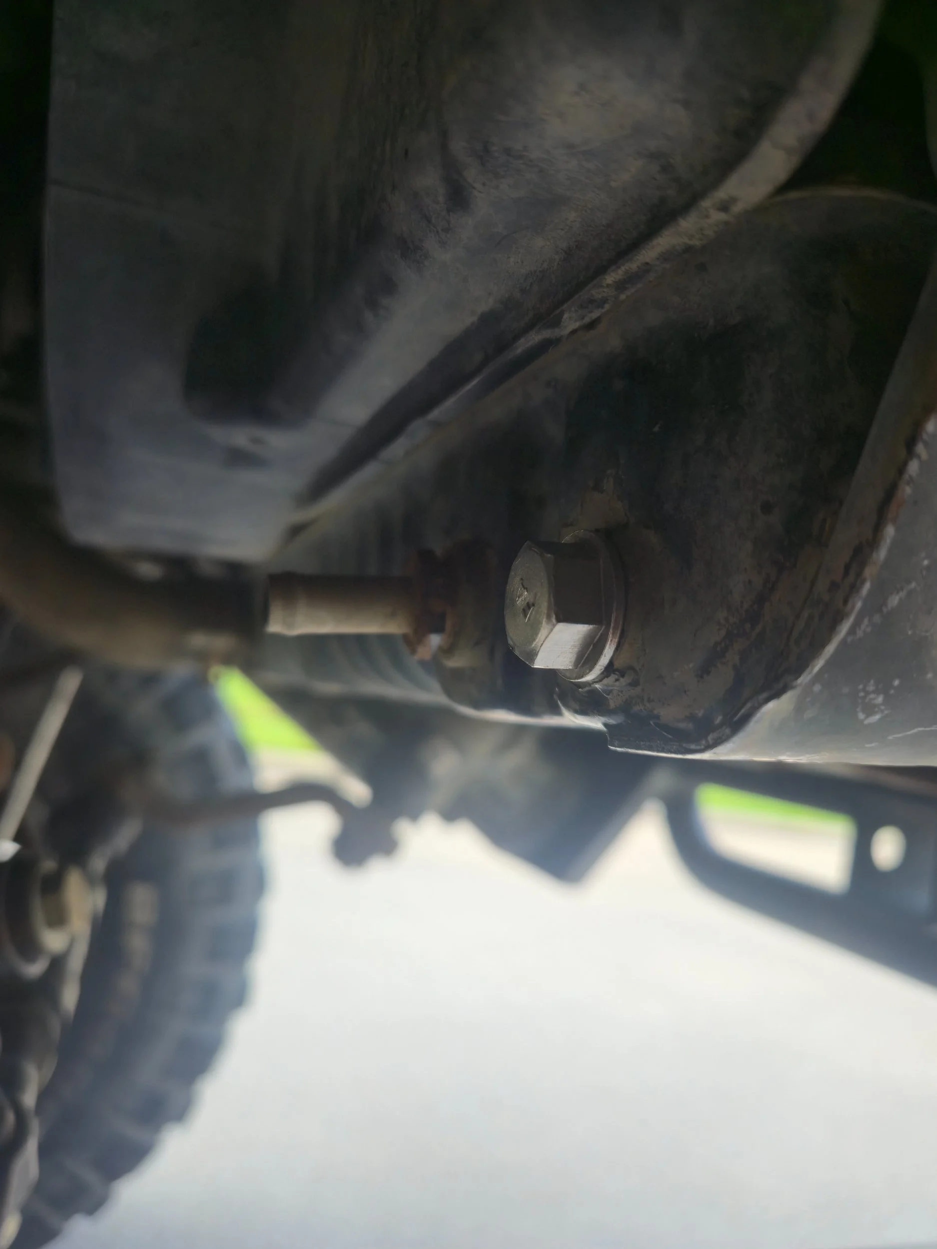

Noticed my radiator suddenly developed a steady drip from the drain. Thinking it just came loose, I went to tighten it and the plastic essentially crumbled in my hand. After two trips to autoparts stores who said they have a replacement but didn't I dug around my hardware bin and found a stainless bolt that threaded in the drain hole. Added an o-ring and no leaks after a week of driving.
