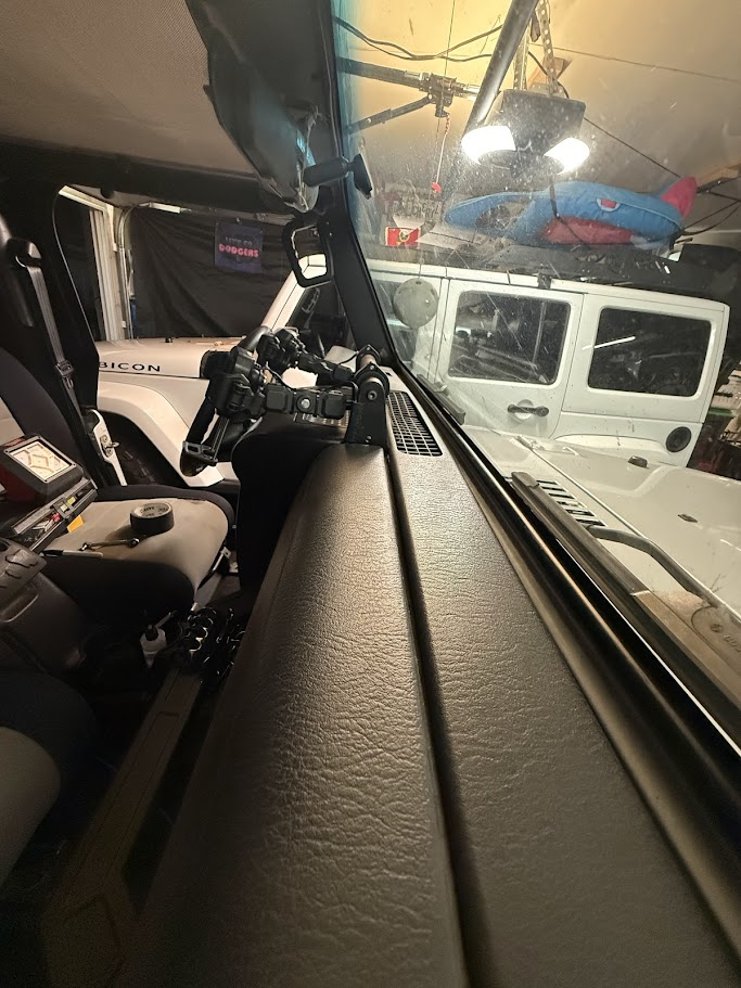

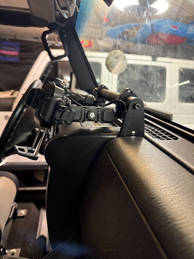

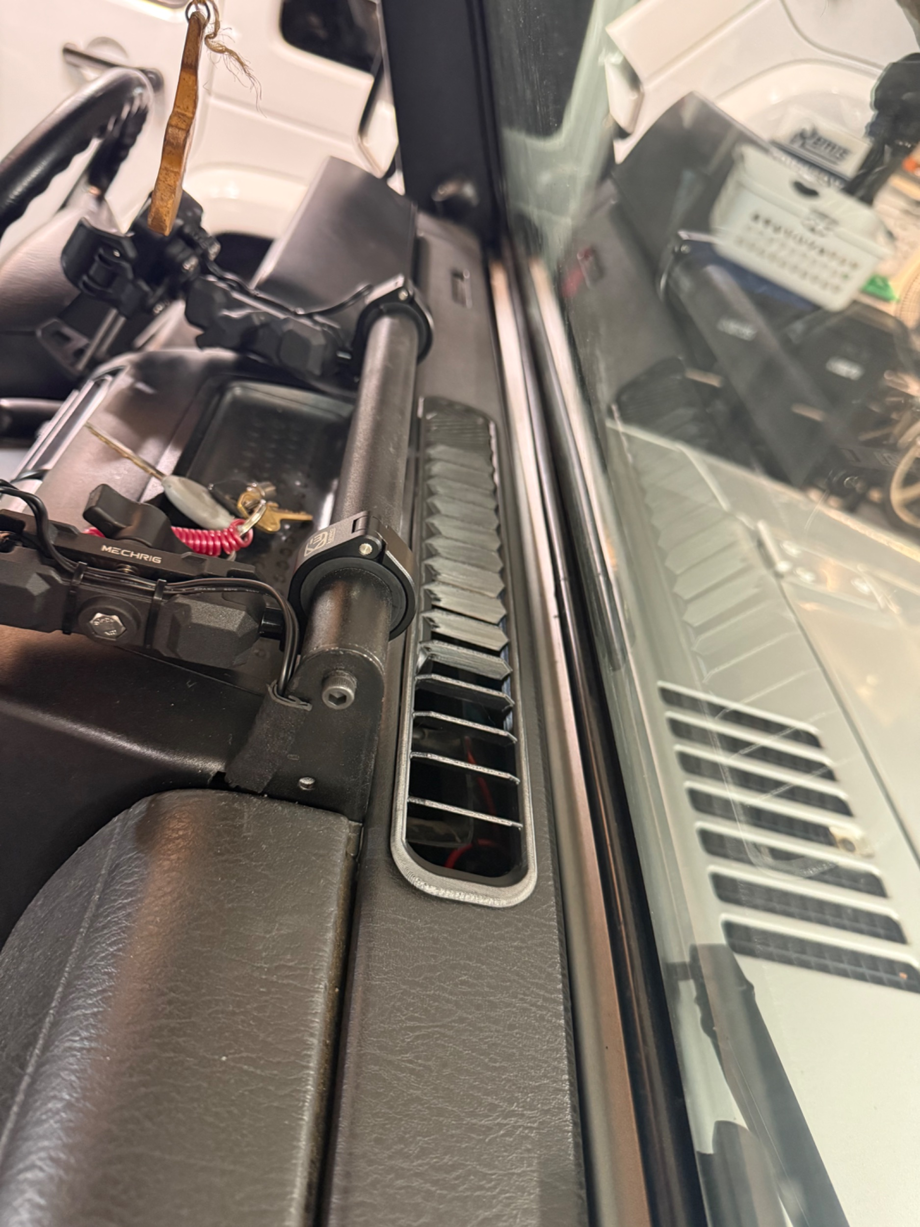

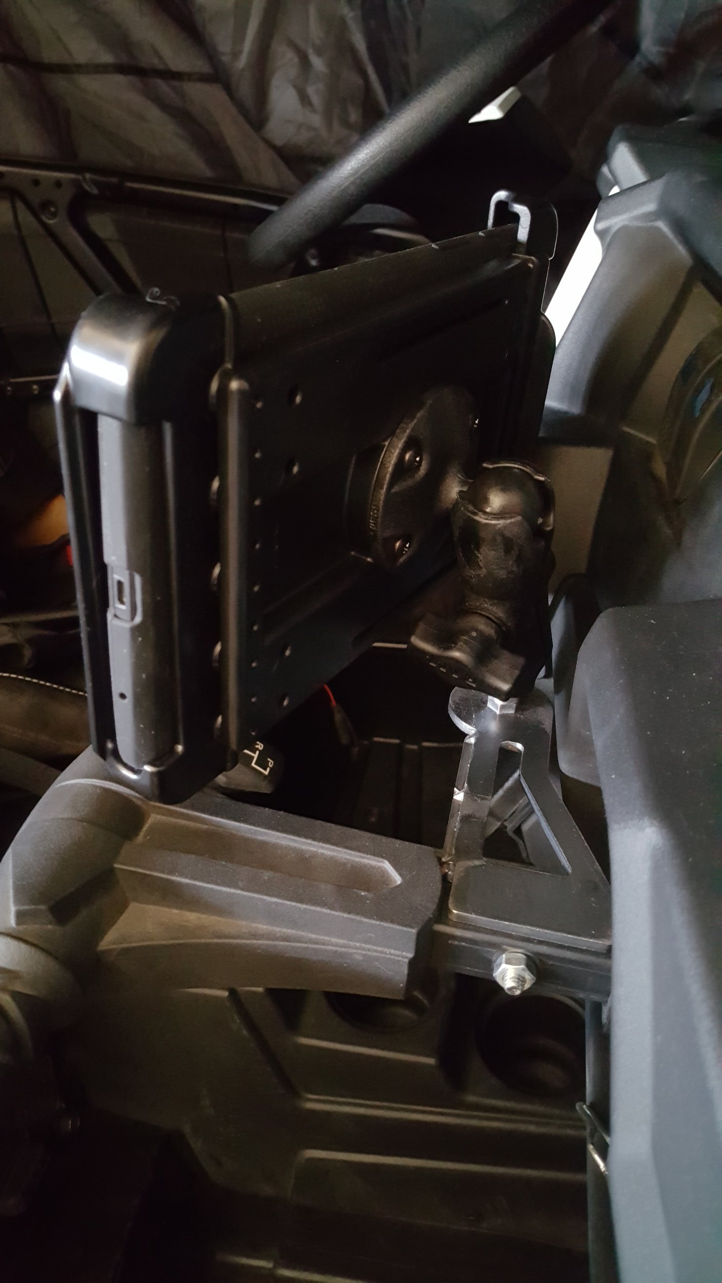

You kind of need to sit in the drivers seat with the tablet in the holder with an arm on it to really see what you need.
I wanted the tablet pointed right at me and I didn't want it blocking the vents or anything else.
That tab on the bottom was my final attempt to address the bouncing. That tab may have helped a little, but the steel right there isnt super stiff and it still moves. The bounce is due to the dash flexing at this point
My buddy and I both use that location for our nav tablets (my Samsung on RAM docking and his Apple on a similar) but we're using RAM "claw" mounts clamped to that grab bar. I like your custom fab much better! We both had bouncing due to dash flexing. My solution for both TJs was combo of HDPE pullman loops plus length of 1" Velcro One-Wrap, with the loop attached to the dash trim panel at the windshield. Its not a perfect solution but does act as an overtravel limiter to stabilize the device.

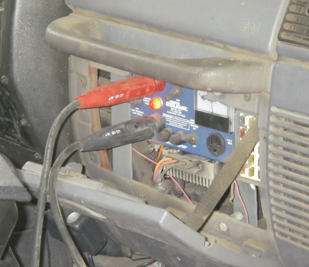

While maybe not totally custom the way Jeff & I mounted our onboard welders control box into the glove box area might be a little custom?
Which is why I asked... But then you could say if something had to be modified from how it was offered it might then be custom? Or just one off?
Yes. Yes, that would be considered custom lol.

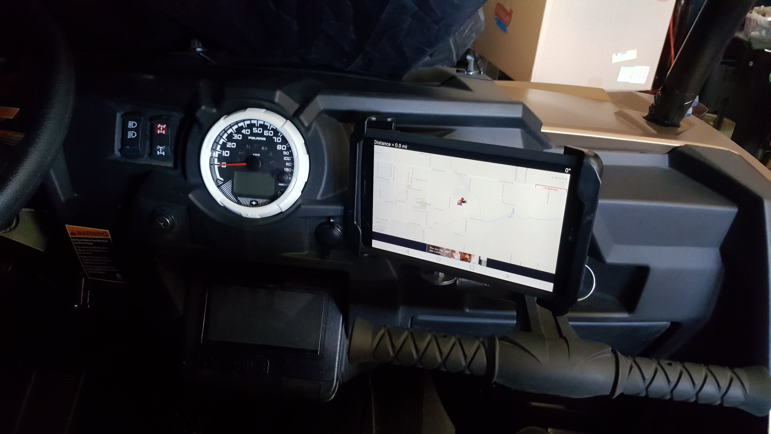

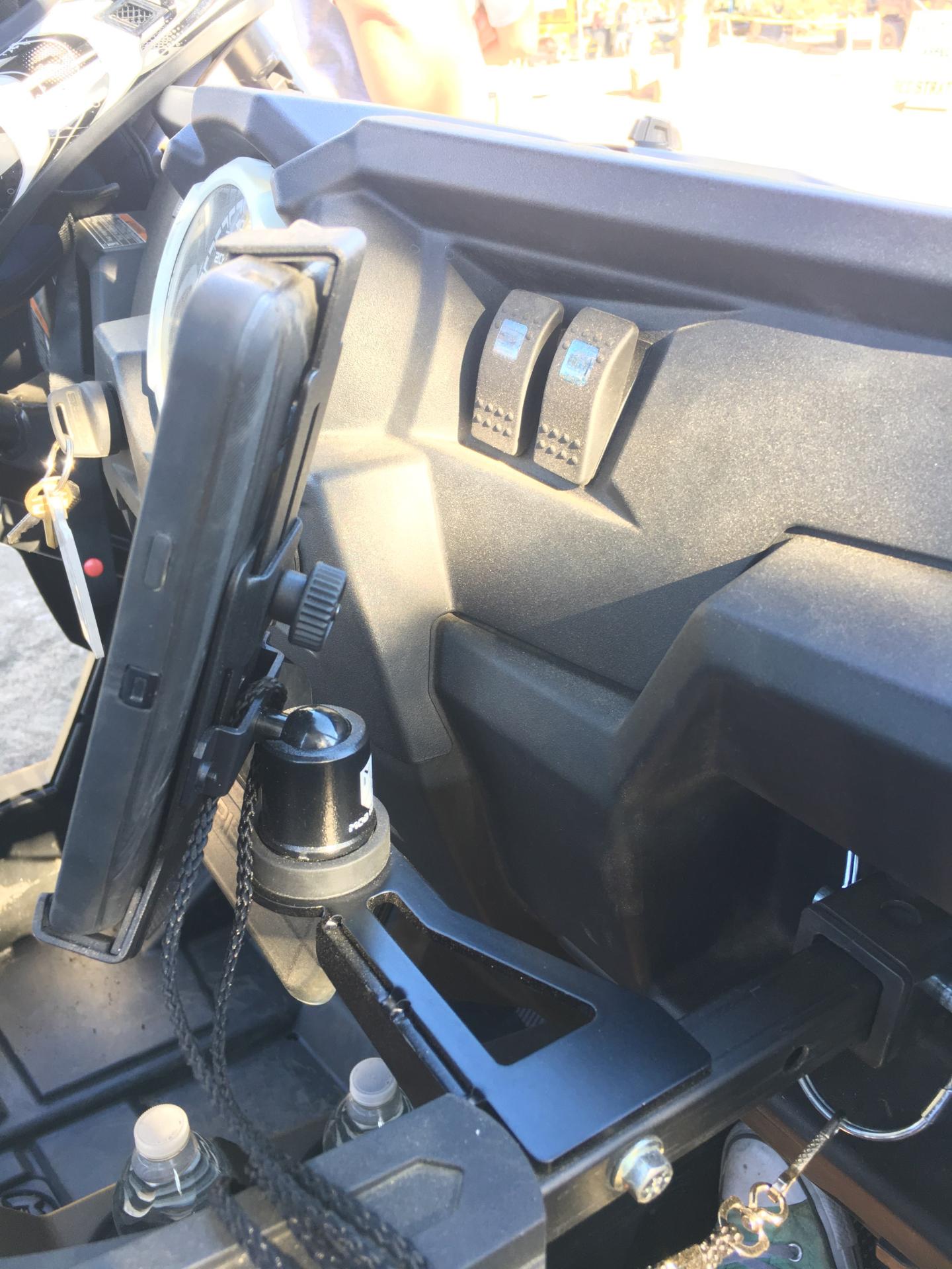

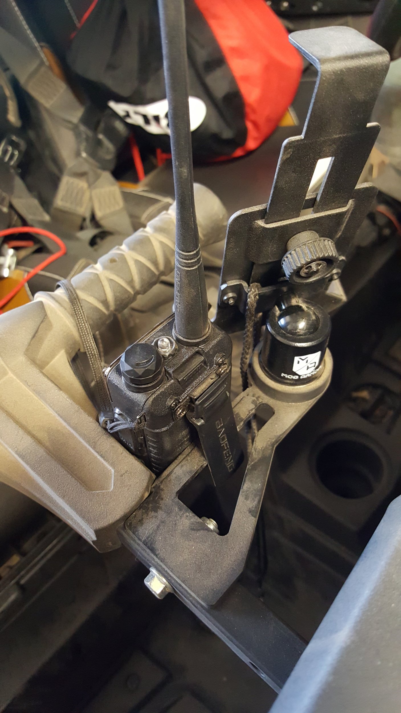

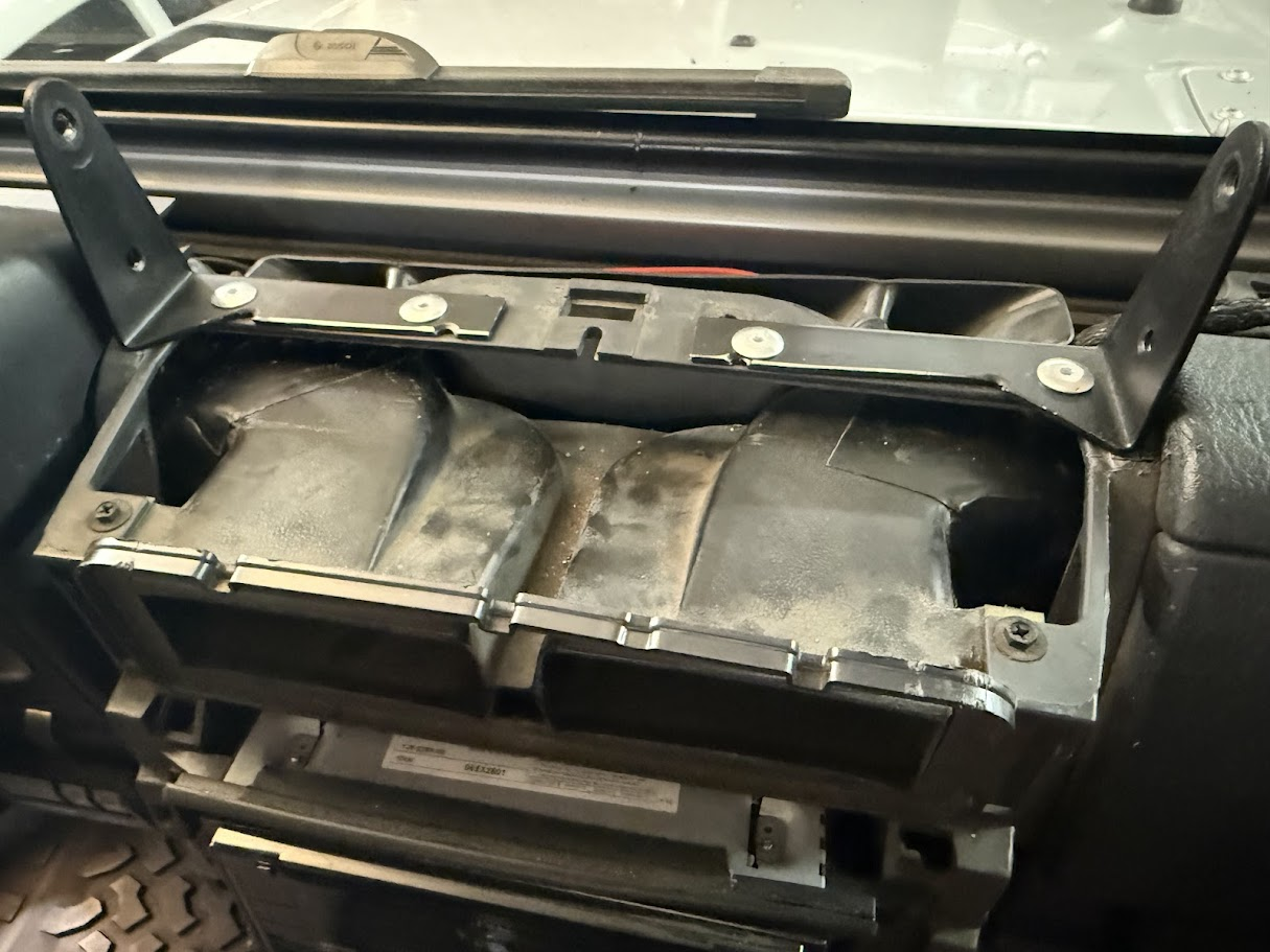

I could send you the DXF. You could leave the dash mounting points alone and just mess with the mounting arm in CAD.
The three hole pattern is for the Bullet Point 20mm balls. The center hole is 1/4" I was using with RAM 1" balls with 1/4-20 attachment.
Idea in the beginning came from a Mob Armor/ 1" ball mount I sell for a RZR grab handle :D
Yeah that would be awesome! Thanks!

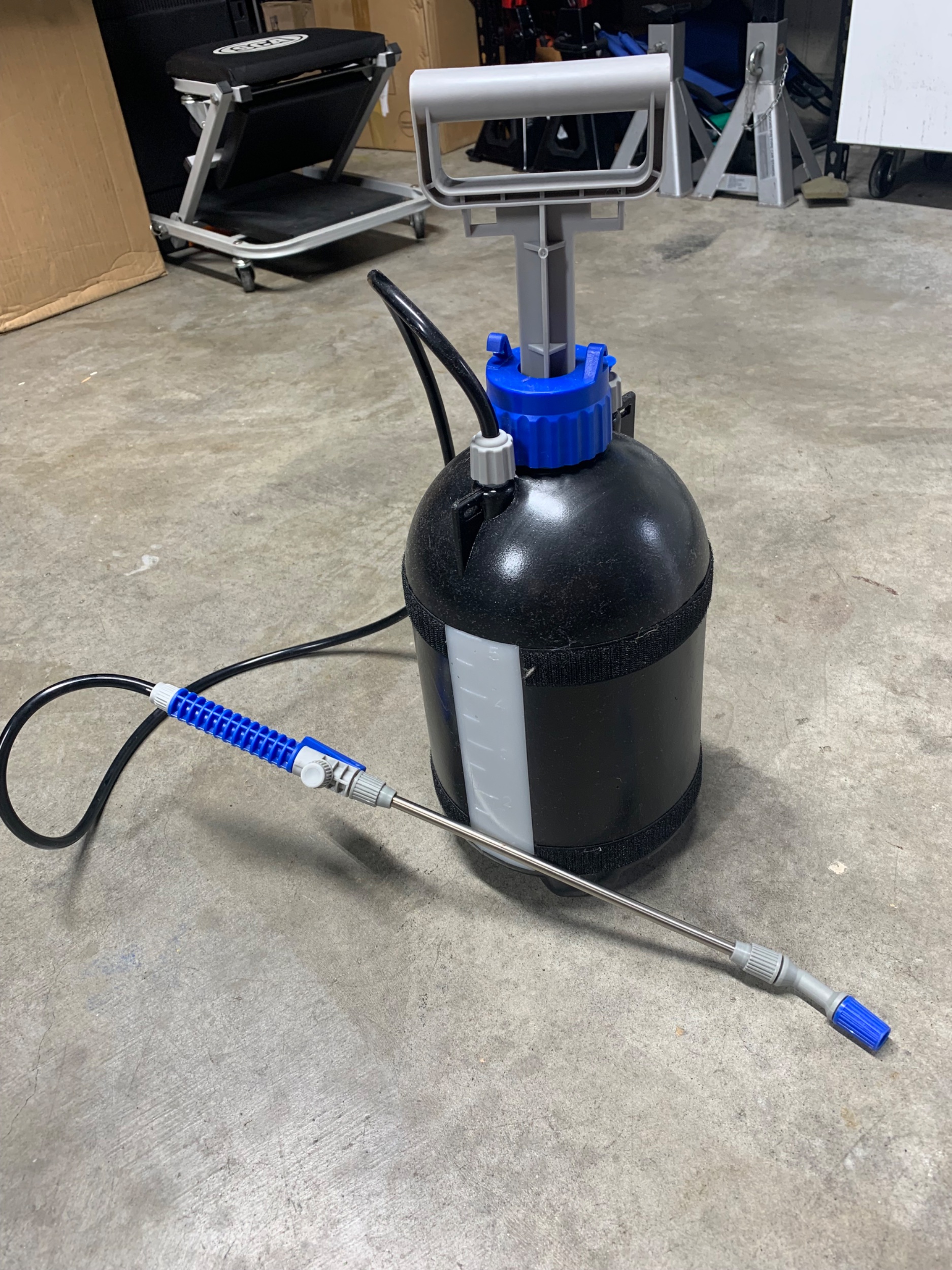

I just use this....😂 .a weed sprayer $15.00 painted it black so it gets very warm in the sun...I added some velcro so it doesn't roll around on my rear shelf..

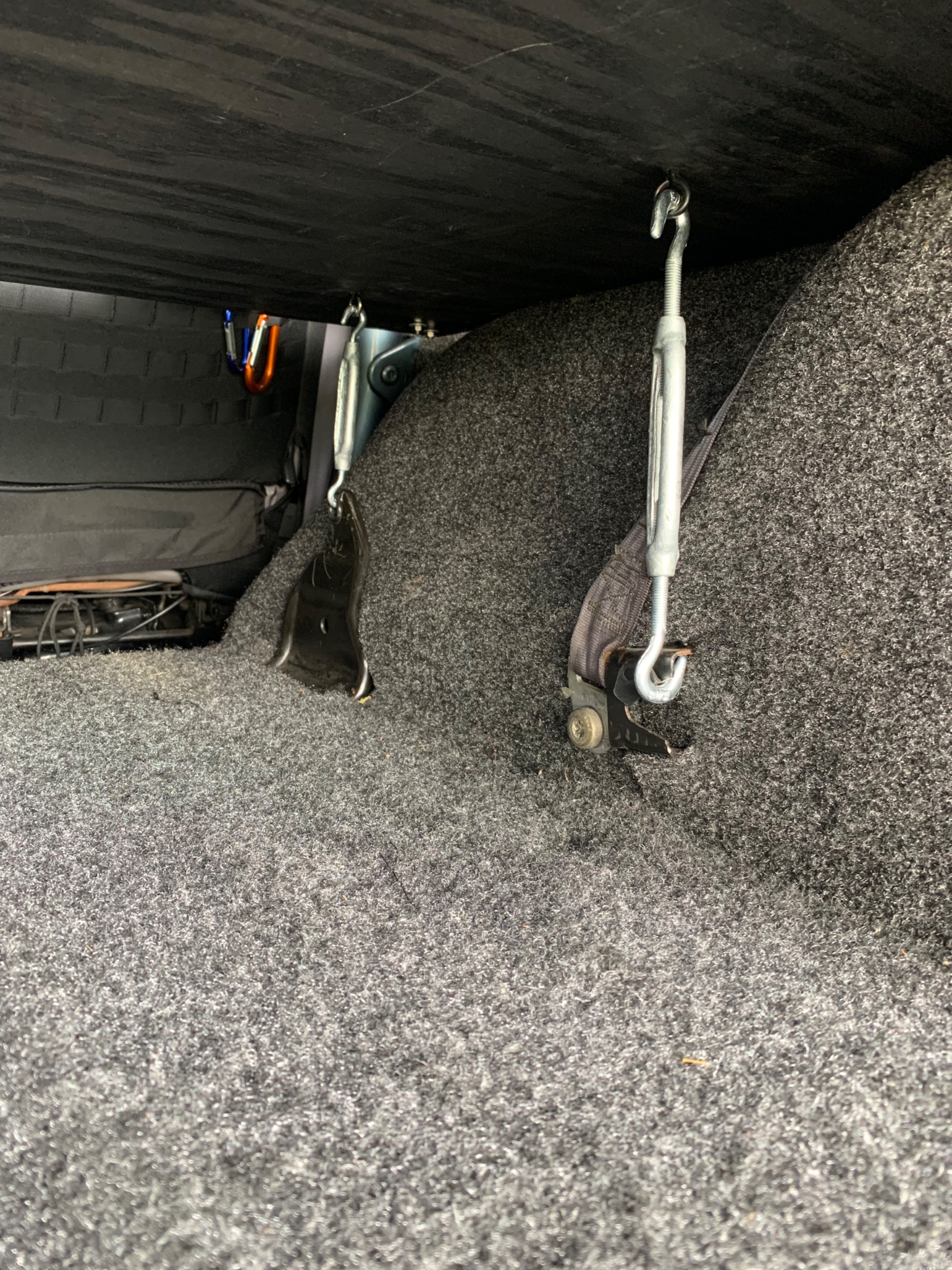

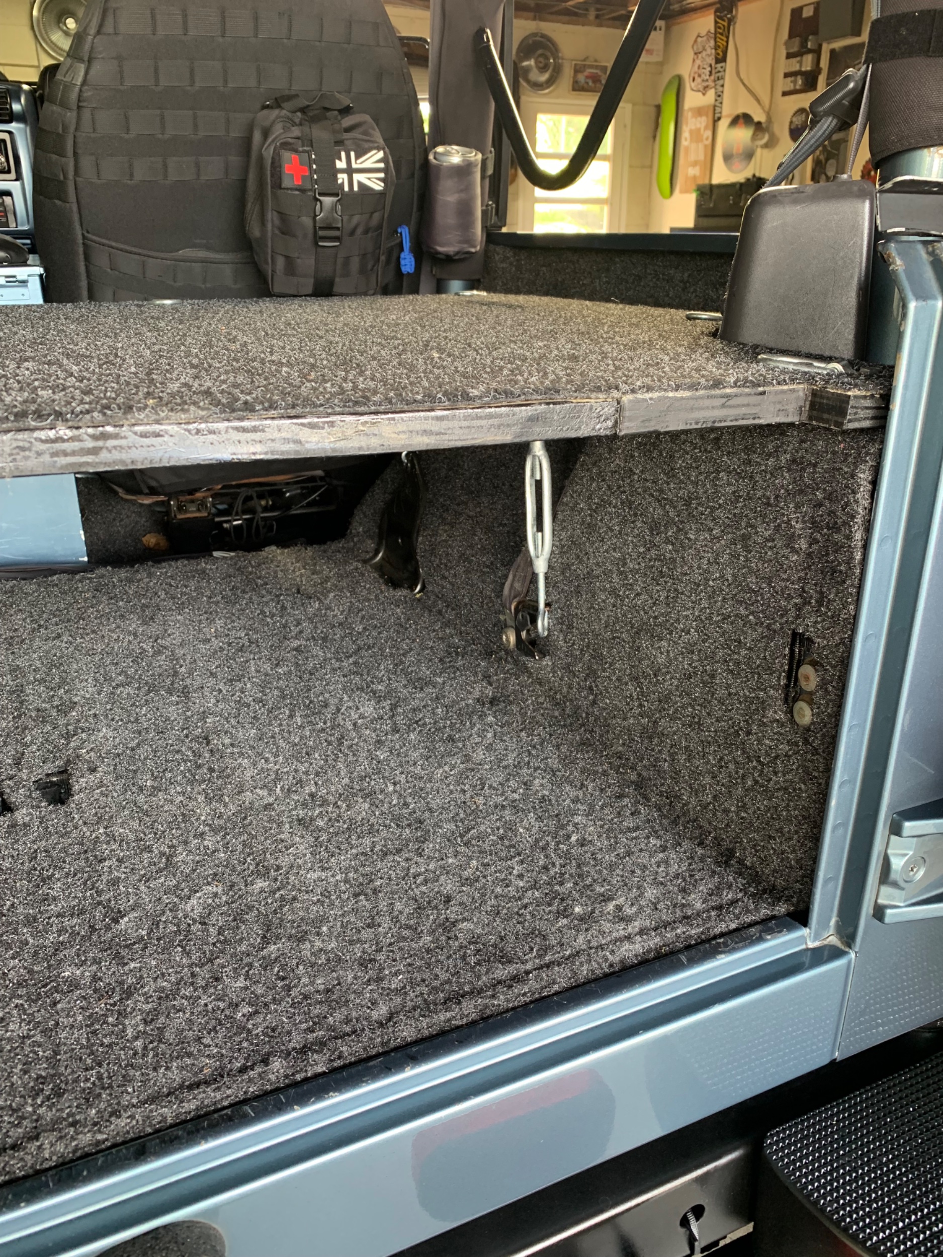

Did the rear seat delete And added a shelf… wanted to find a way to secure the shelf to stop tea leafs ( thieves) lifting it up and helping themselves.
Found these in marine part of the hardware store… I can tighten these down from underneath and secured to the existing hardware from the rear seat..the shelf does not move.

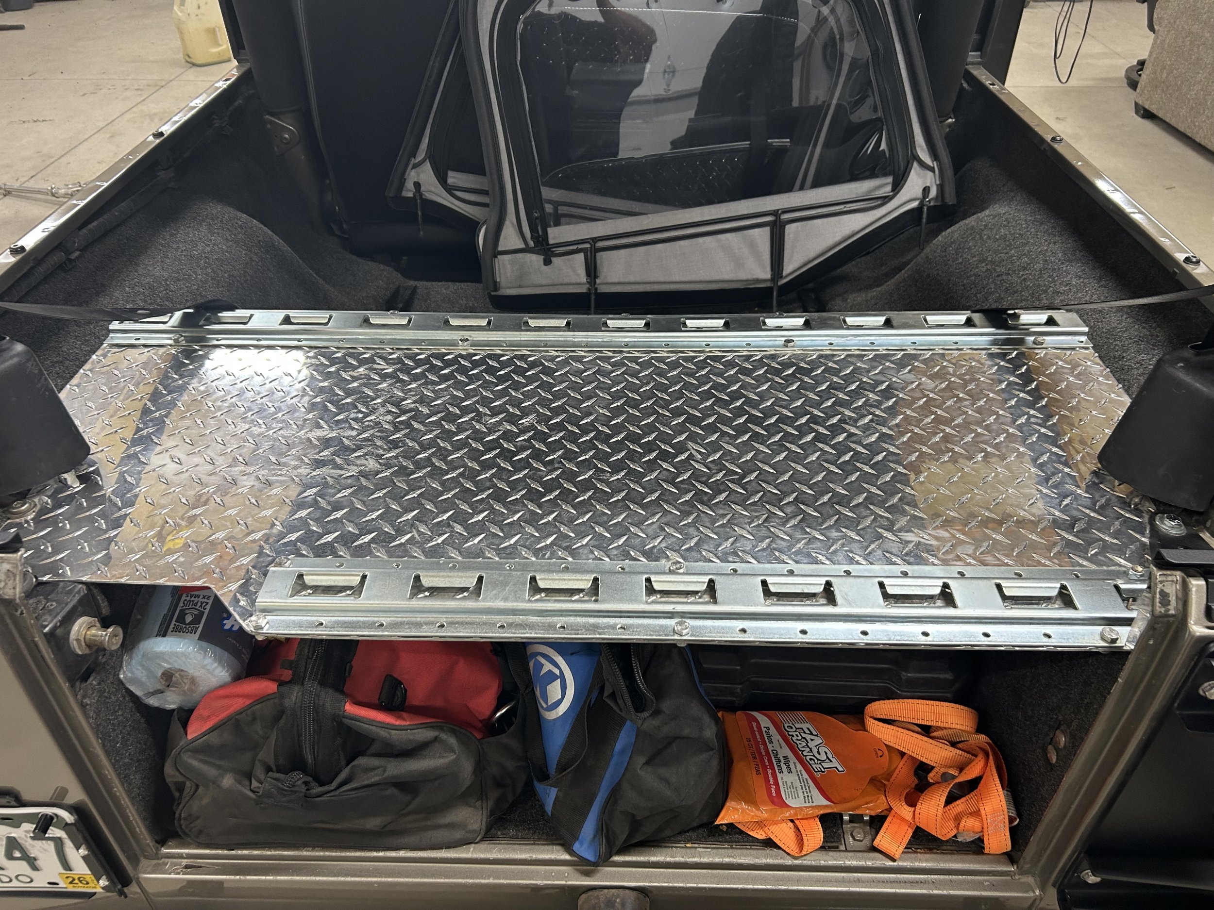

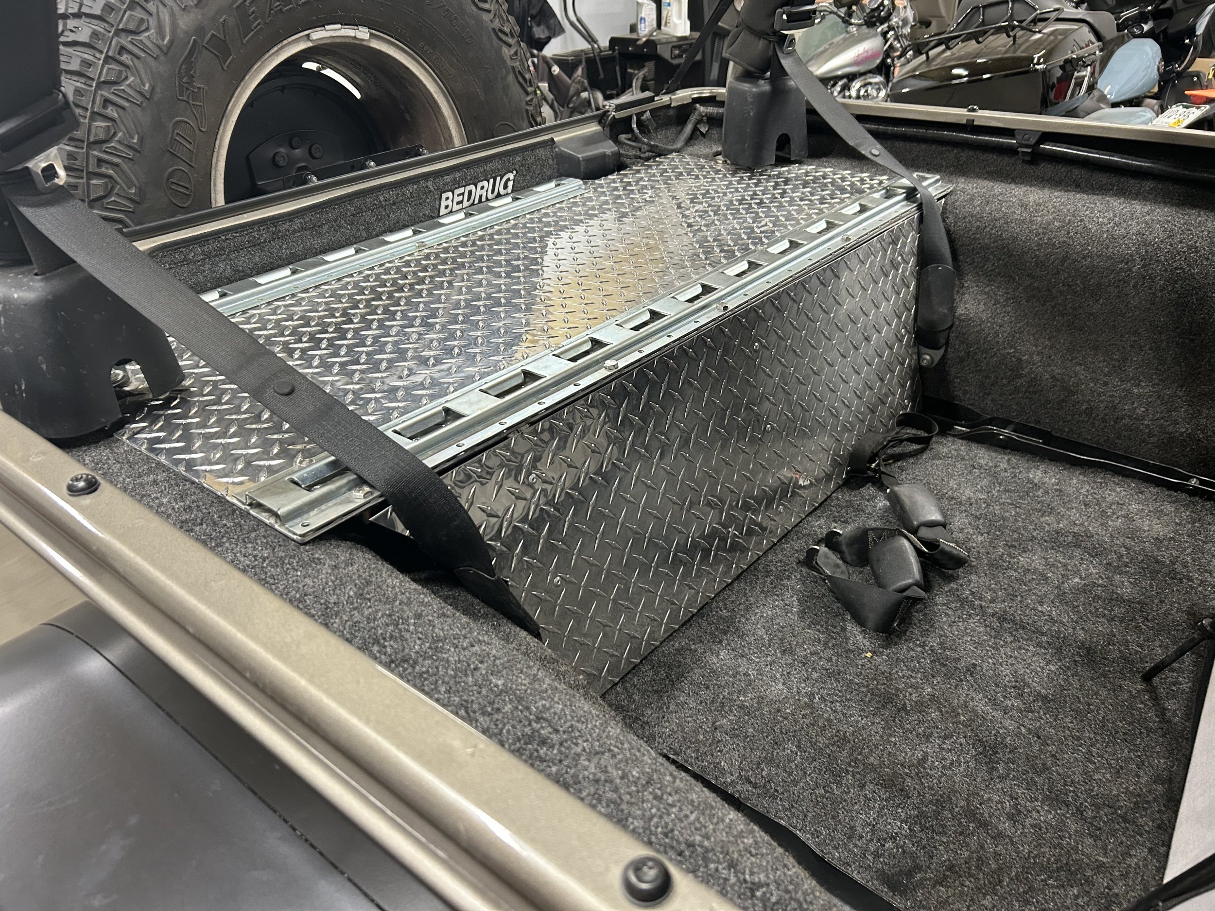

I built something similar in my LJ, but the rear seat still fits. The top uses the rear roll bar bolts and the front of it has a frame made of 1x1 steel that shares the rear most seat mount bolts. Locking the tailgate makes it secure enough for what I need it for. Also added E track to the top to strap down coolers and such.
Nice work… being an LJ you do have an extra room to keep the rear seat… I left my rear seat brackets in there as occasionally I need to put it back in.
The beauty of custom is you make it do what’s right for you and your needs..

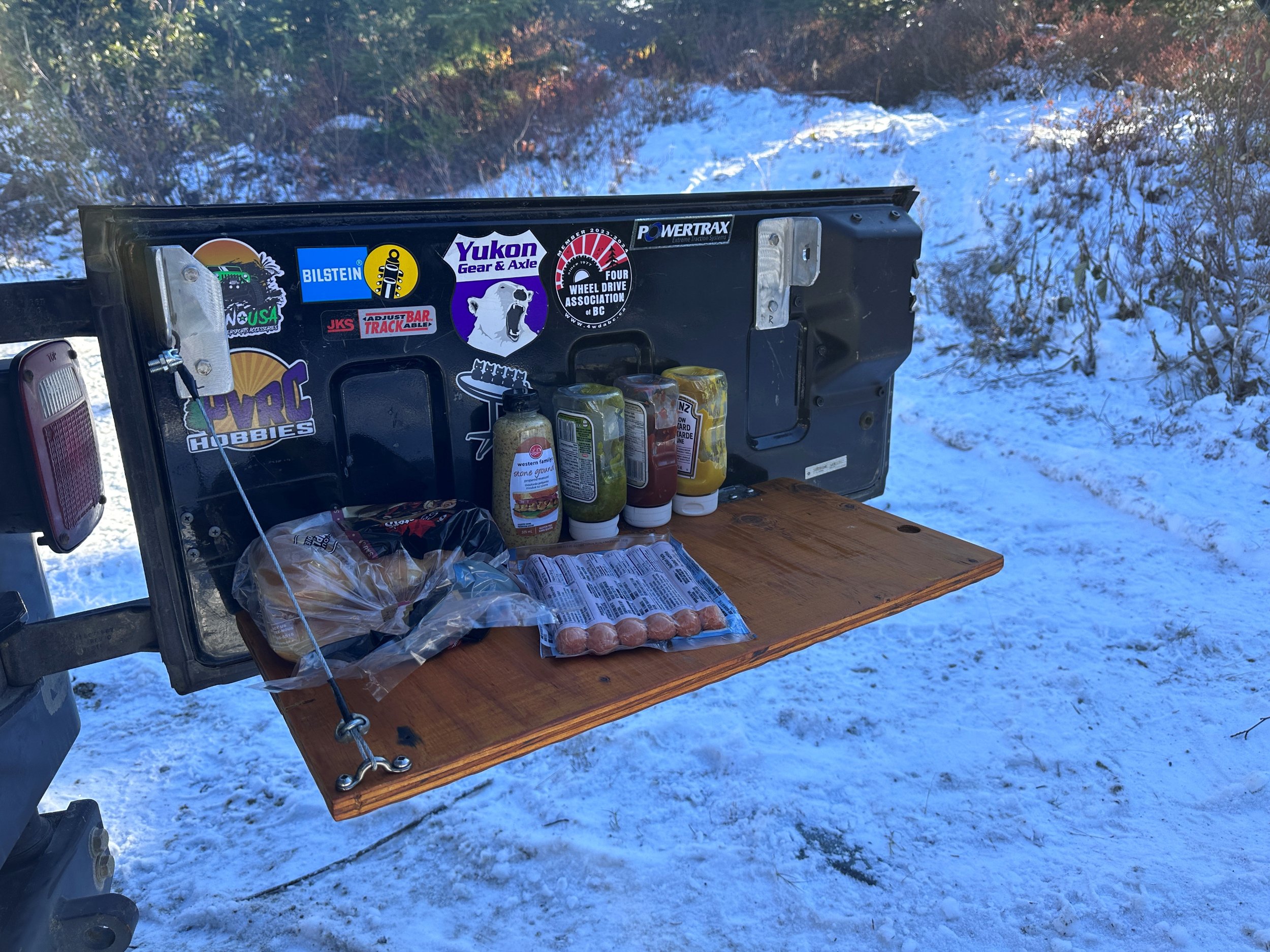

old photo since I've added a holder for a small axe and machete to the underside of the table but this is by far my favourite mod I've done to my jeep. I just used whatever was laying around the shop one afternoon and it turned out great!
Totally agree I use mine every week…
Reactions: thedustyboot
Any documentation or pic on how you installed that? Did you make it or buy it? I like it!

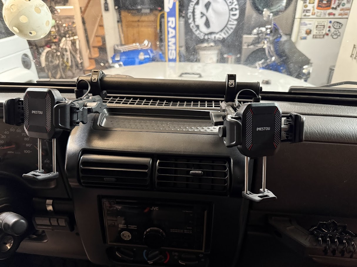

Thanks!
I built it because there was no good place to put the phone other than the floor in the TJ.
I had a mount between the grab bar and radio face, but it flopped around and I hated the charging wire hanging between the phone and the power port; it was either 'in the other car', under the damned seat, or tangled up around the shifter, etc.
I also had a similar mount that fit in the same area on the driver side, but the steering wheel blocked the phone screen when it was mounted low enough to see over/around. It worked as a place to secure it, but it wasn't much help if you wanted to use it for maps, etc.
I saw another member build a roll cage/ cross bar over the entire dash to secure radios and switches to, so figured I could come up w/ something similar.

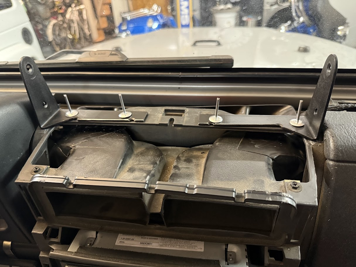

It's literally only 2 L-brackets riveted to the dash structure and a 1" diameter aluminum rod that I drilled and tapped the ends on.
The radio bezel comes on/off without removing the mount or phone holders.
I thought about mounting an inclinometer like this in between them, but that's as far as that went.
