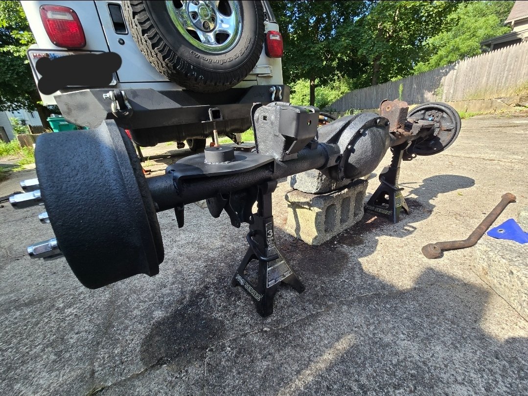

get rid of that cinder block. If you must use one put the cores facing up and put a piece of 3/4 plywood on it.
Oh, it's really not doing anything, there's no weight on it, the Jeep is on a pair of jackstands. It's my overthnking.... What if someone decided to jump on the back bumper..... So I just stuck the bottle jack there as an insurance policy.
But I will switch it up, you're not wrong.

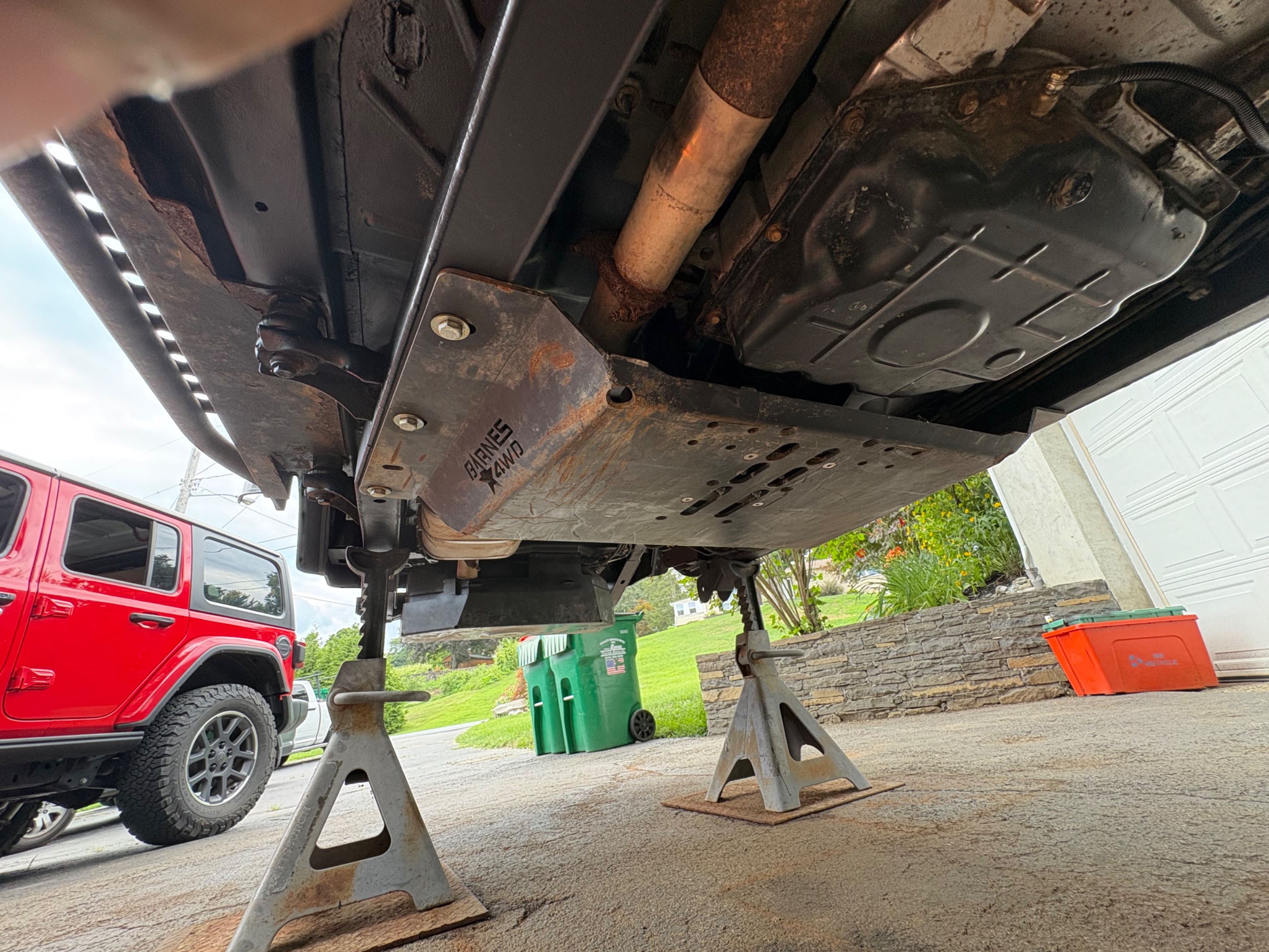

Belly skid installed and torqued.

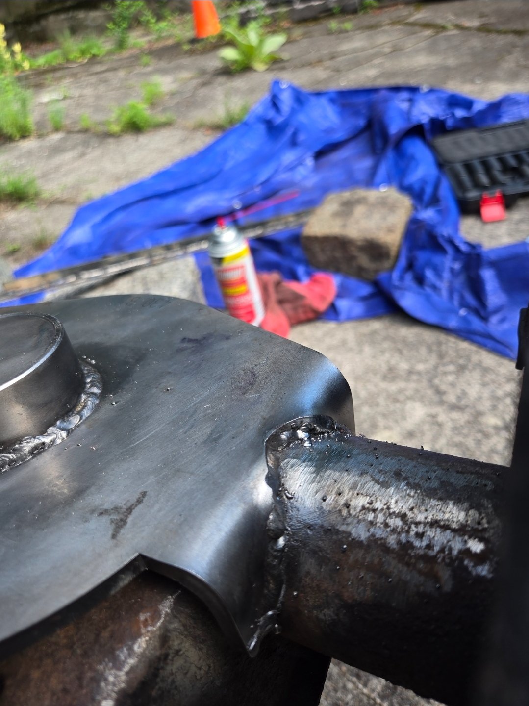

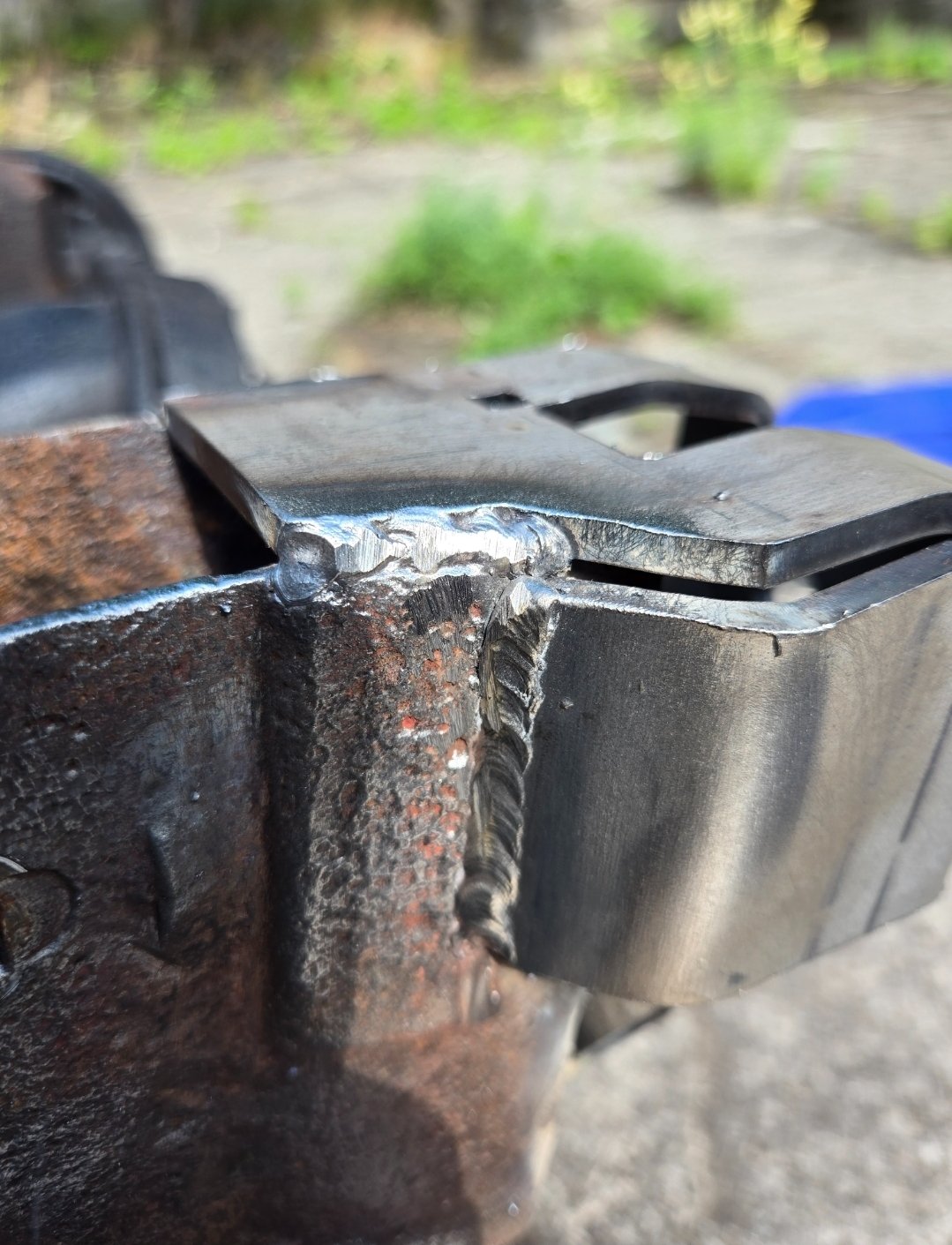

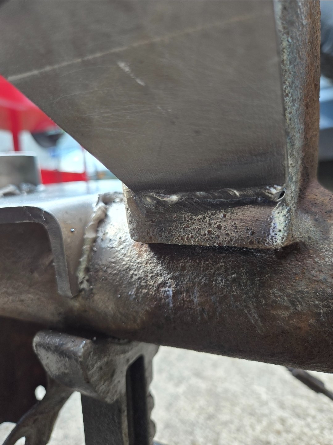

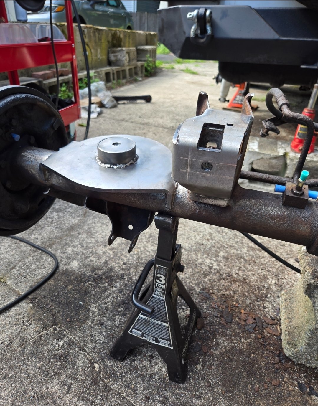

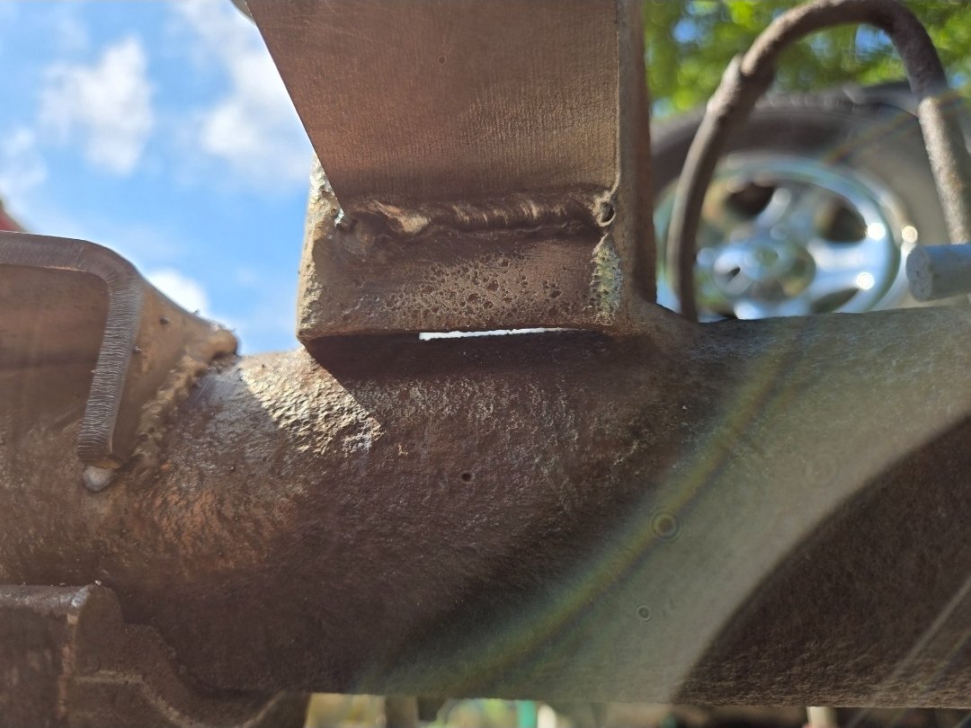

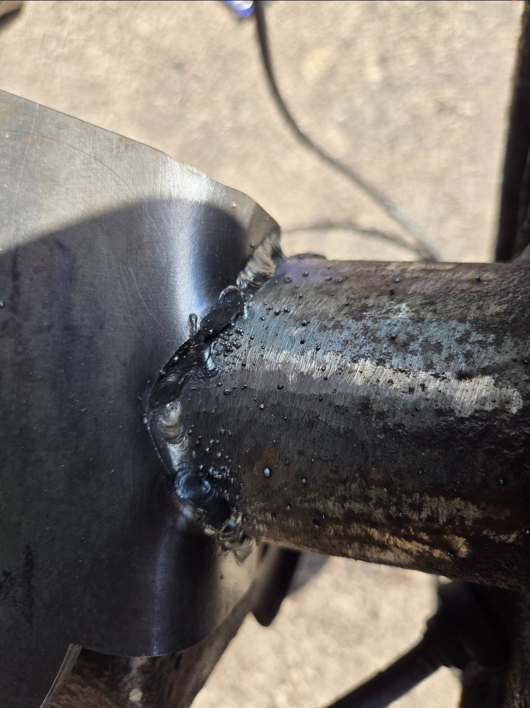

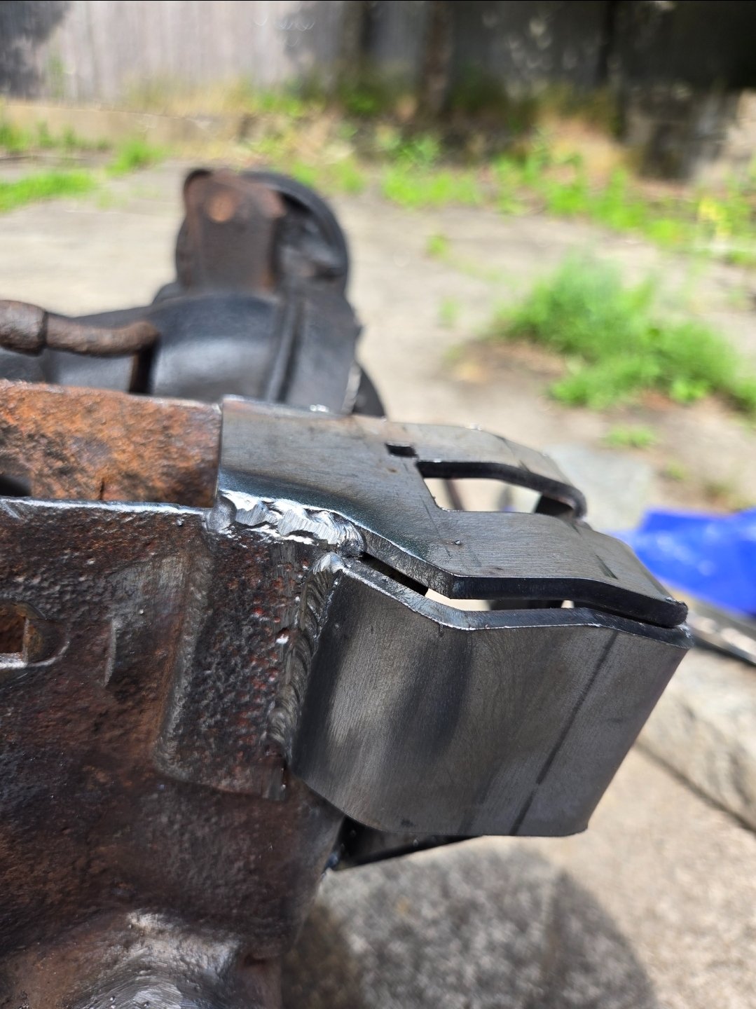

Pulled the trigger and welded on the new spring perch and track bar bracket. Measured distances and angles of the old ones, cut them off, ground off the excess, then went to work. I still have the other spring perch to do, then I'll finish cleaning it up and throw it back on. View attachment 631756View attachment 631757View attachment 631758View attachment 631759View attachment 631760View attachment 631761View attachment 631762View attachment 631763
I truly don’t want to be disrespectful, but there is certainly a lot of cold lap, and undercut on a lot of those welds. I would suggest you consider looking for some side by side guidance and get a second opinion prior to relying on there strength and longevity.
Just sayin.
Just sayin.
You're not being disrespectful at all, it's helpful. Someone else has already reached out suggesting that I grind some of them off and redo them.

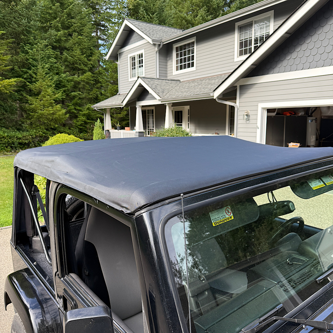

Well we had a sunny day but I still struggled to get the new top loose enough… read a few posts here and apparently the OFFICIAL Bestop directions may NOT be the way to go! 🤣
I removed the rear flaps from the groove, got the windshield clamps hooked then everything fit right in place.
Tomorrow will be another adventure when I try to get the windows in!

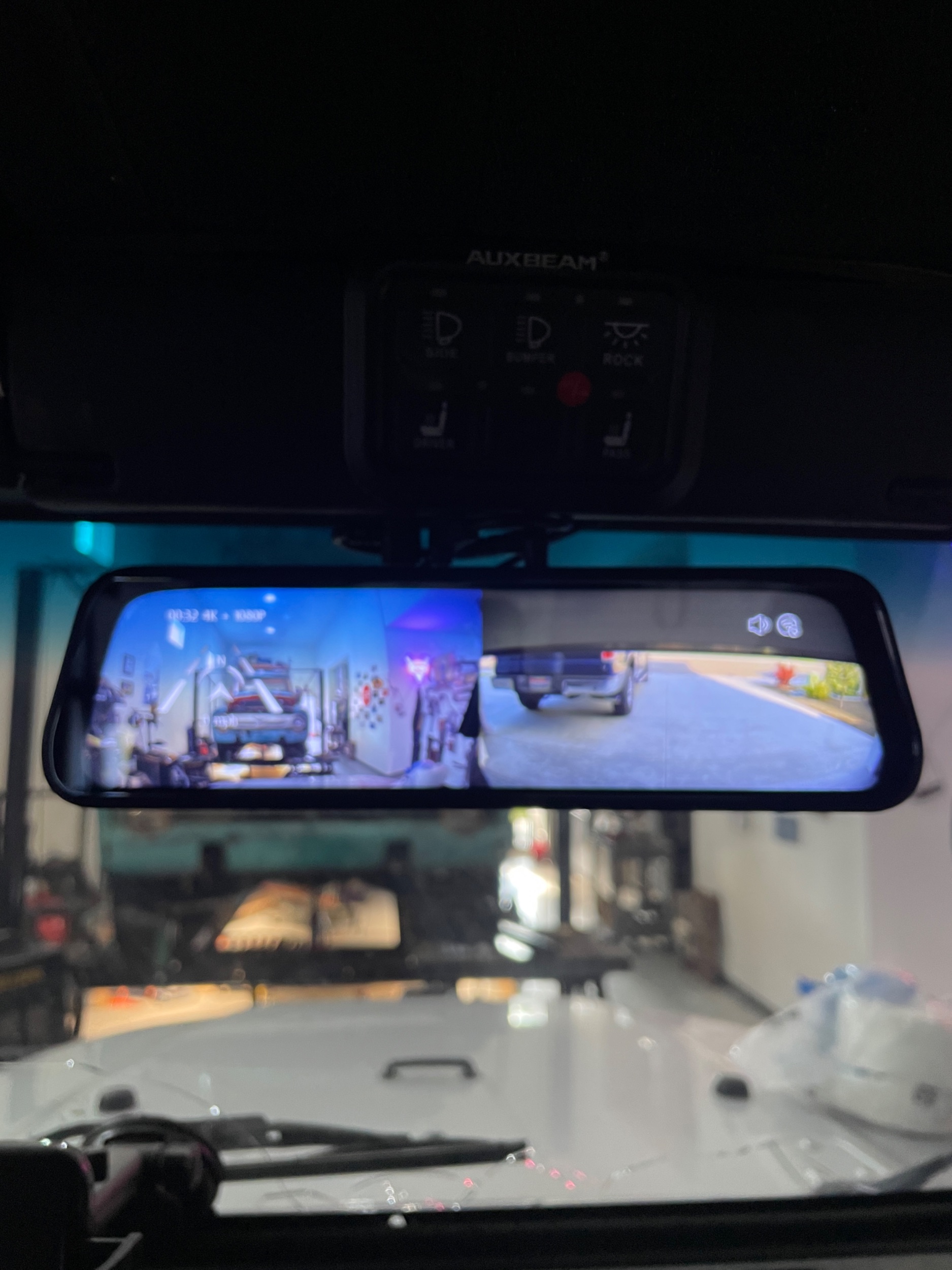

Drilled and mounted the Wolfbox rear view mirror camera. As I need to drive down the hill because the Loctite did not hold the weight of the mirror and it’s just sitting on my dash if figured I’ll get a pair of stainless nuts and bolts so I just zip tied it in place.
My radio has an input for a back up camera.
Anyone know if I can splice the wires and use one camera for both? I will need the rear view always on and the back up on only when I’m in reverse.
Also anyone have a link to the write up for the three contact mod between the back door and the interior chassis?
