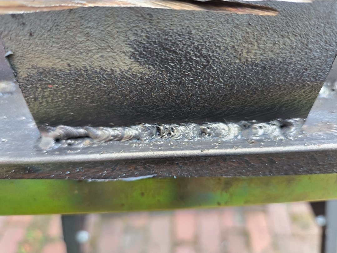

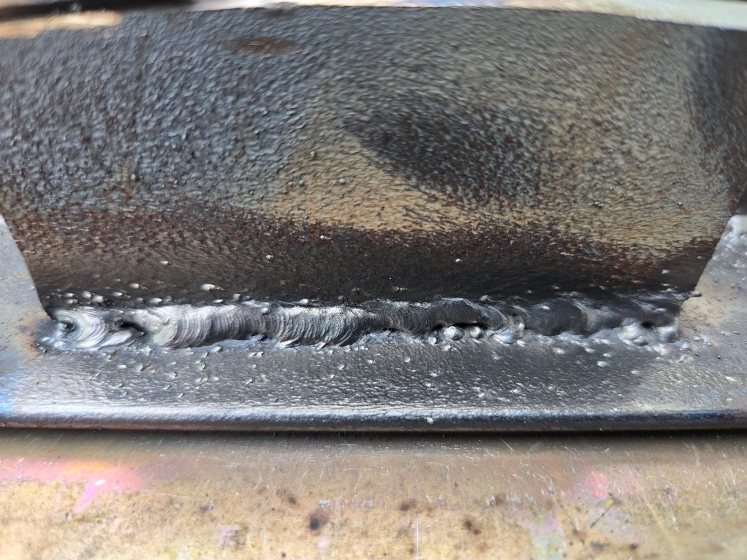

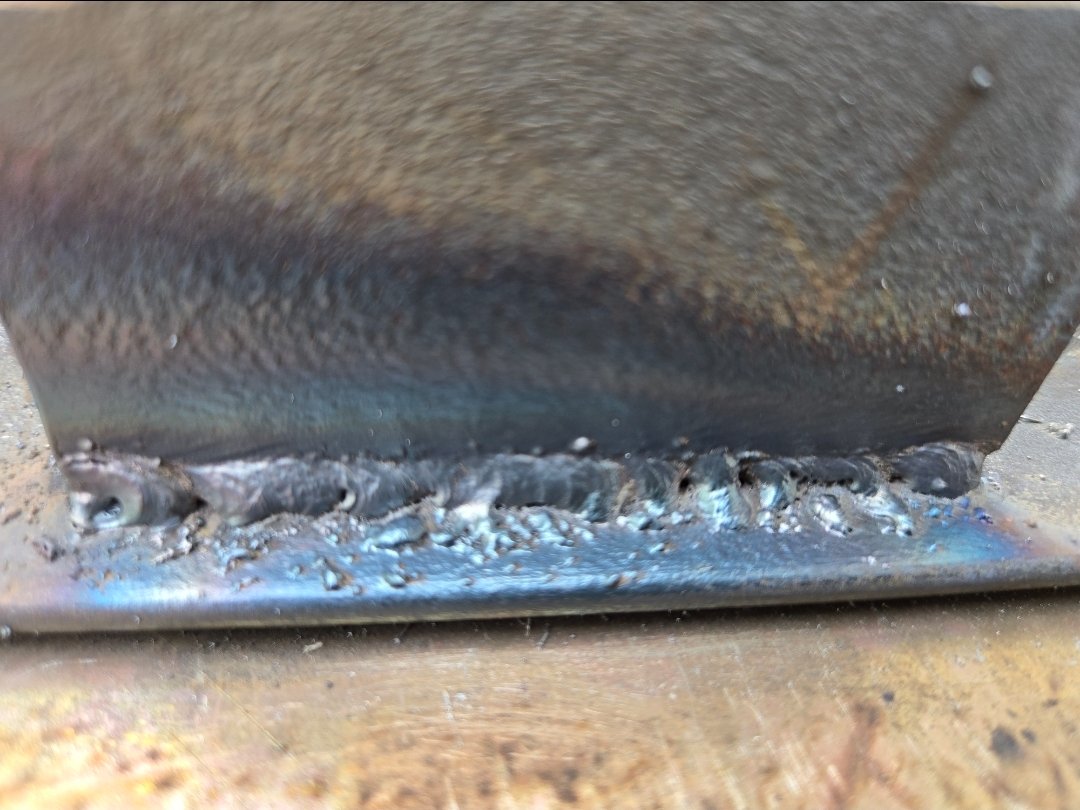

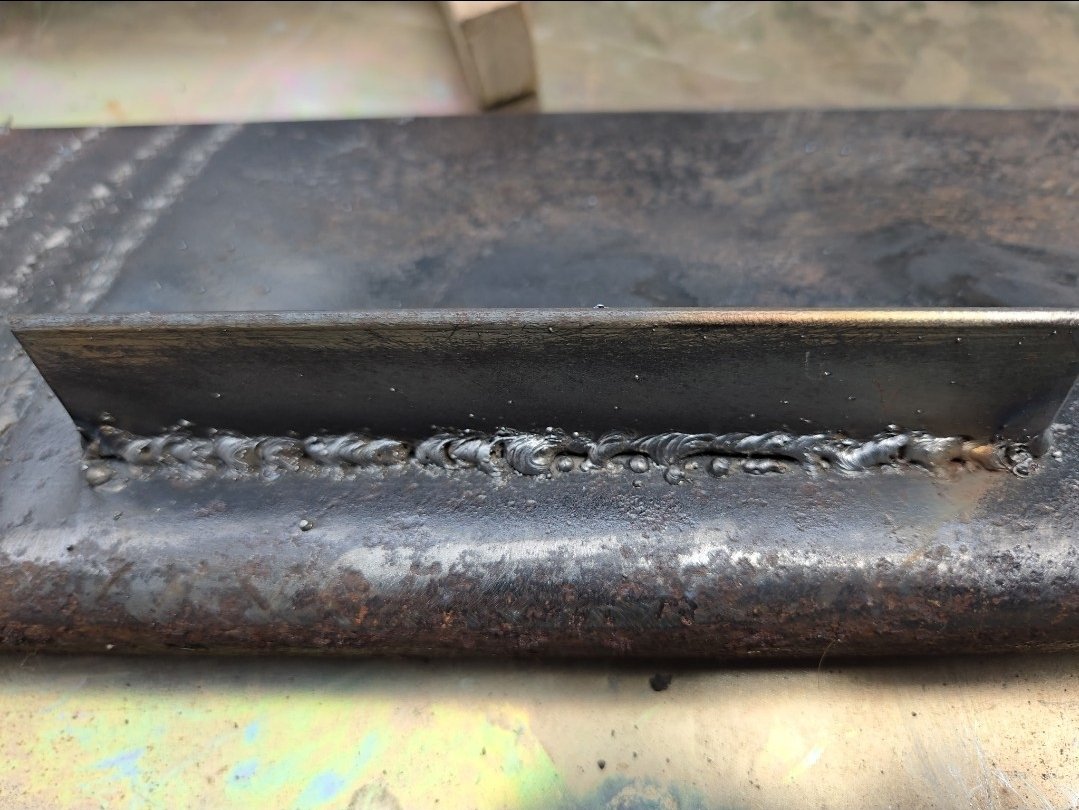

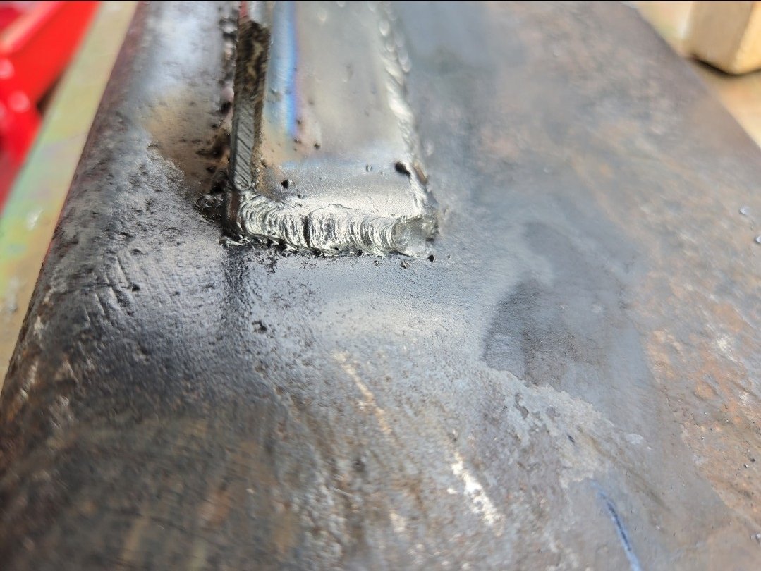

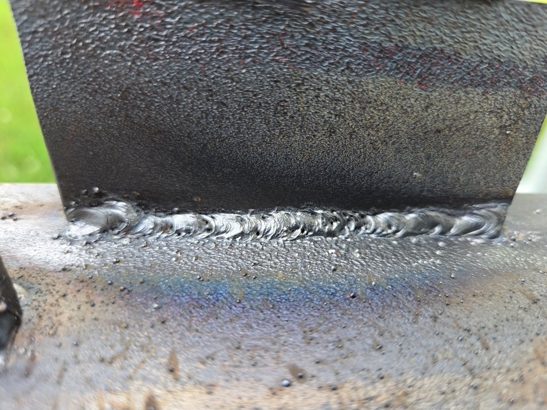

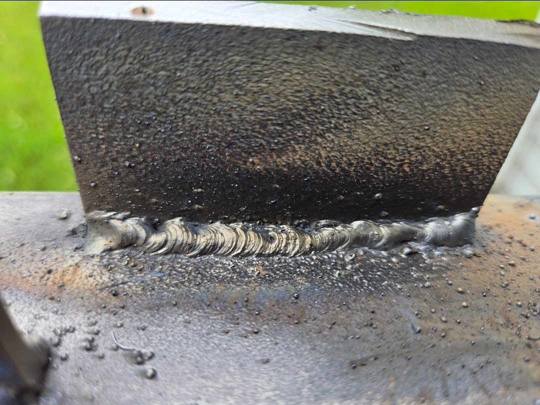

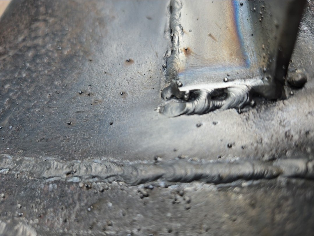

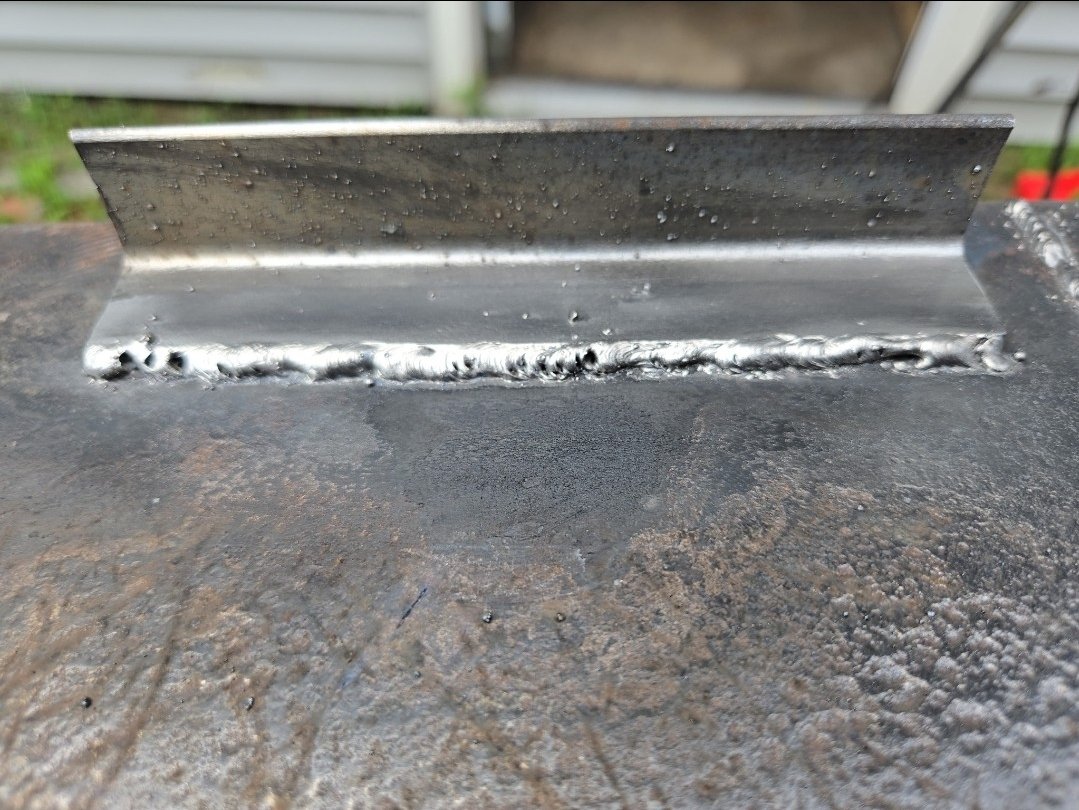

More welding practice, my first time welding pieces together. The morning session was ugly, so I watched some videos, then this is the afternoon session. Progress was made, still far from acceptable...
View attachment 629724View attachment 629725View attachment 629726View attachment 629727View attachment 629728View attachment 629729View attachment 629730View attachment 629731View attachment 629732View attachment 629733...
You're low on heat. Slow down a bit and pay attention to the puddle. Your torch should be about 3/4" from your work. And you should have a 45* tilt to your torch away from the weld. Use a c motion from side of weld to other side of weld. Don't leave the puddle behind.
More heat less speed, is that flux core? Are you dragging? You really want to run hot enough to see your puddle melt the two base materials before you start seeing the filler building up and feel the need to move, the leading edge of the puddle should be a depressed circle/teardrop with the tail end built up. Pics 3 and 5 look like a good start.
It looks like you're too cold and start moving before you're getting fusion and your weld is sitting on the metal in a lot of those pictures. Some of those pictures I'd guess you're using too much stick out.
