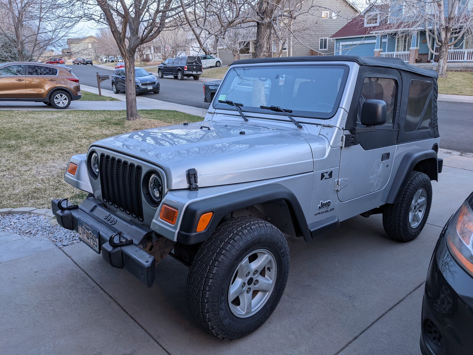

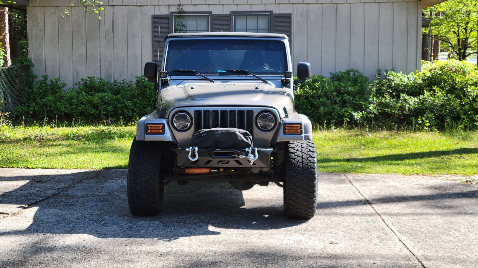

I put 235/75r15s ATs on my stock TJ X today. My brother (PO) was running MT 32s. Way too big. The difference is so much better in so many ways! More pep. Better ride. Turning is awesome. Best thing I've done to it since I've owned it.
I have got 235 15,s on mine. I have spent a year and a half pondering bigger tyres and a lift but I dont need either and the 235 75 15s look proportionate to me.
Nice but they'd be nicer if they were yellow.
You should paint them yellow again.
Everyone knows red Jeeps are faster, get better gas mileage, and their owners are better looking! :D

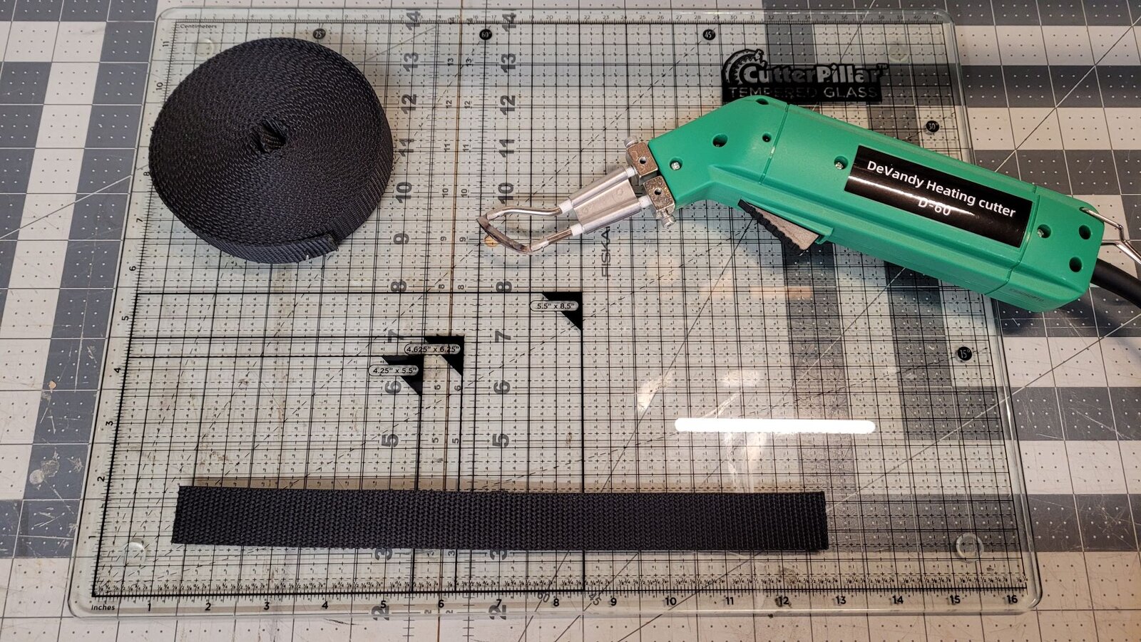

Then I decided I was tired looking at the overstretched and saggy elastic rear window straps so I made a pair of non-stretch ones.
EDIT: I went back to confirm the material I used for the straps. It is polypropylene, not nylon. I bought it when I made a cargo area storage bag, and if memory serves, I purchased polypropylene because it was more fade-resistant than nylon. It may give up some strength to nylon, but all my research suggested it was a better outdoor and weather-capable material. Full disclosure up front.
Cut 1-inch (25 mm) wide nylon polypropylene into strips with a hot knife:
Fold the nylon polypropylene in half and make a hole for the snap:

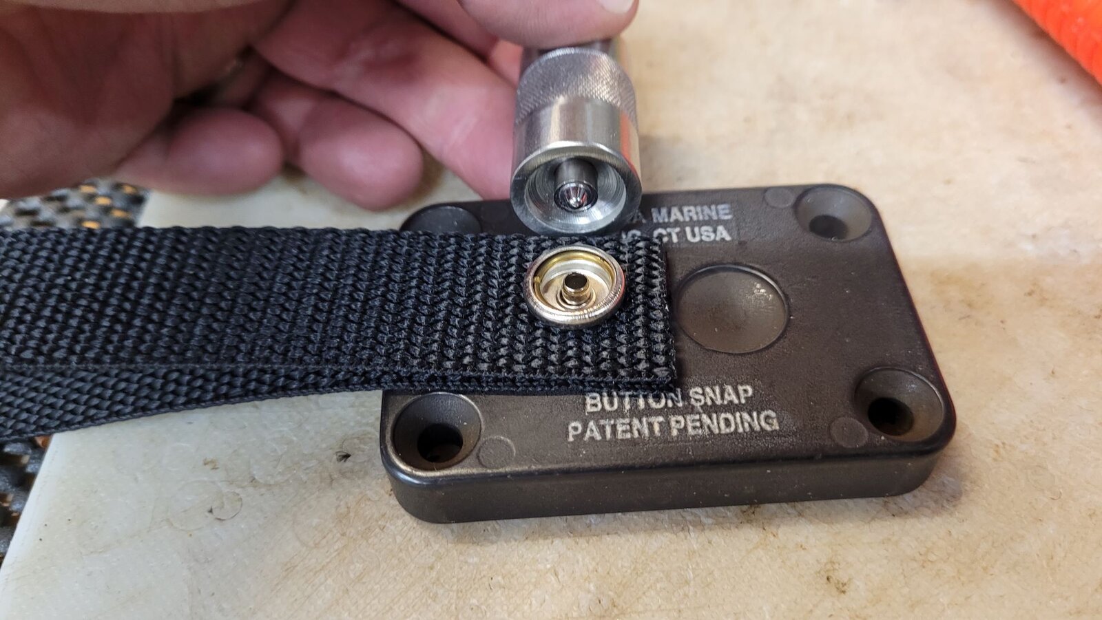

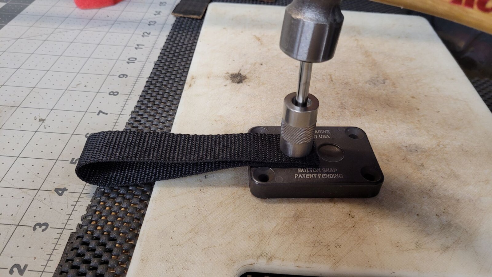

Place the snap's parts on the strap and then onto a setting plate. The domed part of the snap rests in a recess in the black plate, the silver tool is the snap setter. It surrounds the snap and you hit the end of its middle plunger and it rounds the snap's internal stem out and down, setting it in place.

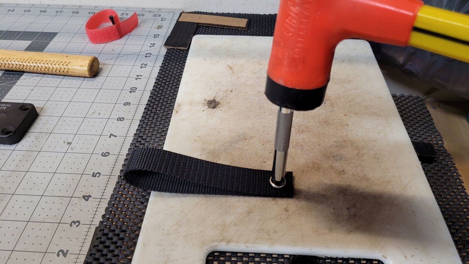

Use a hammer to hit the plunger and set the snap:
