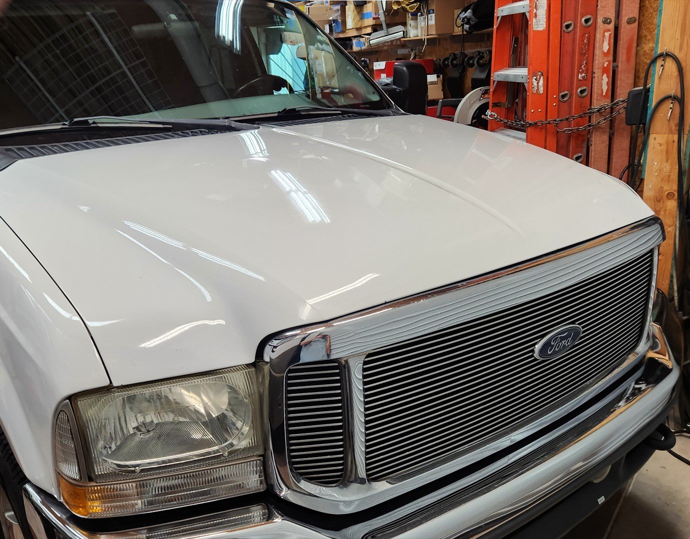

7.3l excursion ftw
That's what I wanted when we bought the Expedition (it was sold to us, untitled with 5k miles on it in 2002). The Excursion was in the middle of its production run then. At the time, we were moving to Connecticut (narrow, busy roads) and I was getting a company vehicle with a new job, so it was to be my wife's car, and it was all I could do to talk her into the "huge" Expedition. I mentioned the Excursion and got "the look." The secret to being married for over three decades - heed "the look"! ;)
If only I'd have been able to talk her into the Excursion...

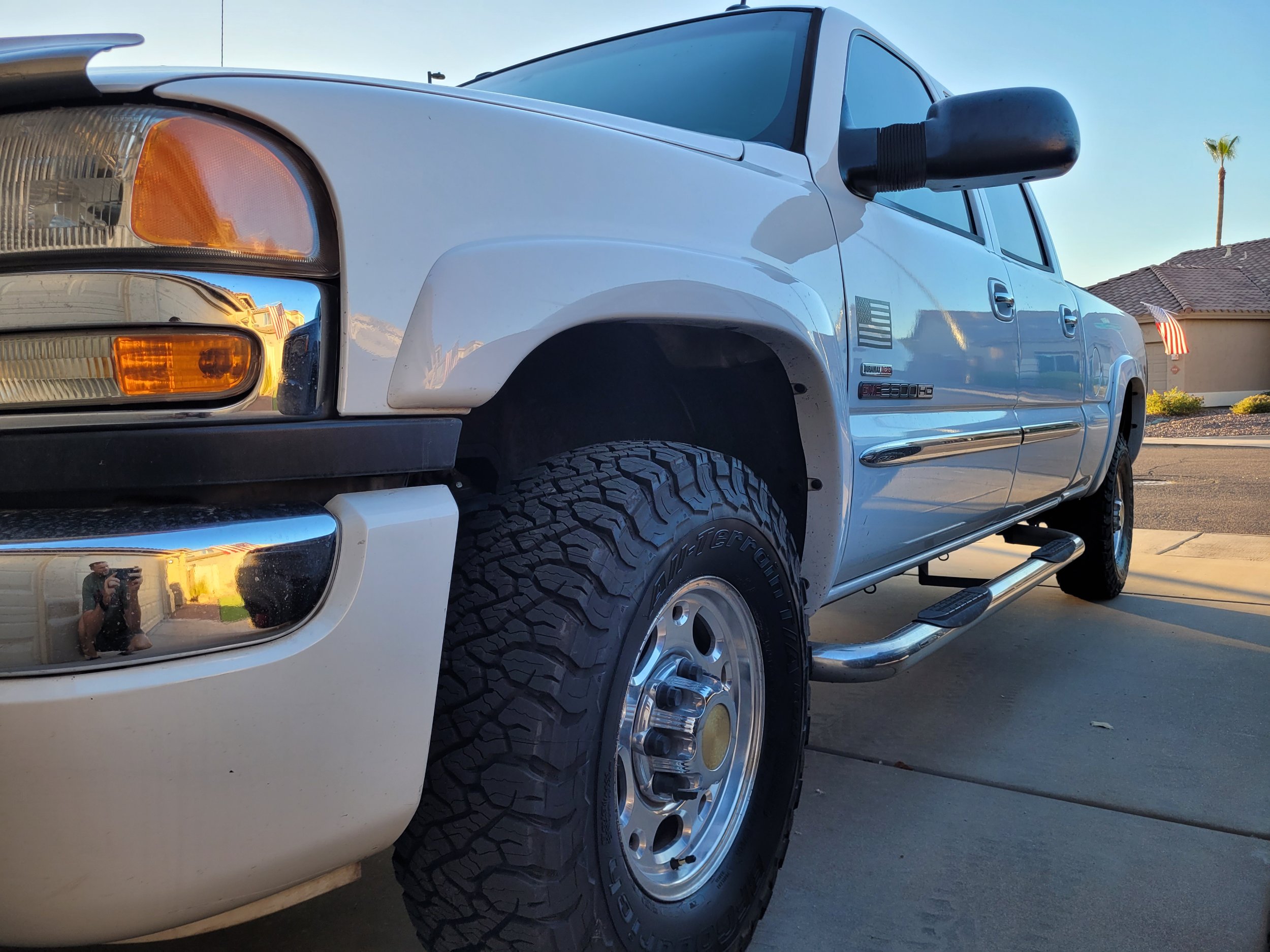

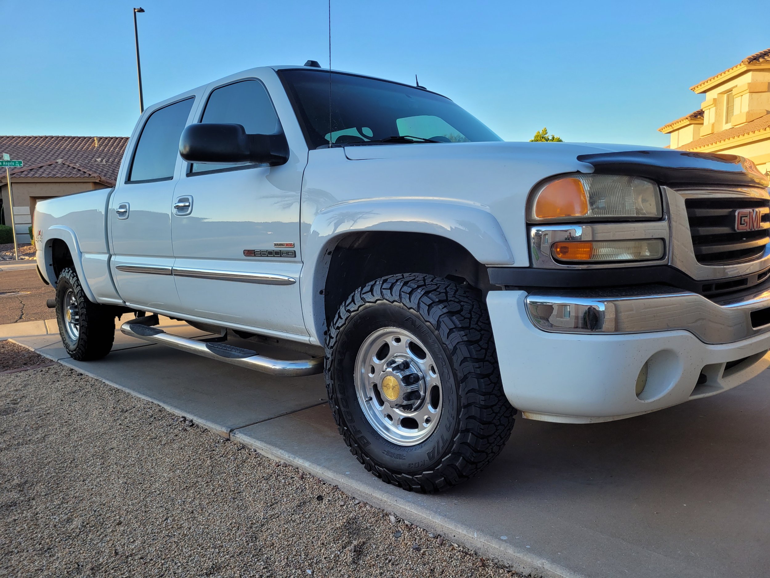

New shoes for the Dmax.

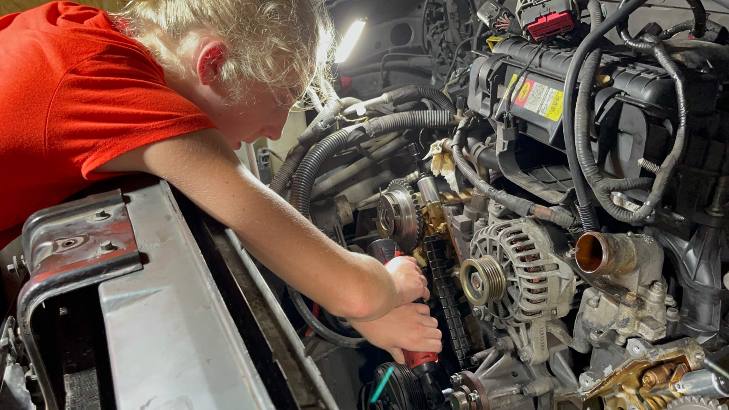

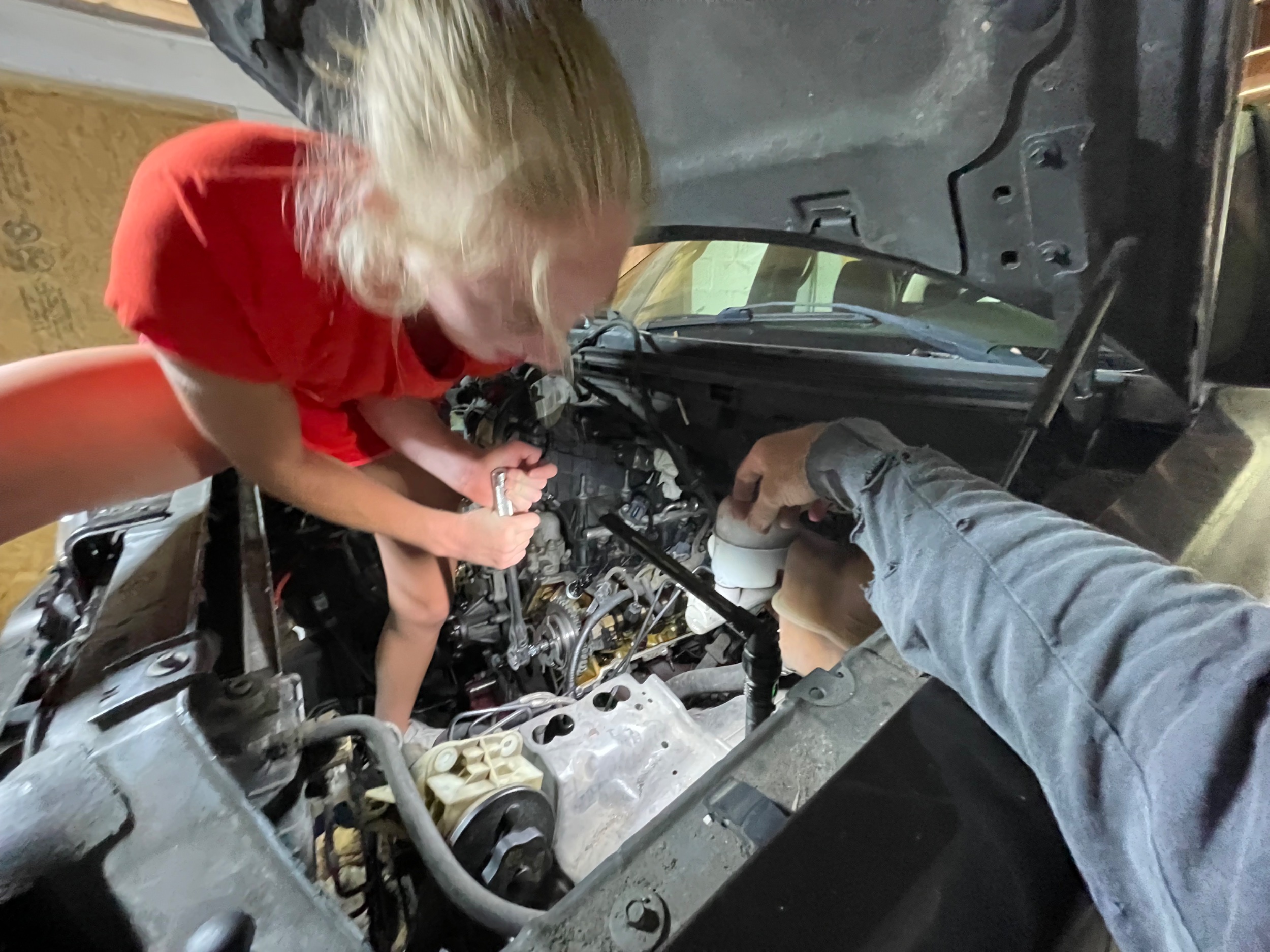

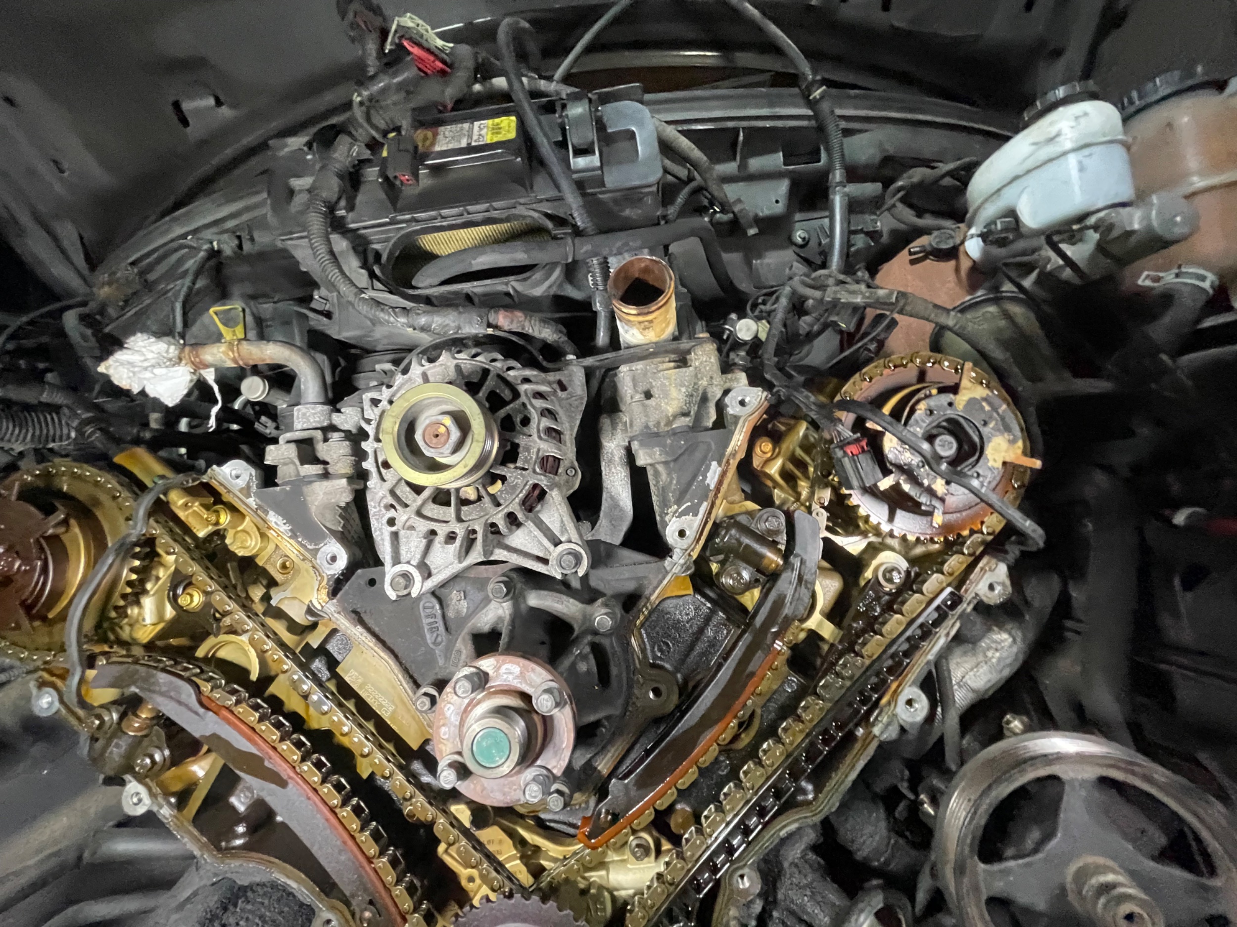

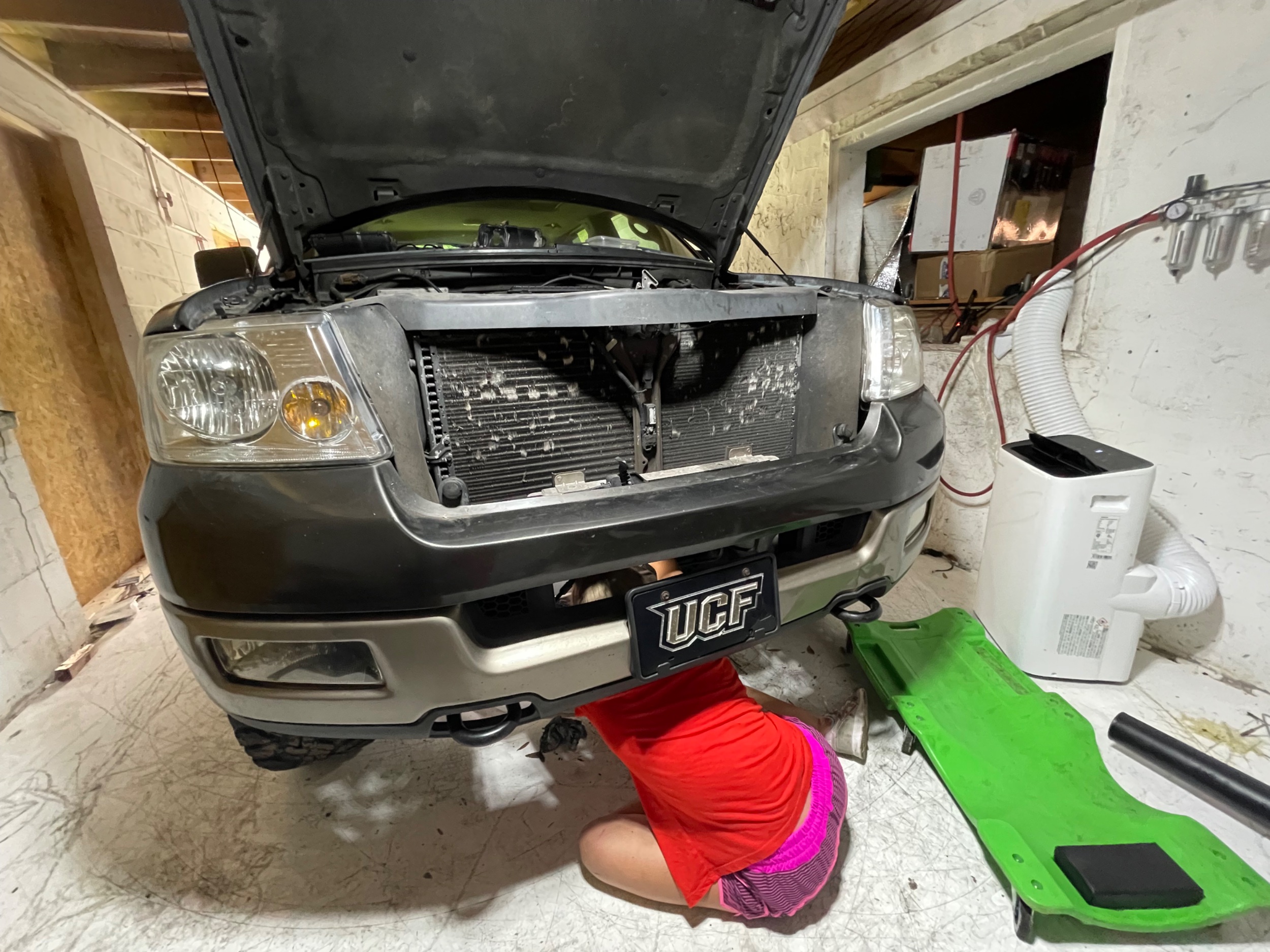

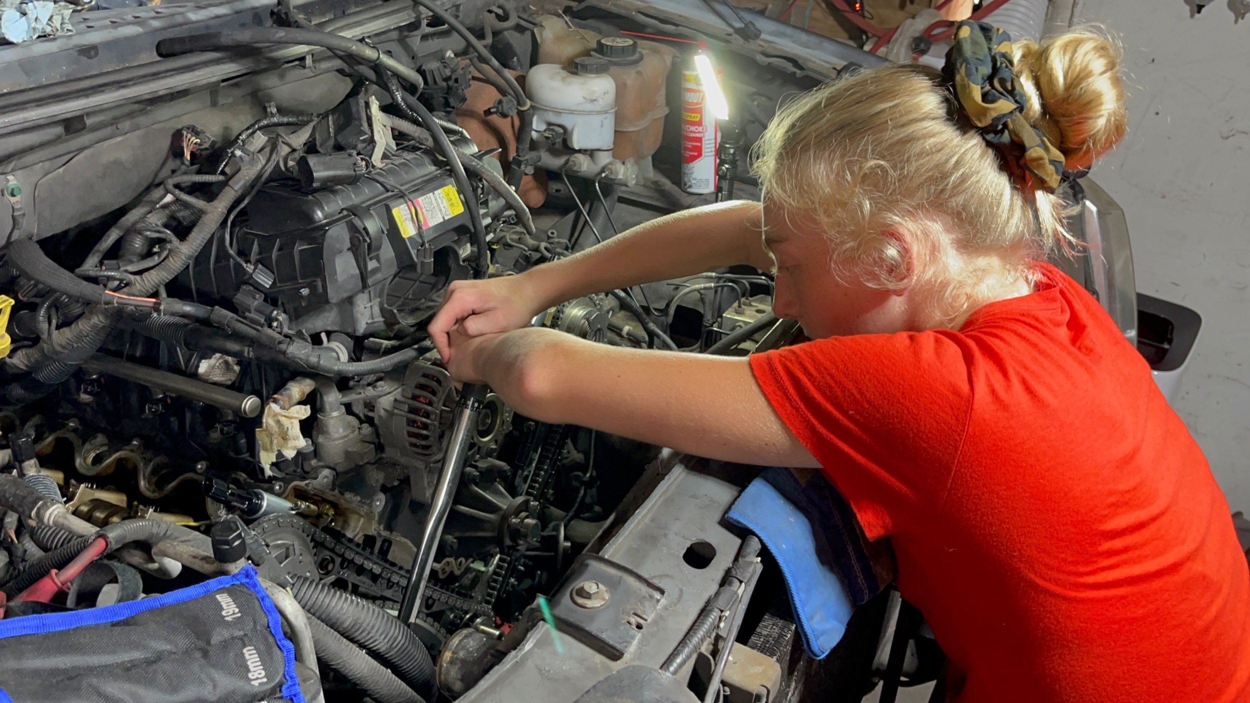

Tore into the 300k mile 2005 F150 5.4l to retrieve the timing chain guides and hopefully get another 100k after a timing job.
Finished up the timing. New lash adjusters, roller followers, hi volume oil pump, water pump, and fan clutch. This thing has NEVER been this quiet. The absolute BEST part(by a country mile), is my 15yo daughter and i did it. It's now her truck :)

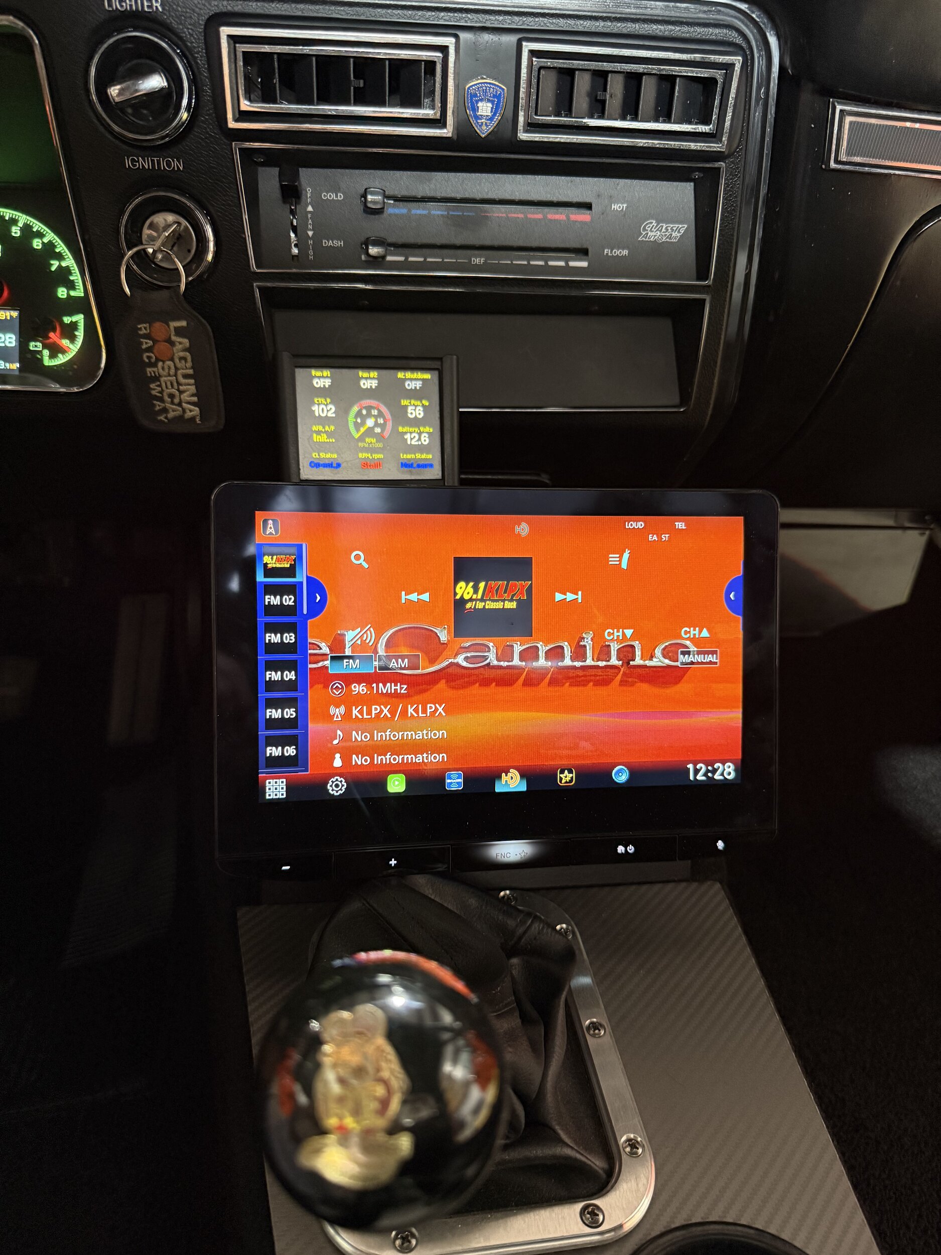

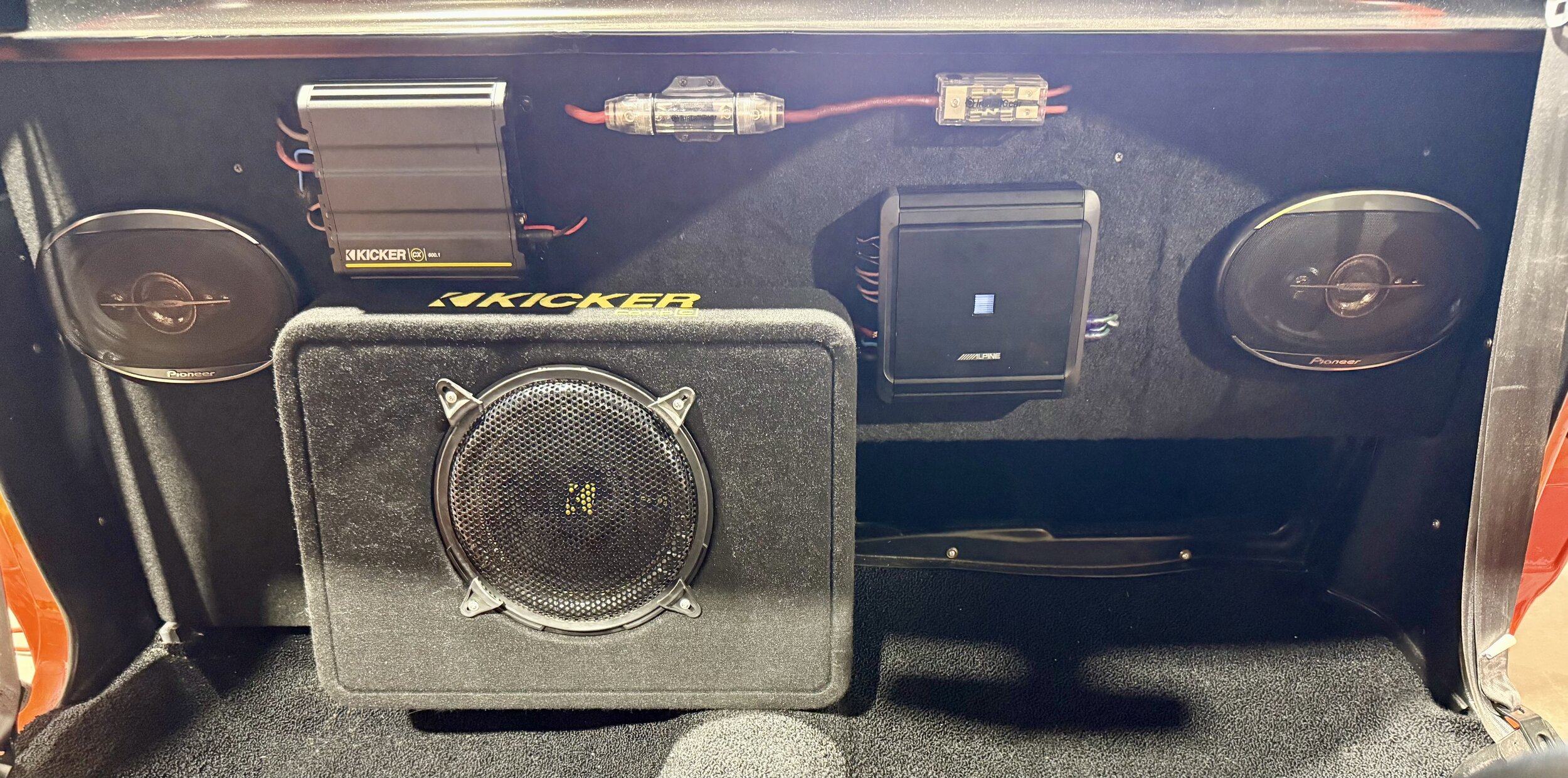

Just stumbled across this topic. I’m finally winding up a 9-month (so far) refresh, repaint, & update of my ‘68 El Camino SS. I finally got the stereo install wrapped up so I can put the interior all back in.

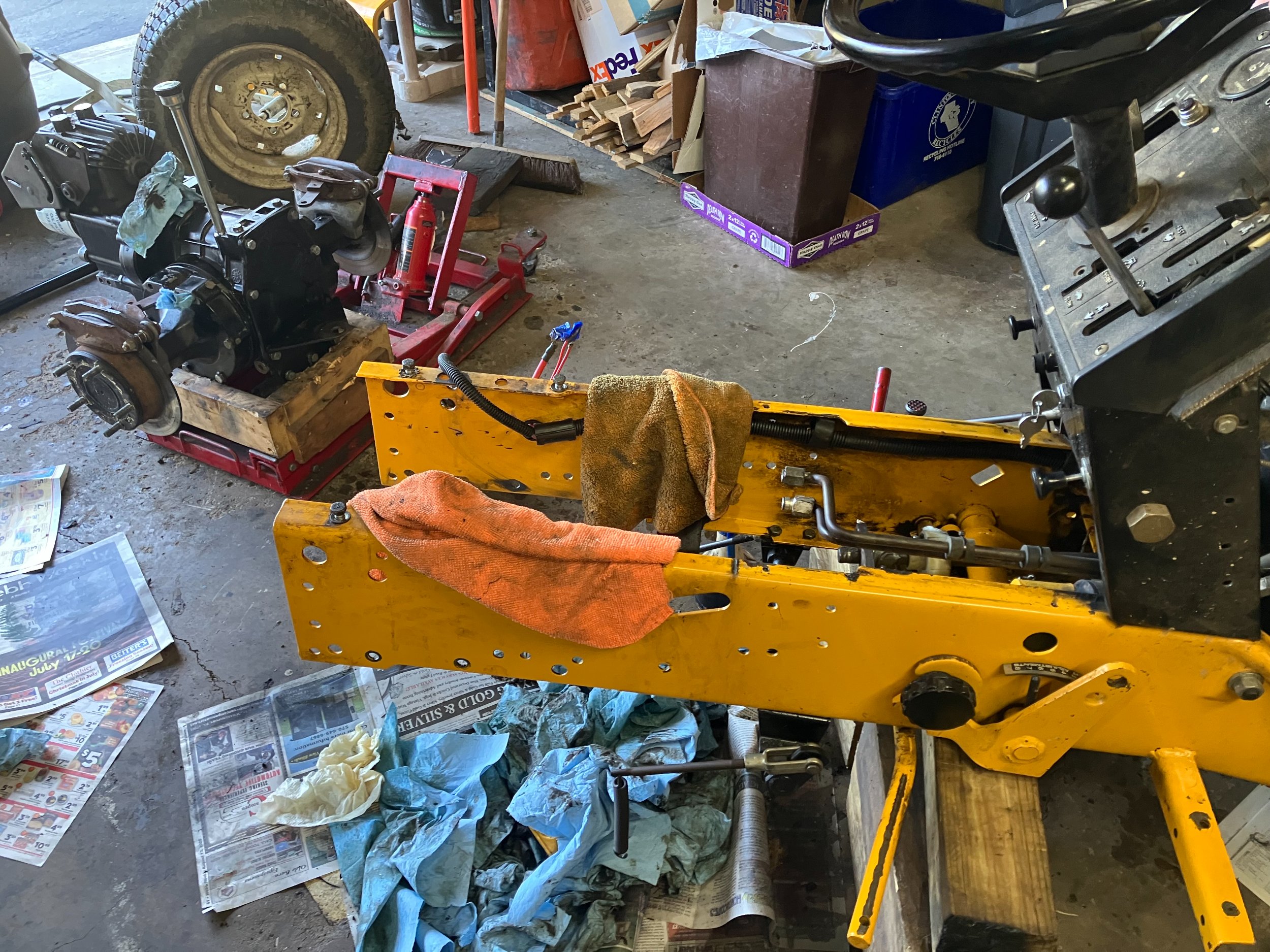

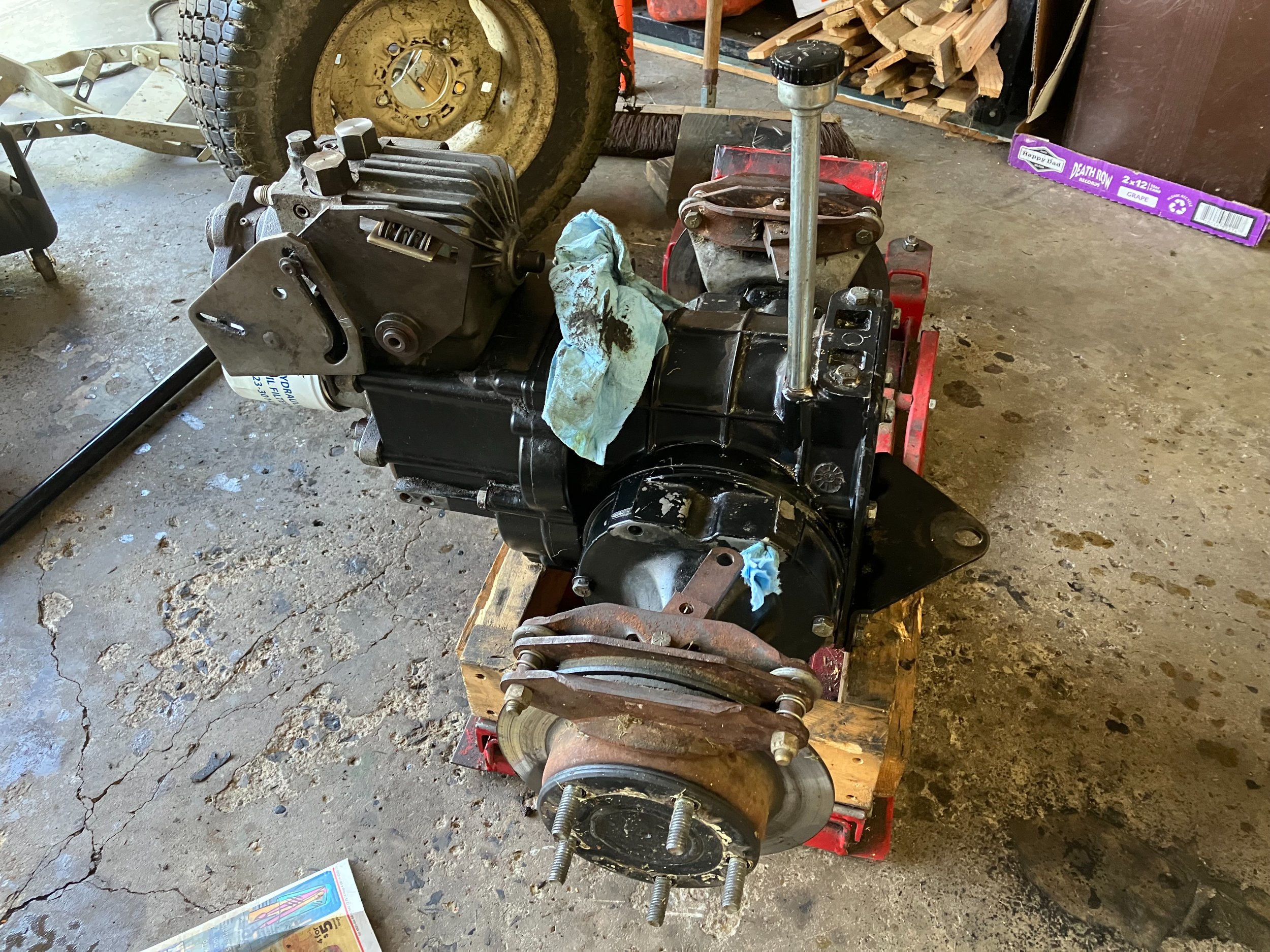

Not my daily driver, but had to pull the differential/hydrostatic unit in my Cub Cadet to resolve an oil leak I've been putting off for a few years.
What model Cub Cadet? Looks like an older well-made one. I work on small engines as a side business and love the old garden tractors. They are worth rebuilding over the junk sold in stores today. I'm currently going through a 2000 John Deere 345 to use for myself.
Reactions: John Cooper
It's an 1811, wide frame from the late 80's. When the original twin Kohler wore out, I repowered it with a kit using a B&S Vanguard.
My latest challenge is now that I have it back together, it now won't start unless I jumper across the starter solenoid. I think I repowered it about 12 years ago. This is the first time I had any problems since then, other than a flat tire.

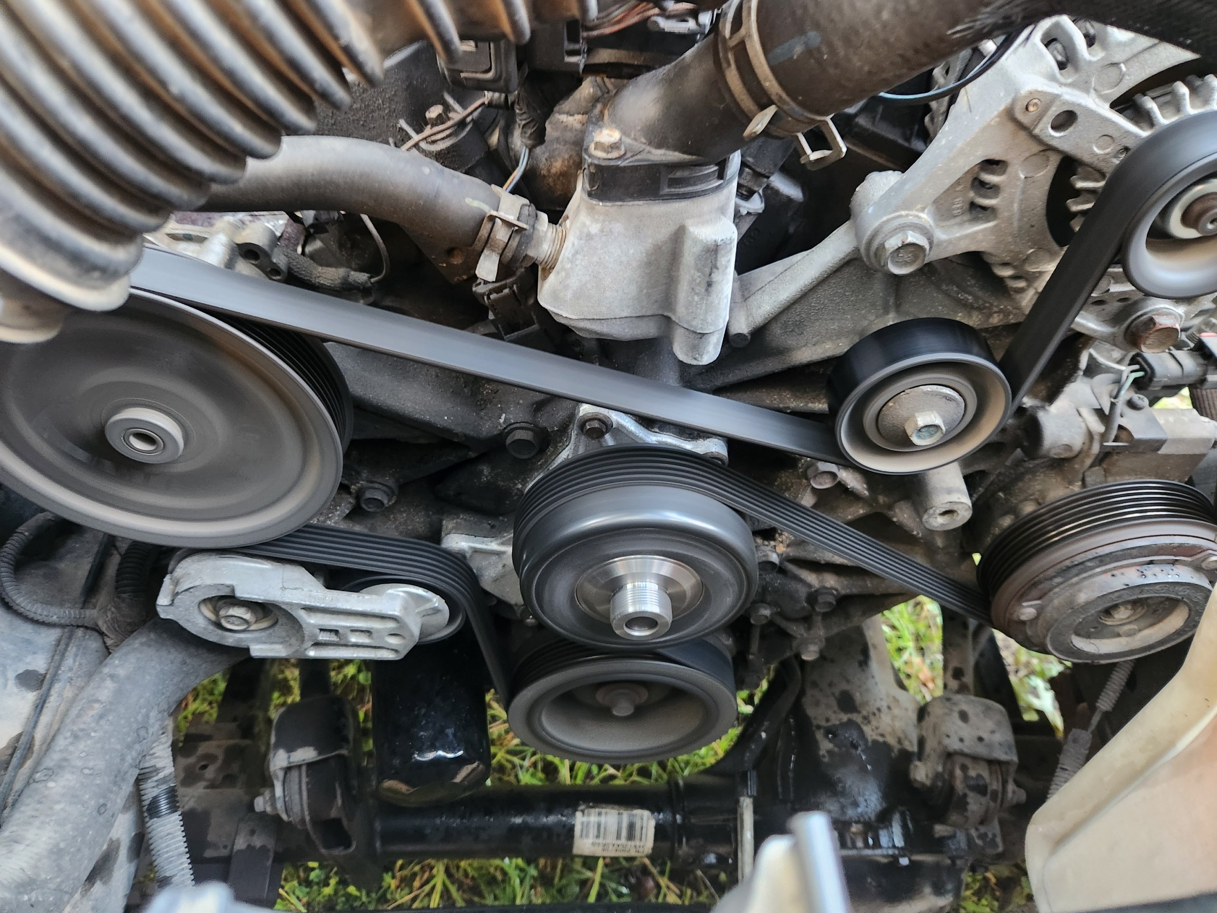

The JKU started making a rattling noise, so yesterday I removed the serpentine belt and spun all the pulleys and tensioner's. Water pump was the only one making a slight noise.
With the belt off I started it up and no noise, ruled out the timing chain.
Bought a water pump today and had it replaced and test driven in an hour and 20 minutes.
3.8 with an electric fan makes things quick!!!!
