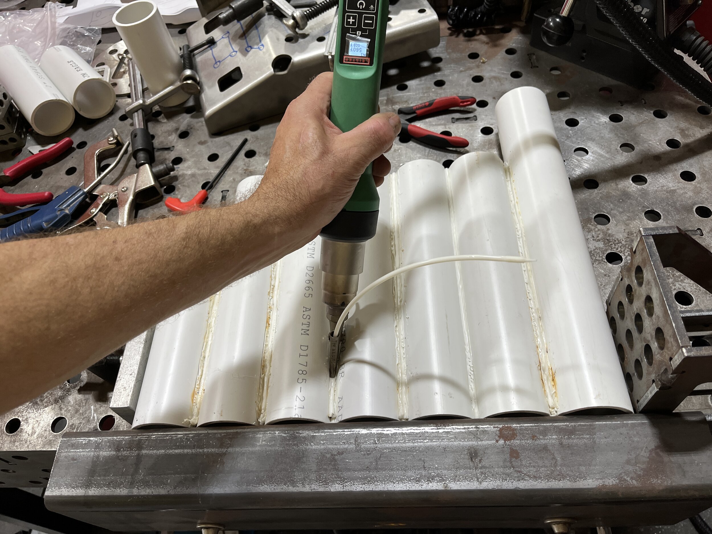

It's a hot air welder. The hot air melts the filler rod and the surrounding plastic.
That particular welder looks a lot more sophisticated than the twist and pray HF model I've got. I like that you can digitally set the temperature...which is critical for welding plastic.
The second most important thing is figuring out what plastic it is so you select the right welding material and temperature.

Mac, I bought this welder, which is a pro-level plastic welder, because our wells are drying up around here, and rainwater collection is going to be my only source of household water in the next few years. I have a fair amount of plastic welding to do for the massive collection and treatment system I've been building for the last several years, so I sought out a pro-level solution...
Very accurate statement, Mac. Just like welding metals, you have to know what you're welding and then use the proper settings. Leister makes a non-digital (just a knob to turn) gun exactly like the one I bought for a few hundred less, but the salesman told me the digital would be worth the extra money. He was right.

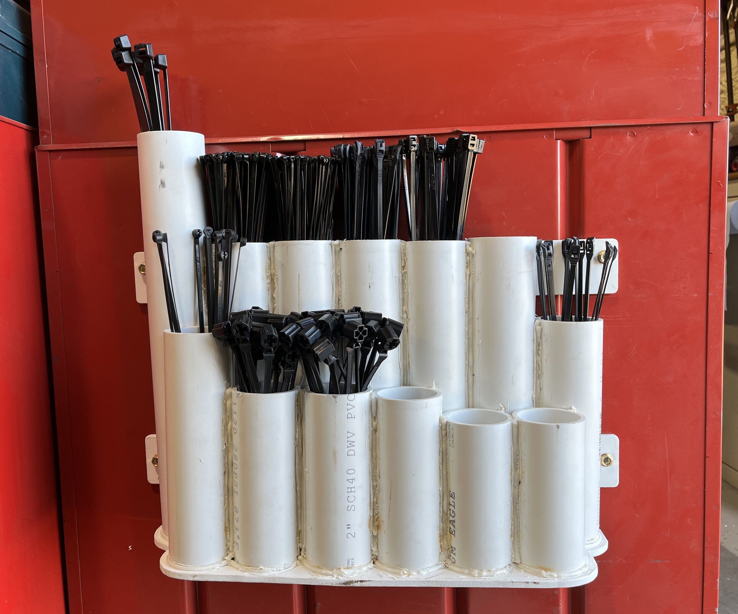

I started making some cable tie organizers. I wanted to organize my cable ties, and I assumed someone would have the perfect solution for me. Nope. I couldn't find anything even close to what I need, so I decided to make an organizer out of PVC. I cut some 2" pipe into different lengths. Then, I welded them together:
There's a second row that I welded onto that row, but I forgot to take a picture. I've got some PVC sheet on order, and I'll cut a bottom out of that, along with some pieces to weld on some mounting tabs. It'll be wall-mountable when complete...

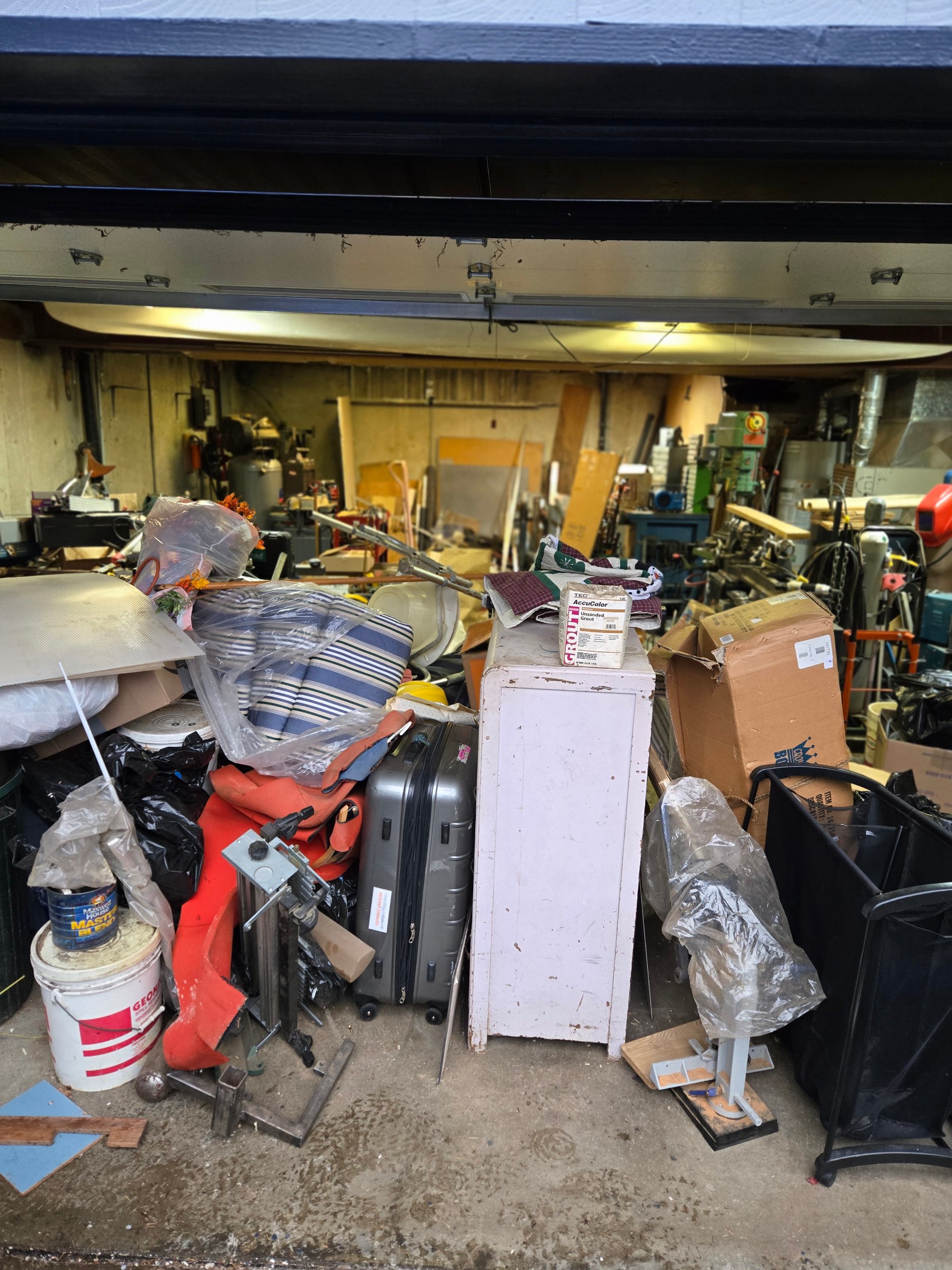

Cleaning out my dad's garage......
I am totally going to leave a car parts collection just like that for my kids to take care of to pay them back for all the cleaning up after them I did. Then when they throw most of it out they are going to realize how much gold was in there reference maintaining the vehicles I left them.
You're welcome boys 😎

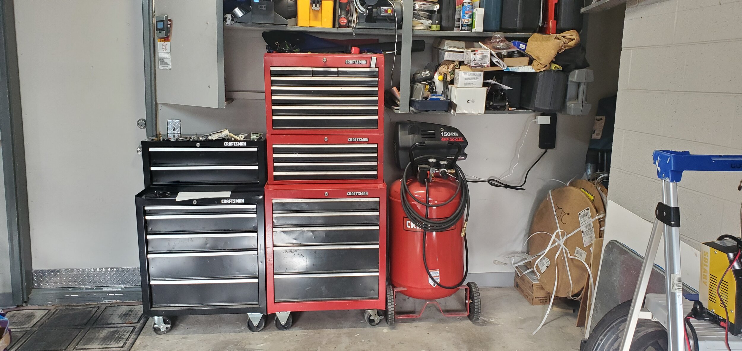

I inherrited about 5000lbs of tools (mostly vice grips) and this red tool chest when my f-i-l passed 5 years ago. I brought it home over the summer because the black chest my wife gave me was overloaded and I needed to spread it out. But it didn't all fit quite perfect in my garage.
I secured the top of the old black chest to a wall beside where I park my car.
And swapped the tool chests so I'm back to having a good place to store my extra set of wheels for the car.
I finished the PVC cable tie holder and mounted it to a toolbox:
PVC is not nearly as easy to weld as HDPE is. It doesn't flow very well, so the welds are butt-ugly. On top of that, welding around the circular pipe was tricky. I had to change directions on every tube at the base. I doubt that I got full fusion everywhere, but I think the welds are strong enough for this purpose, though. At least I won't misplace my cable ties any more!
If you’d buy that 3D printer this would have been a good use for it. ;)
