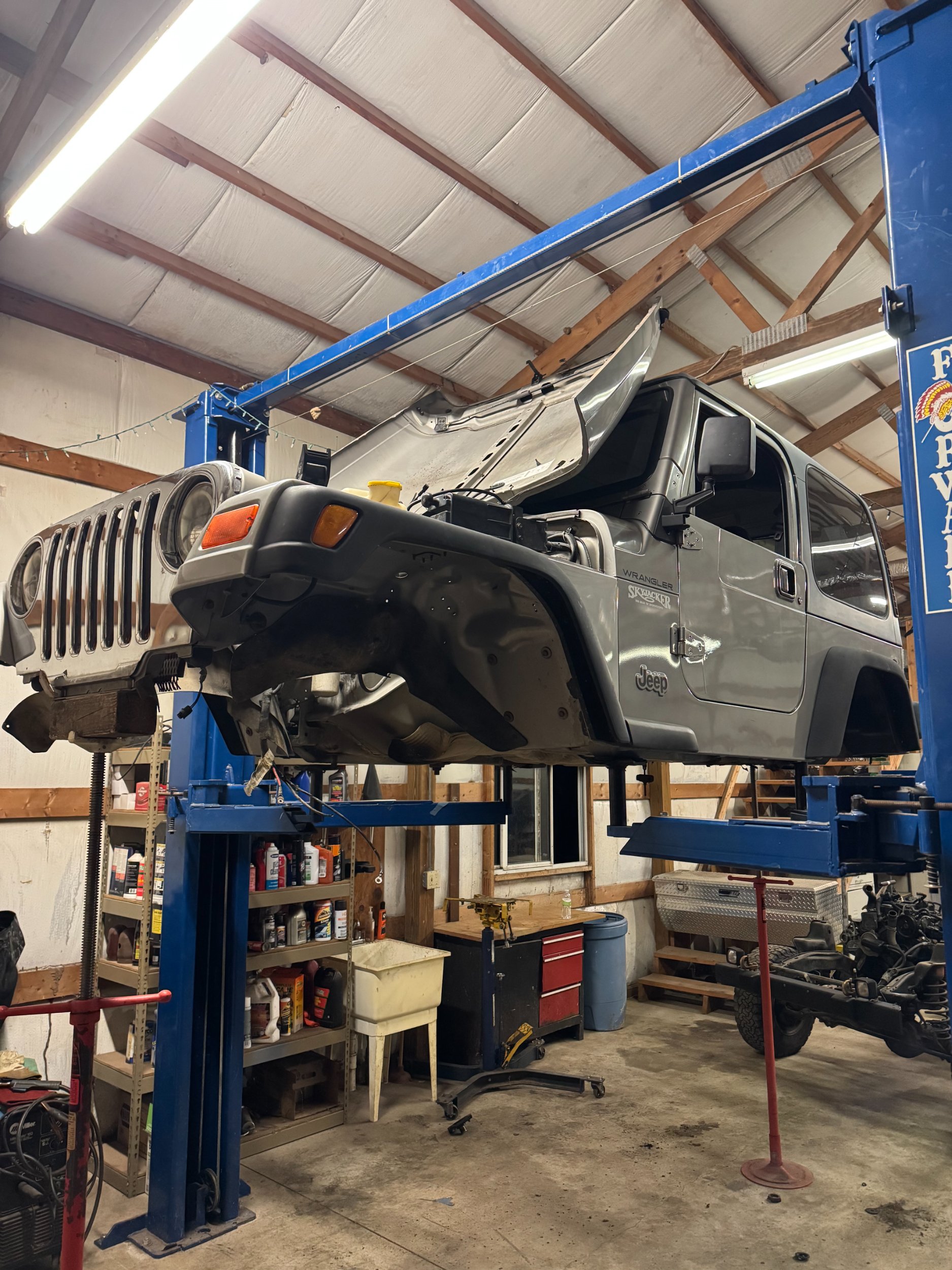

Currently in the process of a frame off rebuild of a 2000 TJ. Main goal of this project was to fix the rust by replacing the torque boxes and clean up/rust prevention on the frame. Since I am already deep into this, I plan on replacing all suspension components as well. While the project has been moving quickly, at this point I am overwhelmed with options. I believe there has already been a 2.5" suspension lift installed at some point because of the skyjacker shocks and what appears to be front spring spacers (correct me if I am wrong). My end goal of all of this is to be able to run 33" tires and have a capable off road build. I don't want to go crazy with the budget but I want everything I choose to be functional and last. I think where I need to start is with the lift kit and base everything else off of that.

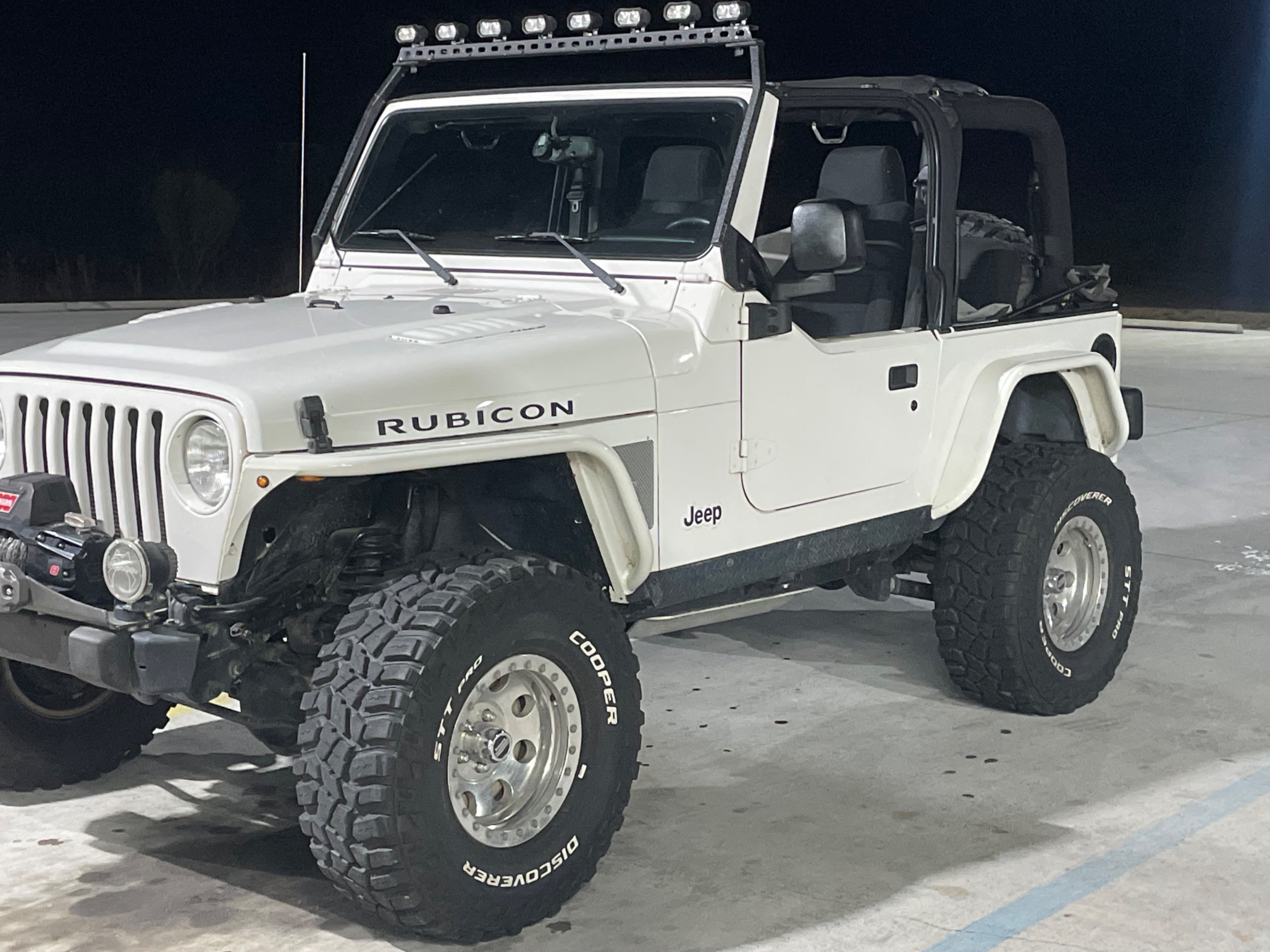

I'm not sure what was going on there. The spacer up front looks like a 1.75", but where is the spacer on the back? Was it rolling carolina style?

My profile pic is how it rolled before. But I do agree that something weird is going on. I am assuming that it probably was the most budget lift available at the time of install. Your comment on caster makes a lot of sense, that is the direction I will probably go regarding that. About to read up on the forum Chris sent as it seems pretty informative.

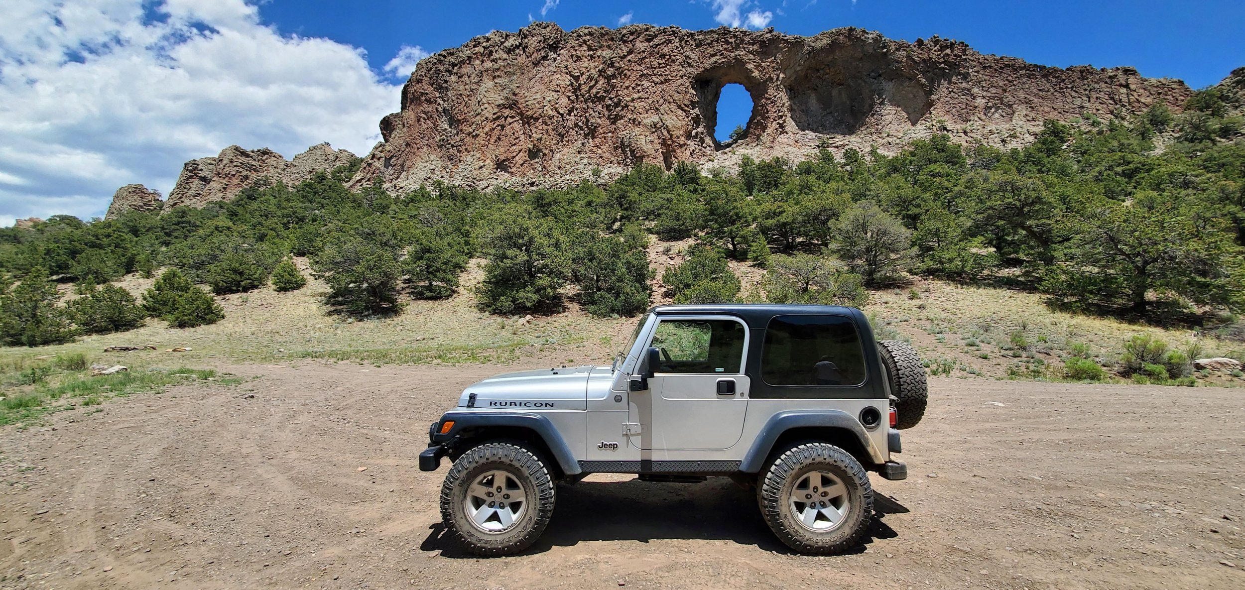

As an alternate POV, I run a 2.5" lift with no body lift and metric "33s" and have since a few months after I bought it in '04. Now I do have single adjustable control arms and adjustable track bars all around because when I'm done I don't intend to further change the lengths. Part of the reason was that the alignment I had done showed there was some small misalignment on the rear axle which had always pushed the jeep. I'm not suggesting this is the ultimate rock crawler, but it's done what I've asked and can go harder than you might expect thanks to the lockers. It drives and rides better now than when it was new. I also took my dad's LJ back to stock and refreshed all the control arms, shocks, spring isolators, and likewise - he loves the way it drives.
I was a cheap 20-something back then. I use my Jeep differently these days. I'm updating it to go another 20 years into retirement and I don't need to do it on the cheap these days. I also know what I want from it and plan to finish up this round of updates this year and then just go back to driving it.
