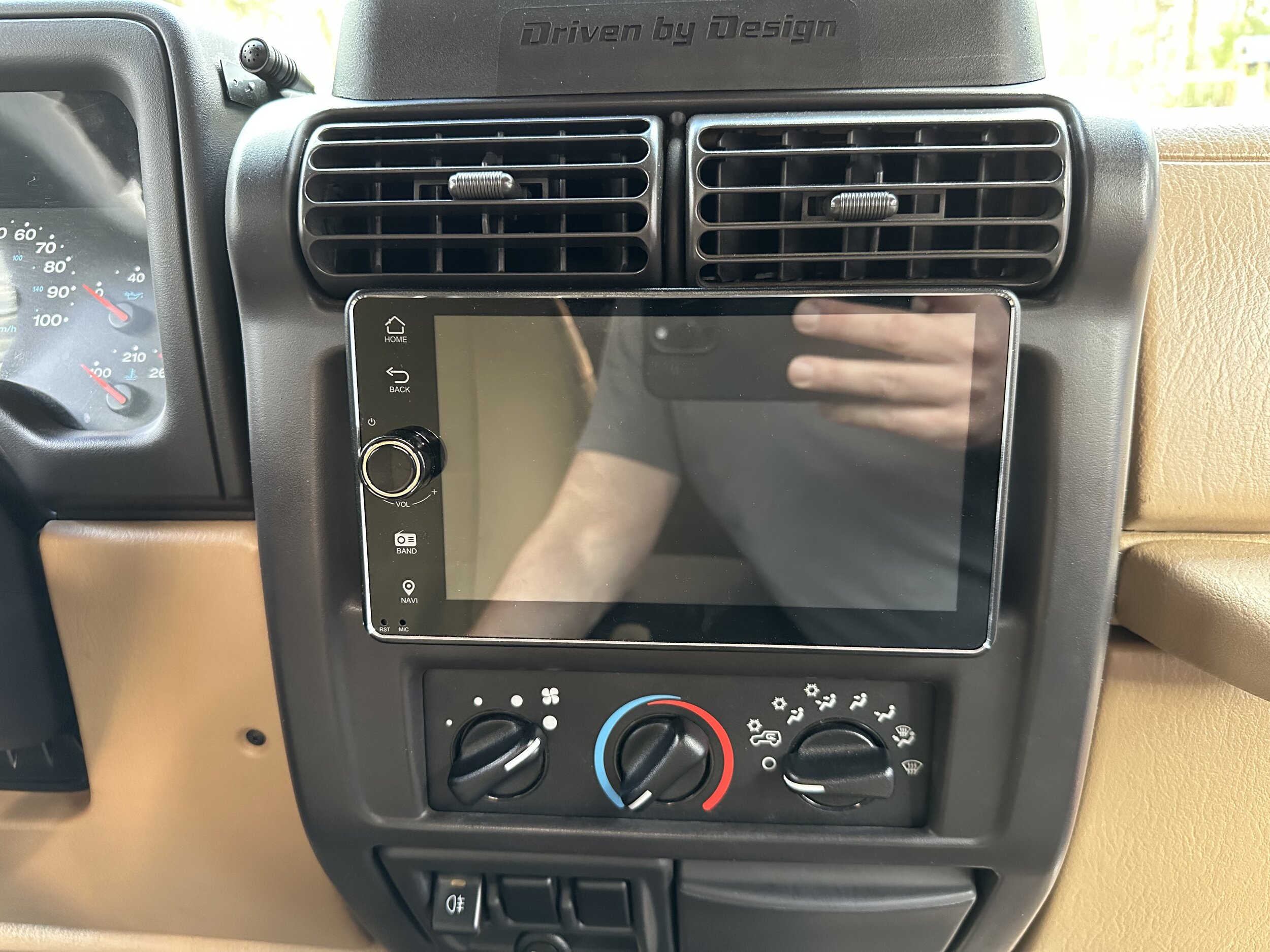

5 Days over a 13 day period, it is finally in and functional.

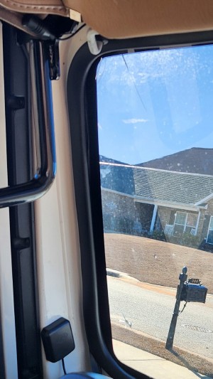

I put the mic on the roll bar cover and the gps antenna is magnetic, so I stuck it on the A-pillar.

To properly triangulate, and get the most amount of reception from GPS satellites, the antenna really should be horizontal. I would just velro/sticky tape it to the dash just ahead of the gauge cluster.

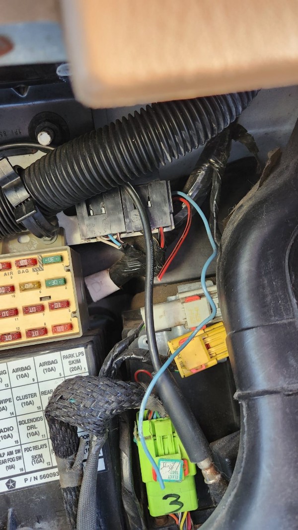

Any idea if these wires belong here?
I can't see where they go, the red wire was powering the old radio and is constant power. If you left the radio on, it would run the battery down.
I don't think the blue wire was connected to anything.
I pulled a few fuses, most are old and corroded, some are the incorrect amperage, so I am replacing them all.
Back to the red and blue wires, if they don't belong, I am taping and tucking them.
Did you say this traced out to the rear of the vehicle? Might be a reverse trigger wire. Kinda looks like the switched & unswitched trigger wires Jeep gives you from the factory but since you traced them, I guess not.
What new hat unit did you go with?

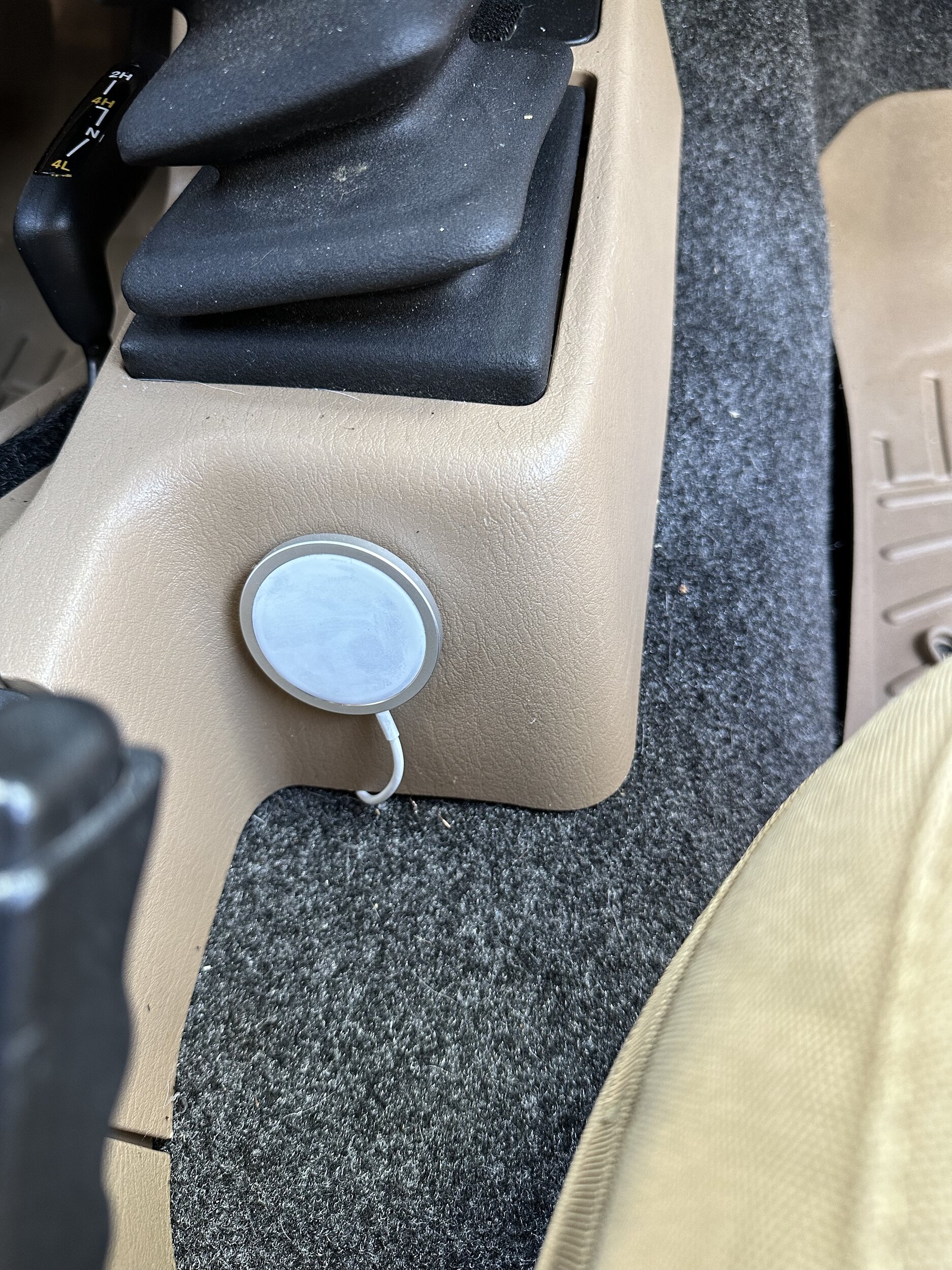

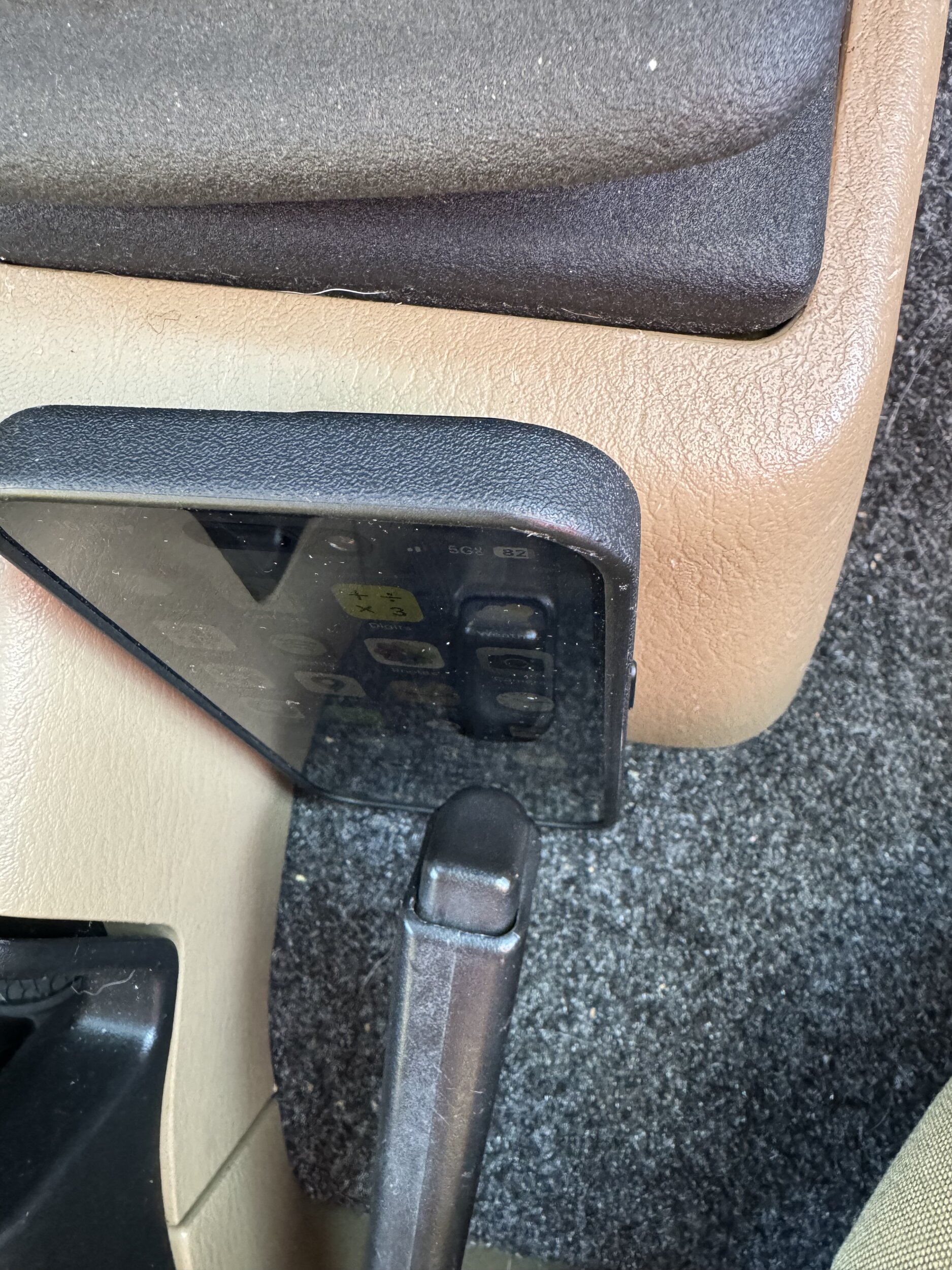

This is my wireless charging setup.
Add a fuse in the glovebox + apple mag charger. Keeps the dash clear and the upper tray useable.
HU is the Joying Android which does wireless apple and android CarPlay.

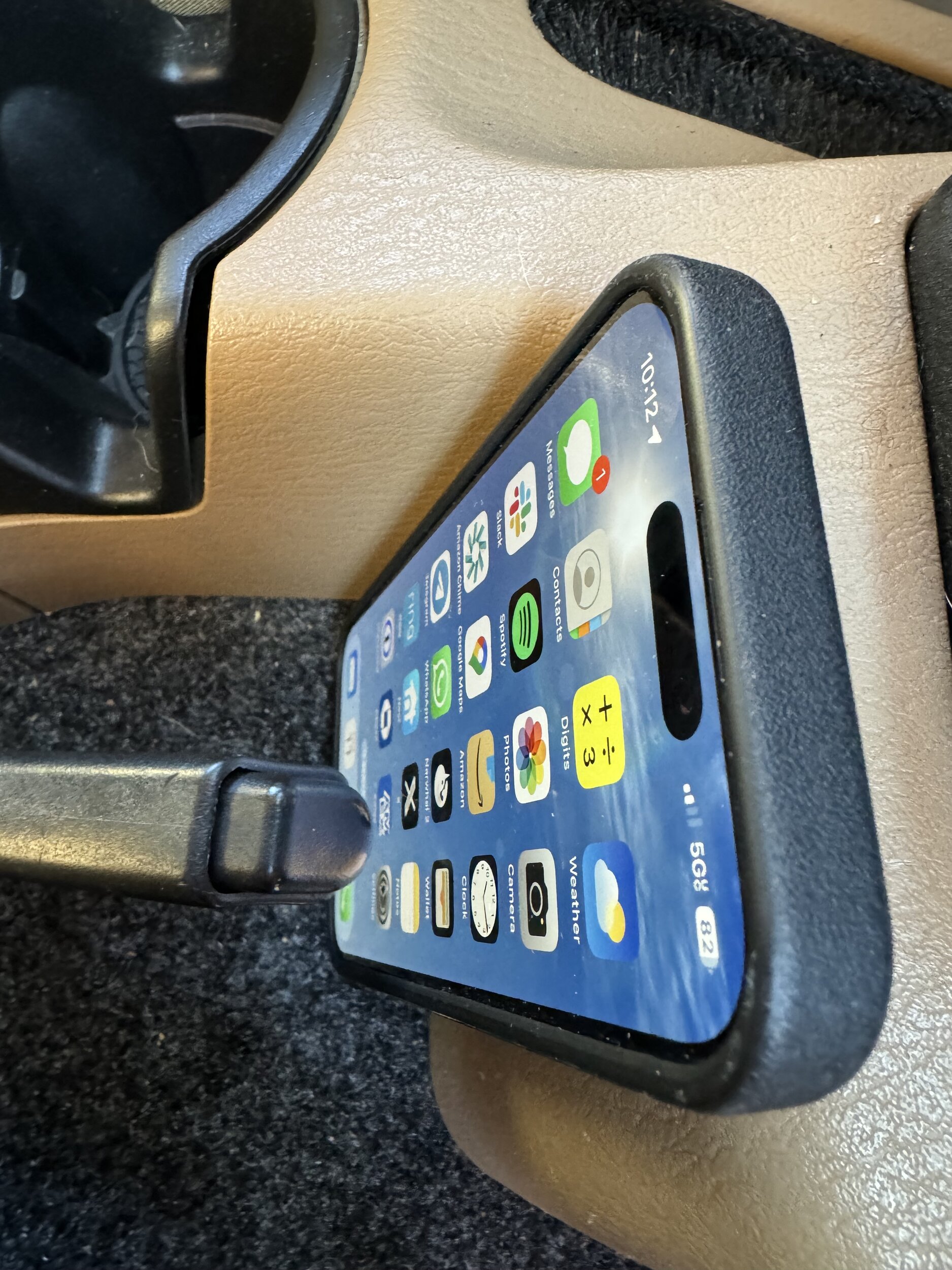

Can you post up a pic with the phone stuck to the charger and the e-brake down? I've been thinking about mounting mine there for a while but worried how it would be with the brake lever down.

I use navigation off my phone, it is better and more up to date. If I am out of cell range and need the installed navigation, I can lay the antenna on the dash.

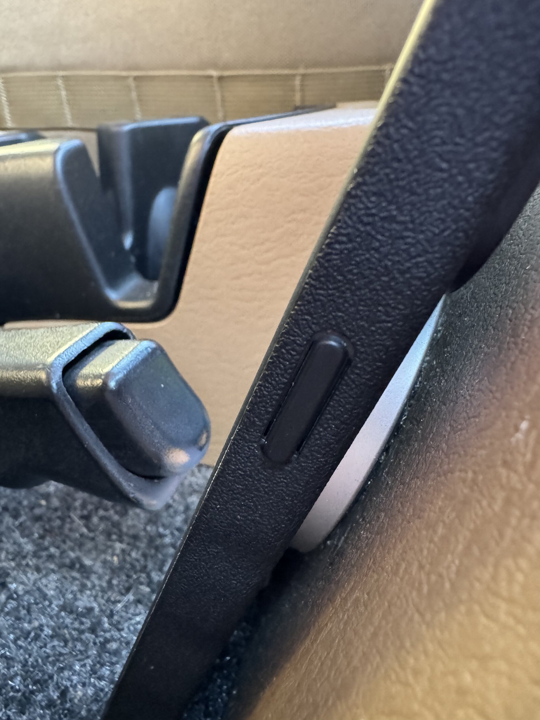

Let me know if you need more. I can fit my thumb between the phone and brake button but maybe not with winter gloves.
The charger plate is low enough so that case is supported by the trans tunnel and not hanging.

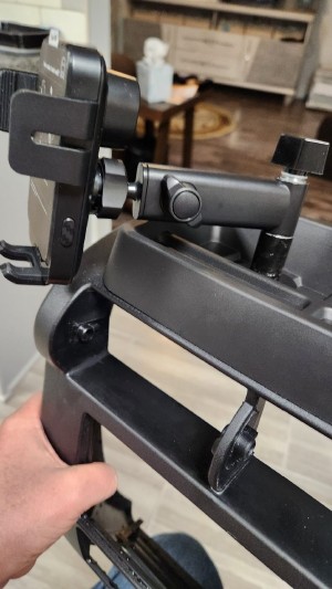

My version:
The suction cup holder on the windshield is a no-go, that is a small windshield as it is.
I took an old license plate and used it as a backing plate to tie the phone holder into the two screws that hold the top of the radio bezel on.
The holder and phone puts quite a bit of weight on the plastic bezel and on the two plastic tabs that hold the bezel on. By tying the phone mount into the metal on the dash, it should be pretty stable.
The dash tray and radio bezel had a small gap between them, so I placed a fender washer between the two to tie both pieces together.
I will give it a couple weeks and see if it meets my expectations.
