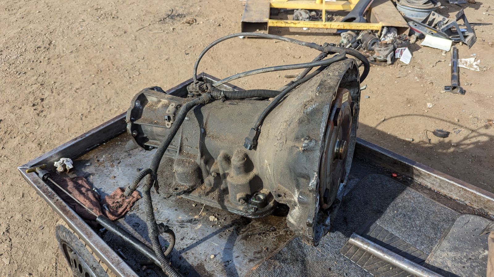

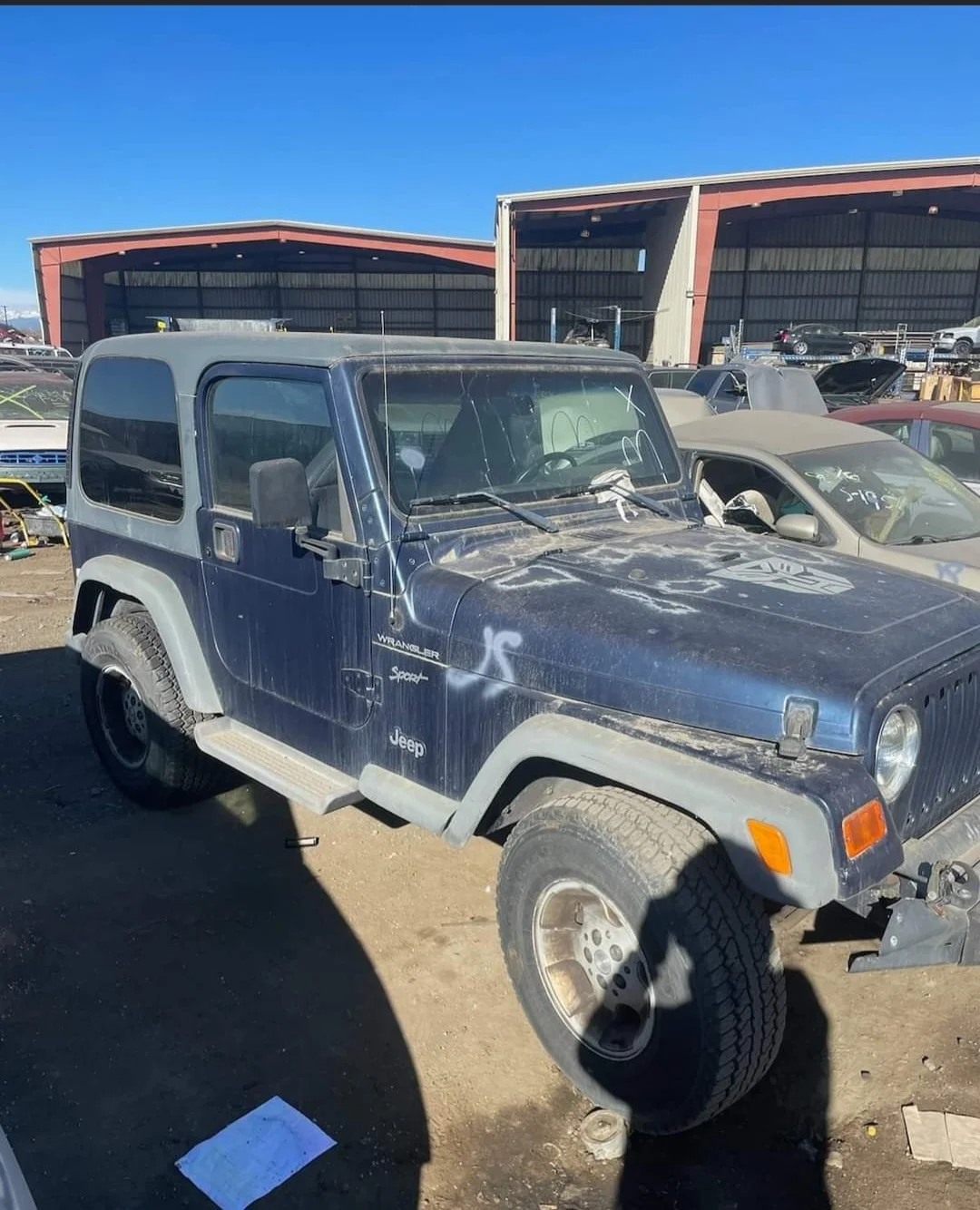

The jeep is still on jackstands, but I am joining the ever-growing auto swap group on WTJF! I spotted this TJ at the local u-pull&pay and @hosejockey61 graciously picked up the 32rh for me while I was at work.
I still need a few items and have ordered several parts already. Its all very exciting! To make it work with the savvy ua will be a challenge. Savvy never made a skid setup for the early automatics. From my understanding, its going to require a separate, stand alone cross-member as the 32rh is much shorter in lenth. we'll cross that bridge soon enough though.

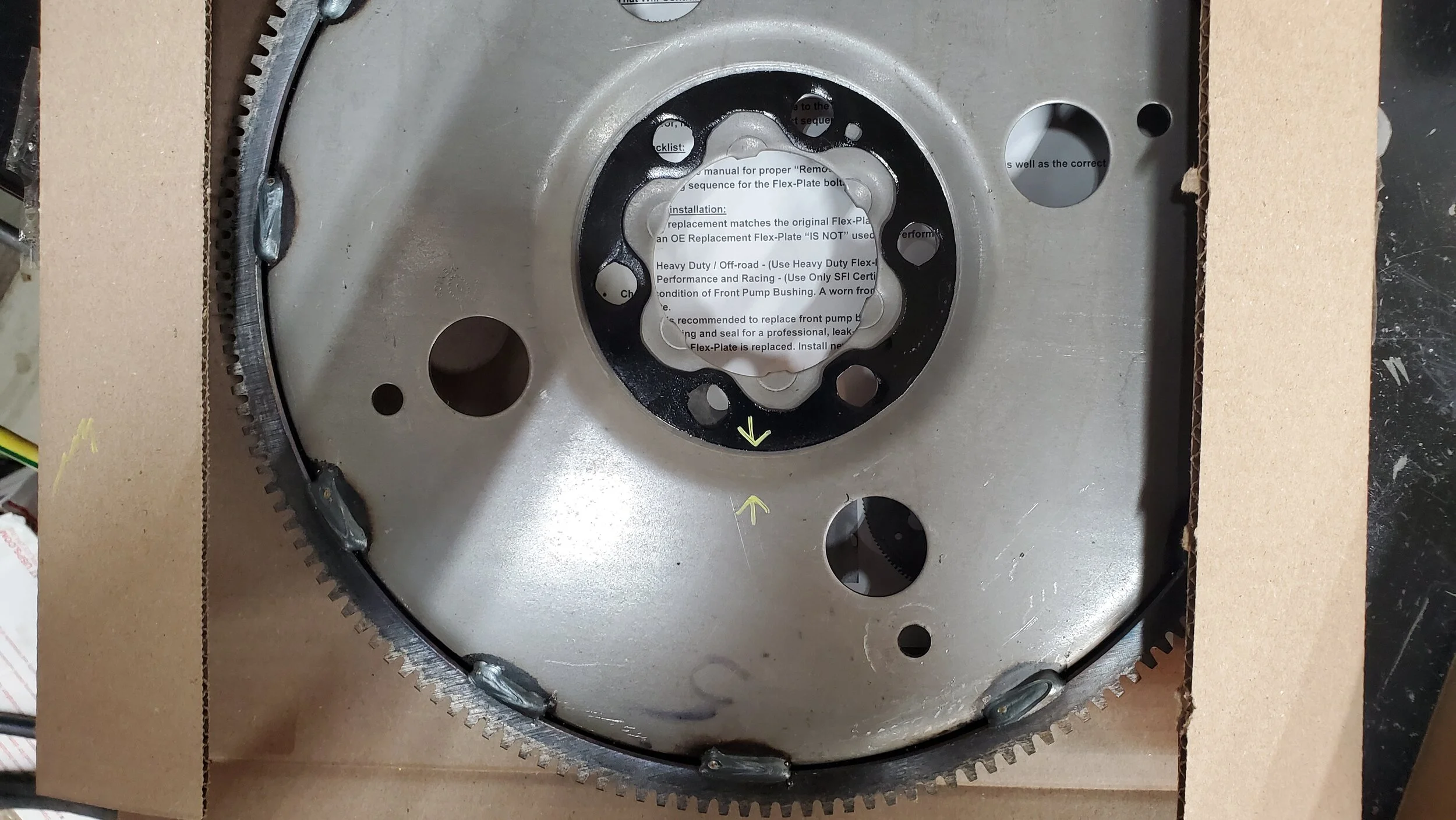

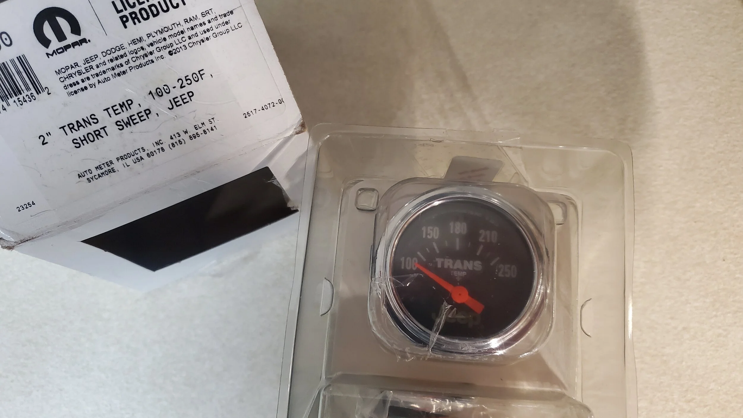

Some more goodies!
