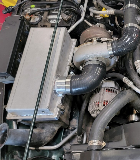

I love how you incorporated the factory air box & filter instead of just slapping on an open filter element. (y)
Do you plan on having all tops fabricated aluminum, or are you looking into having plastic pieces made?
Agree. Very nice to retain the stock air box. I really like this set up. I'm looking forward to more details.

They will be fabricated aluminum. I don't anticipate enough production to justify the setup costs of a plastic part.

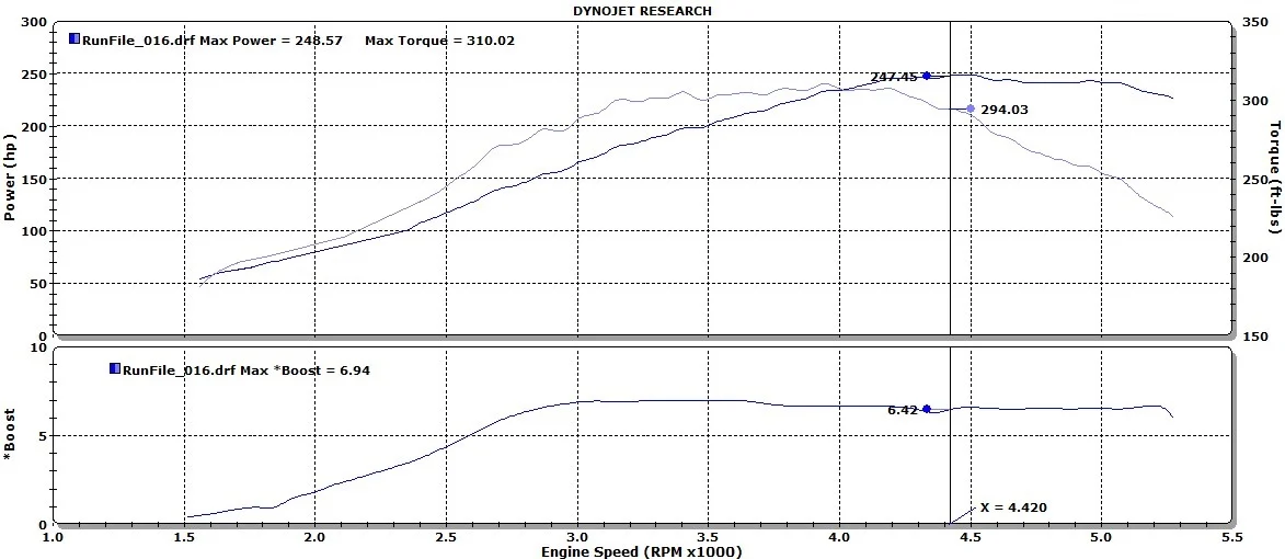

Update on the kit... We have had it on the dyno a few times between heat cycling, break-in and driveability tuning. I don't have any detailed numbers yet, but I can say it has been over 230 whp without issue.
Nice. Probably over 300 at the crank with 25% drivetrain loss. How much spark advance and boost for that output?

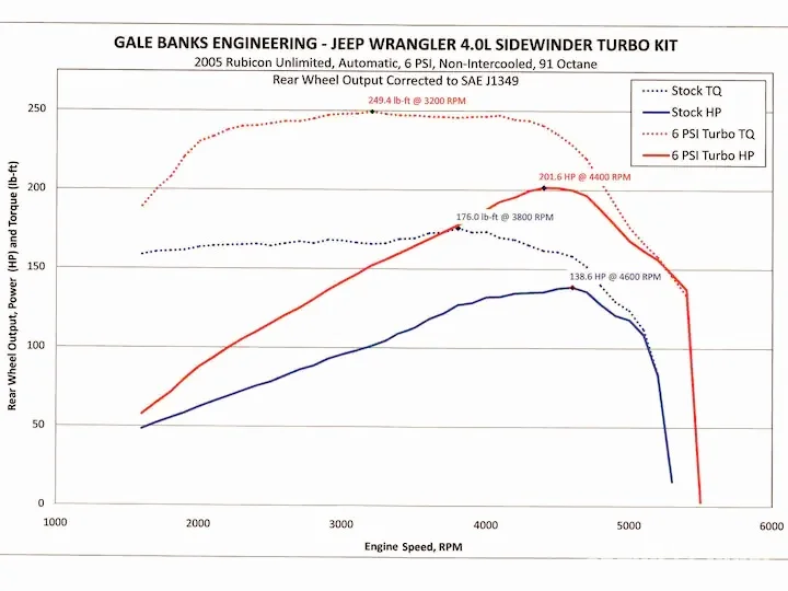

That's pretty good for the 4.0.
Anyone remember what Banks was getting with their kits?
That was from a Motortrend article I saw from a while back.

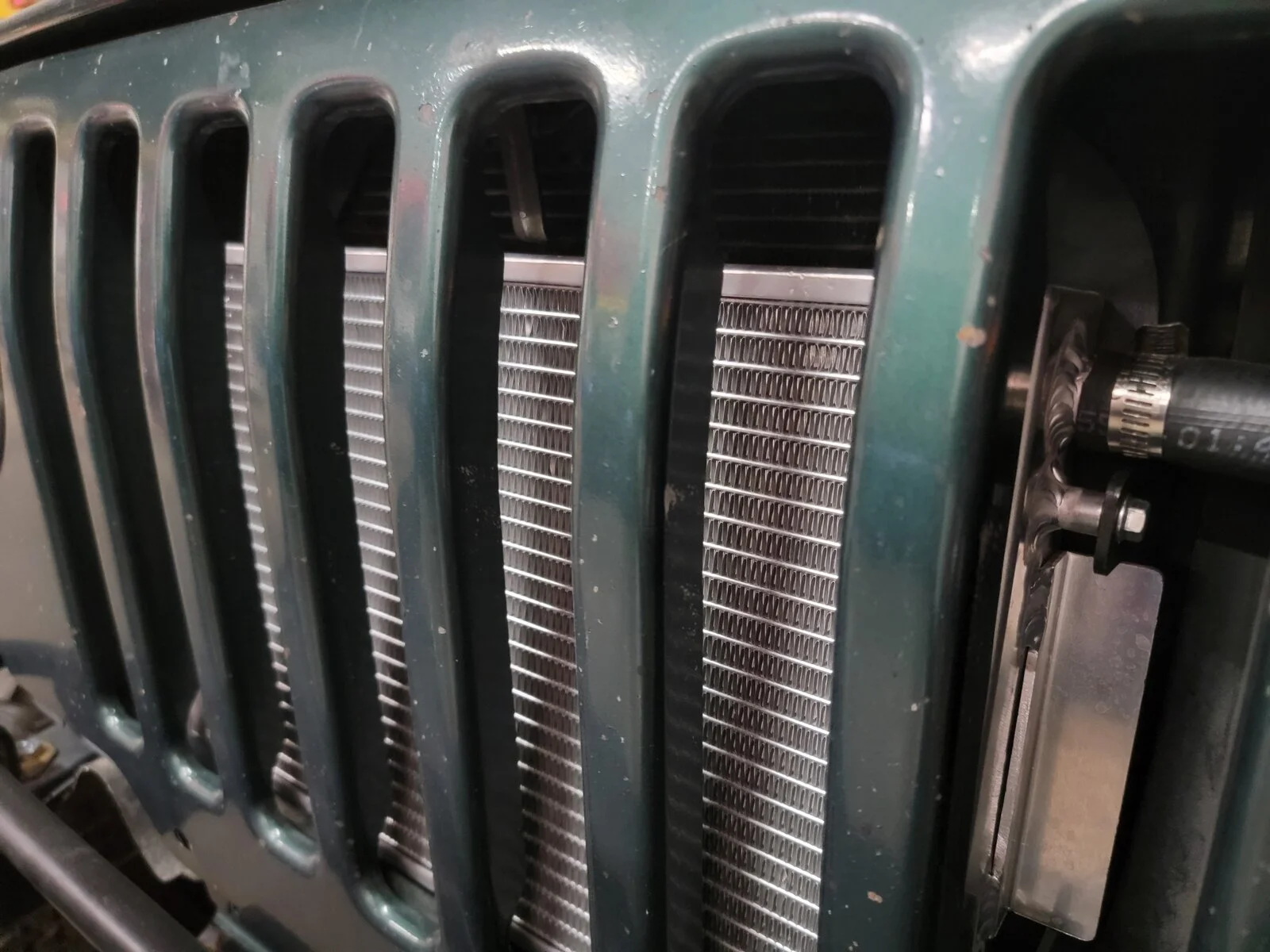

Is the hood latch the same on all years? That heat exchanger looks like it would interfere with the safety catch on my 2000. I didn't think I could fit an exchanger that large.
The test Jeep I am using is a 2000. The latch fits fine. The cooler core is mounted below the latch.

I noticed you had the same year after I posted that but thank you for clarifying and for the close up picture. Do you have the dimensions of the heat exchanger? That one seems to be a much better fit than the ones I was looking at.
17x11 core 2.25" thick
