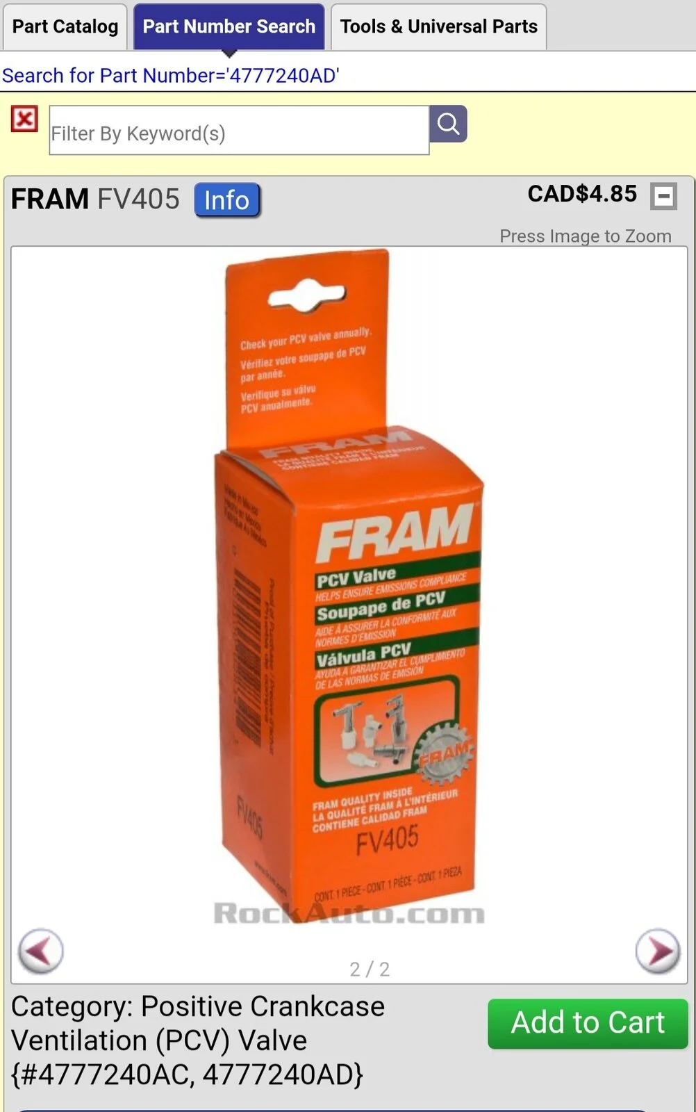

I ended up installing the Fram FV405, but I will keep your part number handy.

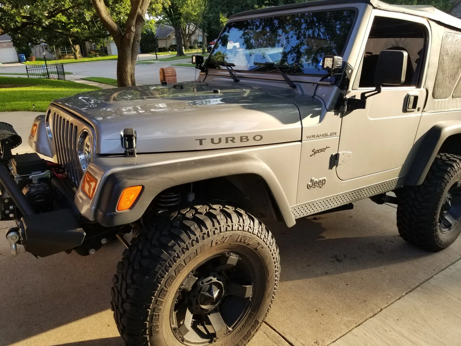

New hood decal installed today. I had a friend of mine who does this sort of thing design it for me based on the TJ Rubicon lettering. Kind of subtle yet gets the point across.

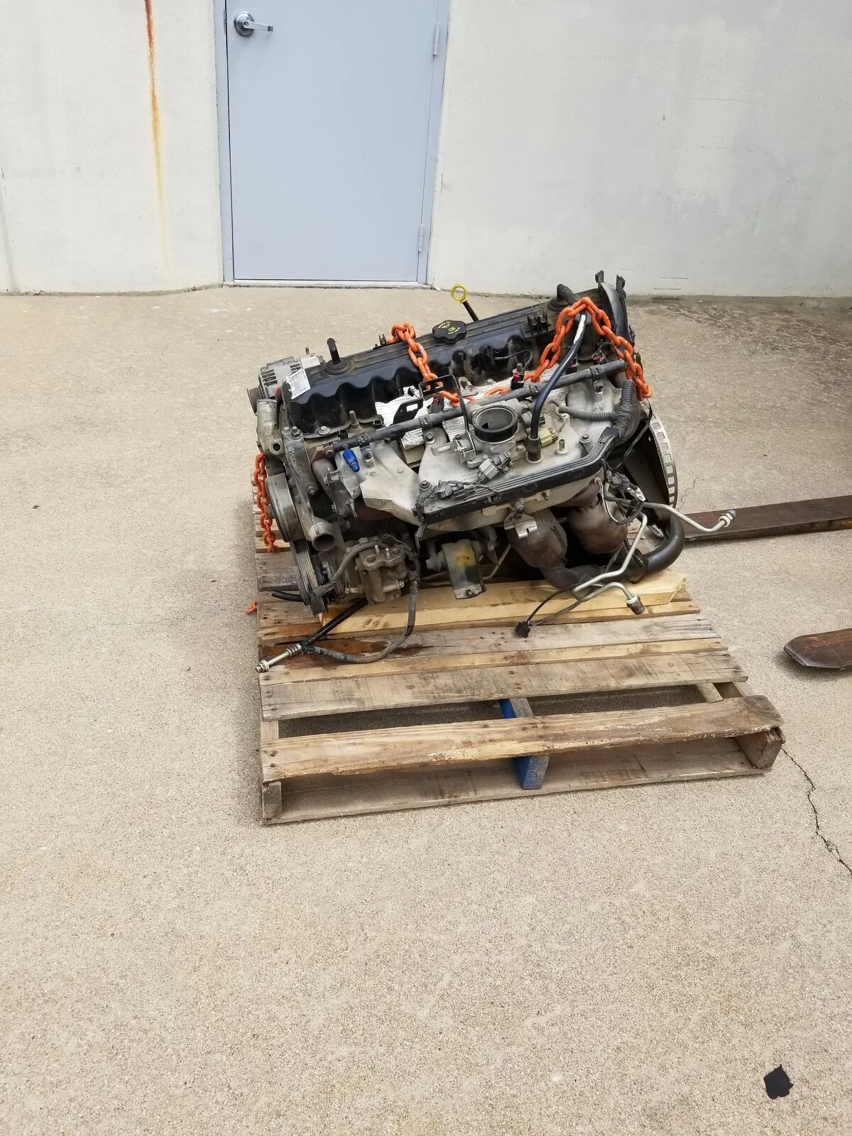

I picked up a used 4.0 last week for 5 bills. Seller said it only has 32k on the clock. Looks pretty clean on the outside so could be legit. Plan is to send the block out to my machine shop and do some version of a 4.6 stroker with forged internals. Maybe also put in a cam and up the compression as well. This project will be on the long term goal list as I have other things in line first.
I haven't decided on any particular kit yet. I want to get it torn down and determine bore size before making any decisions.

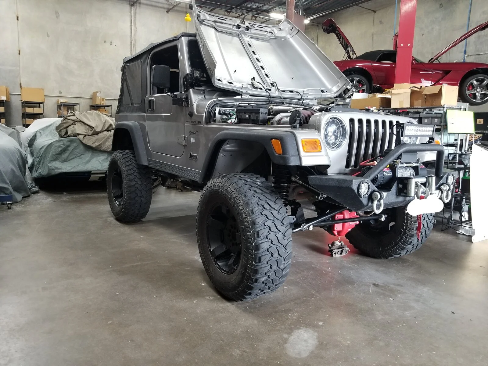

Spent some time on it the last couple of days. I finally removed the Dana 30 and replaced it with the Currie 44. I also took the opportunity to install the Savvy control arms, Rockjock springs, Currie steering, and Rockjock front and rear track bars. I also installed the spare transfer case with the SYE kit. I'm still working on the skid plate as I'm making a custom one from aluminum plate. Lots of work still to do. I'm going to pull the rear end and power coat the housing, as well as install the 4.56 gears and the ARB locker. New rear brakes, and some Genright fenders.
