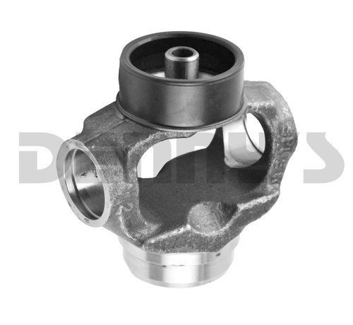

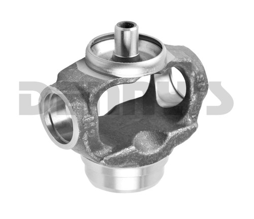

I'm no expert, but based on looking at the parts at Denny's, I believe the CV ball stud yokes are different....
This one says to use with greasable centering yoke only
And this one says to use with non-greasable only.
Now, when you look at the dimensional measurement graphic, it shows the "H" measurement (the centering stud) as 0.500 on both, so maybe they could be interchangeable, but that baffling on the non-greasable version is probably for dust protection that probably is important enough to matter if they bothered to put it there. Plus the red warning text in the description to only use each type of yoke with each type of centering ball probably should be heeded.
