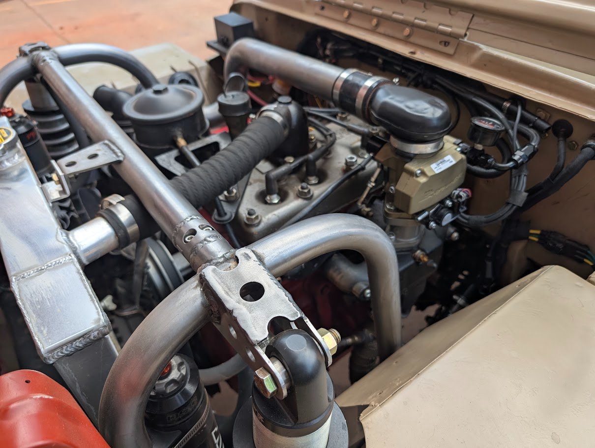

Fixed one of the issues this morning. Idle speed.
I reinstalled the Sniper EFI. When I was having engine issues I installed a Carter WO so I could rule out fuel problems. Now everything runs good, I wanted the EFI back in. I had run the fuel lines in parallel so it was an easy reinstallation.
It fired up with a bump of the key and idles nice and smooth. A quick road test and acceleration is much smoother, consistent and I was able to go up a steep hill near my shop in 2nd at a decent speed... Very happy with that.
Oh, and I set idle rpm to 600, so that will help a bit.
