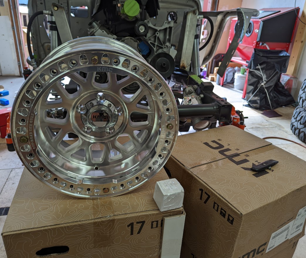

I don't mind cleaning them, maybe I'll ceramic coat the inner part. The bead lock is going to be mangled the first trip out.
Ceramic coating will not help. You will not know the difference. I have done many.
As have I. Ceramic coating is a durable wax. Nothing more. But its certainly better than nothing.

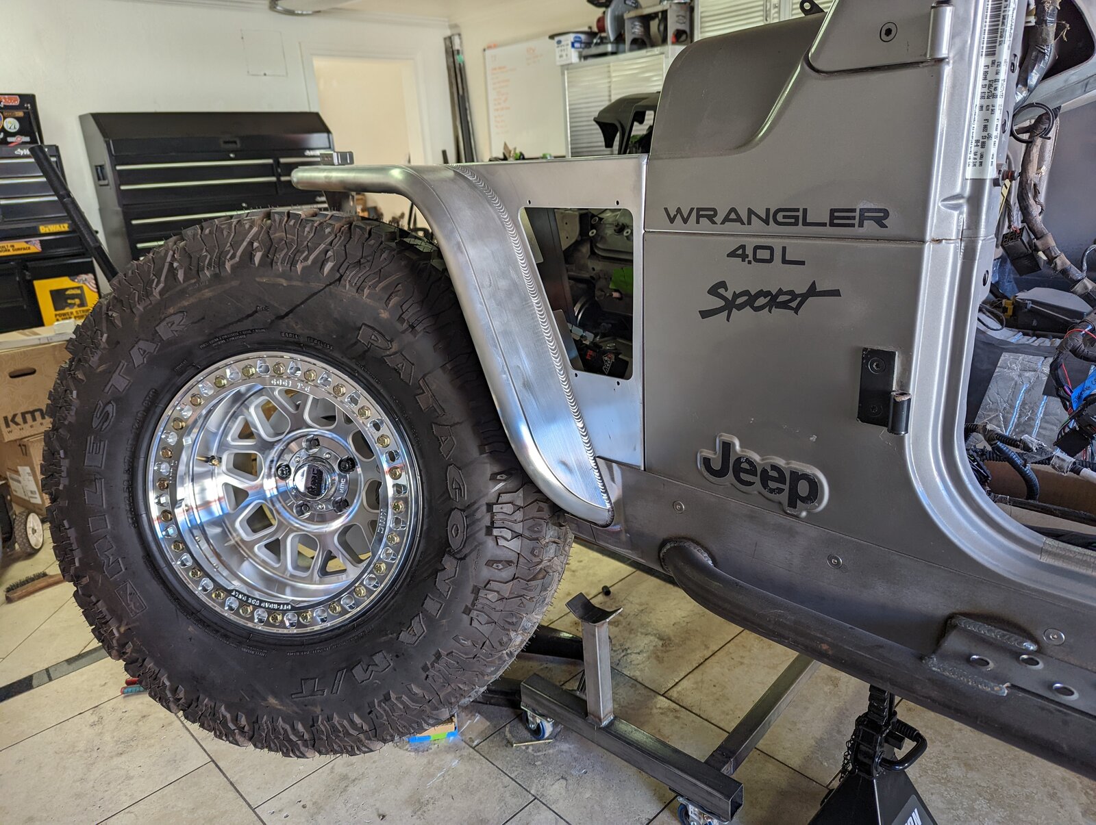

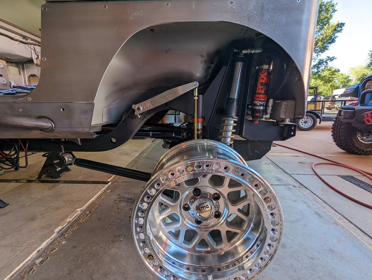

The bead lock wheels have enough backspacing that the tires will clear at full lock, full bump. At least they should. Until the 40's get here, I'm just taking measurements. But 37x12.50s clear no problem!
Reactions: kmas0n

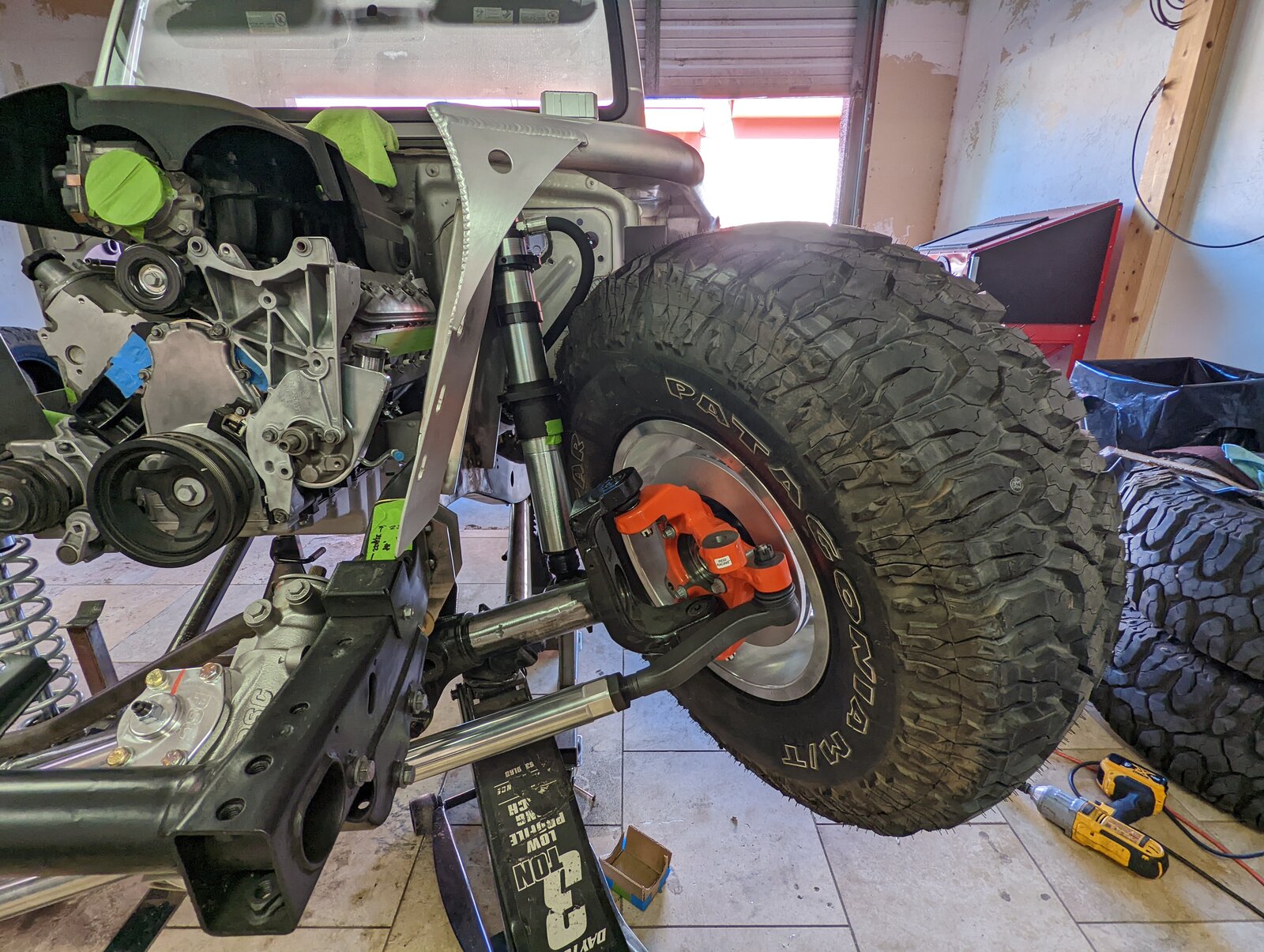

Maybe it’s the angle of the picture. Any clearance issues with the coil spring in the up travel with the wheel turned?
Yup, see post 573.
With the 3.5" backspacing there will be room, but it's still close at the theoretical limits
