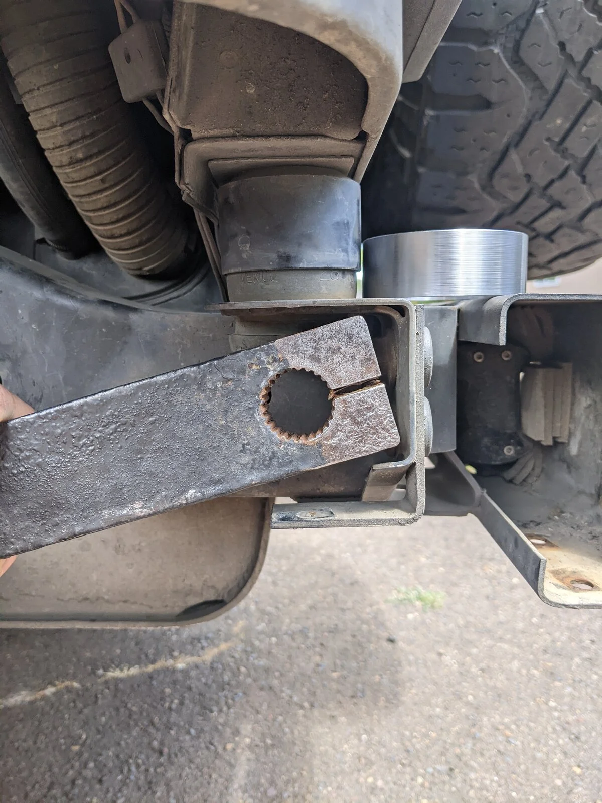

Also, ordered so Nitto Trail grapplers today... 40x13.5R17.
After lots of careful measuring, there is room, with maybe a little rubbing on the fenders in extreme situations.

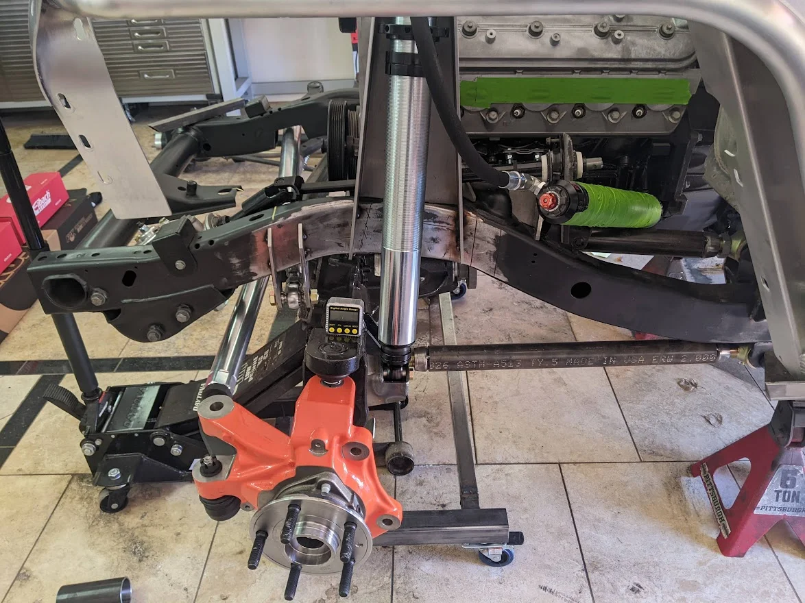

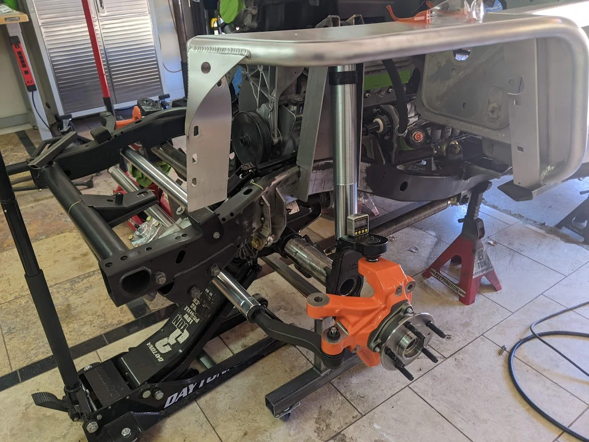

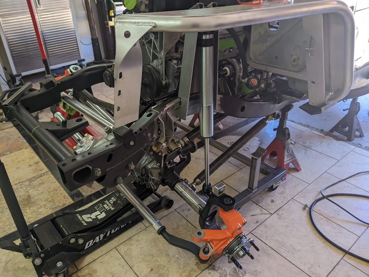

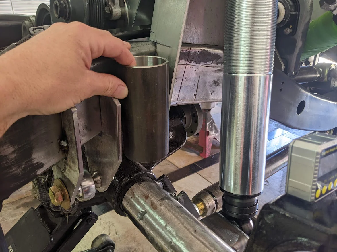

The rough draft of the shock tower is together... this is actually version 3.0. One thing to note... 2.5's max out what the poly towers are capable of. There is VERY little wiggle room. I had hoped to cant the towers back at the same angle as the rear (for my OCD), but there isn't enough room for the shock to swing front to back unless they are closer to vertical. So they are nearly upright (85*). I put the steering shaft back in to make sure there is no interference.
full compression.
Nearly full extension. I need some taller jack stands. The castle bolt is laying on the floor at 12" of droop... so, its going to need a lot taller. Currently its going to work out 5 up 9 down front and 6 up 8 down rear. I may increase ride height another inch for 6up 8 down/ 7up 7down. According to the internet, its better to have slightly more up travel in the rear, so this is perfect.
I may also have to lean the towers out a few more degrees. At full flex the springs are going to contact the frame. currently they are about 3*
I did a quick cycle with a tire on and it doesn't get anywhere near the shock at this config, so there is room to move.
Full compression from the side. The shock is biased towards the front of the tower at full compression. Neutral at ride height. How neutral? at ride height I can easily slide the bolts out of the shock ends.
Potential hydro bump location. I like that I can tie the trackbar, bump stop cup, and shock tower together.

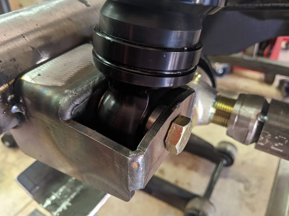

Interesting. The 2.5 foxes come with a different rod end (com 10?) that looks like a rubber bushing with a 1.5 width, so no goofy spacers needed. Clearance is tight here. I had to drill a large hole in the bottom of the shock mount to clearance the shock end.
Resisting the urge to weld all the things. Still a few things to check, tweak, and nudge. I think the front has been easier to fabricate than the rear.
What rubber bushing are you talking about in the lower eye? Should be a Com10 bearing with two metal spacers that go into the bearing. Maybe you got the new style spacers with O rings on them?
full compression.
Have you checked the clearance for the springs? A trick I used while doing the setup was to leave the center spring follower in place. On my shocks it’s the same outside diameter as the springs. Slide it up and down during cycling and you know your spring clearance.
Looking good, You're gonna like the 2.5s. I'd raise it the inch for 7/7" split in the rear. I've got 8" up in the rear and 6.5" in the front and it gets after it as much as the tractor motor can push it
I checked the shock ends this morning. You are correct, Com10 bearing with two spacers and a large o ring. Thanks
I've been sliding the spring over the shock to check clearance. Thanks for the tip!

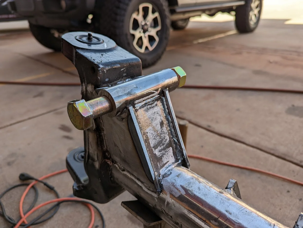

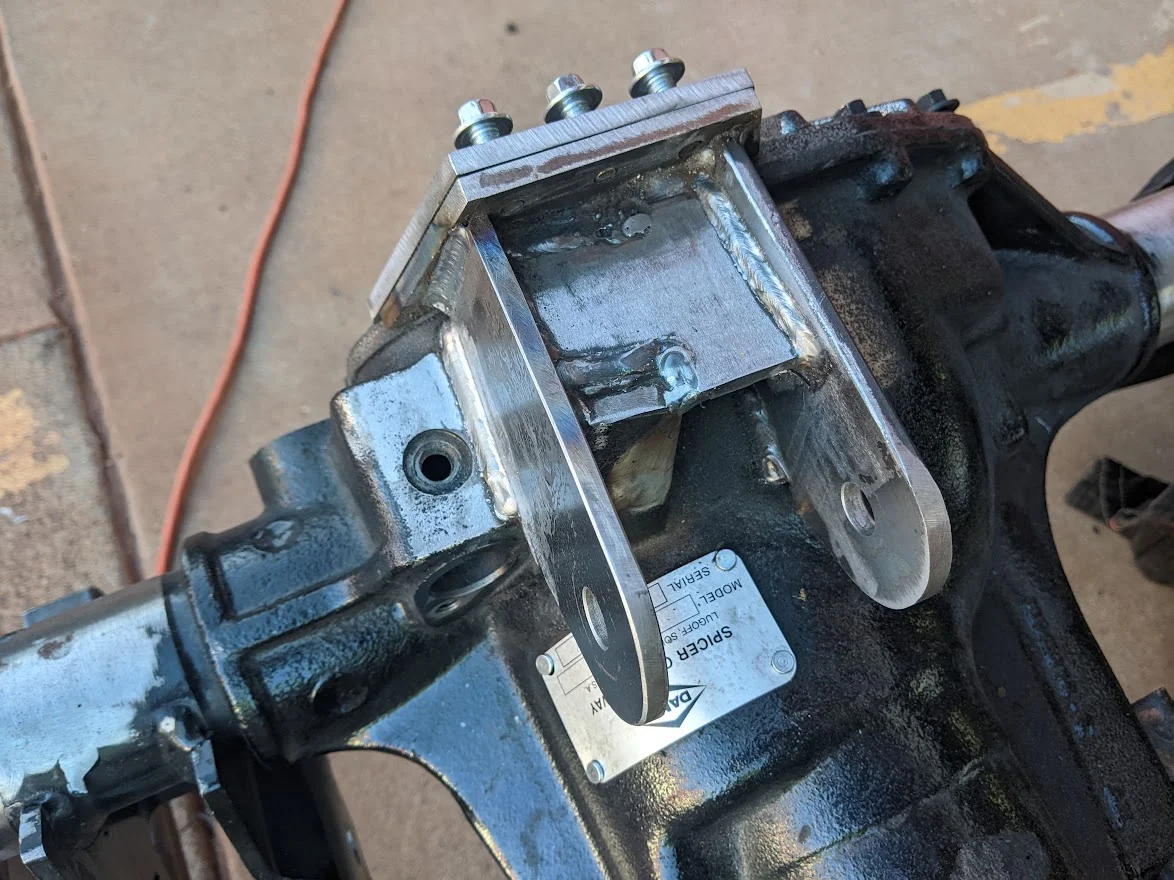

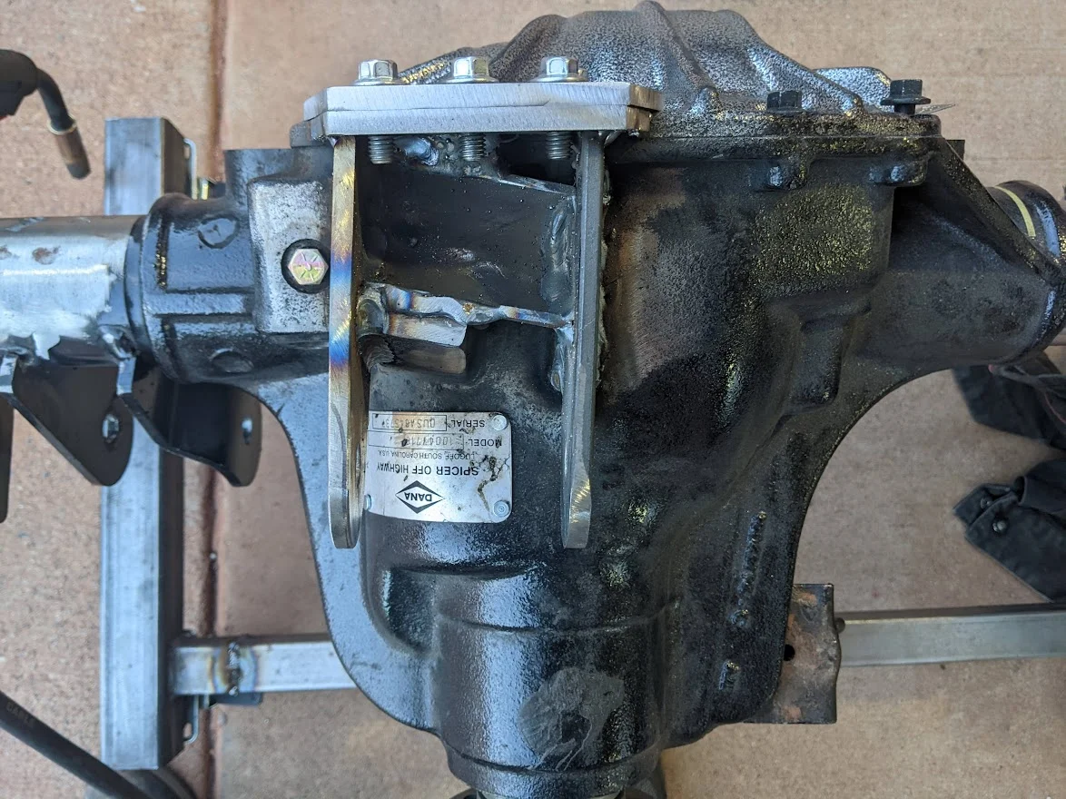

I'm confident about the placement of the trackbar and upper link mount, and I got tired of the tack welds breaking when cycling for the coil overs, so I welded the mounts up. I thought I would include a little detail about the upper link mount.

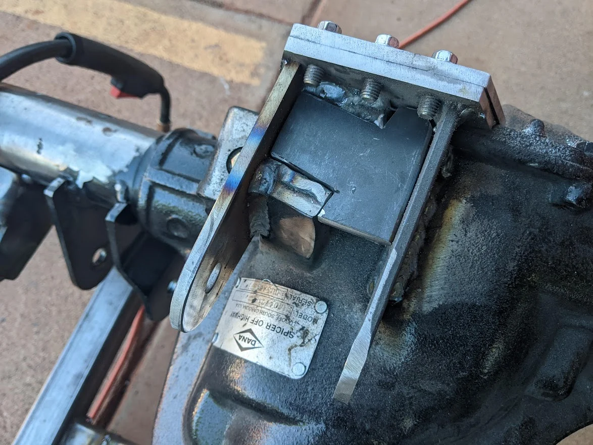

I cut the factory style upper mount in half, so there were two prongs sticking up and then fitted some tube for an internal structure.

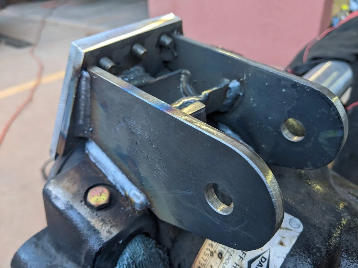

Then I built the link mount from this foundation.
I was able to weld the 1/2 tube to the inside of the link tabs, as well as weld them to the housing. Usual treatments were performed, pre heat, post heat, blanket for slow cooldown.
Other side.
Top view.
I still wanted a little more support in between the tabs and the prongs, So I made this little bridge that tucks down inside and anchors everything together.
welded.
As mentioned a few pages back, the reason I didn't do the standard truss bridge is with the V8 there simply wasn't room for one without loosing significant up travel. So this is as strong of an upper mount as I know how to make. Gusseted internal structure, and a differential cover tie in. For a failure, I would have to hit something hard enough to rip the top of the pumpkin off.
