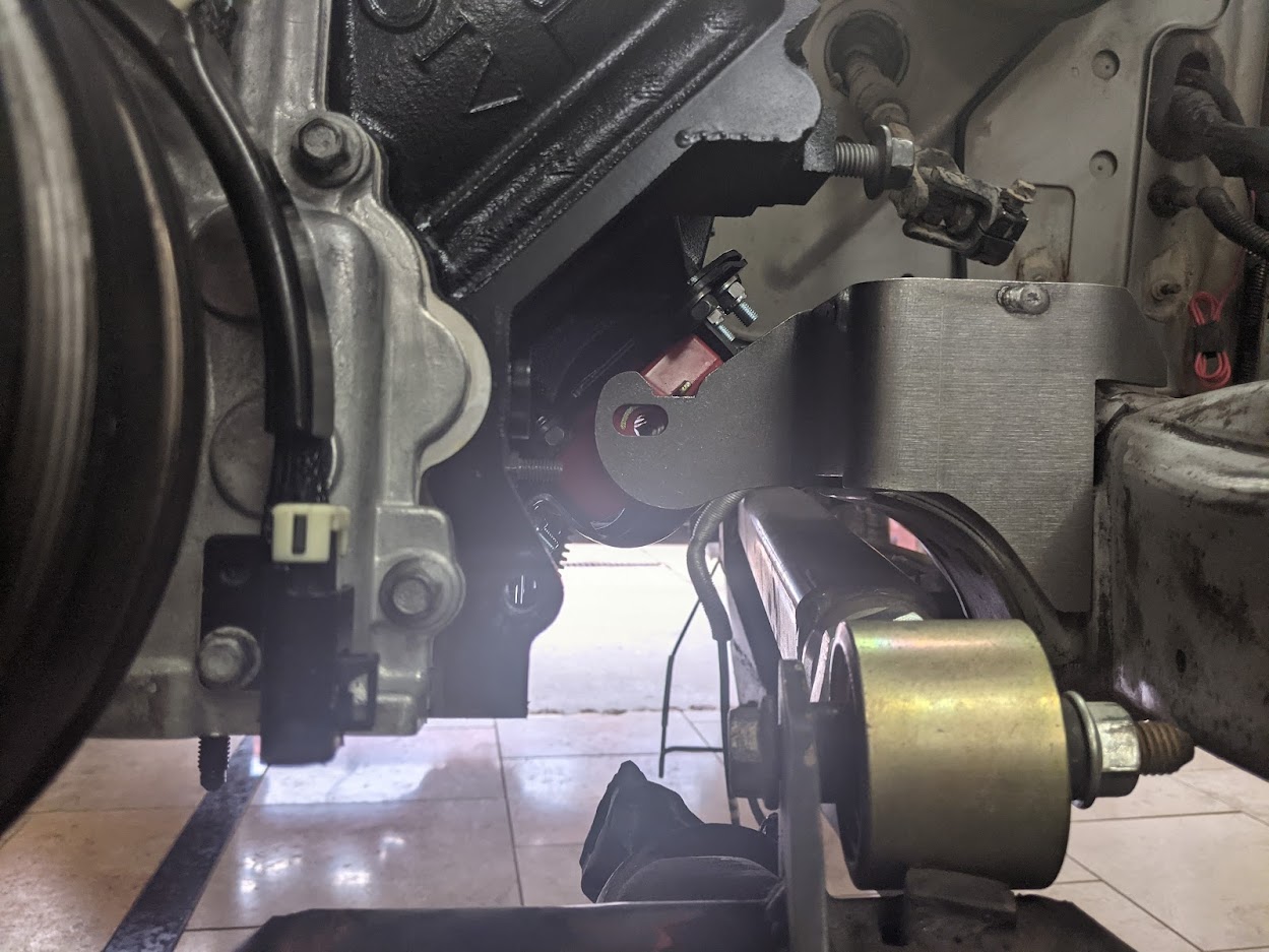

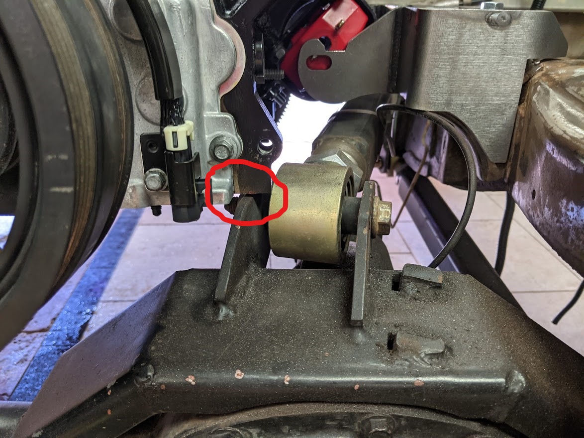

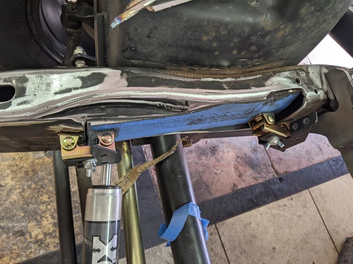

I'm thinking I'll relocated it on top of the factory mount... The two square nubs. Should be plenty of roomBreak out the angle grinder
It looks like of you hadn't mounted it to the rear of the pumpkin it would be fine. Do you not want more link separation? If were on top and centered like the savvy 3link I don't see any interferenceI'm thinking I'll relocated it on top of the factory mount... The two square nubs. Should be plenty of room
The upper-link just needs to move towards the driver's side. I'm thinking about 2 inches or so. How much separation do I need? I have 8 at the frame and 9 at the axle. The upper and lower links are near parallel and the same length.It looks like of you hadn't mounted it to the rear of the pumpkin it would be fine. Do you not want more link separation? If were on top and centered like the savvy 3link I don't see any interference
If you have enough clearance on the frame side, I think that looks good. Also appears that you have a little more clearance under that part of the mount.Ok, so my solution is simple, I kept the driver side of the mount, and relocated the upper link to the other side of it, I'll make a new driver side mount (unless someone thinks single shear is enough) This should free up plenty of room for the exhaust too. Once the pan comes in I'll be able to check clearance for the truss. its going to be tight and may require a cutoff wheel and welder (My two favorite tools). Again, these are all at the extreme limits of travel, such as bottoming out hard off a jump, but we certainly don't want the oil pan being the hard bump.
Frame side is good, I wish I had the exhaust headers in, that would help confirm placement, so I'll just go with "as far away as possible" from them. I've fully flexed it and everything clears fine.If you have enough clearance on the frame side, I think that looks good. Also appears that you have a little more clearance under that part of the mount.
Before you burn it in, if you have not done so check your clearance at full articulation (full stuff on one side while at full droop on the other) both ways. If that works I’d say you are golden.

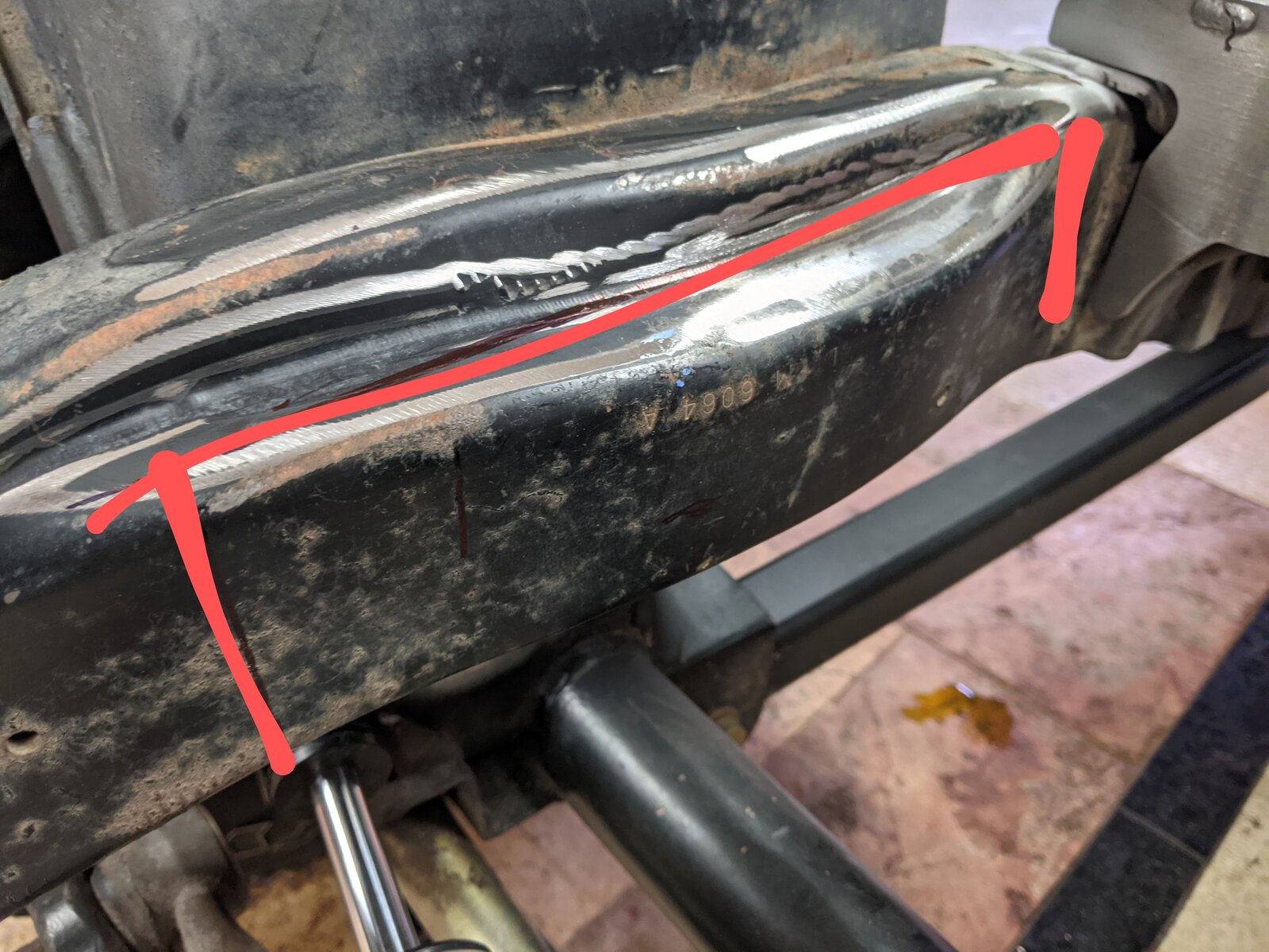

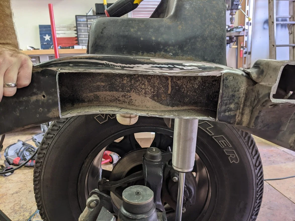

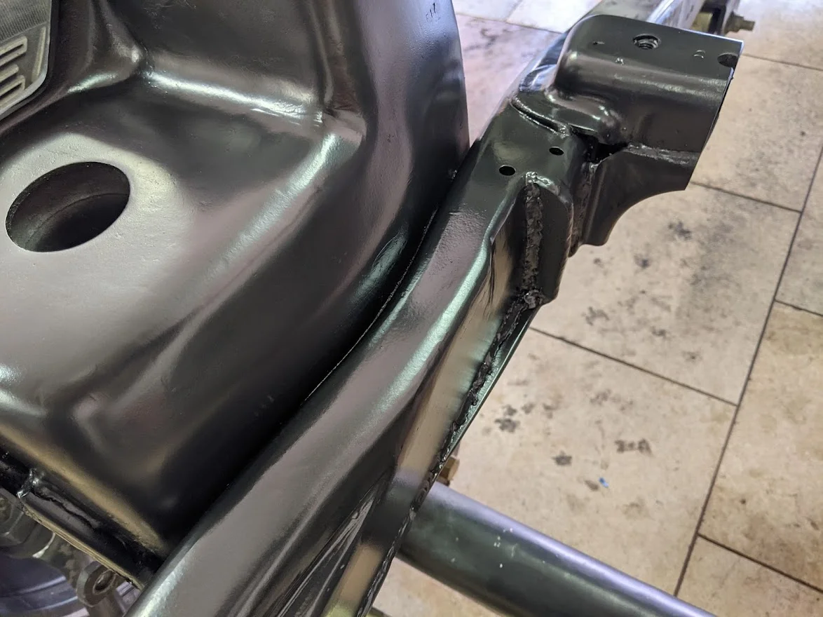

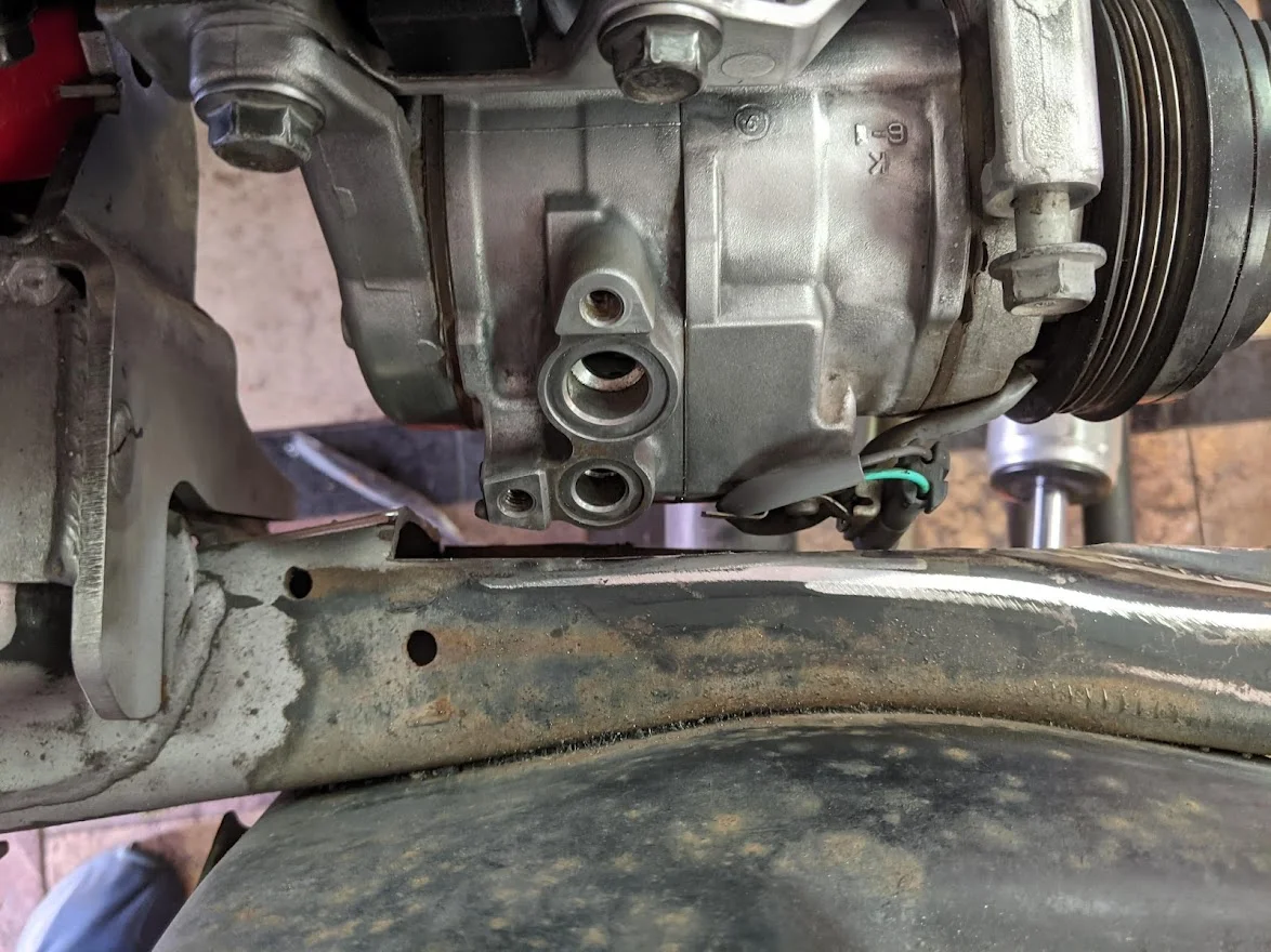

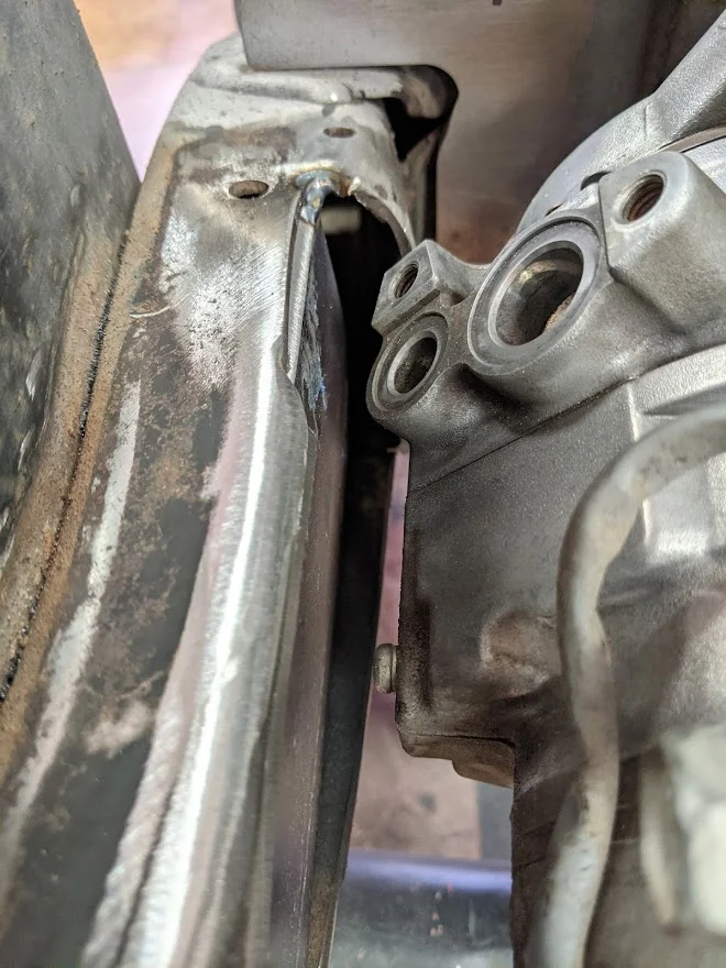

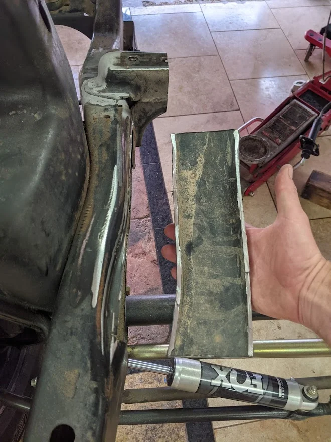

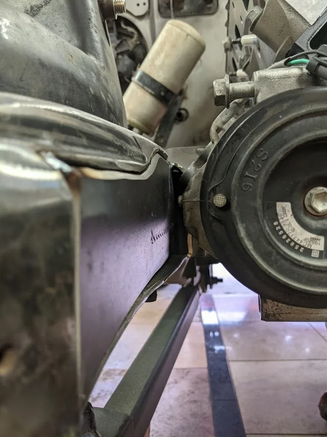

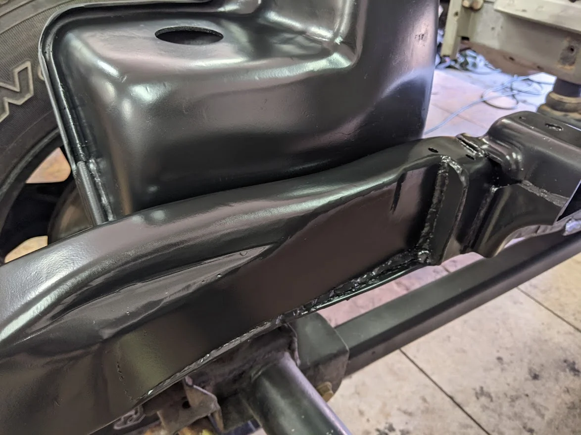

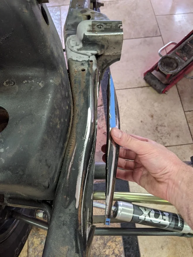

Have you looked at Tox's thread? I thought he did something along these lines.On to the next bit of frame modification. The vortec truck engines have thier ac compressor mounted low on the passenger side. The frame of the tj is too narrow and has to be notched. They make ac compressor relocation kits, but that's for people who are afraid of cutting and welding thier frames. I really can't find any pics online so this is what I've come up with...
My thoughts are cut a transectional rectangle slice out, flip it, and weld it back in. The better my rectangle, the better the notch. The outie will become an innie.
Anyone have any thoughts? Pictures? What have others done?
