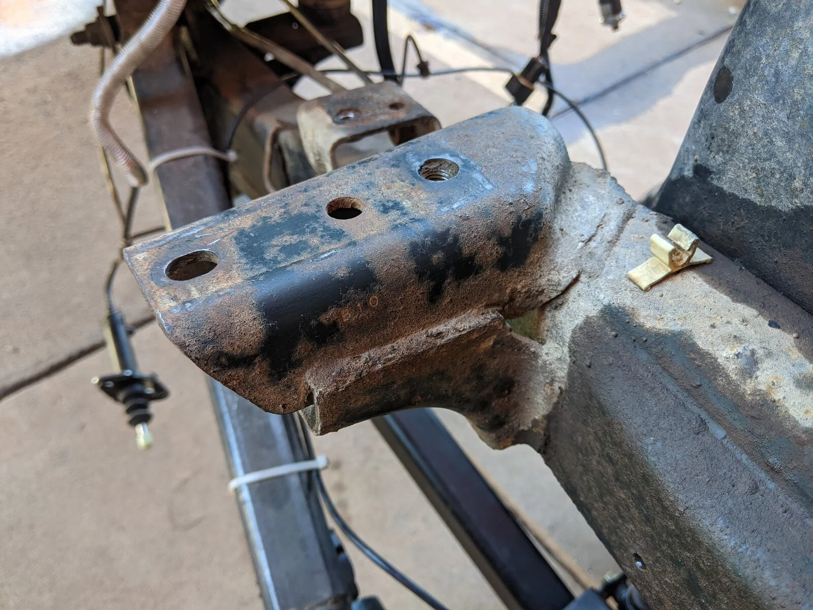

1) what front 3-link? Savvy goes up into the area that those brackets occupy.
2) check the cam characteristics. Choppy isn't fun crawling.
3) 2.72 or 3:1 isn't going to be the same in mine vs yours since our engines have different outputs. I'd look into a jk 4:1 for yours.

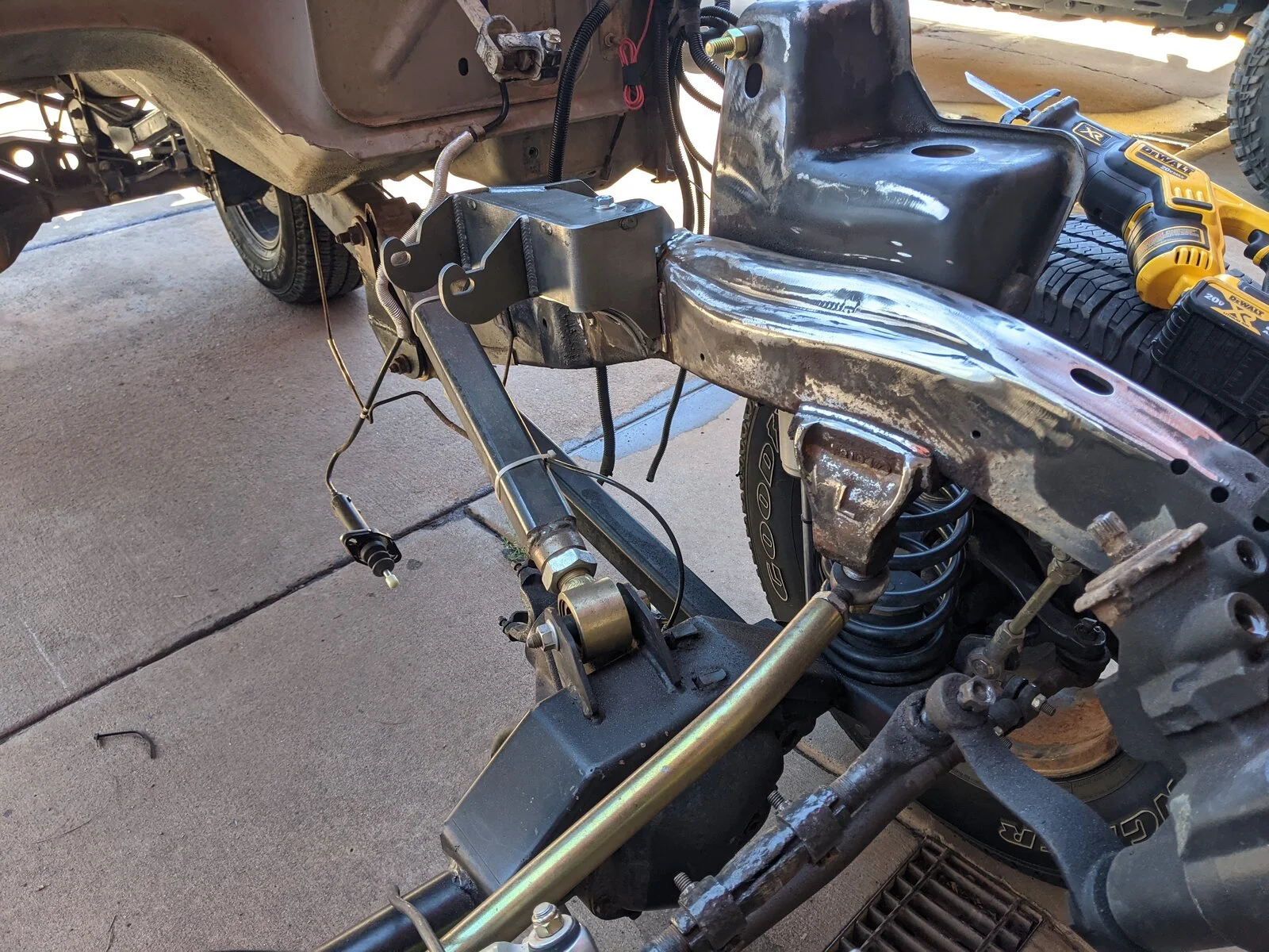

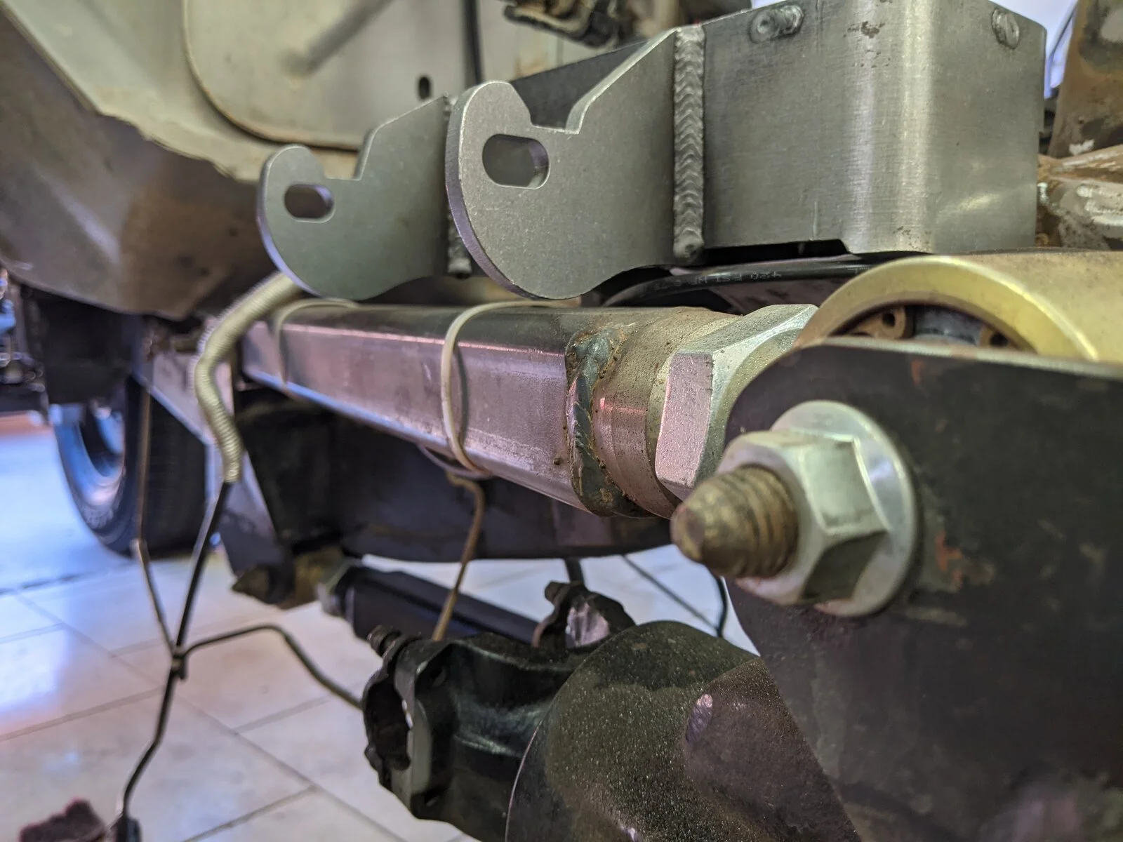

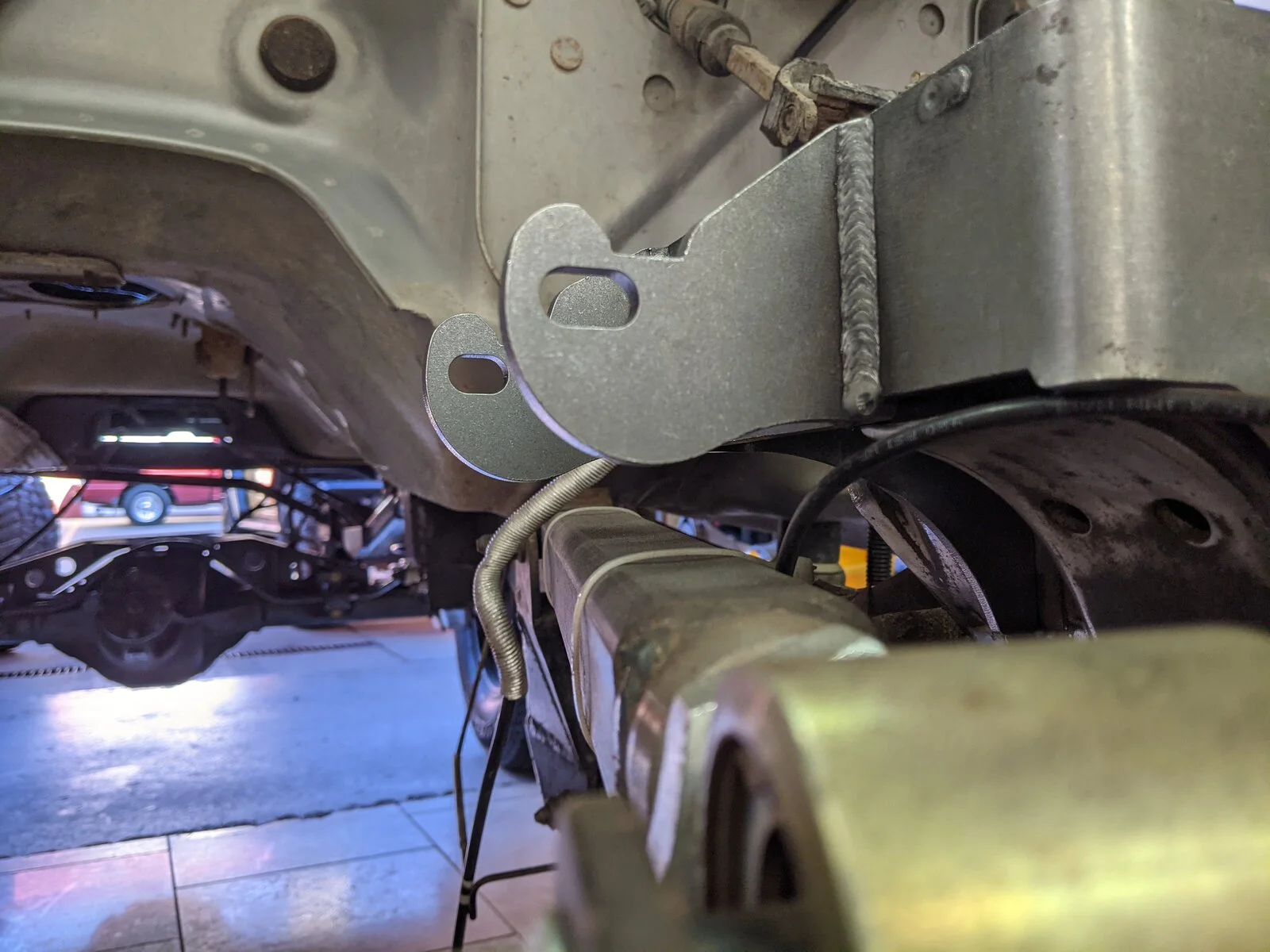

1) My 3 link is all custom. The upper-link on the axle sits low and behind the truss. Pretty close to the level of the factory mount.
2) Feedback is great if anyone has used their cams... they claim they have a very smooth idle and no loss below 2k
3) I'll look into the JK 4:1 before I order the adapters
Much thanks!
edit.
here's what I mean by low and behind the truss. You can see the tabs for the factory mount. The truss was a Clayton, and I shaved about an inch off of it to tuck things in. The bolt is pretty close to where it would have been in the factory location, maintaining factory separation. I don't really know what the savvy kit does. Upper and lower links are the same lengths for zero caster changes during suspension cycles.

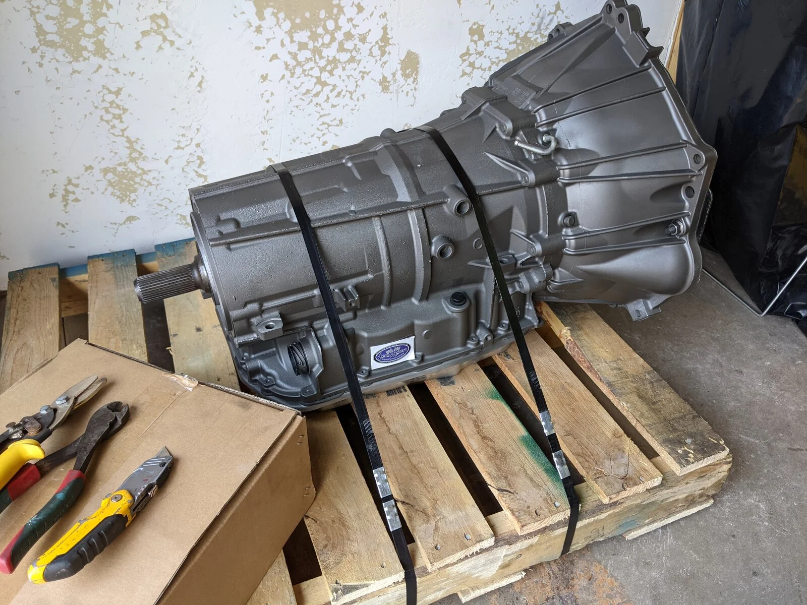

The 6l80e and standalone wiring harness arrived yesterday. Zero gravity has been a pleasure to work with. The transmission arrived well before promised, was well packaged, and looks fantastic. If the same care has been given to the internals I'm expecting a very good transmission. Zero gravity performance has been very responsive to phone and email correspondence. Very refreshing.
I'm going to throw another shout-out to Jim at Zero Gravity Performance. I had sent him an email informing him that the transmission and harness had arrived and that I really liked the paint he used to finish it. Today this arrived in the mail... Without being asked, Jim sent me a can of the paint he uses so I can paint the transfer case to match.
If anyone is looking to have a transmission rebuilt, or is just buying a new or rebuilt one (he can get you a brand new one for 1k more) consider contacting Jim at Zero Gravity Performance. It's worth a little extra money.

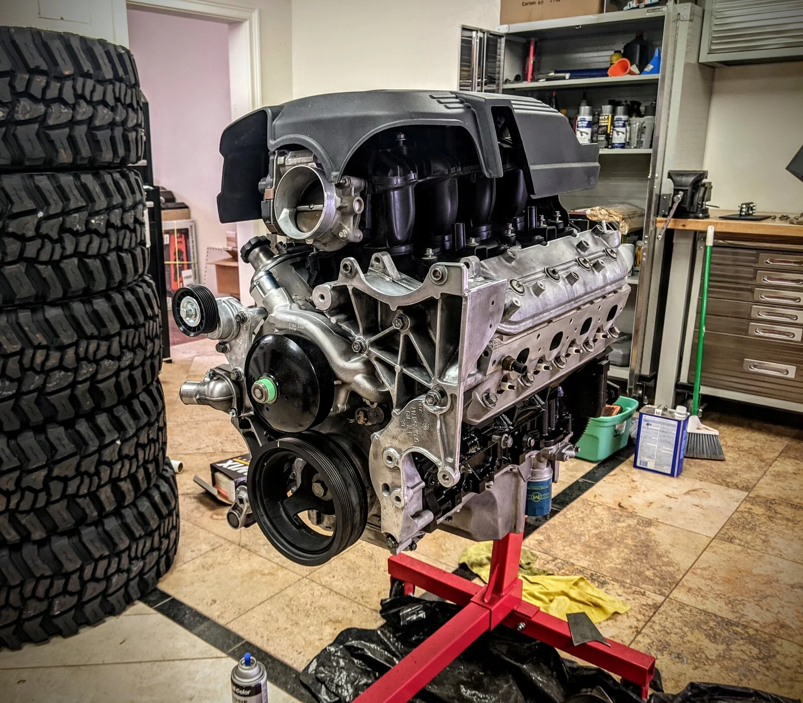

Not running right. I've decided to keep things as close to factory Silverado as I can. Same transmission, truck exhaust manifolds, truck intake, truck accessory drive, factory camshaft. The trucks this engine came out of are incredibly reliable so the closer to stock it stays, the better. A wild tune, aftermarket camshaft, mismatched intakes, and mismatched pullies are all a recipe for unreliability. The 315 HP the engine left the factory with will have to do.

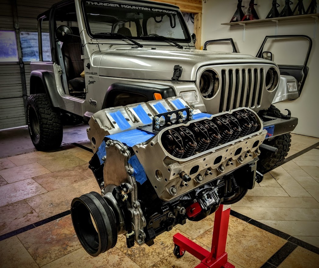

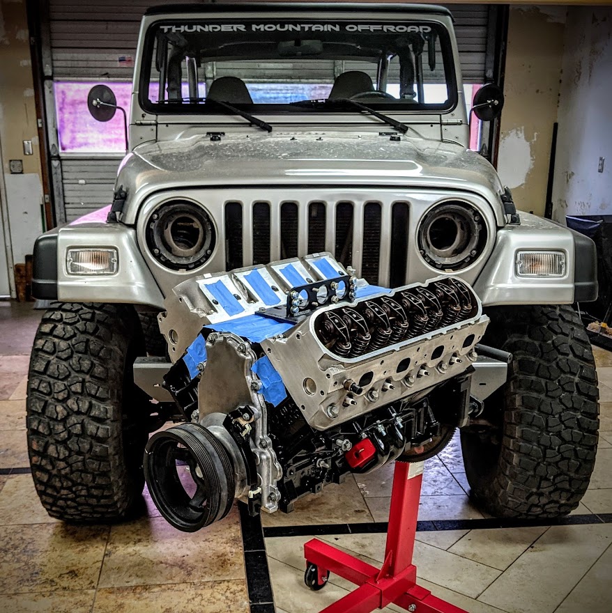

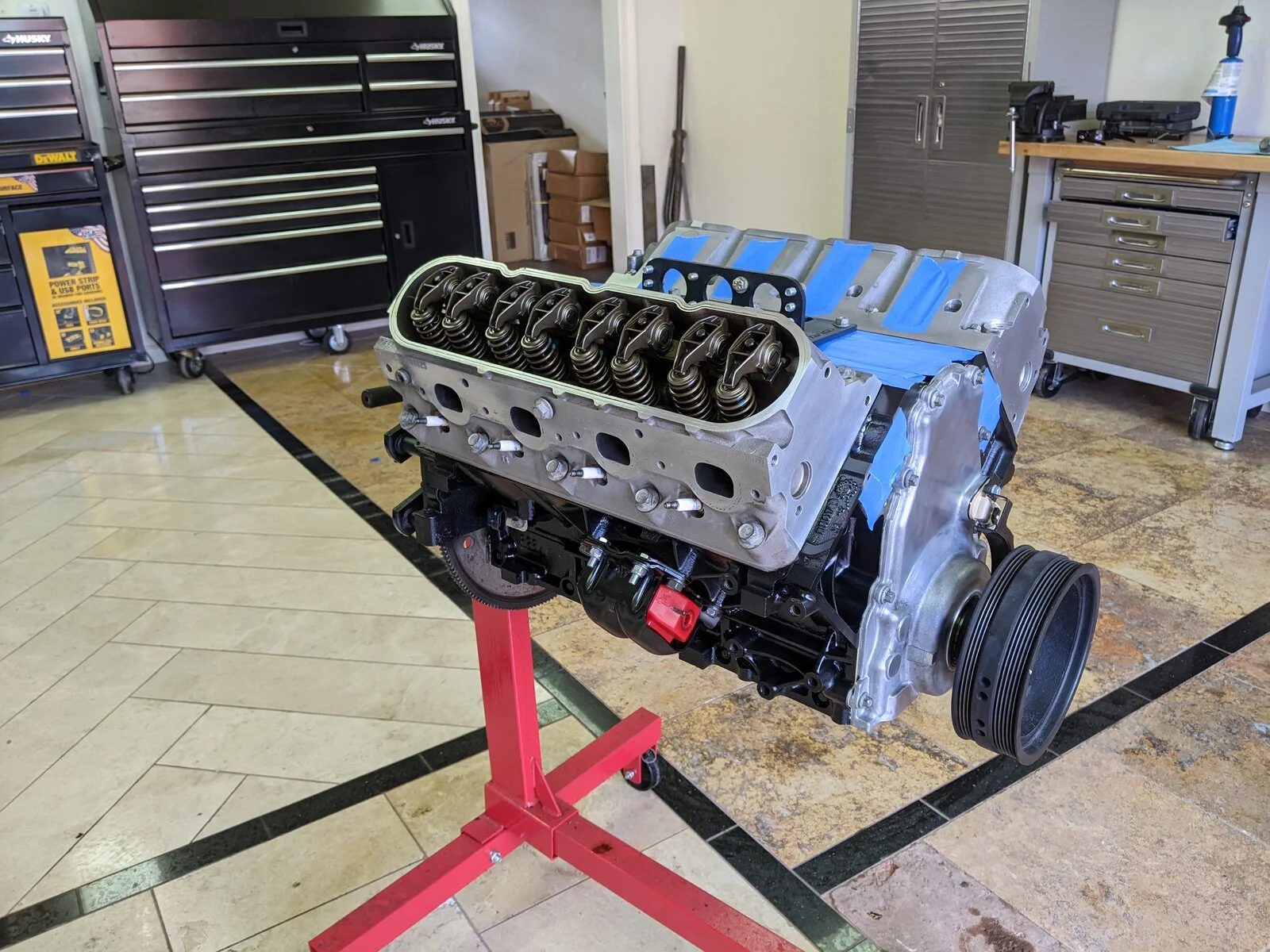

Block is cleaned, painted, polished. Replaced seals etc. Everything looks clean inside. The hash marks are still on the cylinder walls. Bearing surfaces look good. No coke or build up. I've replaced water pump, ps pump, alternator, tensioners, pulleys etc. Cleaned and polished the accessory drive brackets. I've done everything that I want to the block. Now it's time to start disassembling the TJ

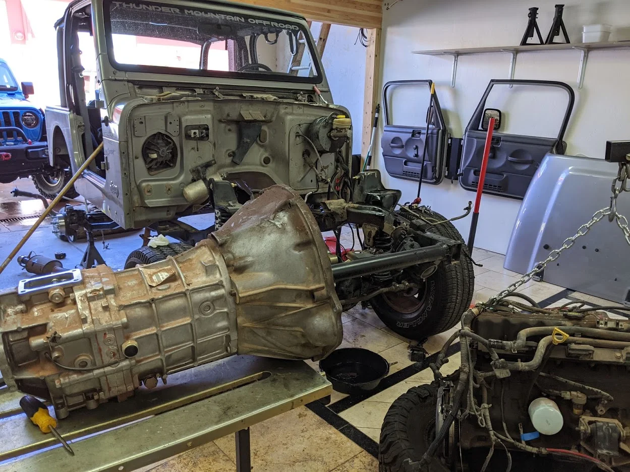

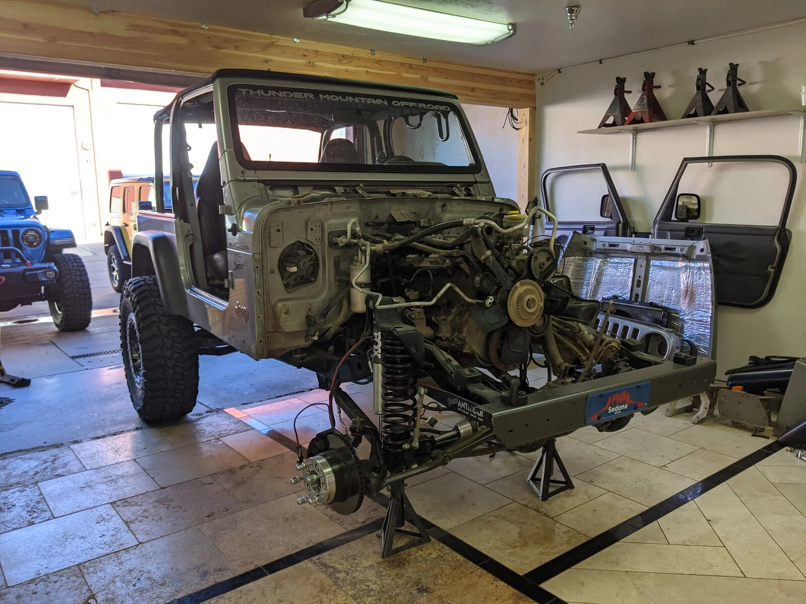

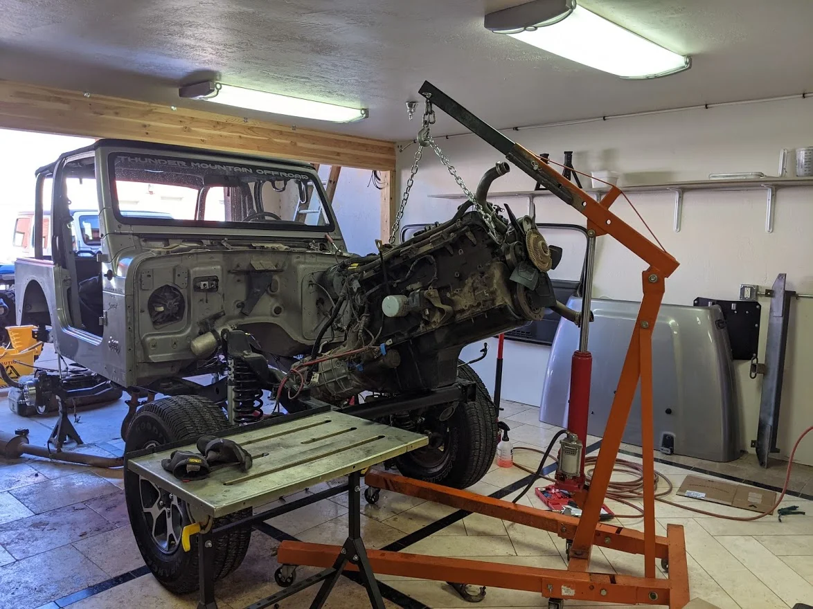

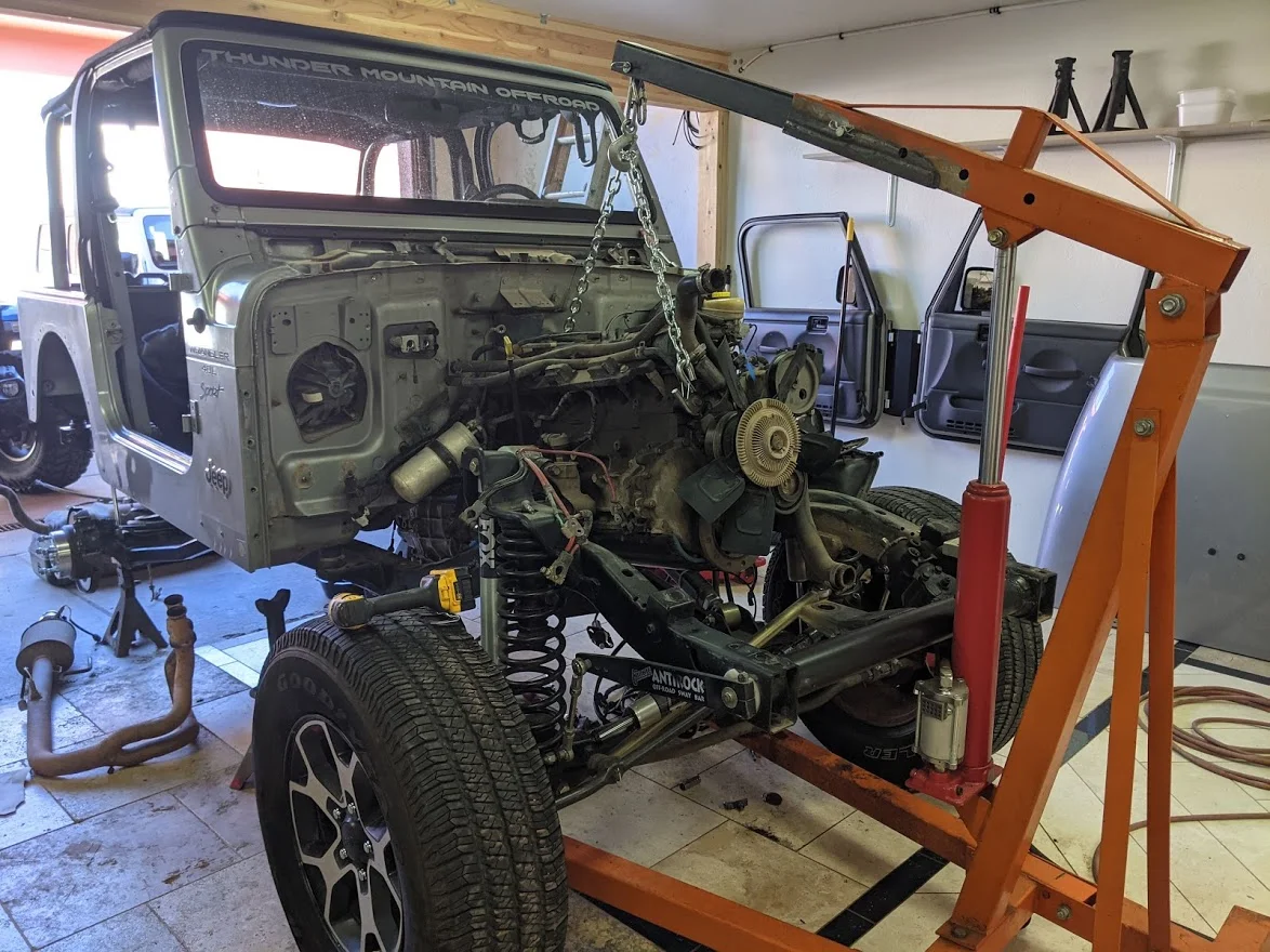

I took the 4.0 for one last spin. It's been a great engine. Not exactly inspiring, but it got the job done. I drove around town clicking smoothly through the gears, the last spin with this AX15 too. Parked it in the garage and took a few pics for Nostalgia's sake.
The next time it comes out of the garage it's going to be a very different machine. It's also going to be a hard few months.
Yep - I remember that last ride when I did mine. Serene.
Its an enormous amount of work, but the entire driveline, exhaust, fuel system, and braking system have been removed.
The brake line routing is being modified, the fuel system is being converted to AN lines so it all had to go. The tank has been dropped to facility the "butt crack delete".
Its so close to being a full frame off restoration at this point.... why not?

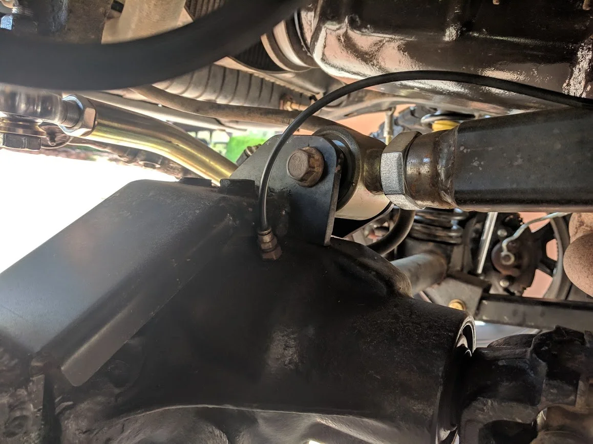

Is that mount going to clear the upper control arm at full bump? Looks close in the picture, but hard to tell.
One of the reasons I'm choose the blackheart mounts is that they weld to to factory motor mount brackets, and don't hang any lower than factory. So if the suspension worked with the 4.0, then the new motor mounts won't have any interference. I'm worried about the engine itself getting in the way. I'll get it mocked up soon.
At full bump, with 2" of bump stop extension, there's plenty of room...
With only 1 inch of bump stop extension its pretty tight, less than 1/8"...
This is good info for the future in case I decide to eventually fabricate a hoop for coilovers. Currently my shocks dictate 2" of bump stop extension. And tires hitting fenders, but I'll be addressing that
