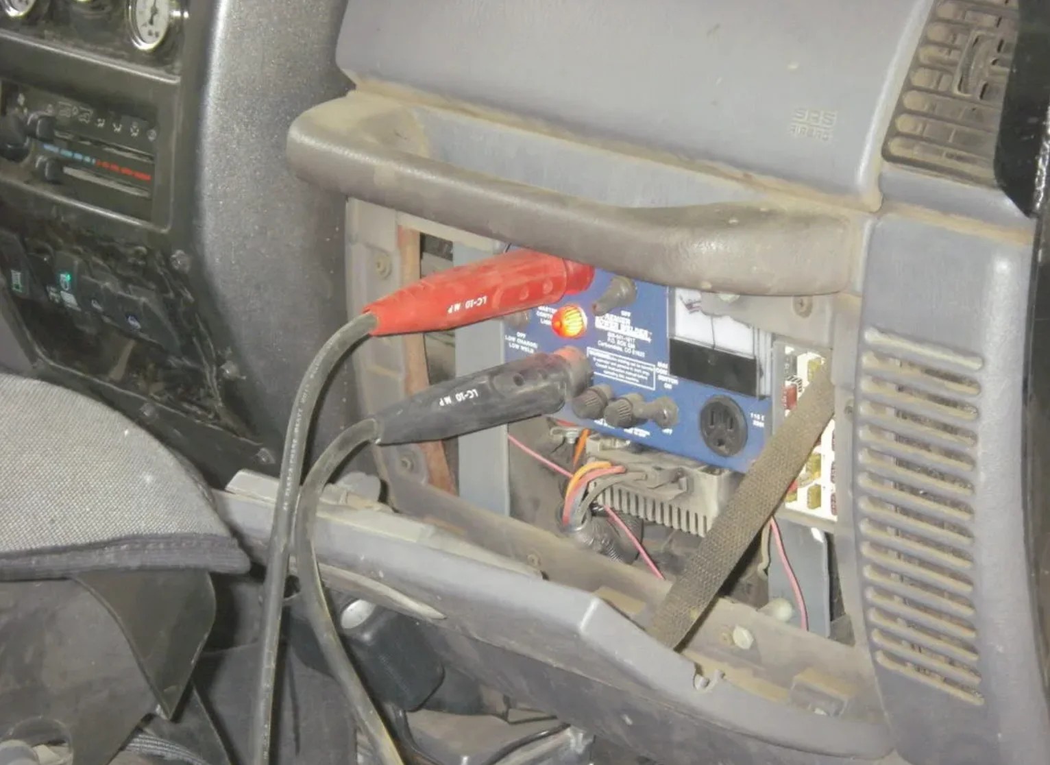

As someone who has one believe me it's more than worth it. Like @NashvilleTJ I mounted my unit in my glove box due to a lack of room under the hood.

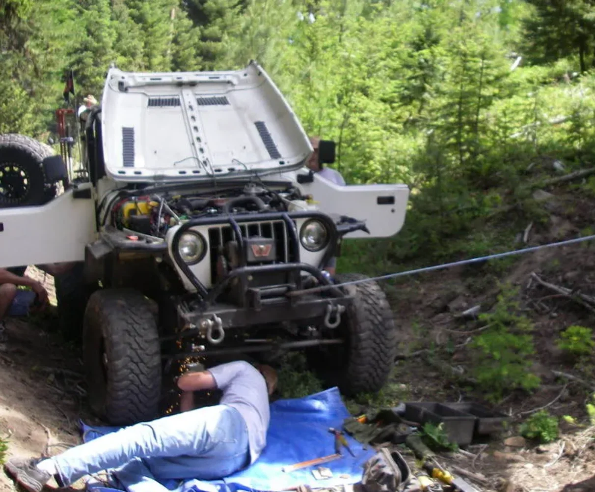

Broke my trackbar bracket on the trail so had to do some repairs.
I keep 6010 rod for use on the trail. I also have a Ready Welder for working on others rigs or if it's a part I can remove from mine. As has been mentioned before when using the Premier to power the Ready Welder you cannot weld on your own vehicle.

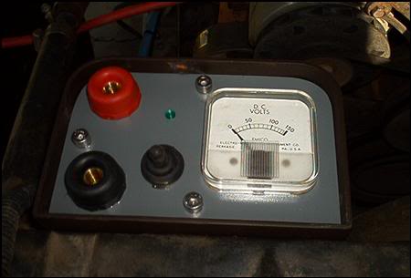

After a Rubicon trip fail because someone had a steering box come off the frame and no one had a welder, I built a welder when I got home.
120 amp Ford externally regulated alternator and a simple control box I made. The switch sent 12v to the field post on the alternator and that's it. Flip the switch, run up the RPM up until you get the voltage you want, and go to town. Higher the RPM the higher the voltage. Could easily get it over 120v if you really wanted to. Used it a ton mostly for other people and it was awesome.

Building your own is pretty cool. Your control box is first rate.
Was a stupid simple project I did in the late 90s. I had most everything and the room to do it.

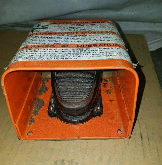

Thank you. The lead connections are Lincoln and the gauge I got used from a surplus place. The box was a cut down OSHA pedal guard exactly like this one :D
