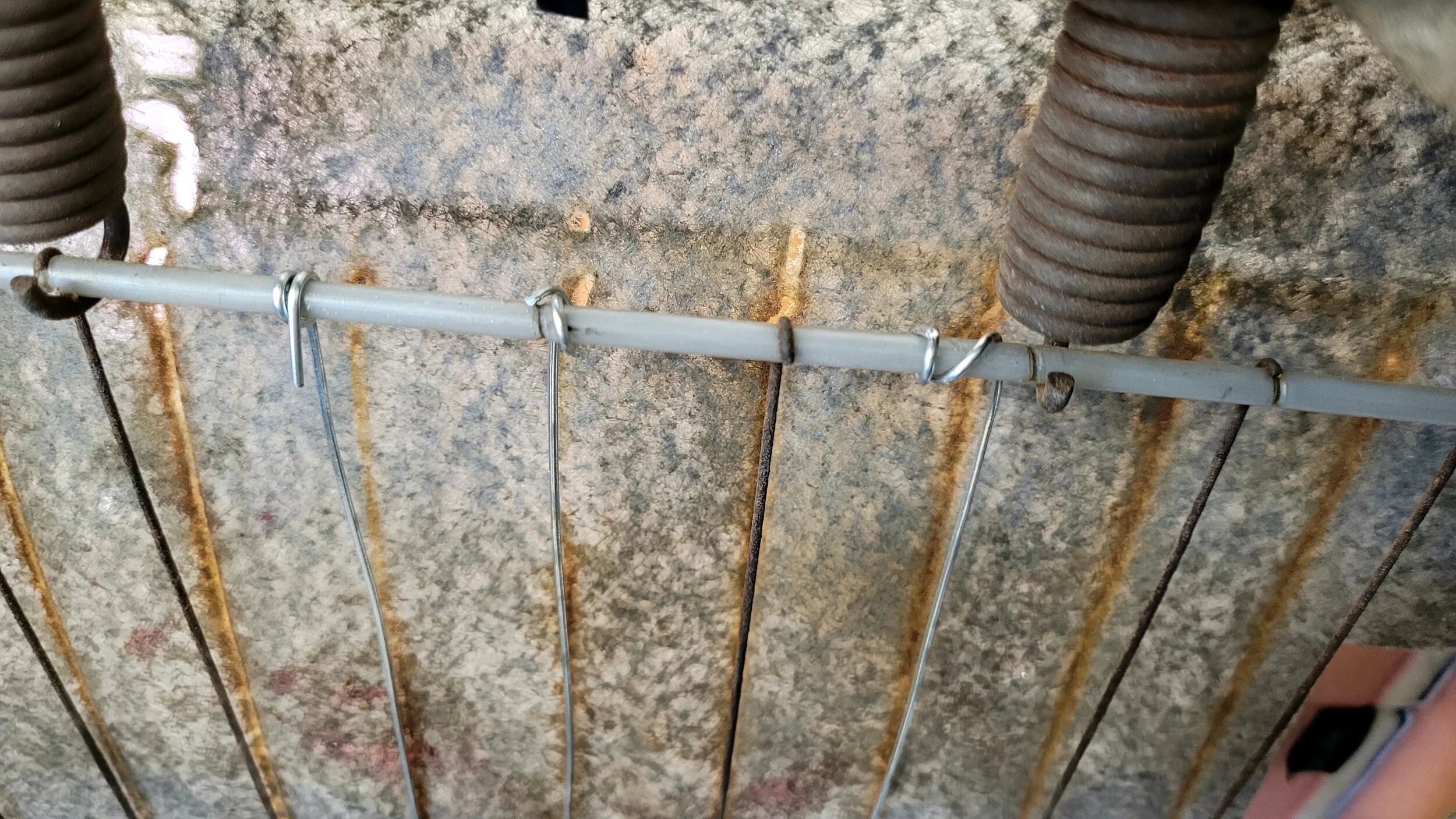

Replced broken piano wire springs under the foam while replacing the seat foams.

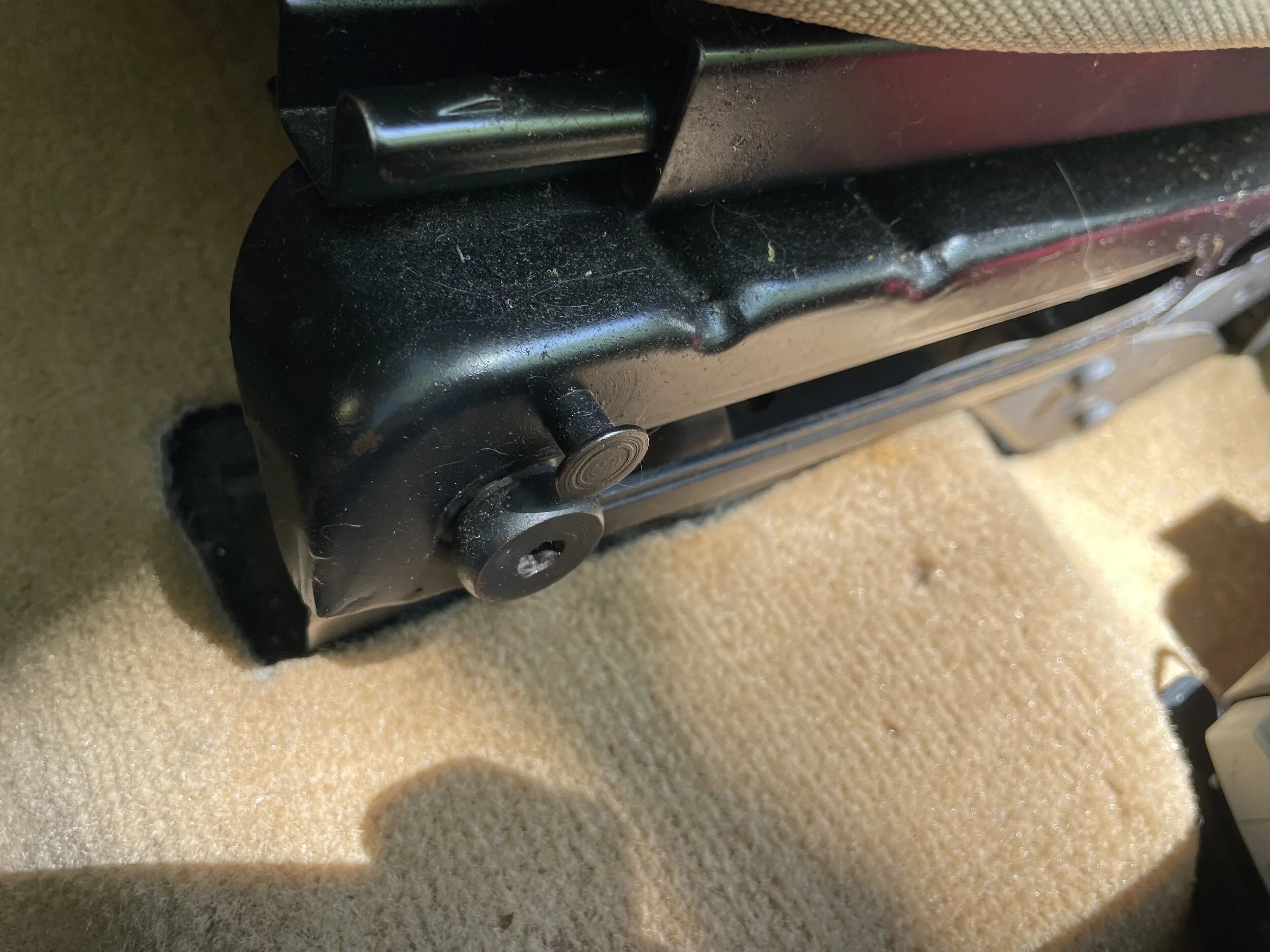

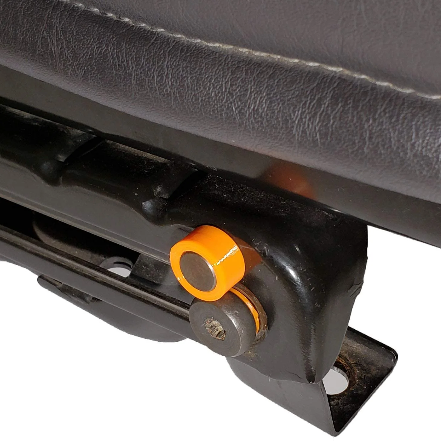

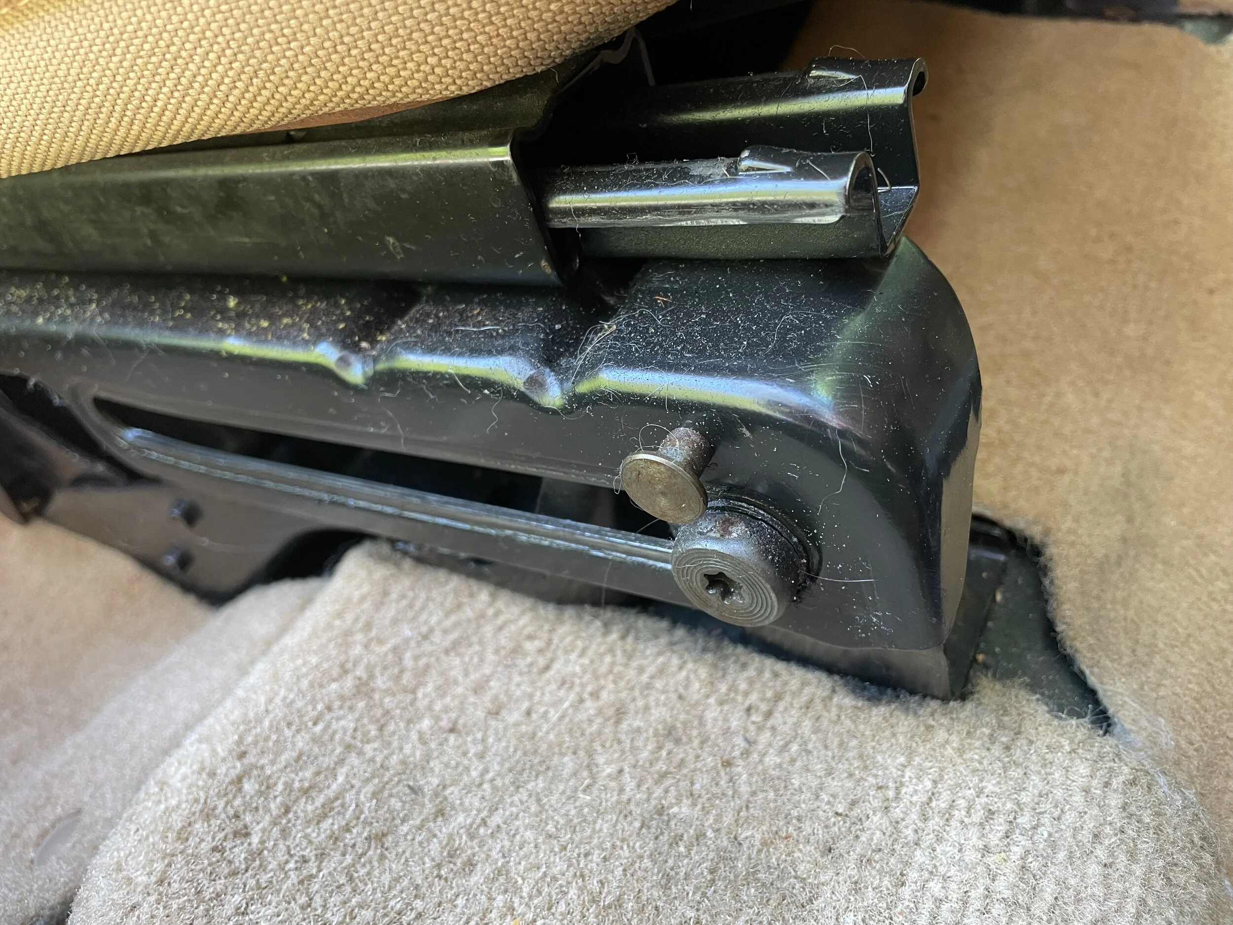

Yes, I was asking about the bushings like in the pictures above. The 3D printed ones don't seem to last long.
I have gotten to use to Amazon's free shipping. Summit charges $11.99 to ship those bushings to me. Might just try and make some.

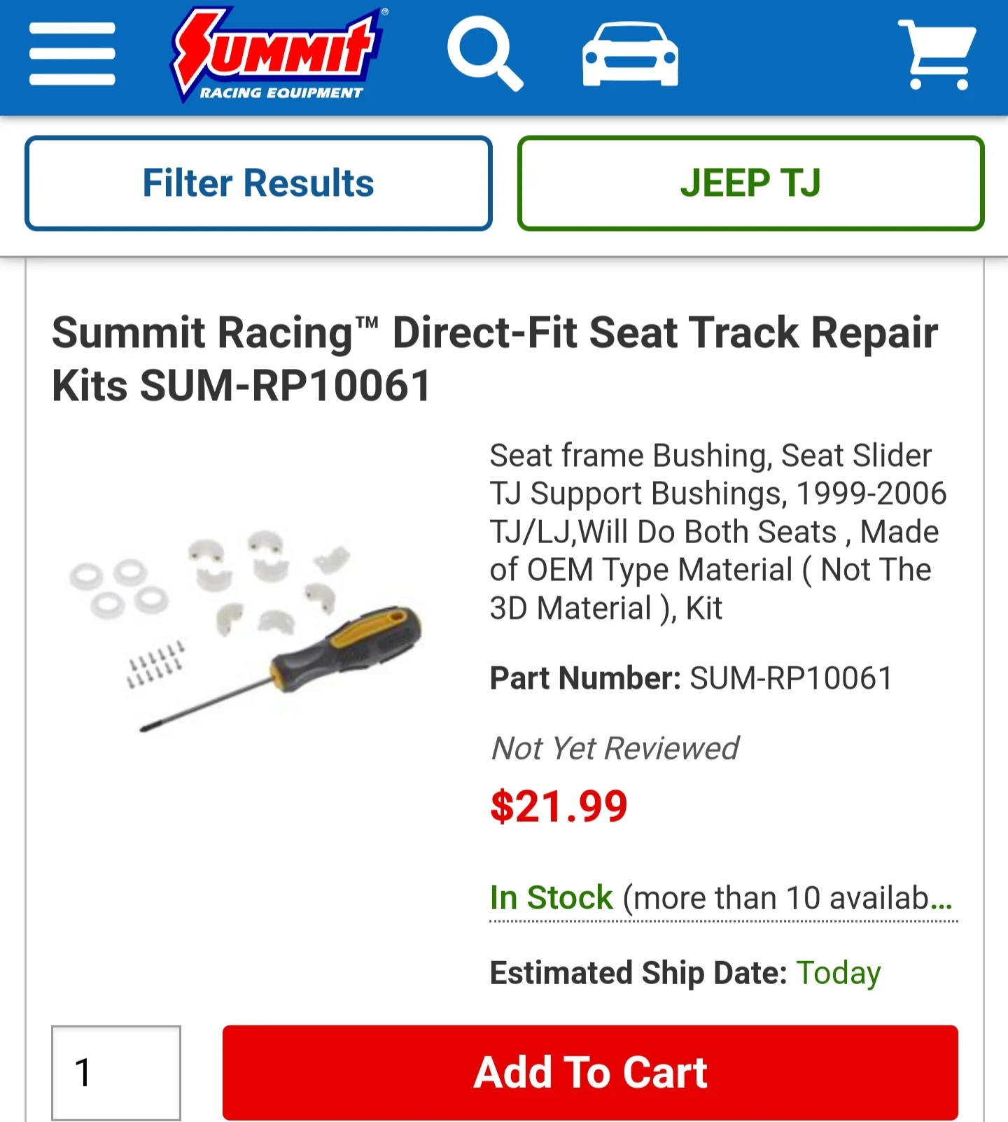

Have you seen this option?
Reactions: Tob
I bought them, haven't installed them.
$109 order gets free shipping.

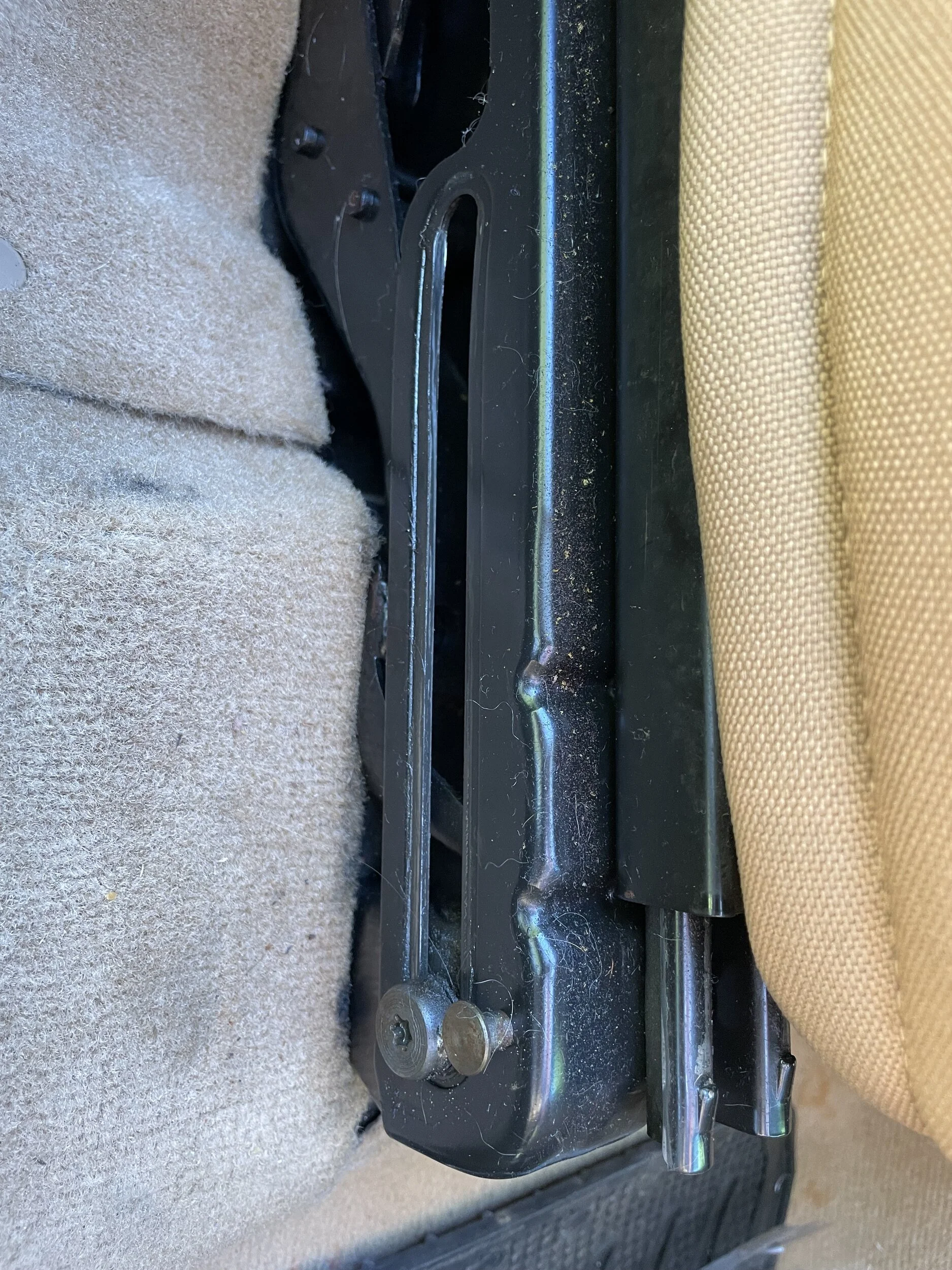

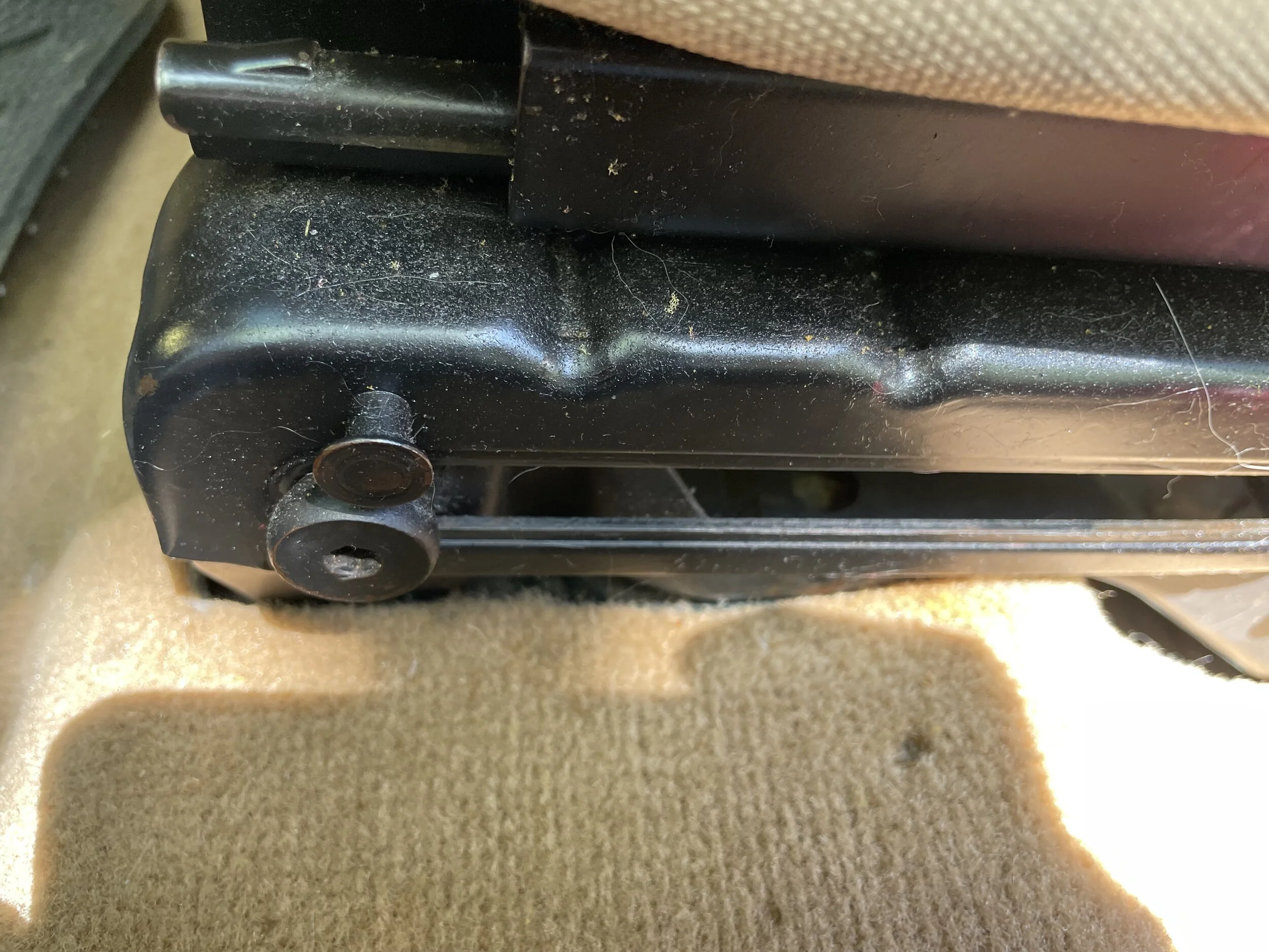

What is different about the seat tracks in the '97-'98 models? Says these repair kits are for '99-'06
Passenger seat base pics are a '00 model Sahara seat. Driver seat base pics are a '98 model Sahara seat.
The head of the Torx bolt looks different, otherwise looks mostly the same.
The slot width and/or the bolt shoulder is a different size. I tried on my '98. I think I made it work with a Dremel but it wasn't easy and I remember thinking just finding stuff from the hardware store was the way to go. The 3D printed set I got and made work wore out super quick and I didn't go that route the second time.

Thanks. Since I have a set of 97, 98, and 00 seat bases around if I get time this weekend i'll do some measuring.
