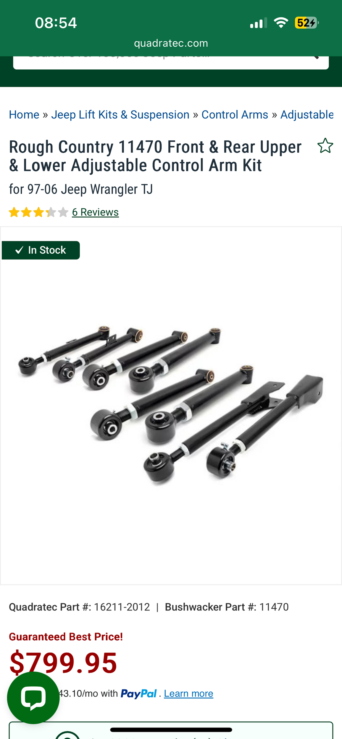

TJ control arm recommendations
I noticed that too and fixed it! Older picture!
Am using your tightening procedure!
-Mac
