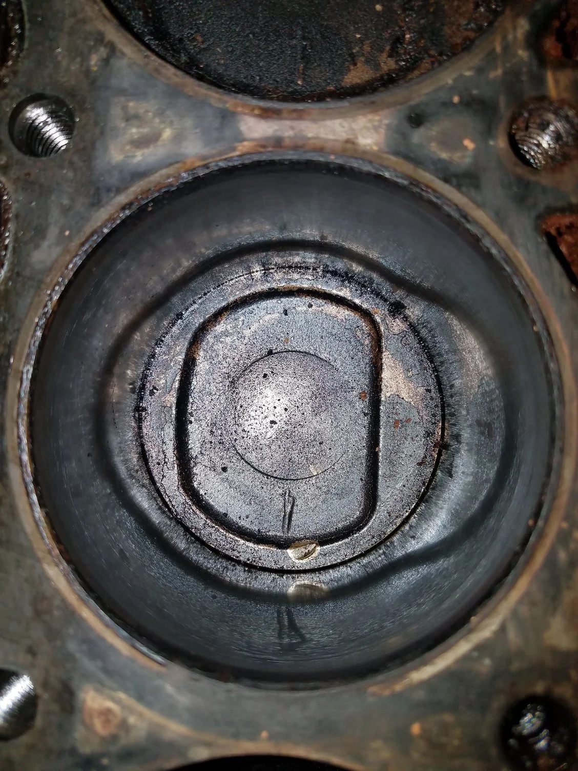

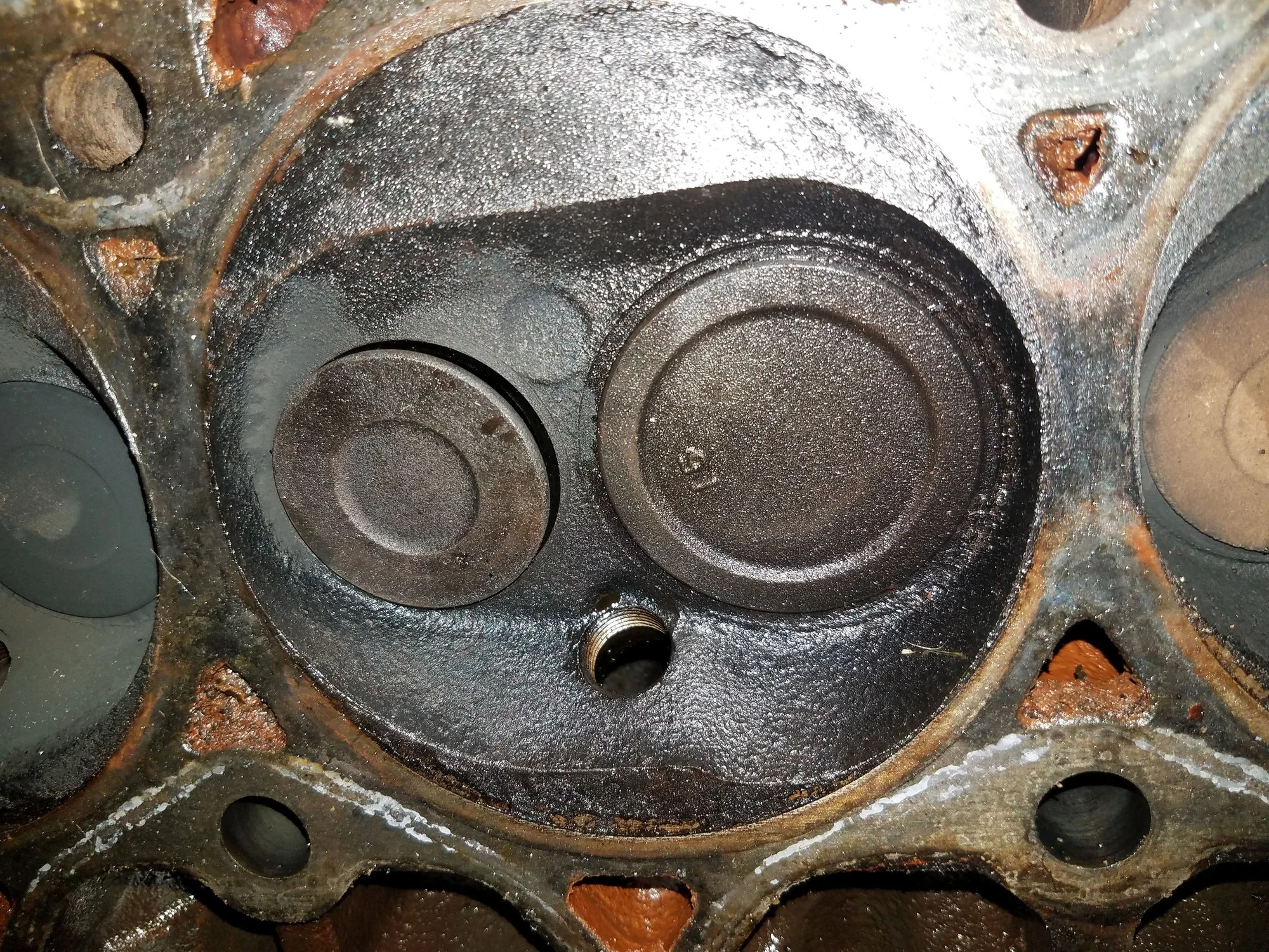

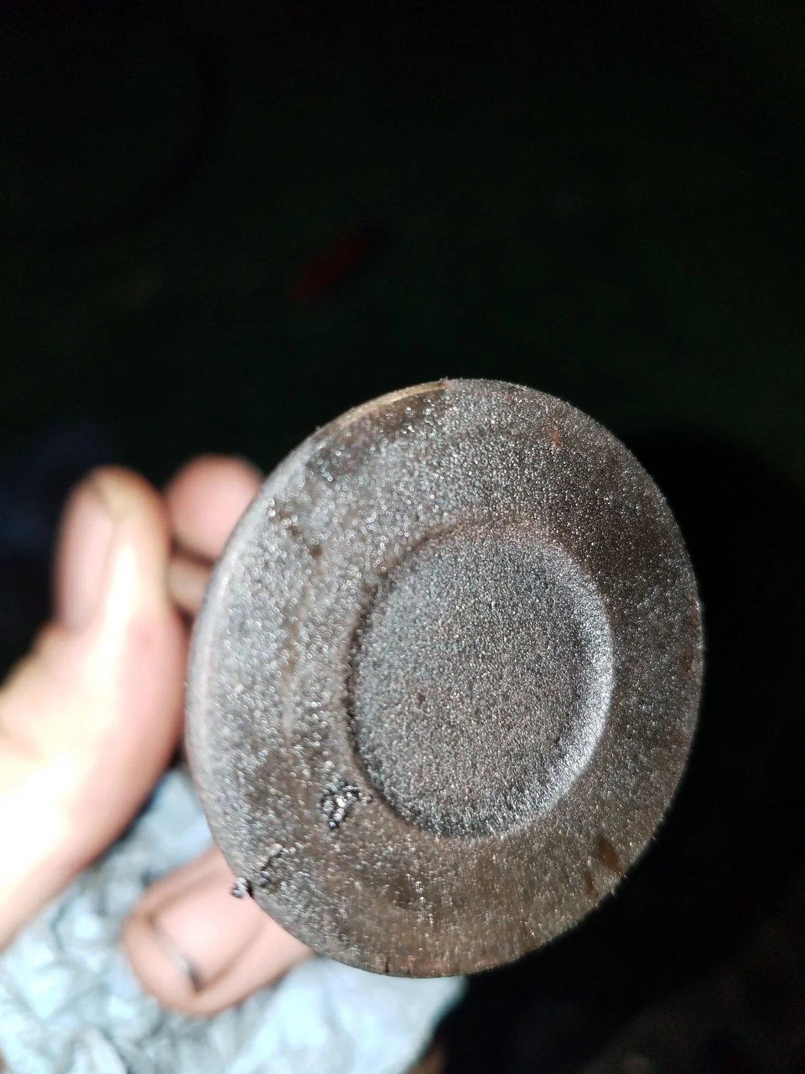

I'm looking for suggestions on how my #4 exhaust valve and piston came in contact with one another. The 4.0l 266k miles has had a slight ticking noise for some time that I believed to be lifter tick. Last week it started running real rough at highway speed she heated up real quick but I managed to get home without ever exceeding normal operating temp of about 210. I found cylinder #4 to have no compression and missing coolant so I assumed it was head gasket. After getting the intake and exhaust manifold off I found the rear half of the block to be wet. So I pulled the head last night and also found bent #4 exhaust valve and a clear mark on the piston top.
I baby this thing because of the amount of miles and just needing it to get me by as my DD so I don't rev it hard enough that valve float should be an issue IMO. Being a non interference motor I would think timing is not the issue either. I did have some overheating issues a year or so ago but I'm not sure if the noise corresponded with any of that. I've never received any misfire codes until this latest episode. It doesn't look good but not terribly bent either. I guess what I'm asking is do you think the valve has been like that for awhile or did the valve and gasket damage happen at the same time?
I don't want to just replace the valve and piston only to have this same problem. What else could cause this interference?

I'm more thinking a small burr or piece of dirt caused the valve to stick open. Its the exhaust valve on number 3, which would be one of the hottest places in the engine (so most thermal change). Kind of a perfect storm, if you have a valve on the large size of tolerance, guide on the small side and a little bit of contamination. It really wouldn't take much... Once it hangs, that piston comes up, smacks the valve and bends the stem, locking it in place. That would also explain why the rest of the valve train looks decent, because its now not doing anything. The pushrod might be slightly bent just because its now loose between its points and if it misses the rocker pocket or lifter pocket, it might put a slight bend in it.

The divot in the piston was much deeper and very well defined. Plus the whole mess is a lot cleaner in there. We moved the piston up and watched how close it got to the valve and it was not very close at all. My bore scope doesn't look up very well, but we could see the valve pretty easily.

Oddly, the push rod is not loose at all. I don't disagree with any of this, I just can't figure out how the valve gets down far enough for the piston to smack it on a non interference motor other than valve float.
It would have gotten hot and expanded more than normal...I don't know what the valve to piston clearance is nor do I know how hot it would have had to be to make the valve touch the piston. With a 150,000 mile motor, carbon build up and a chunk breaking off and getting somewhere its not supposed to be (including in the valve seat and having all that flame front flow through to the backside of the valve) is possible...It could have gotten very hot in a hurry.
