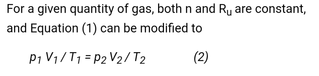

How do you guys determine how much to air down if the tires are hot? Say your highway pressure is 30 cold and you want to air down to 15, and your tires are hot and reading 35 so do you let out 15 or 20?
Based on your question, I would air down to 15 (not 20) since you may want to be lower than that anyways. Then check the pressures a bit later to see how the readings look cooled down. My guess is you'll want to air down more or leave it alone.
