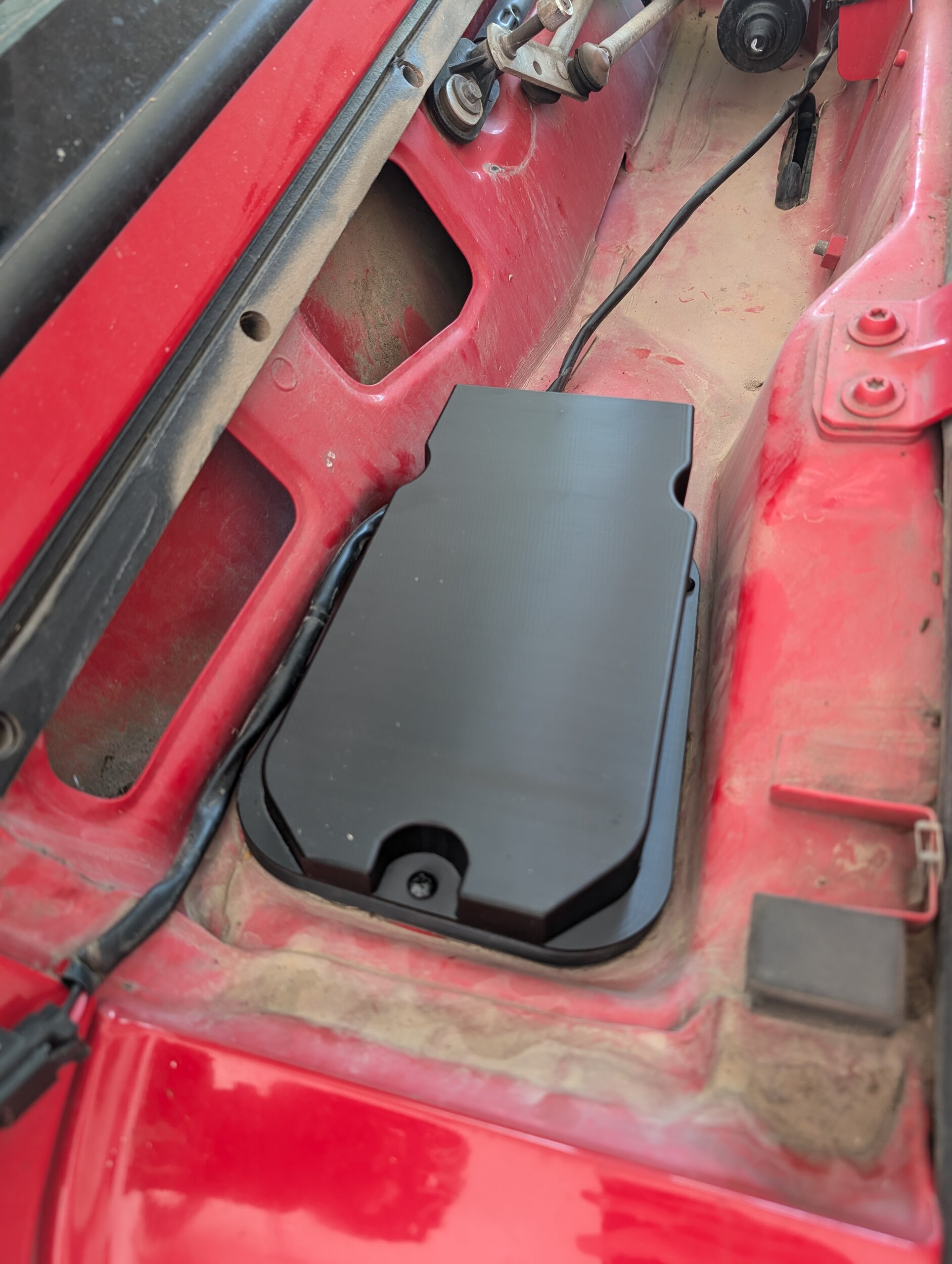

It uses the existing stock screw holes.
I'm not convinced the earlier models had the holes from the factory. Not sure what year is shown in this photo found on the interwebs but @patdugan indicated his is a '99 model. The hole certainly looks similar. I'm attempting to come up with an alternate air plenum to suit earlier models for my design. (y)
Reactions: SkylinesSuck
Reactions: chili_pepper
I drilled holes and then used washer head screws. They didn't add screw holes in the TJ until they switched over to using that covered trim piece. In the earlier models there are no holes and no covering, mine is a 99.
It looks as though, save for modifications to give clearance to the screw holes, the actual hole punched through the sub-cowl is the same size. That said, some years seem to have a bit of plastic extending through the hole from inside. Making an alternate air plenum part might be a bit easier than originally thought.
What printer did you use to make that?
Bambu Lab P1S, overall I'm very pleased with it. Handles ABS and ASA prints with relative ease. Most of the parts take between 0.5 to 3 hours (not including cooling time), except for the main air plenum...that one comes in at ~14 hours with higher print quality settings. The plenum is also a bit wasteful as it uses a lot of material for support. I tried flipping the part over on the print bed to reduce support but quality of the finished part suffered remarkably.

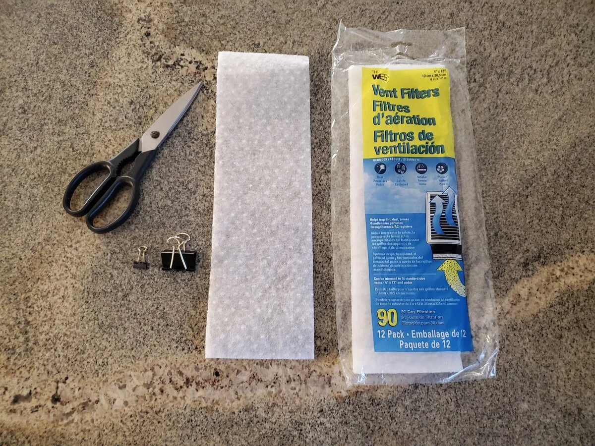

I made this simple "cabin air filter" with a leftover furnace register filter and some binder clips to test the concept. No more blasts of dust from the vents when turning on the A/C. Cost = pennies.

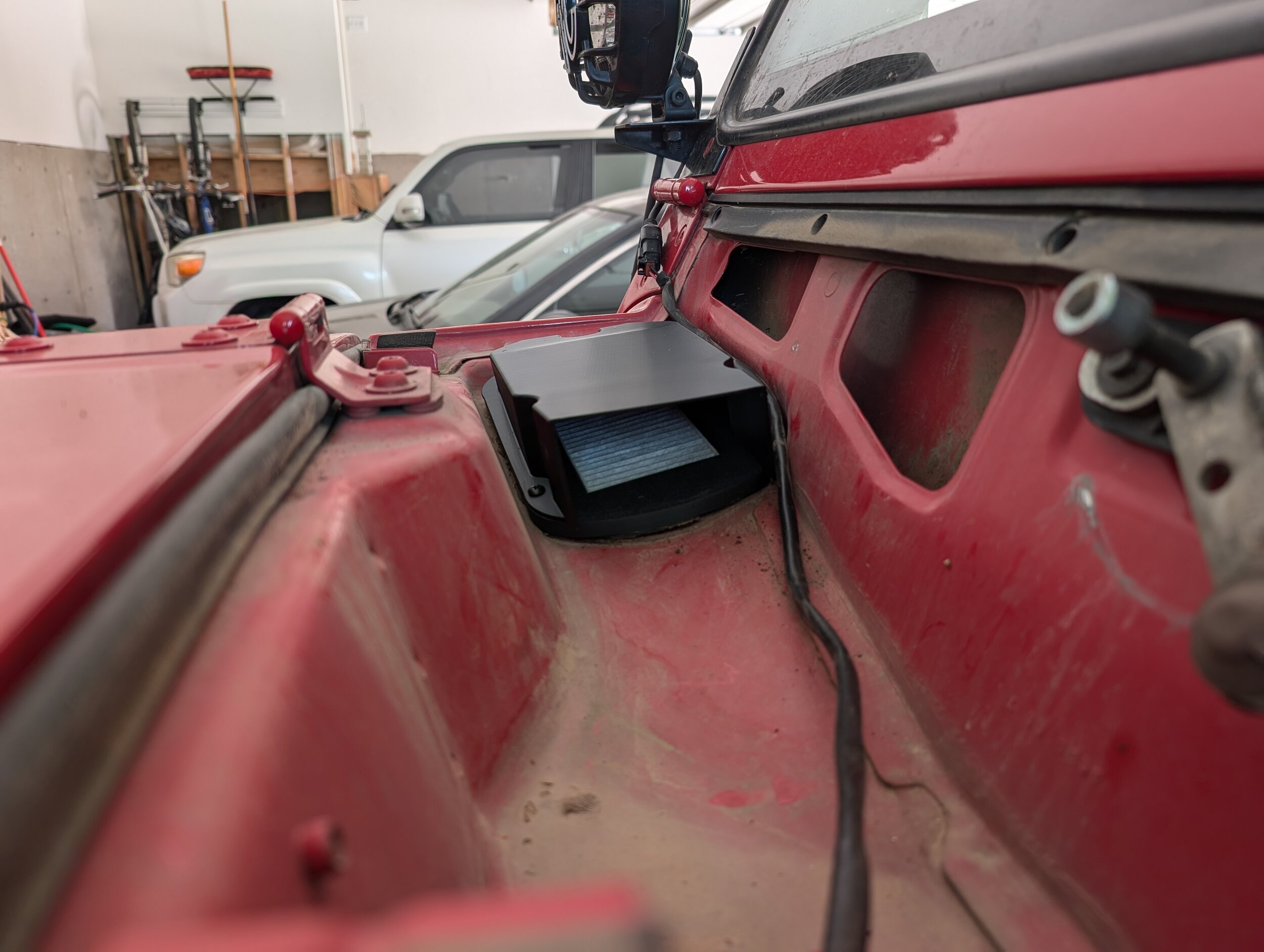

$56 shipped. Housing and cover are 3D printed ABS equivalent. Seems like a good design since it will accommodate standard Mopar cabin filter. As long as walls are thick enough. 3D printed stuff is not as strong as actual molded parts. These parts wont see any stress except where the screws are used so don't over tighten when installing.
