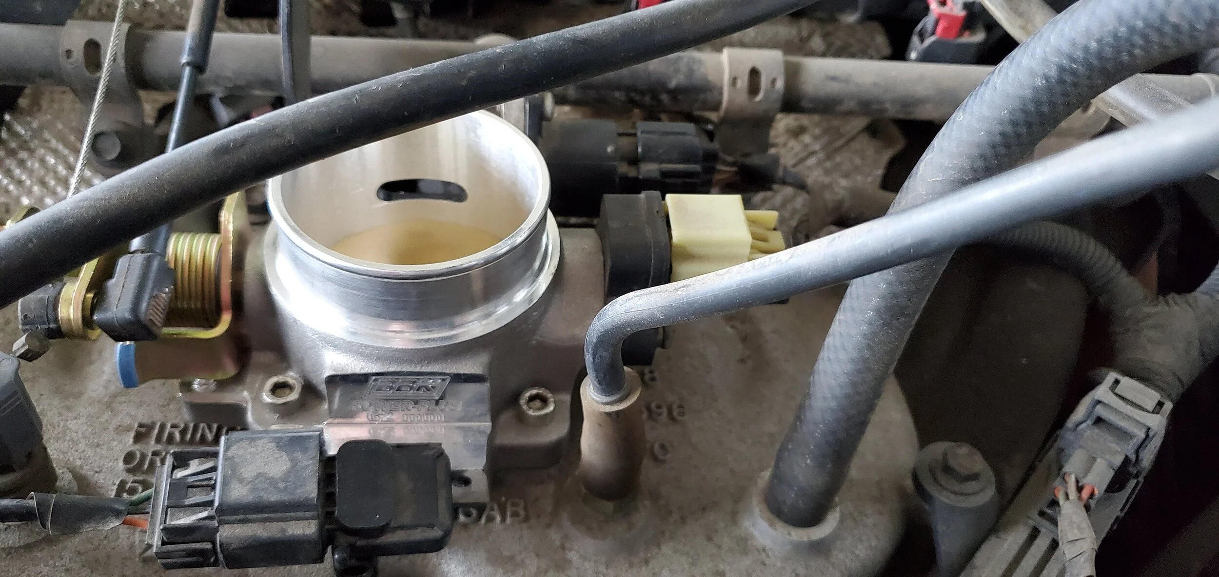

I went with a 62mm and they do make a hissing noise for sure. It’s very obnoxious. I believe it’s because the opening for the Intake Manifold is machined at 60mm and you’re slapping a 62mm TB on so the air that’s coming in just hits that lip where the Manifold isn’t cut to the same diameter to match the TB. I’d imagine the air is hit that lip and cause all kinds of turbulence going into the manifold but I can’t really see air so I’m no expert.
You could port the intake manifold if you’re that down bad but I don’t see the point because the engine is programmed to take a certain amount of air in so you won’t see any benefits unless you tune it for the increase in air.

I have the 62mm BBK throttle body on my 1998 Jeep Grand Cherokee 4.0 and it doesn't make a hissing noise.
I only replaced mine because it had a large leak in the throttle body, and I couldn't find a stock replacement either.

I installed the BBK 62mm throttle body at the same time I did my 1.7 roller rockers. I don't believe it on it's own would have a significant impact on power on a stock motor, but it wouldn't hurt it either. With more significant head/cam/stroker/forced induction work, the 58mm stock bore would eventually become a bottleneck. I plan to go down those roads eventually which is why I picked it up. Fit and finish is good.
I do get a small whistle sound at a specific partial throttle position near closed, say 10-20% open. I believe it is the crisp sharp edge on the throttle plate. It matches the machined opening on the horseshoe intake manifolds and that is not the source of whistling. Compared to other noises on the jeep, it's very small and infrequent.
