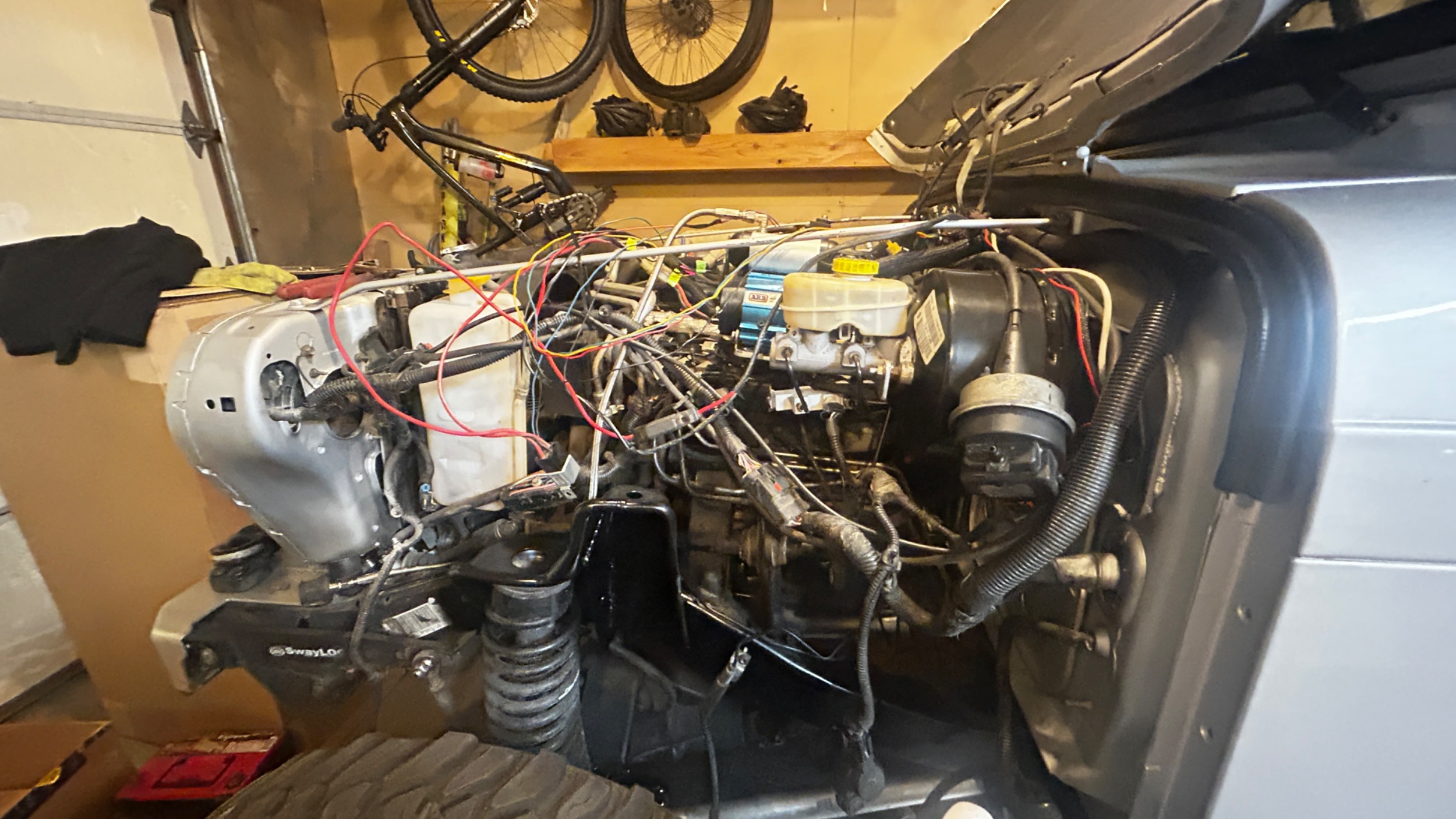

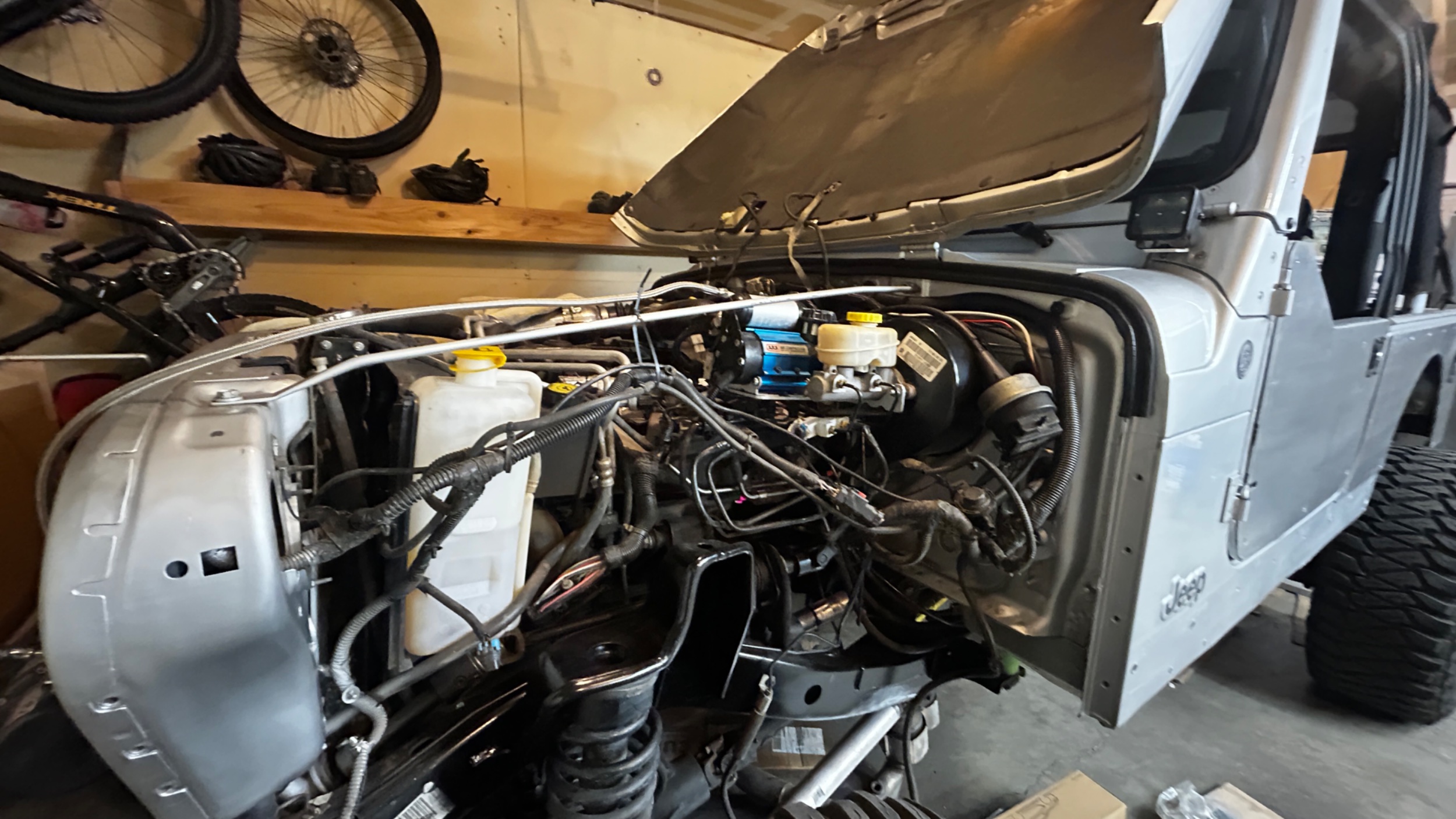

Got very little done today. Mostly just looking at things and thinking about them. PCM is mounted higher and closer to the firewall. Missing in this pic. Forgot to take one, but I used nutserts

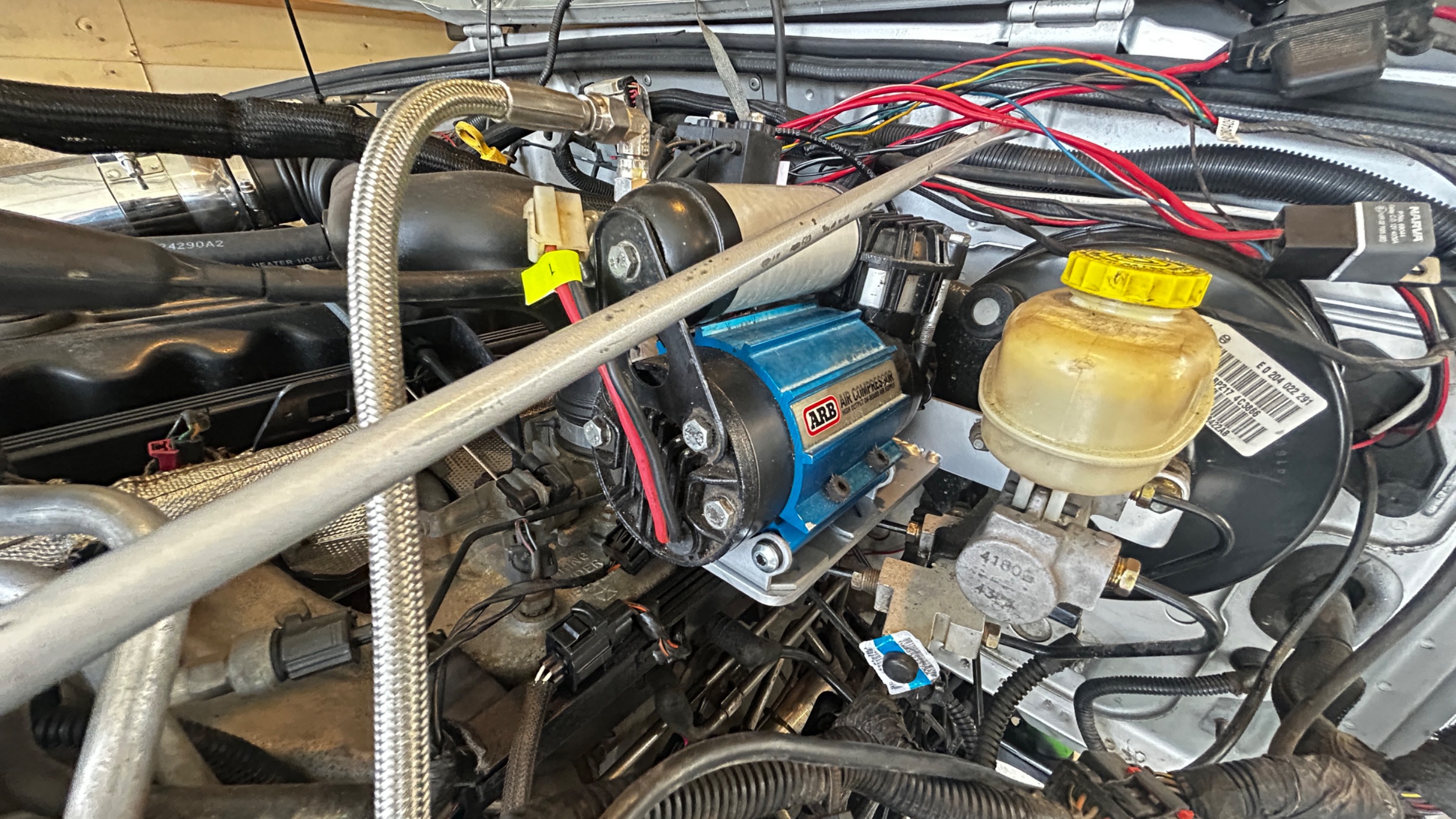

ARB Compressor mounted. Fits in the space perfect. Glad I put it here. Now to focus on the working. It’s a mess. I look at it and my brain scrambles. Going to watch BFH video and read the install manual and then get to plotting next moves. View attachment 651376

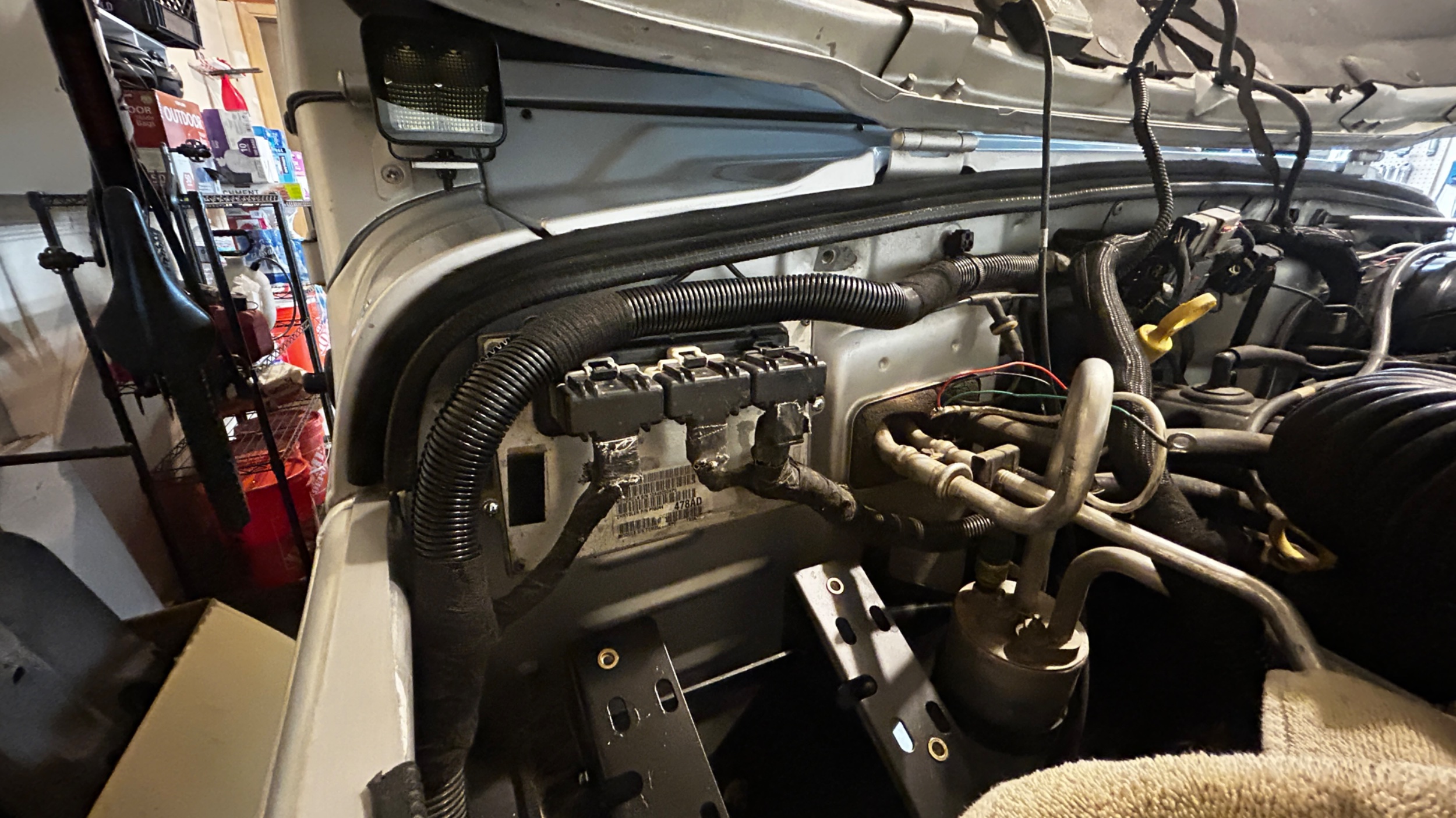

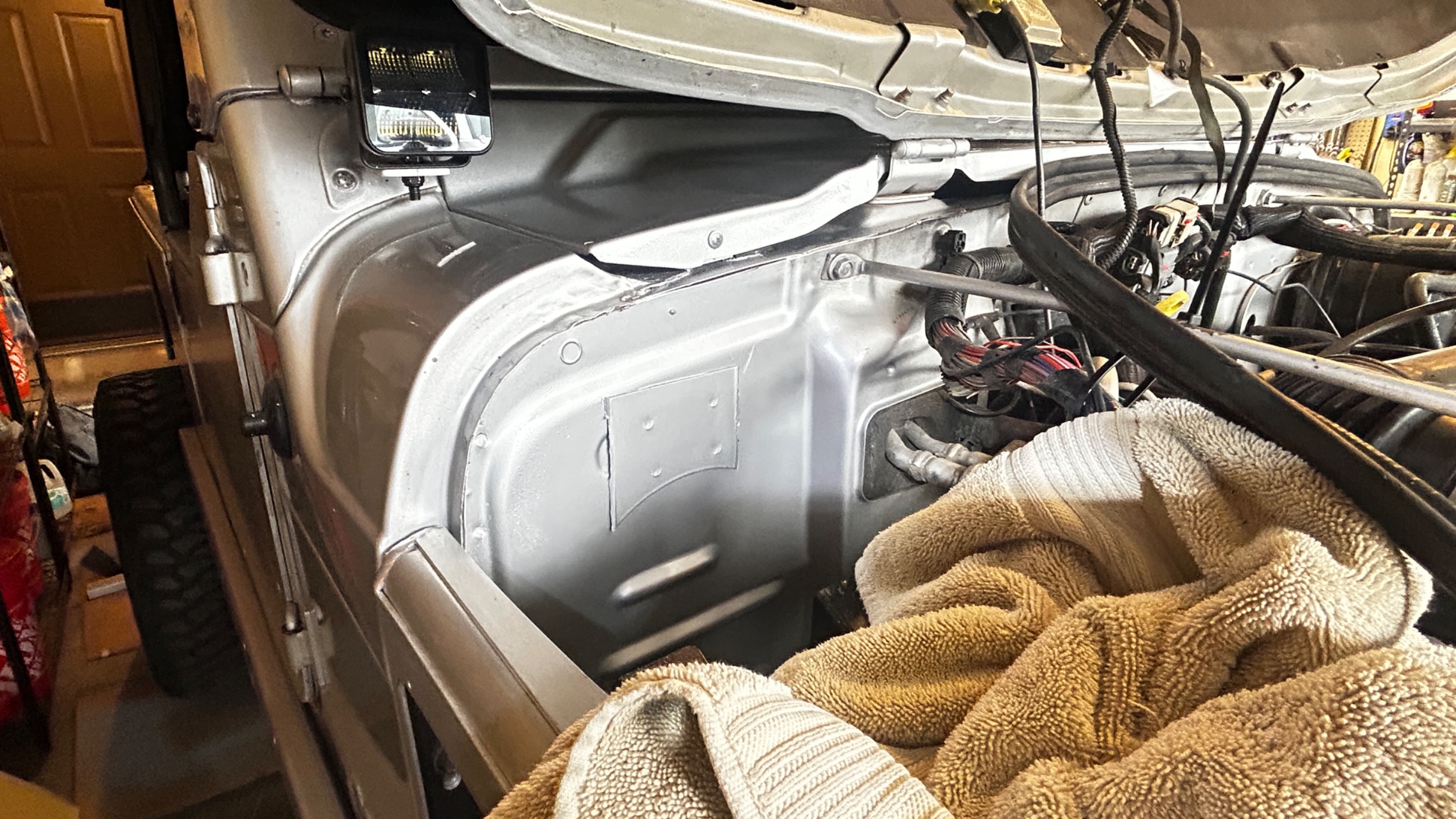

Surprised you haven't removed the flood lights yet after you hated them on my rig.
Reactions: lBasket and JMT
That’s extreme. They are a level of complexity I didn’t need because I don’t wheel at night. In this case the cowl was already notched for the wires. I filed the notches to make them more uniform and then repainted the cowl. I like them just fine. I just don’t have much use for them.

Happy with today’s progress. Cleaned up all the wiring to the ARB compressor. Super happy. Mike’s @hosejockey61 video on the ARB compressor on BFM is really good. He shows you all the adjustability of these units and makes a good product recommendation.

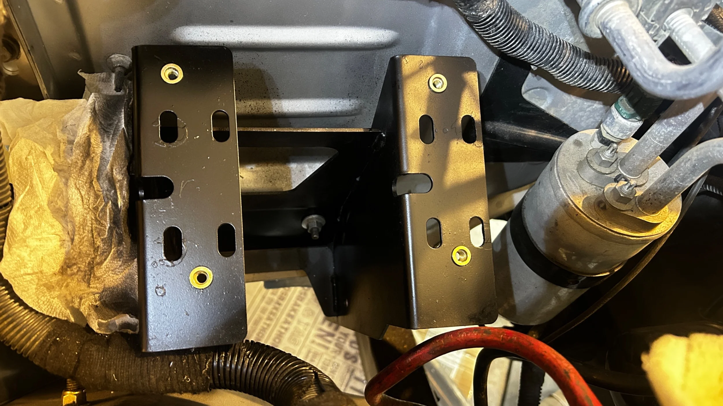

The battery bracket assembly has been the biggest issue. I really dislike the way GR sends you some carriage bolts and lock nuts to bolt the battery tray to the battery bracket. You have to crawl underneath the rig to remove the nuts, and even with the battery on top of the carriage bolts the lock nuts reach a point they don’t want to come off.
Thanks to @Lou and @jjvw for suggesting I move the PCM up higher and closer to the firewall. It created some space downstream that will make things easier. I still couldn’t find a route under or through the battery bracket for the PCM plug on the outboard side that gave me any advantage and still could plug in, but everything is kosher at this point. I replaced the dumb carriage bolt system with some nutserts and will get the battery installed soon. Next I will start on the new battery and winch cables.
I run that battery tray, and it is definitely a pain installing and removing it because if the position of those nuts. After getting it lined up, I welded nuts to the underside of the tray brackets, and use hex bolts from the top. Now it's a piece of cake.
I may have missed it, but did you put those nutserts in there for that reason?
One of the reasons they use the carriage bolts is to prevent the taller head of a normal hex head version from wearing through the bottom of the battery case.
I prefer to countersink and use flat head fasteners to hold the battery box down to the support. I've also made spacer plates that are the height of the bolt heads with holes where each head is to do the same. The plate is the same size as the bottom of the battery.
Yeah, I mentioned in a post above how much of a PITA the carriage bolt and locking nut system was, so the nutserts were a way to make it easier to remove. I got a Phillips carriage bolt for the bolt. Maybe I should do more like Blaine described to keep the bolt heads off the battery. I could still countersink a little bit in the battery tray.

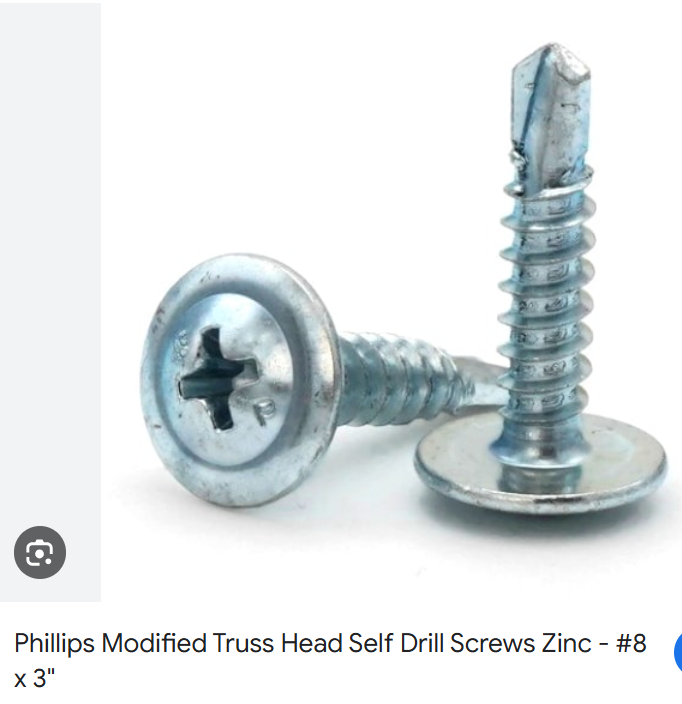

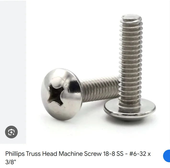

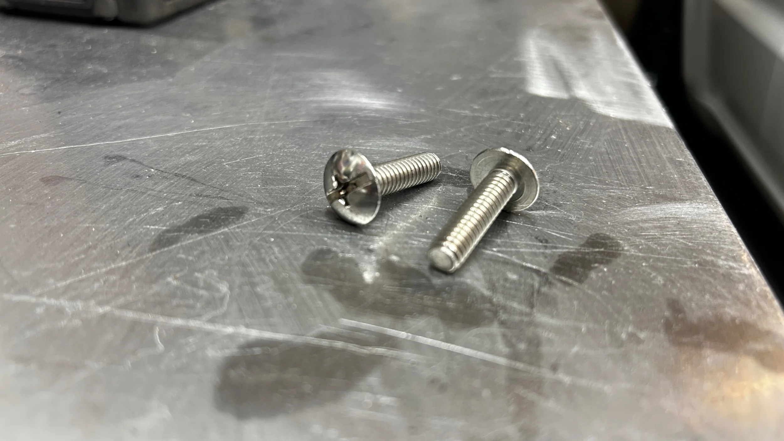

Gotcha. I don’t know what the fastener is called. Has a head similar to a carriage bolt in shape and depth. I’ll add a pic in a minute to this post.
Edit: I guess it’s just a shallow wide head Phillips! 🤣
That fastener does not exist. A carriage bolt by definition is prevented from turning via the square shoulder under the domed head that registers in a square hole and is a single side accessible fastener where only the nut is able to be turned. Phillips is a recess in a fastener head which would never happen to a carriage bolt.
This is something I had never thought about. You are correct, the Phillips and the carriage portion would be at odds.
Reactions: mrblaine
Button head, but those are more commonly found as a Torx or Allen drive. If it is a Phillips drive in something resembling a carriage style head, then it is probably a Phillips truss head.

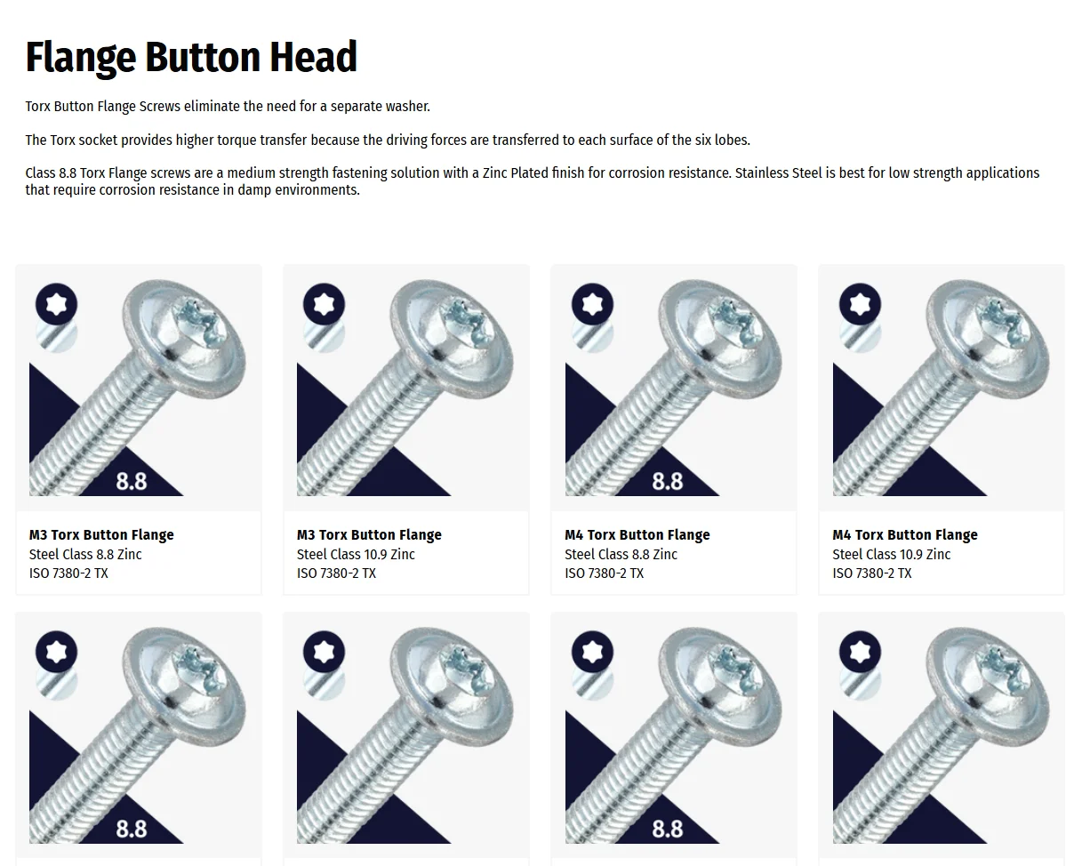

If it has a blended washer shape, then it is a modified truss head. We mostly see those on self tapping and self drill sheet metal screws but a version of them does exist with machine threads. The screws that go into the nutserts in the tub floor that hold down the back of the center console are modified truss head Torx under another name.
They call those button flange or flange button head.
