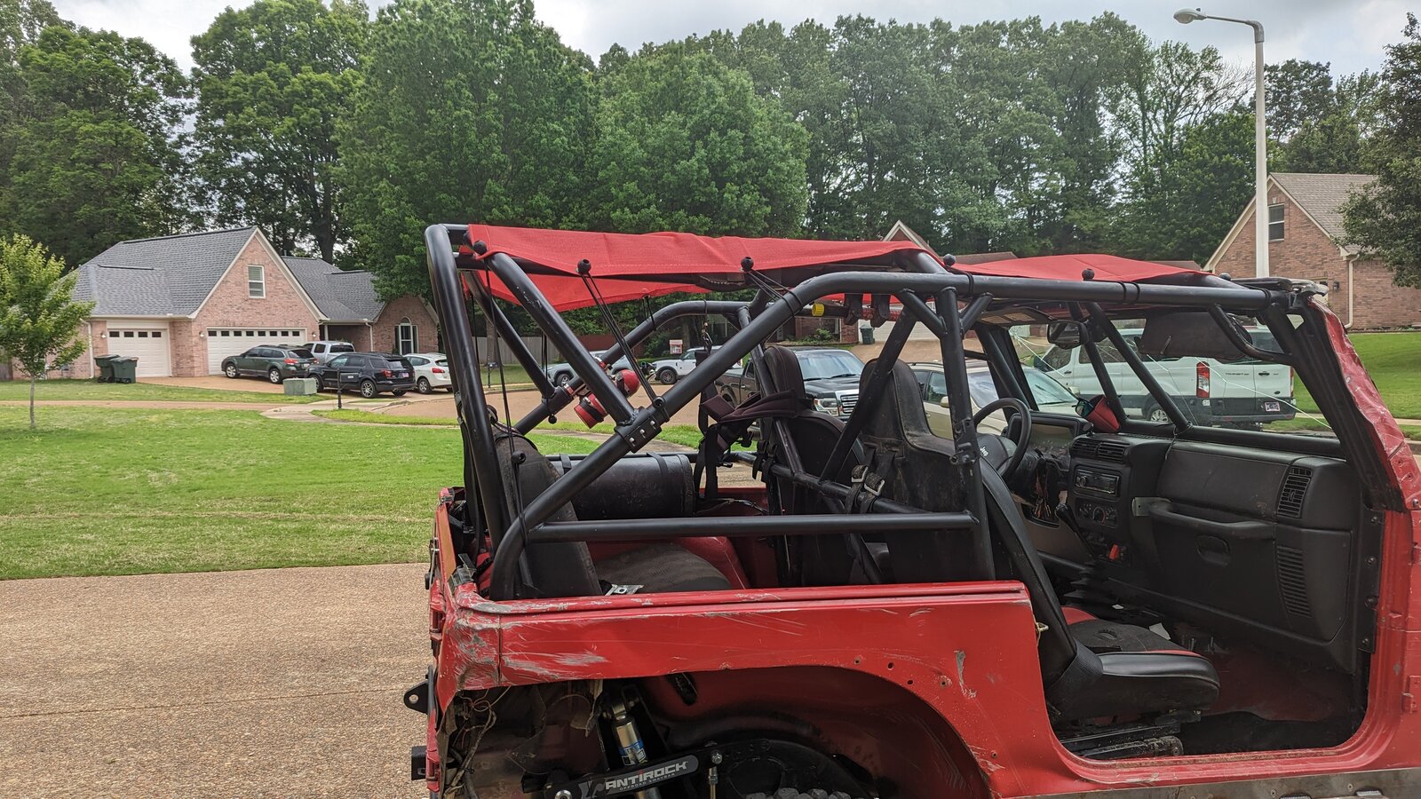

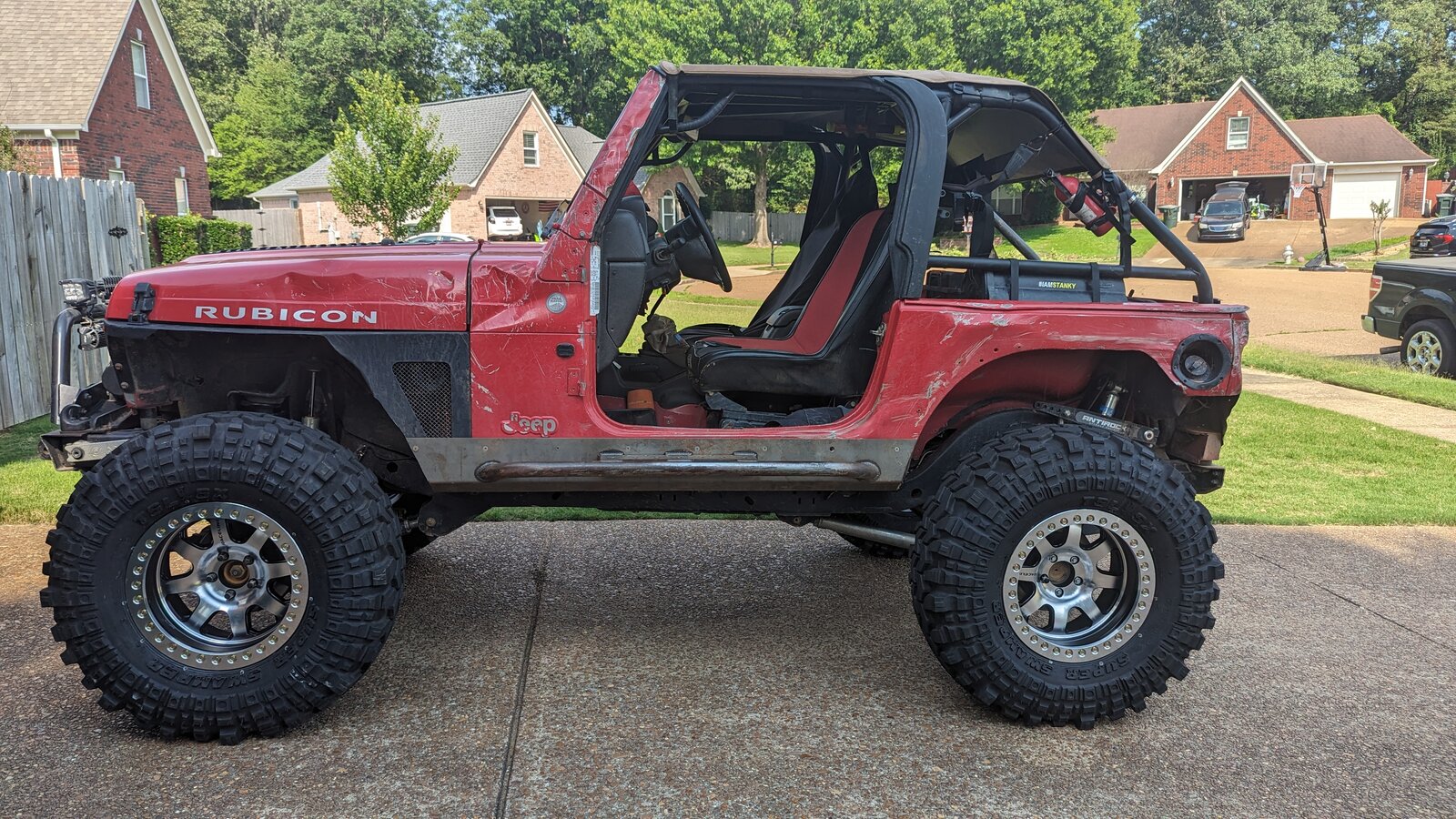

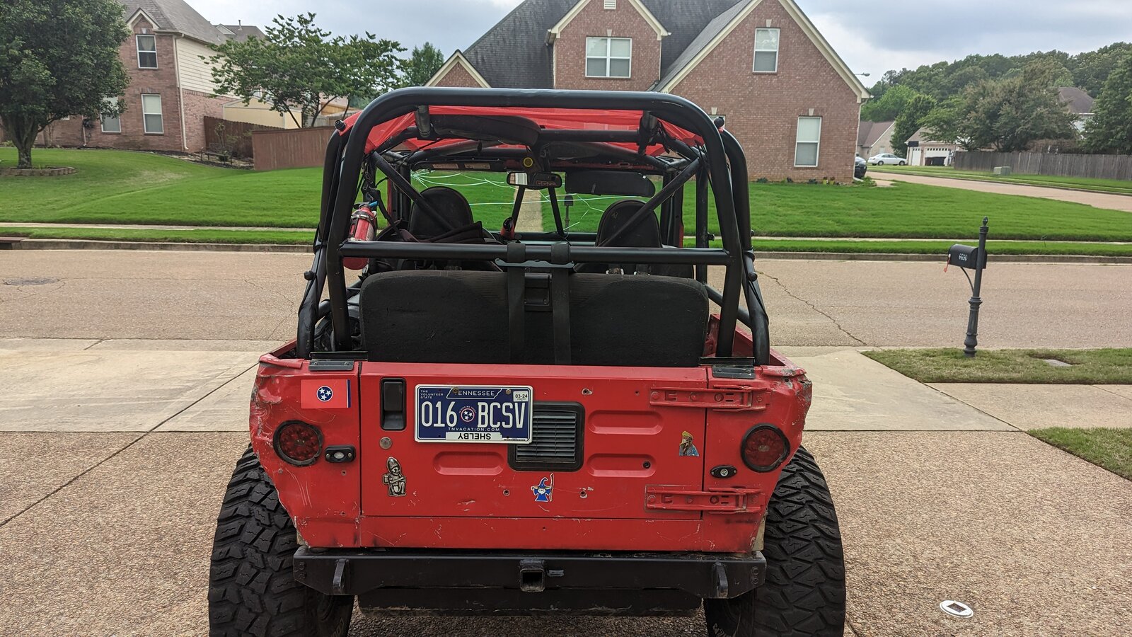

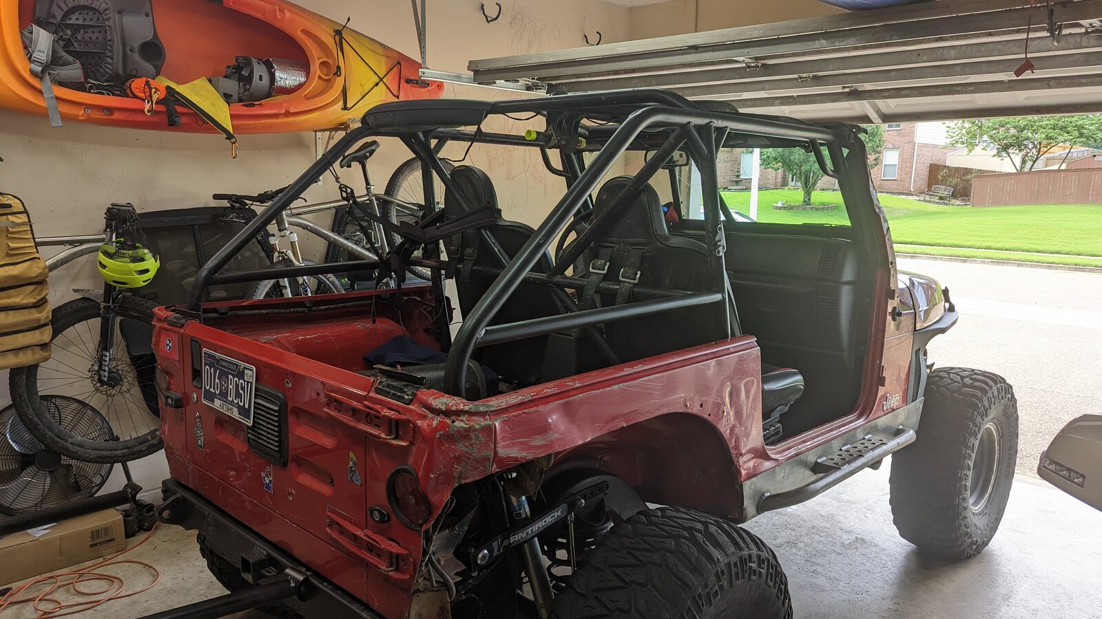

No rear hoop for when there is no rear seat.

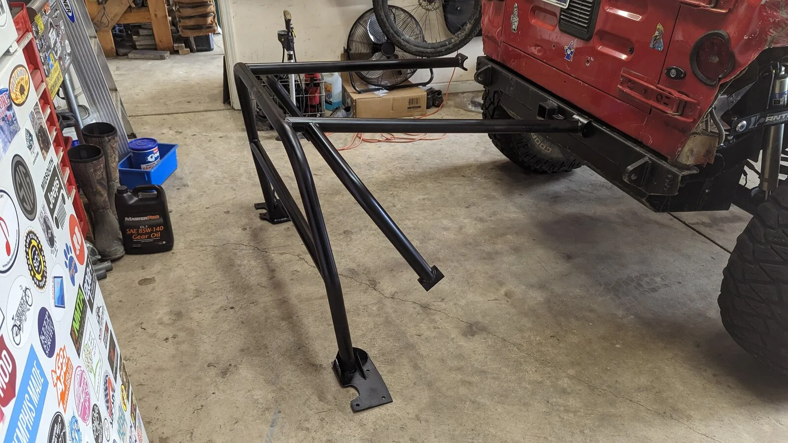

Fabbed rear hoop for when seat gets installed:
Seat installed (moved 3" aft) with rear hoop and LJ spiderweb shade for full coverage:
With the shade on you got to enter through the side and it is tight! I did it a few times just to see if it was possible and it was tough for me. My son is smaller and more nimble so he should have no issues but my wife is definitely not riding in the back.

Yes. I cut off the rear hoop of my cage in prep for this modification and I liked the accessibility to my tools and cooler with the comp cut so I am planning on running it comp cut when there is no rear seat installed (90% of time).
When I bought the original roll cage kit I talked to 2 people ( one being owner of company and one being a customer with cafe already installed) and they both said that his design allowed for factory soft top and adequate headroom for rear passenger. That is why I bought it. After installing it, I quickly realized that was false and it did not allow for adequate headroom for adult rear passenger but since my son was still short it was going to be OK. Now that he has s grown, it was not OK. I don't believe there is anyway to have a rear hoop that provides headroom and also run a factory style top, that is why Jeep designed the factory roll cage the way they did (with high sides and no rear cross bar).
Since I typically do NOT have a rear passenger, I decided to come up with a solution that allowed me to have the comp cut for ease of access during normal operation and also allow for rear passenger that 1 or 2 times per year. My biggest problem is going to be finding a place to store the rear roll bar hoop when it is not in use, not only is my shed full but so is the area behind the shed where I store items out of wife's sight.

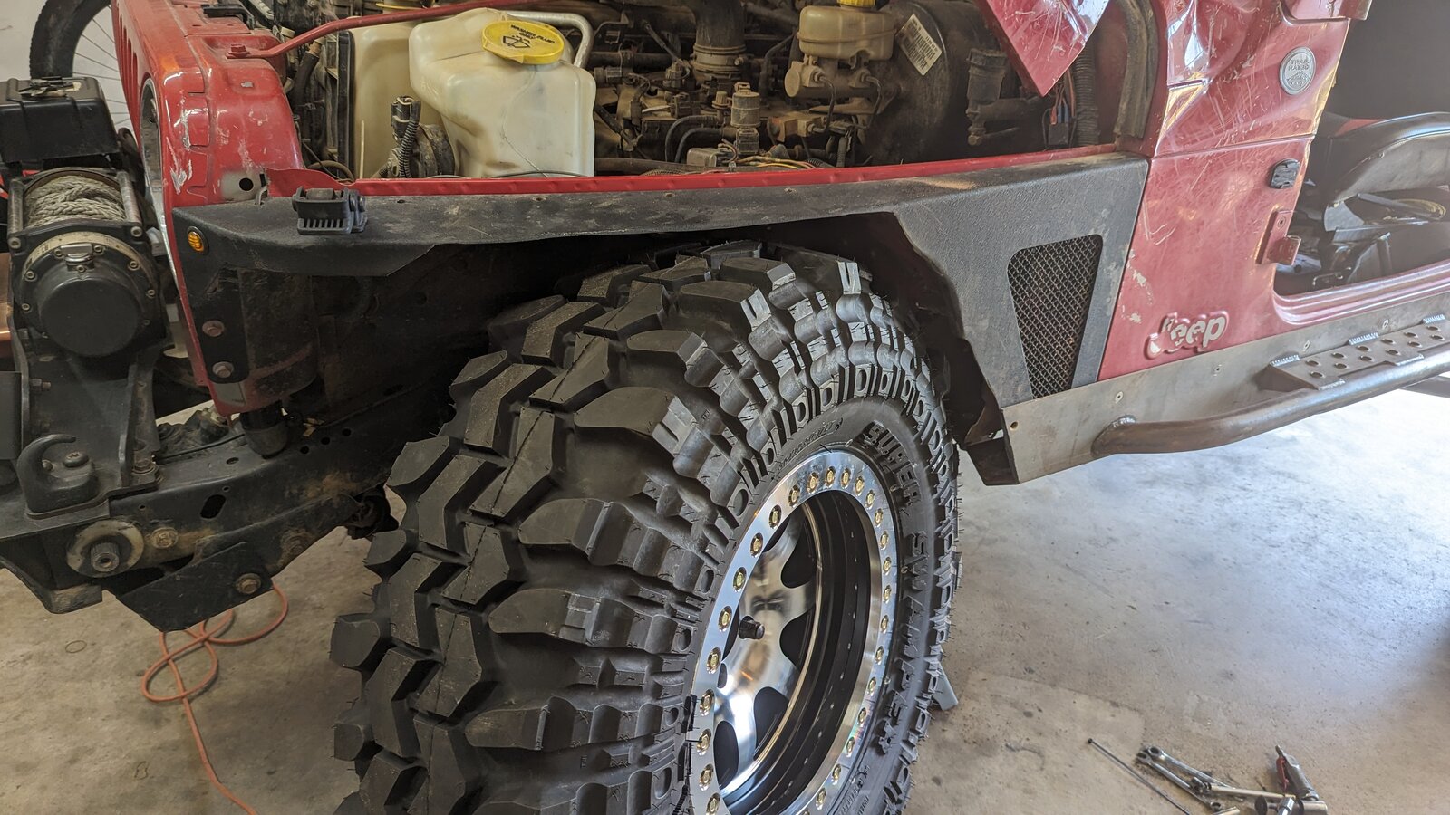

17x8.5 Raceline Avenger beadlocks with 36x12.5x17 E rated TSL SX. Hopefully that will take care of my tore issues. I really didn't want E rated tires but the sidewalls of the C rated tires were not agreeing with my driving style.

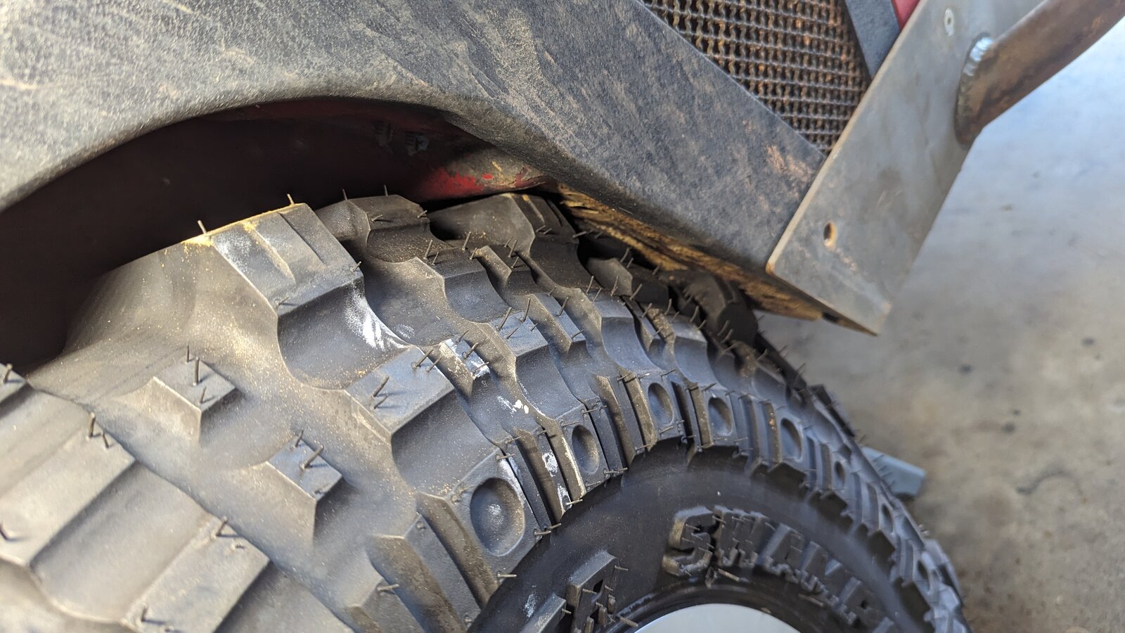

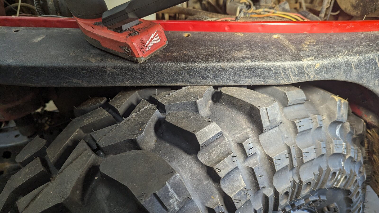

I am still waiting on my high lines and got to wheel next week so I had to do some Pennsylvania redneck engineering to get the front wheels to clear.
I got a tire groover and I was going to groove and sipe the tires but my neighbor (who is an old Jeep guy) came over and told me that I should hold off to see how they perform before I sipe them. So, I am waiting to see how they do next weekend.
