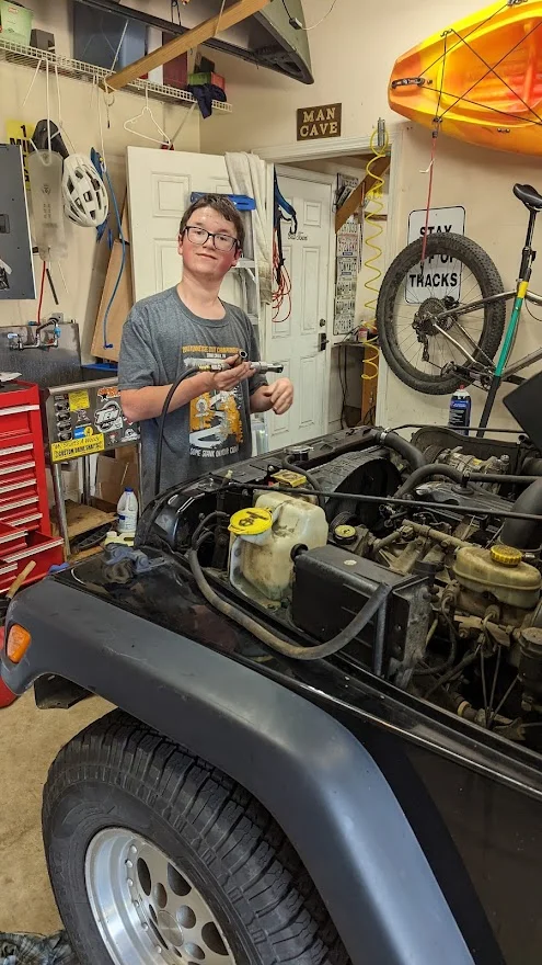

Christian came home the other day and his 98 TJ was making a Knocking noise, I originally thought the worst but once we popped the hood and started to track it down it was the PS Pump. I still had the pump from my 2004 TJ and he swapped it out today.
I love to see a young man getting hands on like that- That is a guy that will know how to change his wife’s flat tire, Good job

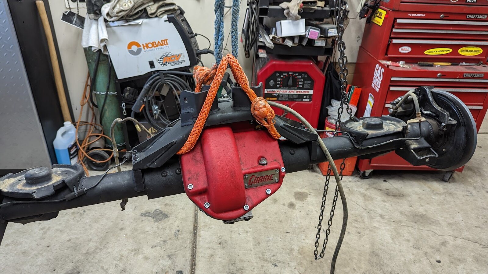

After the Clayton trip I decided to go ahead and start the install of the RJ60 in the rear since the locker in the rear of the Dana 44 was popping. I was originally going to wait until I had found a front axle and do them at the same time, then I waffled back and forth on waiting to install the rear axle, but after Clayton I figured why put anymore money into the Dana 44 when I have the 60 sitting there in the garage. So I started the process of installing the 60.
The RJ60 I got had no brackets and it had a stock Dana diff cover. I went ahead and purchased a Currie Iron Diff Cover and the Bridge Kit and installed those, then I decided if I was going to install this new axle, I might as well try and fix my "hopping" issue during steep climbs so i decided to get rid of the short arms in the rear and install a custom setup.
I only have this one picture, which shows another great use for Soft Shackles in the garage, but I figured I would document what I have done up till this point for posterity and so I can remember it a year from now when I need to fix something. Possibly I will come back and add pictures later.

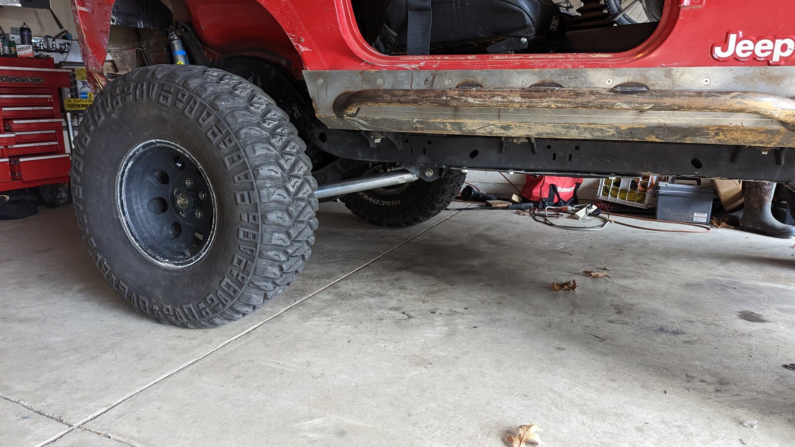

I was out in my garage piddling with the jeep when my neighbor came over, he also has a TJ on 35's. He laughed and said "long arm in back and short arm in front, you can't do that". And I said that it is going to be the next big thing, "The Mullet Design, all the party with half the cost".

Finally had a chance to drive the jeep after the recent rear axle swap. Took it Sunday real quick around the neighborhood and it drove really well. I don't really like the sound with just the resonator dumping behind the skid, but I will figure that out in the future. Sunday night I installed the soft top and doors and then drove it to work on Monday. Well, with the top on, the holes cut in the footwells, and the exhaust dumping behind the skid, it resulted in exhaust smell in cab. So, I am going to have to move fabricating tunnels to close up these holes to the top of the list. Also, the rear pinion seal is leaking. Unfortunately it is a proprietary Currie seal that is $60 (with shipping), ordered it today.
Other than the pinion seal and fabricating the tunnels, the Jeep drove great. I drove 20 miles to work through the city streets and then on the way home I took it out on the interstate and took it up to 65mph for about 15 miles and then took back roads home and it drove great in all conditions!! I got to get used to having the Detroit locker in the rear over the selectable when driving on the roads, but other than that it drove better than before.
Edit - replaced the pinion seal with Currie PN: 60-8011rj pinion seal.
Took a while to get used to the big pops that can happen with the Detroit. They always sound like you broke your entire axle in half lol. With the Detroit I always just had to ease into and off of the throttle when you’re at speed or in a corner or that rear shimmies pretty good.

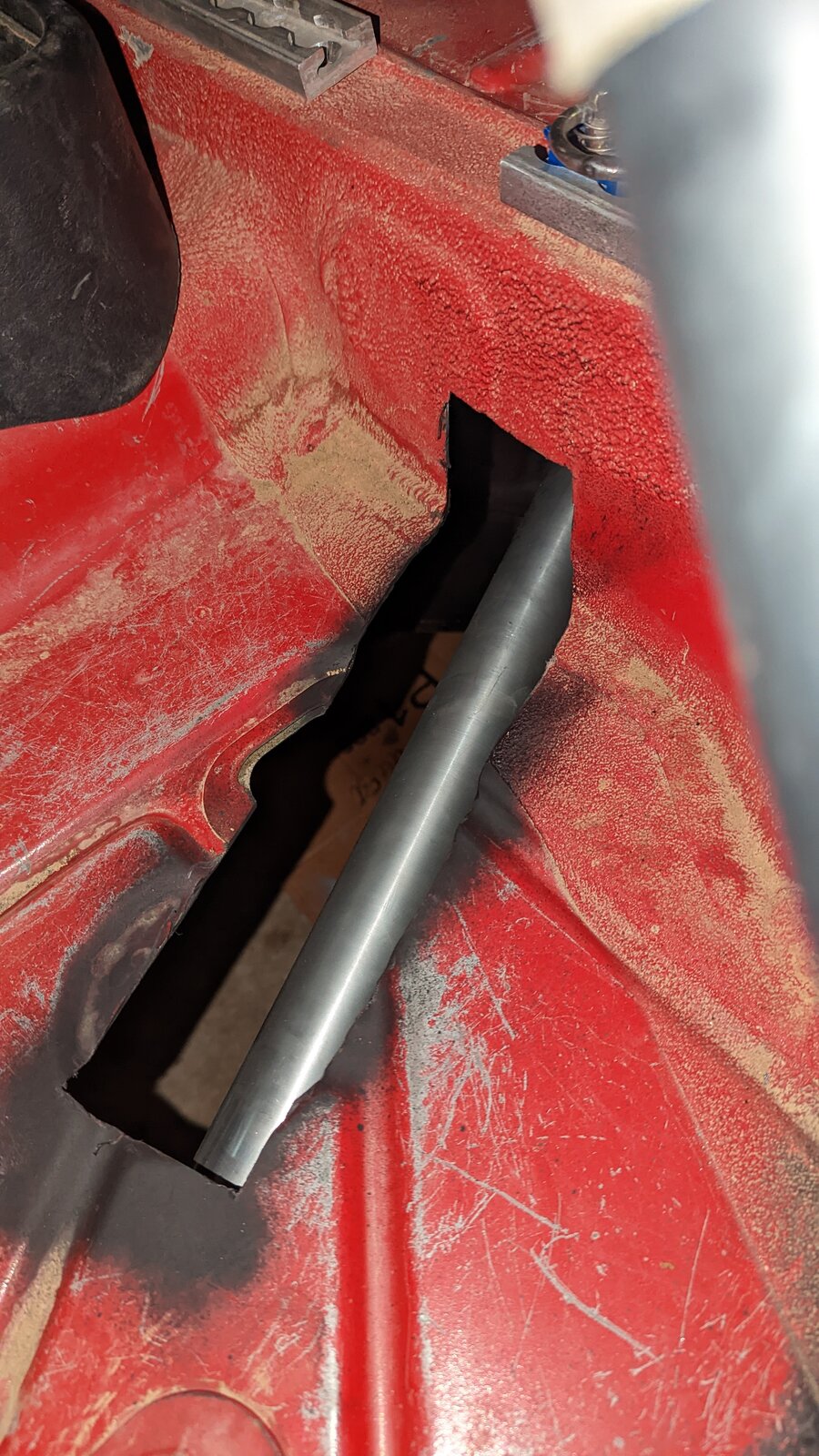

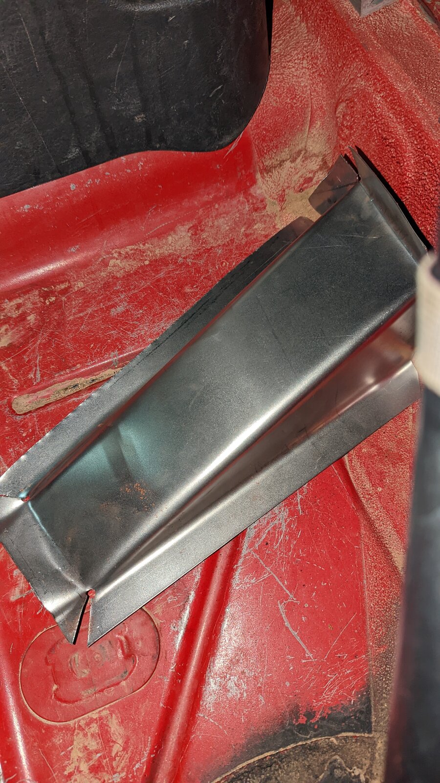

Well here is going to be the general idea for the tunnels.
Slot in floor for control arm clearance:
Tunnel bent up:
Now I just got to get in there and clean everything up, install it, and seal it. Then hopefully after both sides are done I won't die from Carbon Monoxide poisoning :)

Nice work on the tunnel, Vic.
