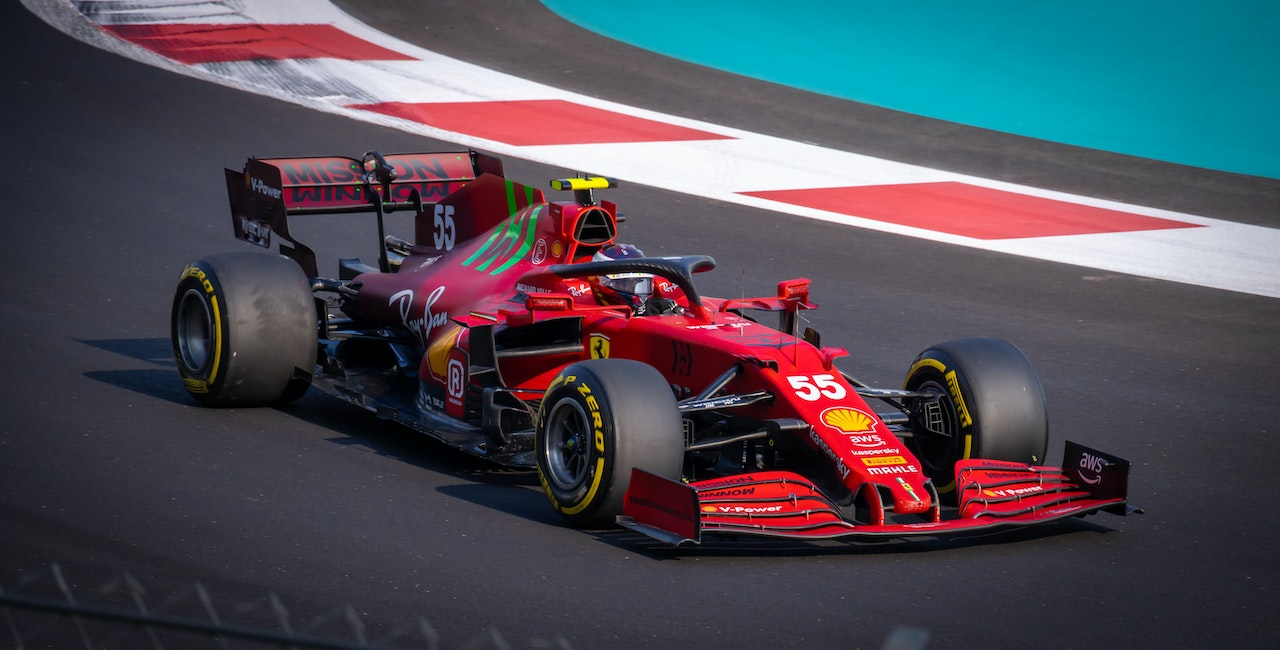

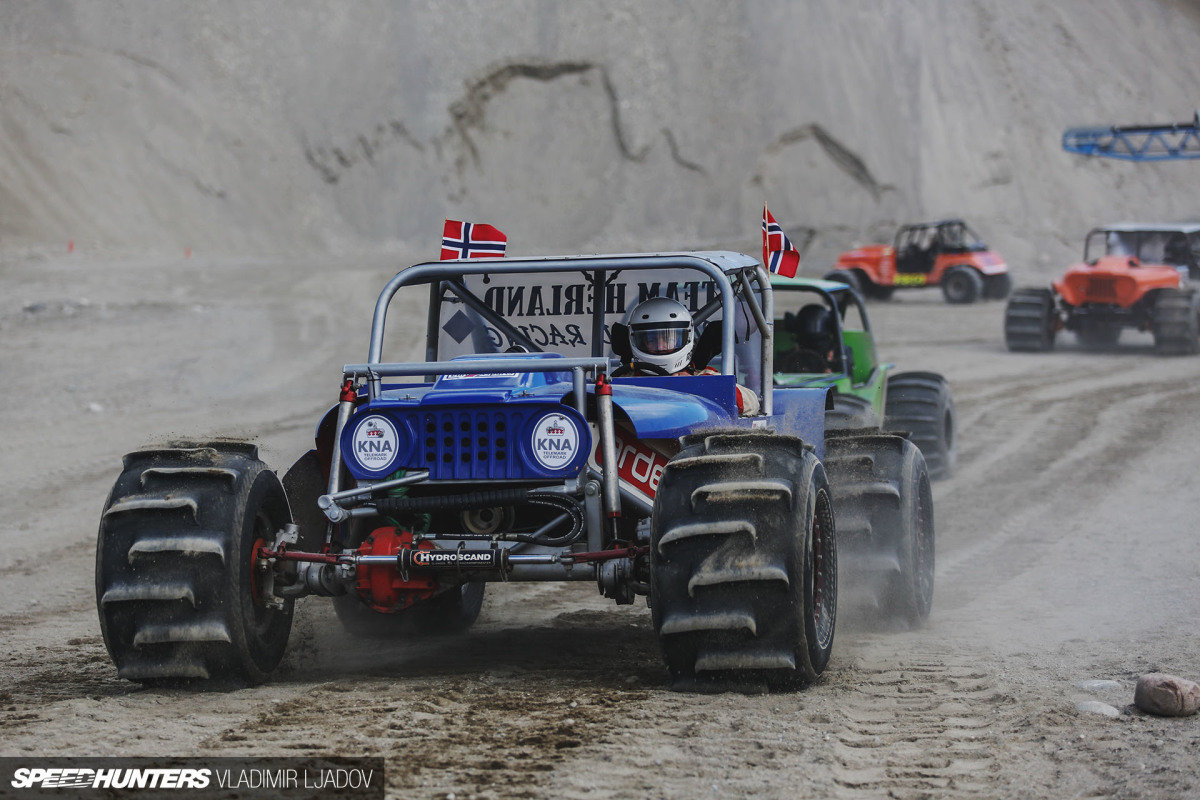

This is a terrible analogy. These tires are selected based on the ability to hold a certain number of G forces when the tire is at 300 degrees and if the track is oval, banked, road course or street course, and if wet or dry, concrete or asphalt, etc, etc, etc. These tires have zero to do with the thread. But if you notice, the pro's use skinnier tires in front. That is because a wider tire is much harder to turn in the corners under deceleration and may grip too much and throw the rear out of tow or the driver not able to turn the wheel.
From a basic physics perspective it's an excellent analogy, and the perfect counter to the "higher contact pressure grips better" claim, or the oversimplified high school physics friction equation that doesn't include contact area at all.
It's rubber gripping a surface, in an application where they're pushing limits and want to maximize grip. And while the front tires are smaller, they're all relatively short and fat.

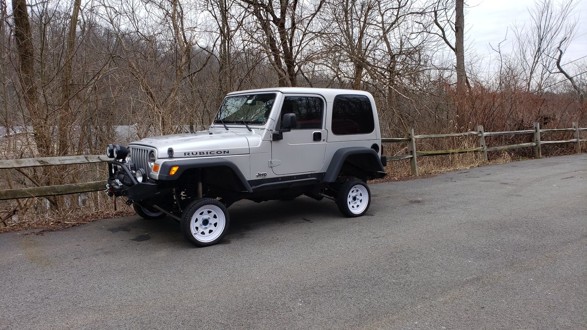

I run 33x10.5x15 BFGs on mine. My TJ is my daily driver so I appreciate the lighter tire for gas mileage. But I actually like the look much better too.
