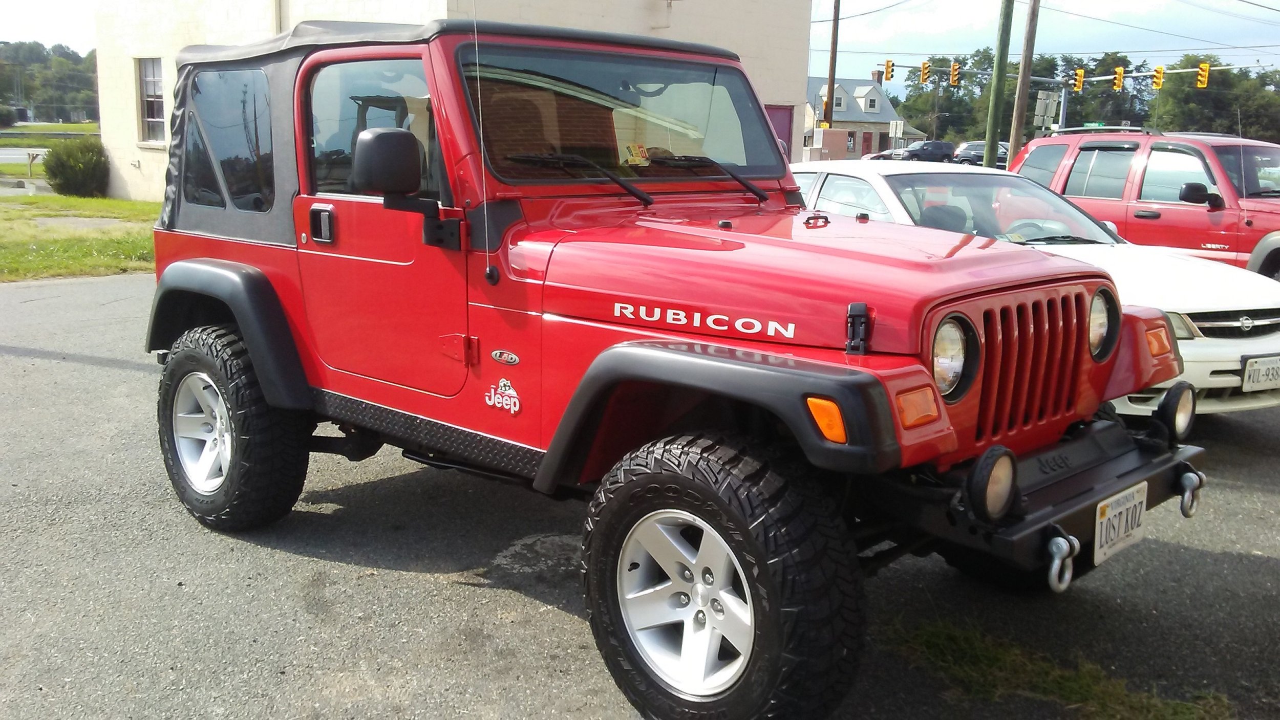

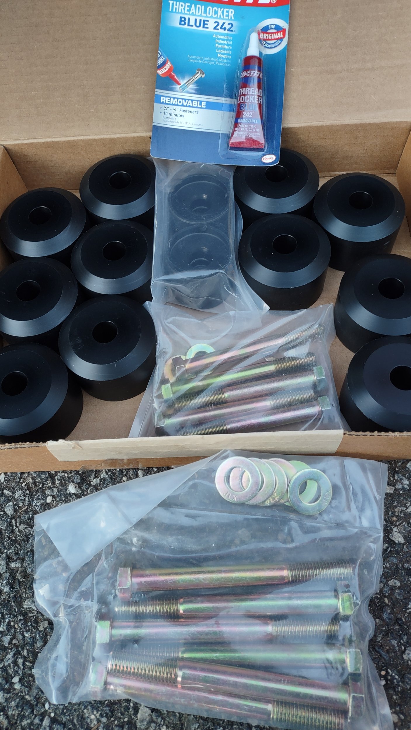

Sometimes fine and sometimes not. With these vehicles now 20+ yrs old the springs sag and it’s hard to say. Many add a 1-1.25” body lift and that makes enough room. See Black Magic Brakes for a solid 1.25” body lift.
X2 on the BMB BL for 31s. 🇺🇸
