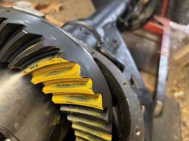

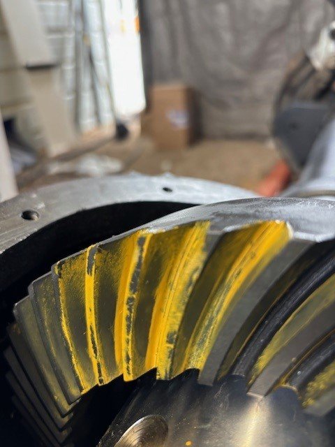

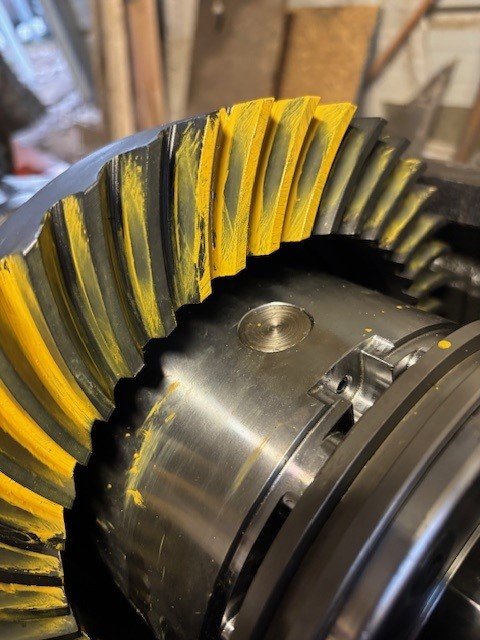

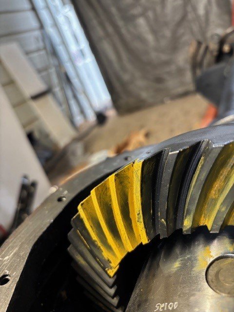

Pattern 1
2004 Ford F350 Sterling 10.5 Axle
Ox Locker
5.38 Yukon 10.25 Gearset (new)
Pinion Depth = .035 Depth Shims under the bearing race.
Backlash = .009
Can you please provide input on the first pattern for this set up?
Thanks

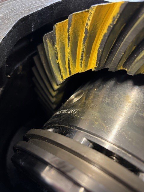

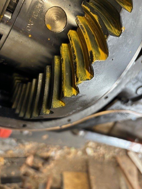

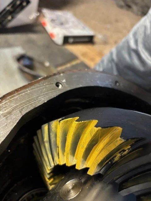

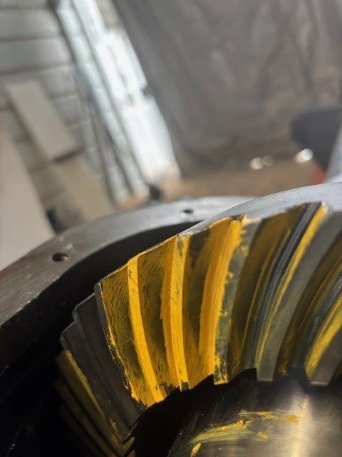

Pattern 2
Ox Locker
Pinion Depth = .025 Depth Shims under the bearing race (removed 10 thou)
Backlash = .008
Pattern 2
Ox Locker
Pinion Depth = .017 Depth Shims under the bearing race (removed 10 thou)
Backlash = .008
View attachment 613431View attachment 613432
The coast side looks good for the most part but I can't see much of what the root has to show. The drive side pattern looks like it should be good but the pattern is kind of tough to see on my phone. Any chance you can wipe off the excess and just use enough to turn them yellow? Try to add more resistance if you can.... That should help out the drive side. Could be me trying to see on my phone.
@Blackjack what say you?
Reactions: Bigfoot-NM

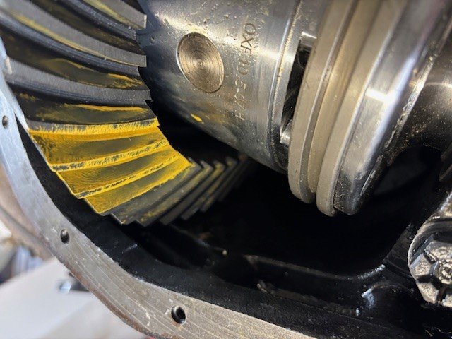

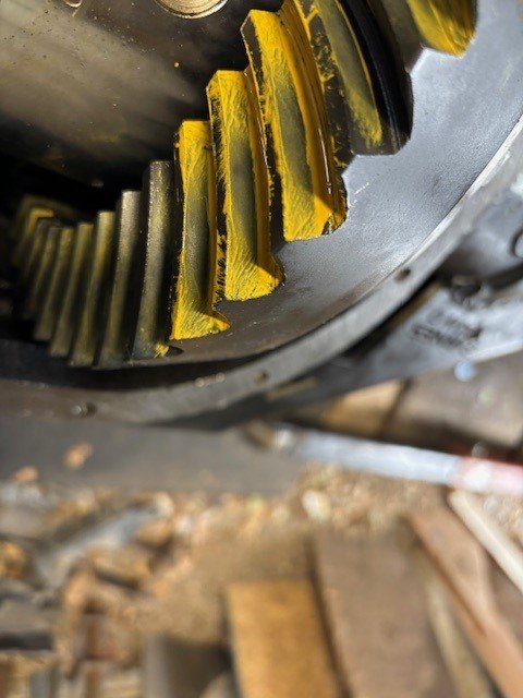

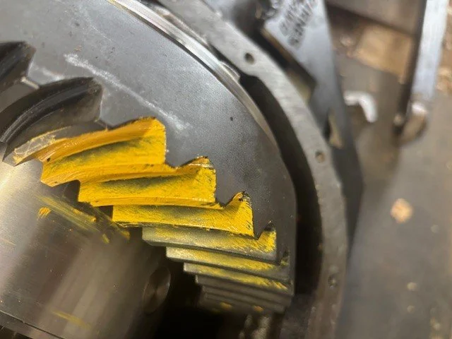

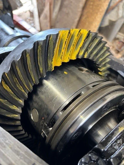

Pattern 3
Ox Locker
Pinion Depth = .024 Depth Shims under the bearing race (Removed 1 thou)
Backlash = .008
Note: I didn't have the shim set up to take out 2 thou. I could go 1 or 3 thou less, I chose to do just 1 )
Man that is the tiniest bit deep. It will run but if you can pull a couple thou more we could see if the pattern flips.
