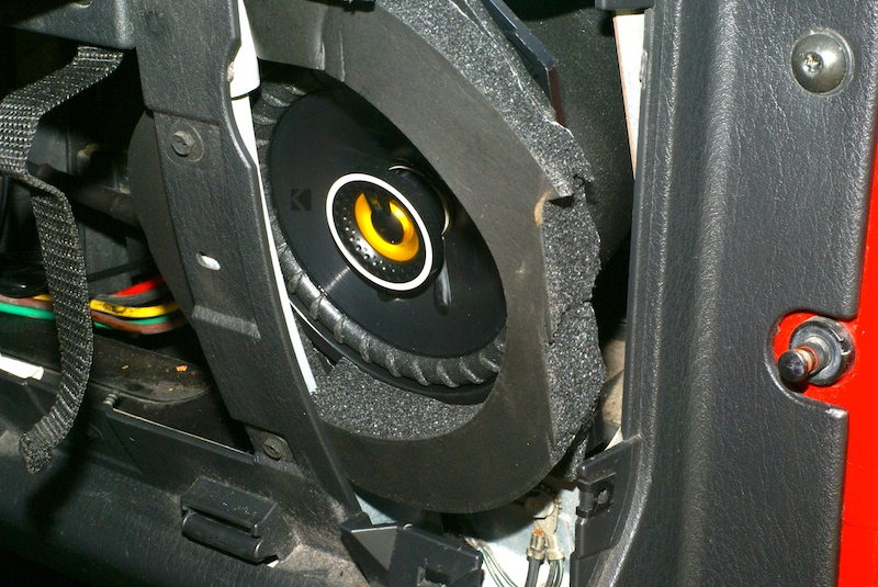

I figured that the boom mats were 90% of the pods for 10% of the cost! I cut a bass port in the back. YMMV and all that...

Like what you did at the rear of the pods. They shouldn’t be enclosed. All dash / door speakers are infinite baffle design they need air behind the magnet. The only thing a pod will do is help push the sound towards the grill out into the cabin and / or help keep them dry. Honestly, the pods are really not going to give you any sonic improvement. A simple speaker ring made from any diy foam to help get that sound up towards the grill rather than leaking sideways behind the grill but that’s about it.

I'm not an acoustic engineer by any means - but it sure seems to me that a speaker wouldn't work well in a completely sealed enclosure - Alternately compressing and pulling a vacuum on the air trapped inside doesn't seem optimal.

Those rings are far better and do more for the sound than any pod ever will...perfect!

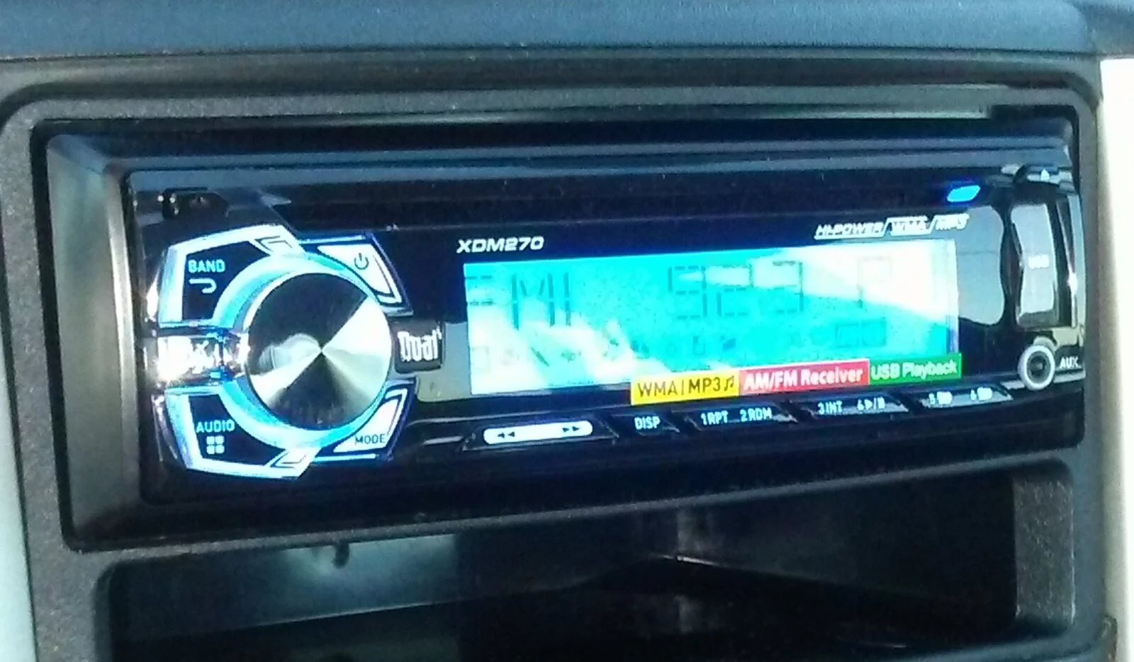

I bought this bad boy for $20 off Amazon 😂
Welp, it lasted less than a month. 😆
Worked fine yesterday AM. Went to drive a couple hours later and nothing. Radio fuse is fine, power is making it to the unit, just nothing once it gets there.
Good news is the return window for it is 1 month, so I'm gonna pull it today and send it back. 😁
That's what I get for going dirt cheap.

You can buy a Dual high powered unit at Crutchfield with all installation gear for under $30. You have 60 days to return with no questions asked. 1 year warranty. I installed one in the Wife's Scion this morning. Took me all of 10 minutes start to finish.

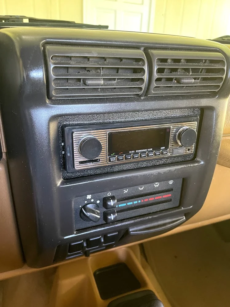

I just hate the looks of like 99% of aftermarket car stereos. They look like a late 90's winamp skin. Some sort of outlandish artistic vision of the future with tiny, almost unusable buttons.
The one I got had a tiny row of buttons but I liked that it had a big knob for changing the radio station or moving forward/back on tracks when using bluetooth.

If you like old fashioned, outdated stuff. I have a factory Jeep TJ stereo. ;)
Well nobody is going to break in and steal it.
So at least you have that going for you. Which is nice.
My 2003 factory radio does Bluetooth!
I paid 2.5 times the price of one of this 99 dollar wonders to keep the look, All the while tunes from my iPhone.
Not aways loud enough at 50mph and over with windows down. but I like the look.
https://1factoryradio.com/jeep-2/

Well , that’s the theory anyway. You’ll get so many arguments about this being snake oil or not. What I would add is it’s only useful for bass speakers. All other car speakers ...or the vast majority are infinite baffle speakers meaning they’re designed for no housing.

Dead right and if using pods cut out the back. No speaker other than your bass should be enclosed completely like these pods do. The rear of the pod is just too close to the rear of the speaker and effectively ensures that speaker does not work as it should.
