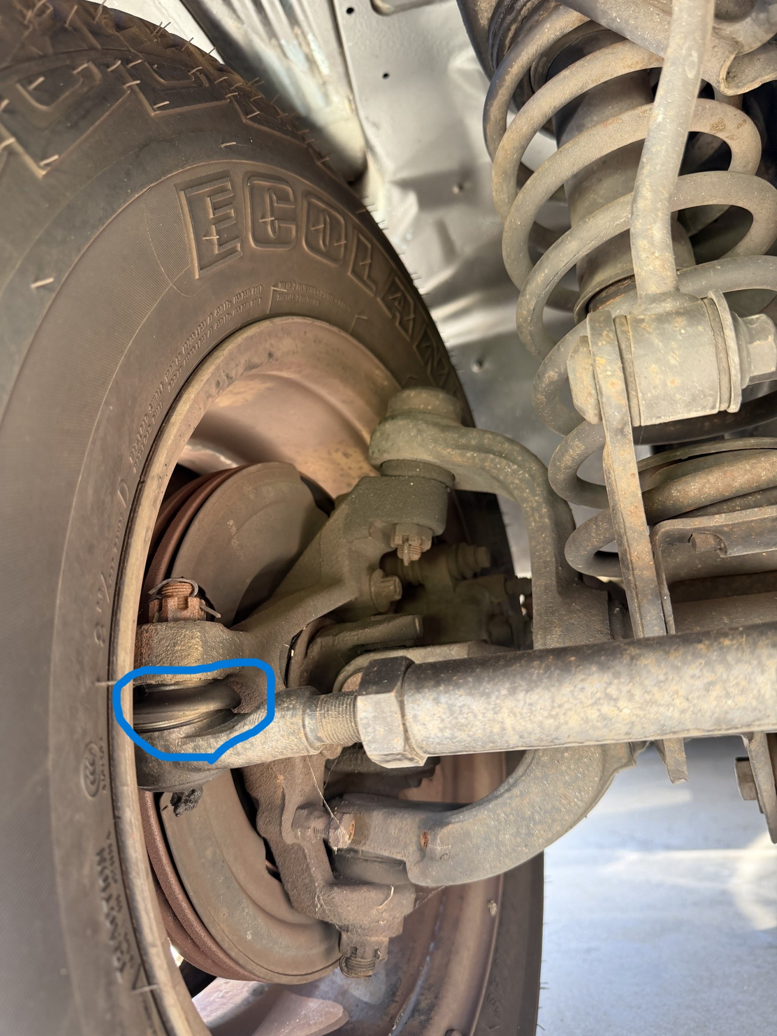

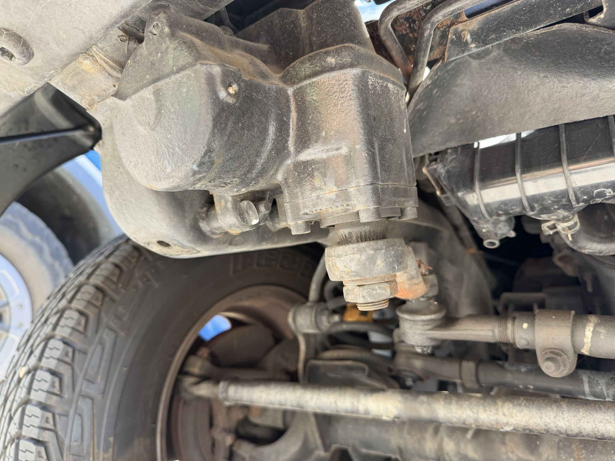

Howdy, so I am slowly rebuilding my dads 04 Tj that I inherited and I've noticed that the steering is pretty floaty. I've had older cars before (70s) and can deal with it but I also figure that after 20ish years it could be due an overhaul and it would be nice to make it feel a it better as I do intend to drive it a fair bit and maybe even sell my daily so I can throw the money into more projects.
Are there aftermarket replacement options that can firm things up/make it feel a bit less floating and more direct instead? This would be for RHD.
steeering box?
Front left (My Passenger side RHD car)
Front Right (My drivers side RHD car)

set the appropriate tire pressure for size, do a dry steering test to check for worn components and finally post up some pics of the steering components as they can often aid remote diagnosis
