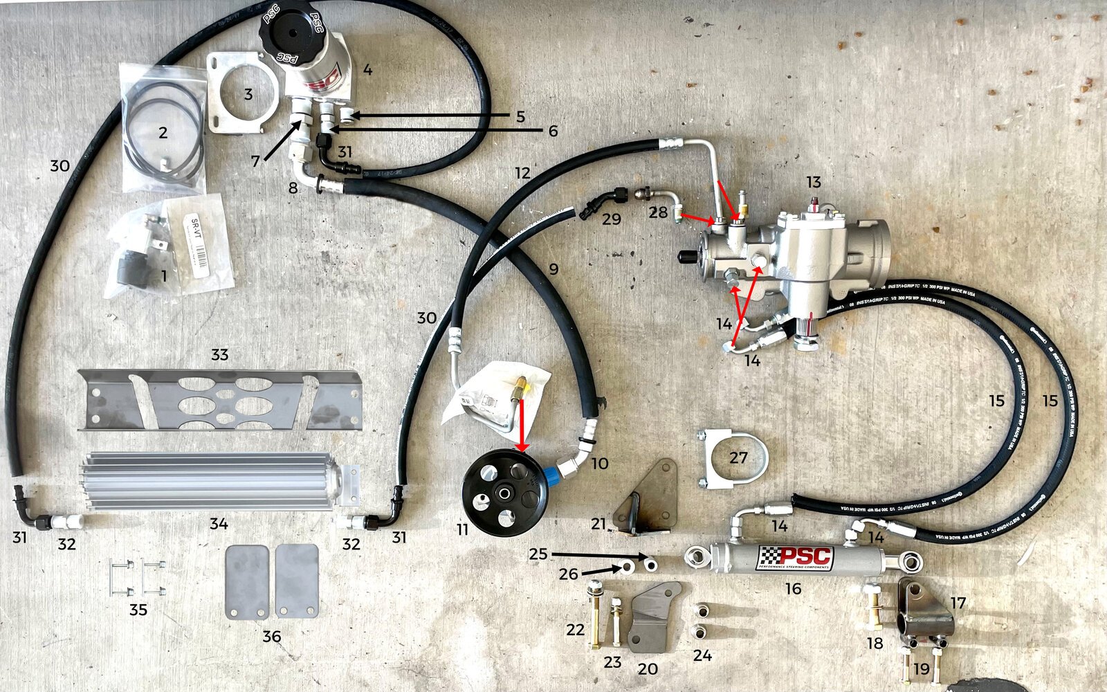

The best part of that picture is Chris made at least 4 mistakes in it that I missed because I was trying to get some method of sticking numbers next to parts without paying attention to what parts were being used.
Going back to this post, and since I'm in the middle of installing a PSC system, I'll bite.
The first thing I noticed is the directions state that the "driver's" side low pressure from the cooler should go to the pump. In the picture, it shows that particular line coming from the low pressure side of the steering gear.
Second, the drag link bracket is oriented backwards.
Third, correct me if I'm wrong, the high pressure lines to/from the cylinder are showing 1/2 and the should be 3/8?
Lastly, it appears that the low pressure lines from the cooler are -6 and not -8? They look like they might even be high pressure lines?
Correctly, the return port on the steering gear should go to the right side of the cooler. We don't do driver and passenger, we do left and right. Folks may not know that the return is low pressure or input is high pressure, but they do know or can tell that the line from the pump goes to a specific port on the steering gear.
If we are going to do that, then the cover plate for the stabilizer/trackbar mount is upside down.
They are backwards is all. The -6 high pressure hoses are shown with -8 low pressure push lock fittings and the low pressure push lock hose is shown with the -6 high pressure 90's.
