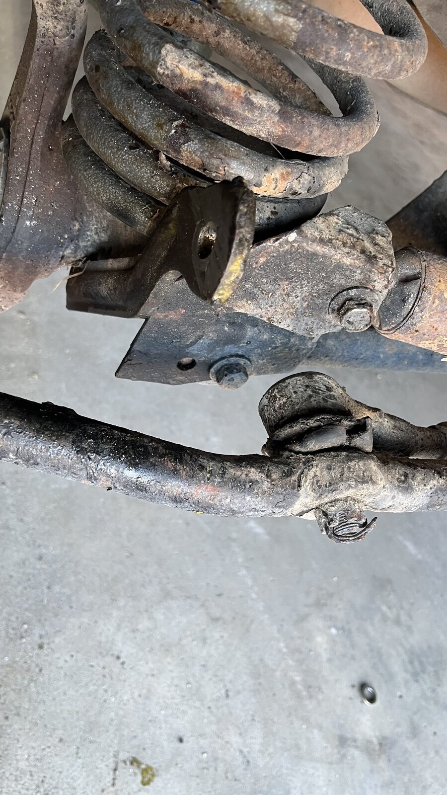

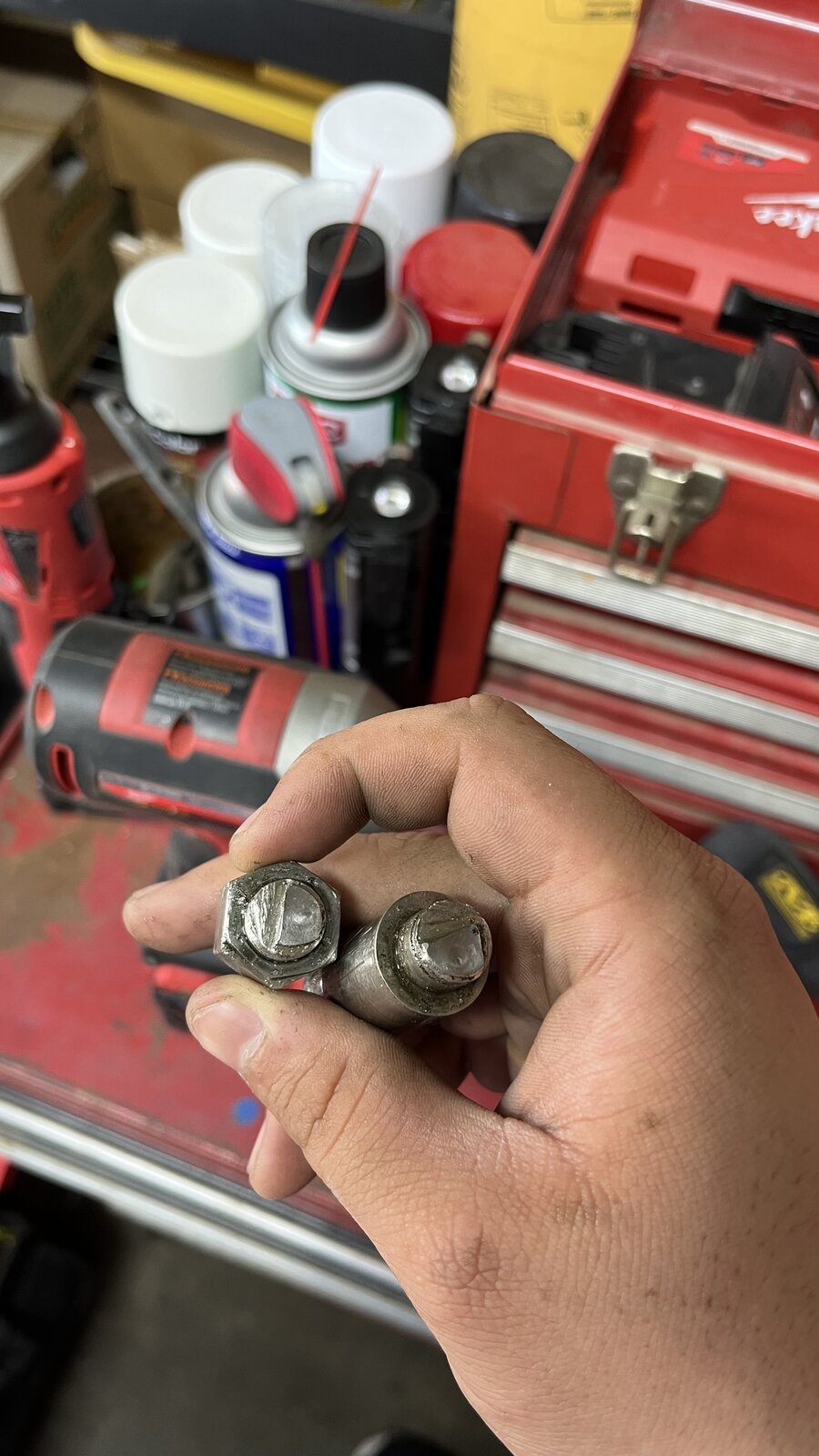

I have a 2000 TJ 4.0 auto, and recently I have been experiencing squeaking while I am driving, it seems like random but I think it happens at random bumps and the squeaking stops when I slow down to a certain point or stop. It seemed to all happen after I have reattached my sway bar quick disconnects link after wheeling.
The stud that connects the sway bar to the axle was very loose and spinny so I was led to believe it was that. Currently the stud is cut off and my sway bar system is fully off the jeep.
Main points: it doesn’t happened the whole time I’m driving, it does NOT squeak when I spin the tire on jack stands(I can check again)
Below I have attached videos of the squeaking, and 2 pictures of the stud cut out

Could be that coil.
Does it squeak when you bounce the front end?
Not that I know of, but I know I need to replace it soon. A buddy said it may be a bushing especially cause a lot of mine are shot. I need to clean the jeep soon so see if it’s dirt
